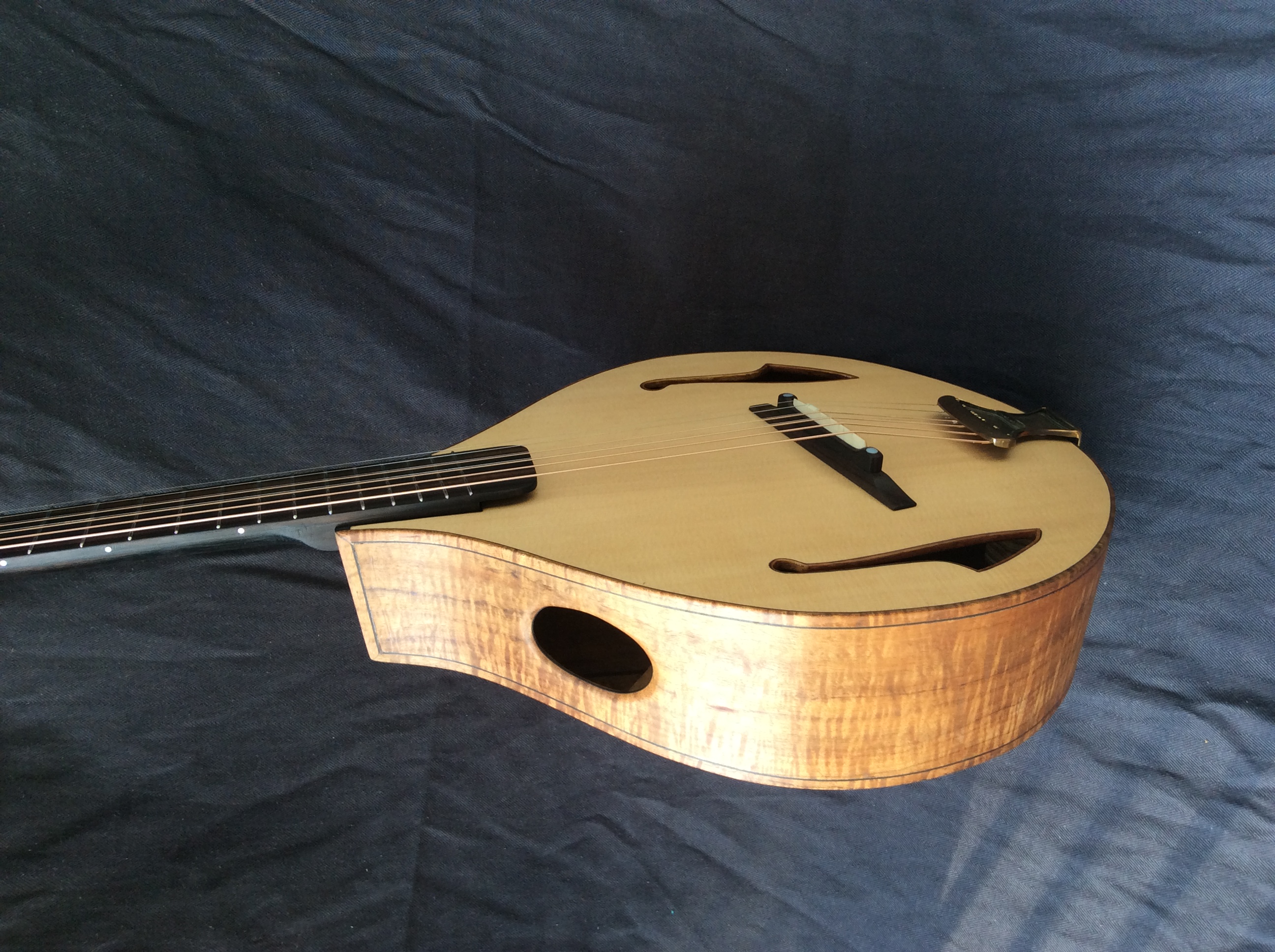

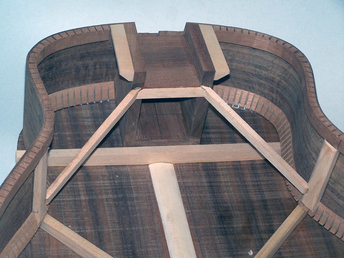

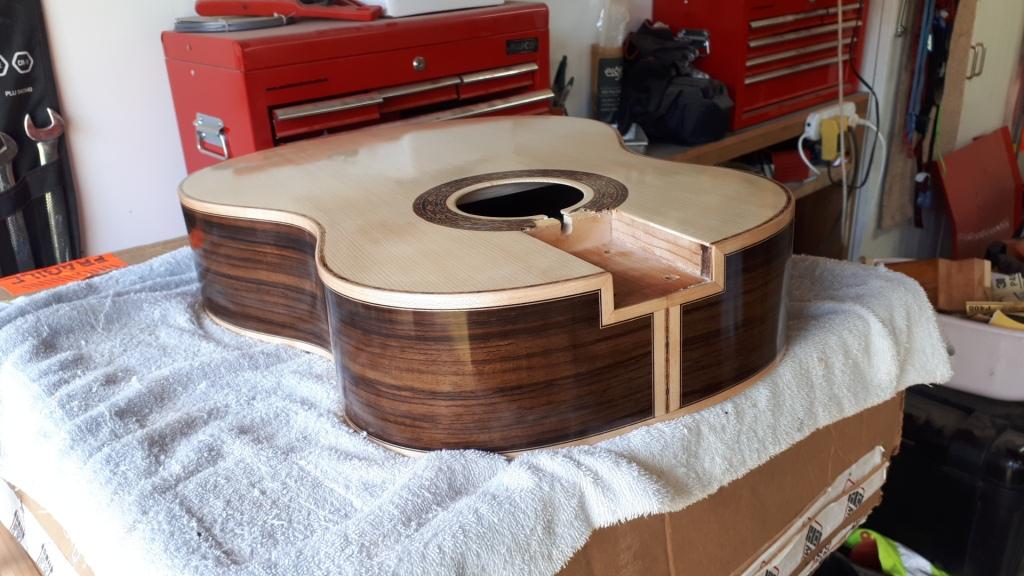

Think about a hollow neck block, with a mortice for the end of the neck to sit in. Embed a couple of t-nuts in the top surface of the neck (covered with the fretboard) and bolt the neck the neck on from underneath. Pics of a couple of bouzouki bodies to give you an idea. The structure is glued up from bits of 8-10mm thick mahogany.

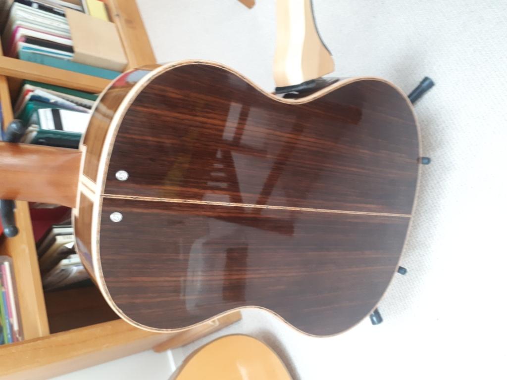

This is a poor photo but you get the general idea. I blackened the bolts as these looked too bright against the rosewood.
Here's a picture of the neck joint
There are two bolts at the other end of the mortice that are done up from inside the soundhole. That's a real pain. The next guitar will just have two bolts accessed from the back. I glued a steel washer onto the heel block in a counterbore so that the s/s allen bolts sit flush with the back once its on.

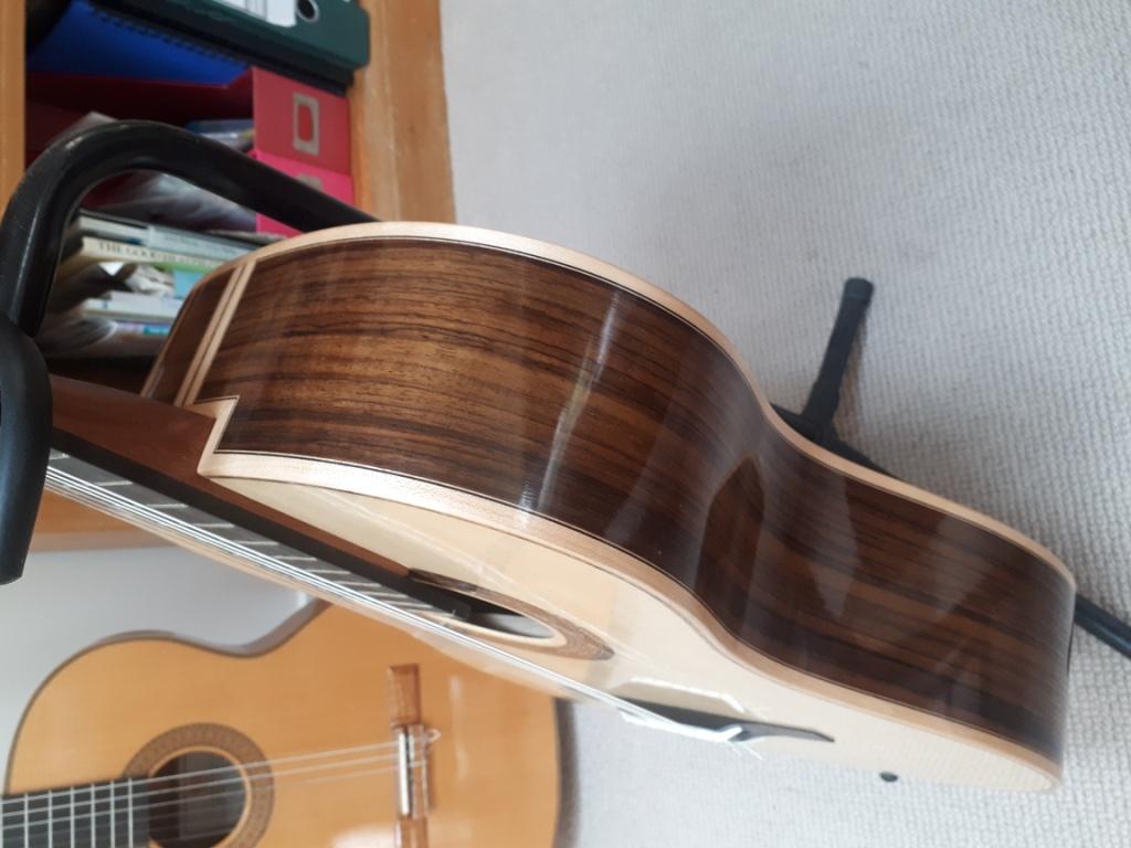

Yep, I endorse what Graham and Richard said. There is actually no need for the heel, very good reasons to eliminate it, and a number of good options to attach the neck in another way. Here is one I made following Graham’s plan, with a hollow neck block (a bouzouki style body, but you could do the same with a guitar shape).

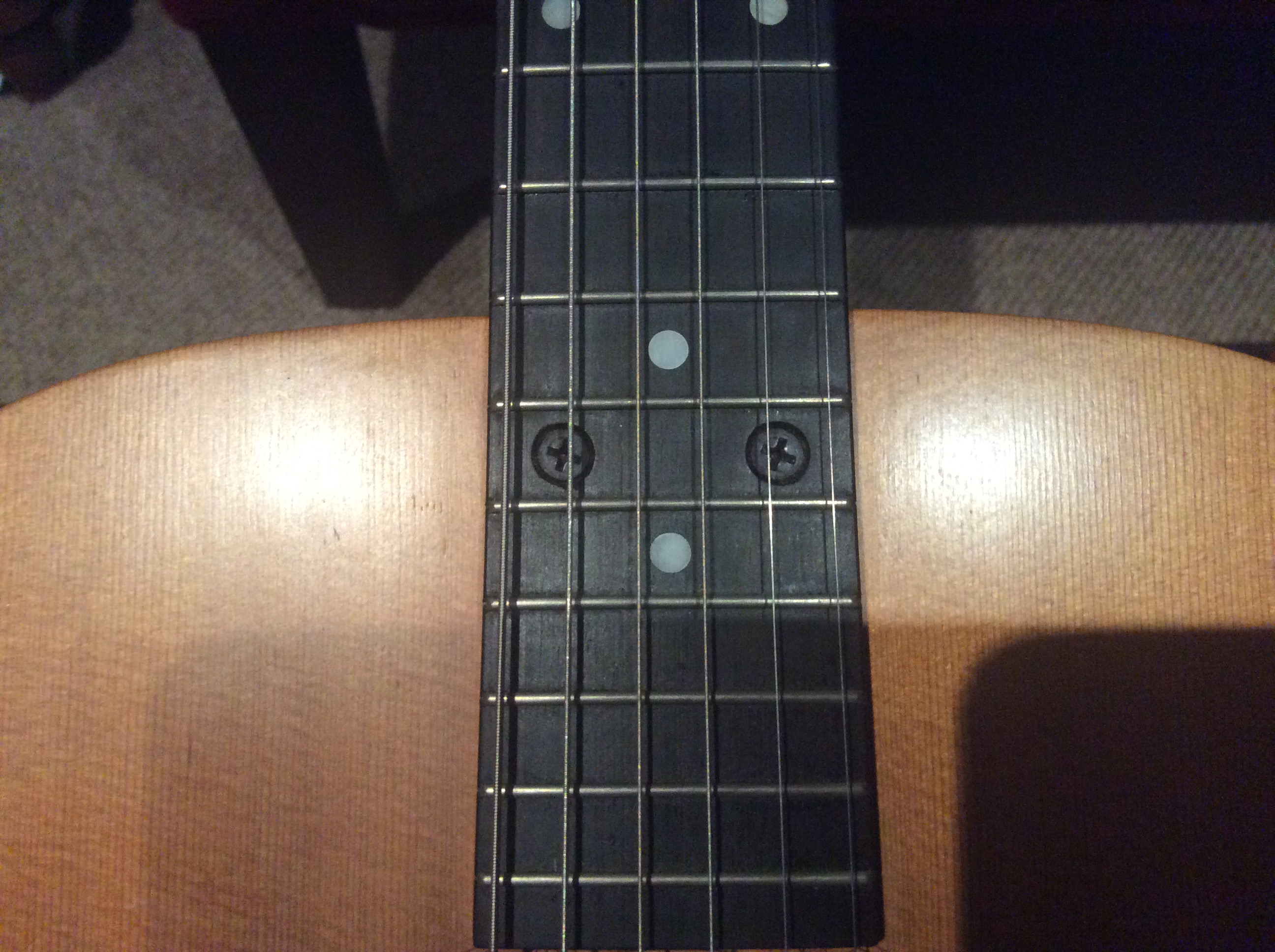

I also love my Taylor Big Baby which has the same style of heel-less neck sitting in a pocket in the neck block. The Taylor has the neck attached by two screws straight through the fretboard at the 16th fret, which is inelegant but effective. Or you can hide the bolts inside, or come in from the back

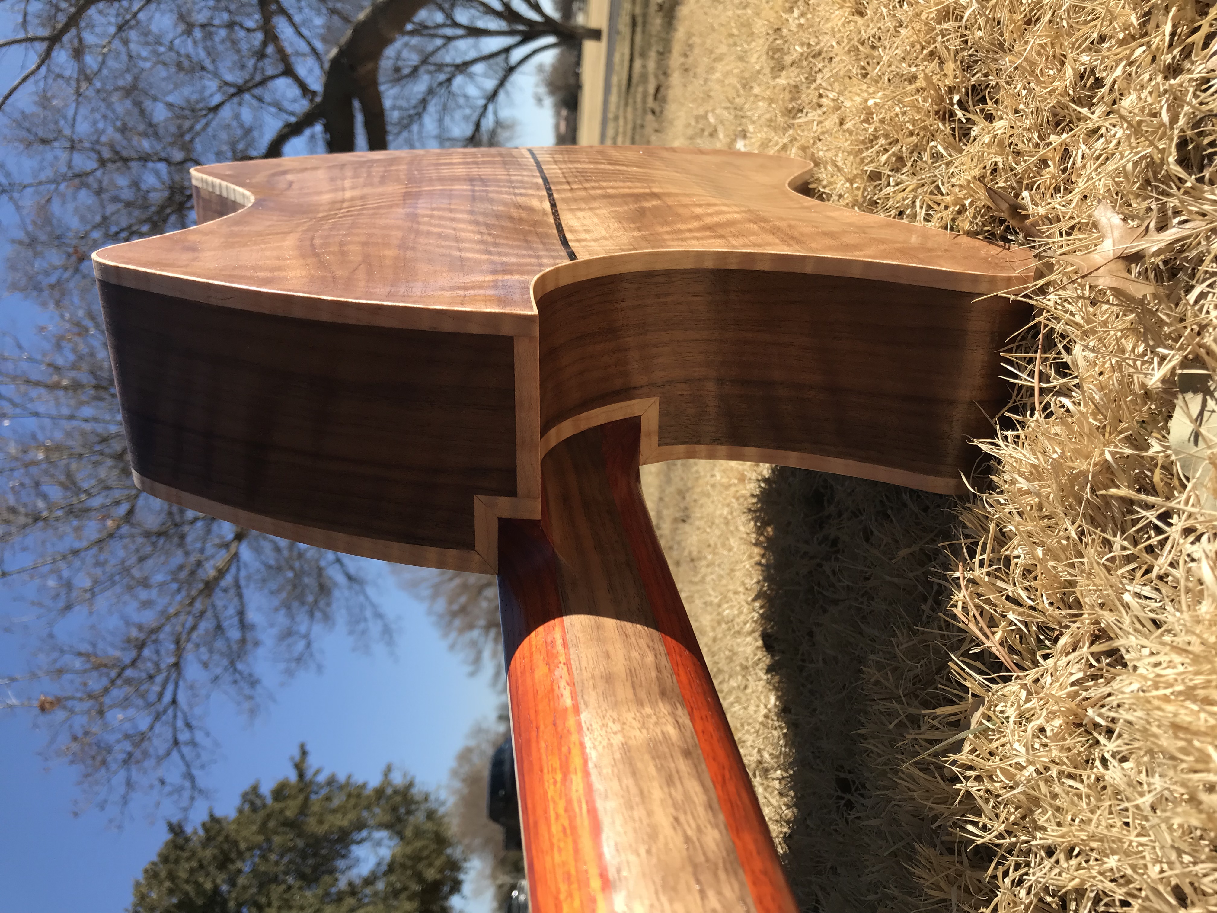

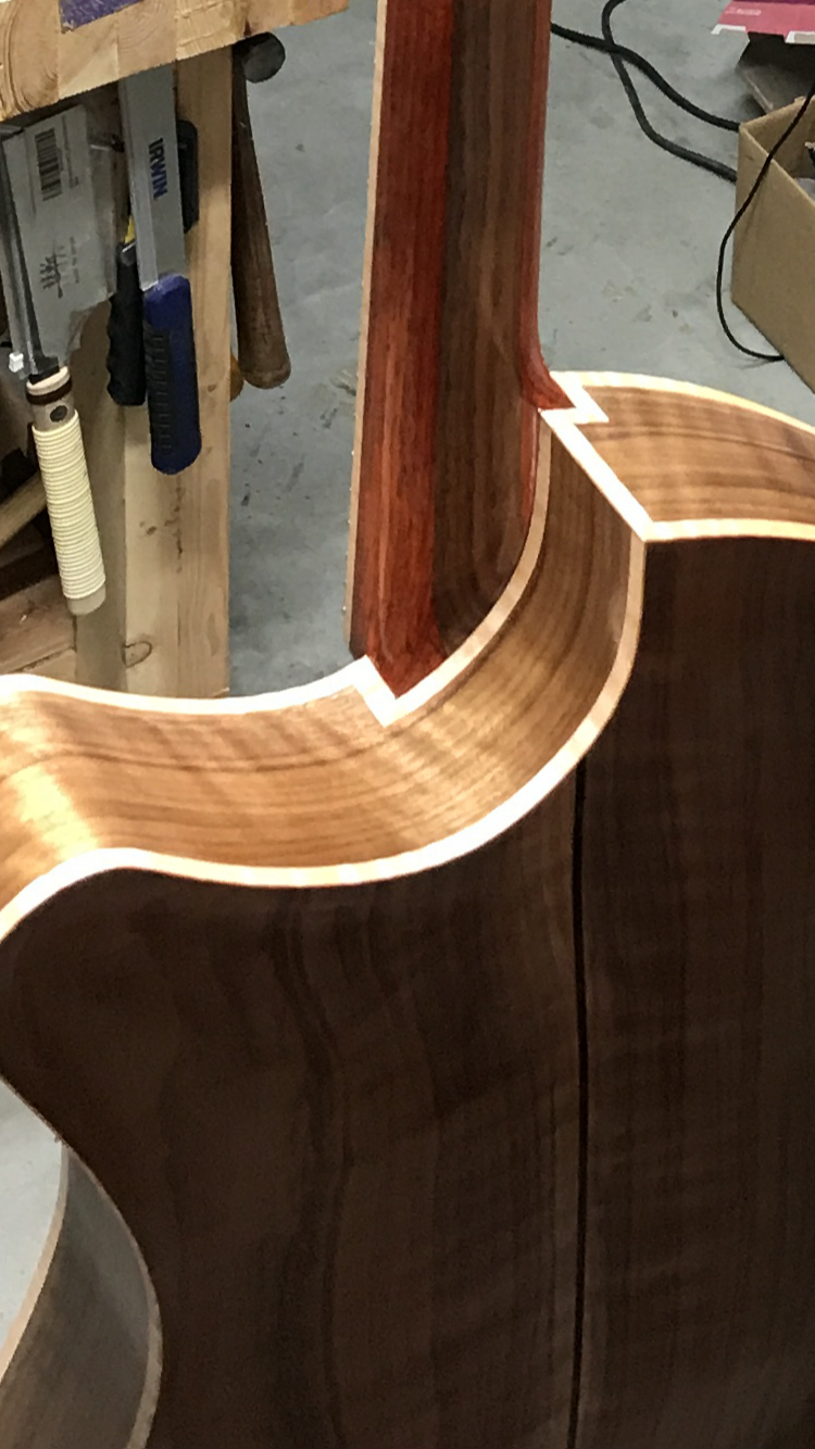

This isn’t a bolt on, I can’t seem to do my cutaways different.
