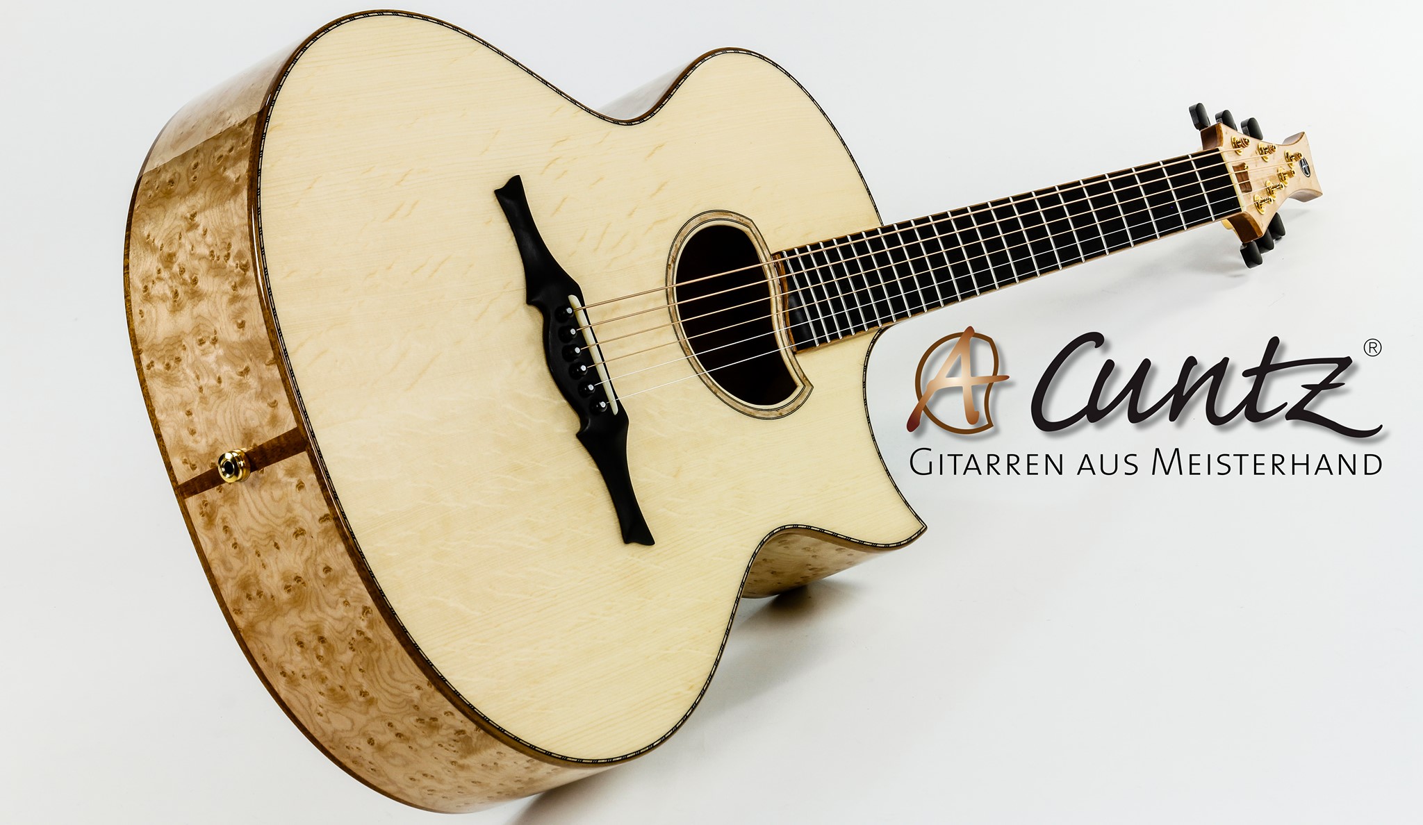

I was looking at a video of Mike Dawes tonight. Very skilled guitarist though I do tend to think if someone wants to play drums they should actually be a drummer! He was in an interview with Tommy Emanuel.
However the guitar he was playing had a really elegant bridge design. No idea if it is an efficient design but it does look really nice.
I wonder if other Anzlf builders use interesting designs...? And can they show that they are effective? I'm talking about SS guitars.

You probably saw Mike Dawes playing a guitar made by Andreas Cuntz in Germany. He makes a really long and elegant bridge on most of his guitars, a bit reminiscent of the moustache style bridge of the older Selmer Maccaferri guitars in length, but more curvy. I like the interesting shaped sound hole too.
In terms of bridge design there are two generally accepted principles that are important for a bridge to work well:
1. The ends of the bridge should extend across the primary braces (whether they be X-braces, falcate, V or A shaped) to strengthen the soundboard under the bridge and resist rotation.
2. The bridge should be stiff but not too heavy.
Beyond that it is really all aesthetics.

Thanks Mark, I recall now he did mention the maker. And thanks for the points on bridge design.
It is something I puzzled mightily over when building my fan braced classicals. I was inclined to make a somewhat shorter bridge to save weight but this would then not have intersected the next fan. In the end I went for a traditional length. It is certainly a design that works as one might guess!
