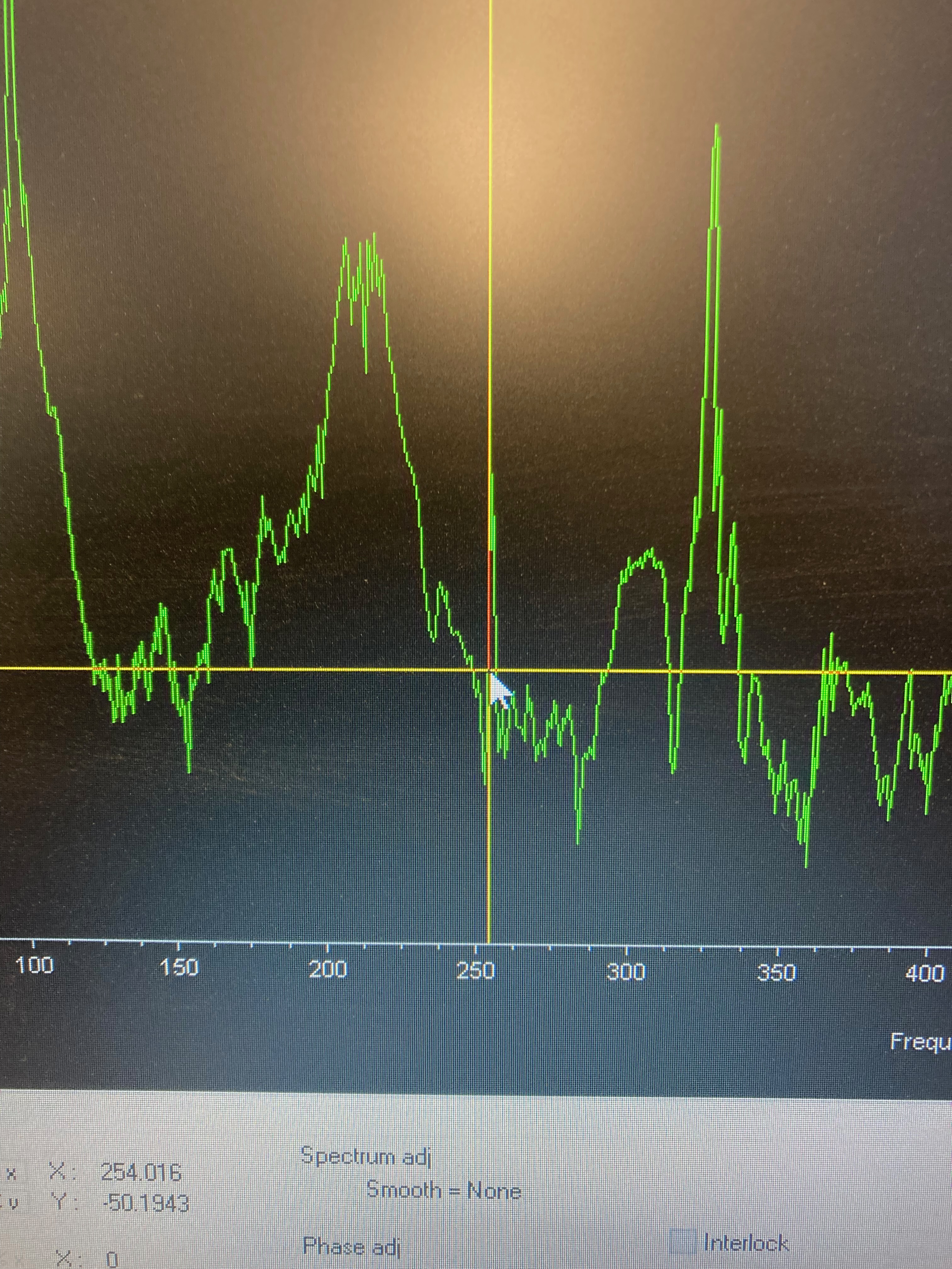

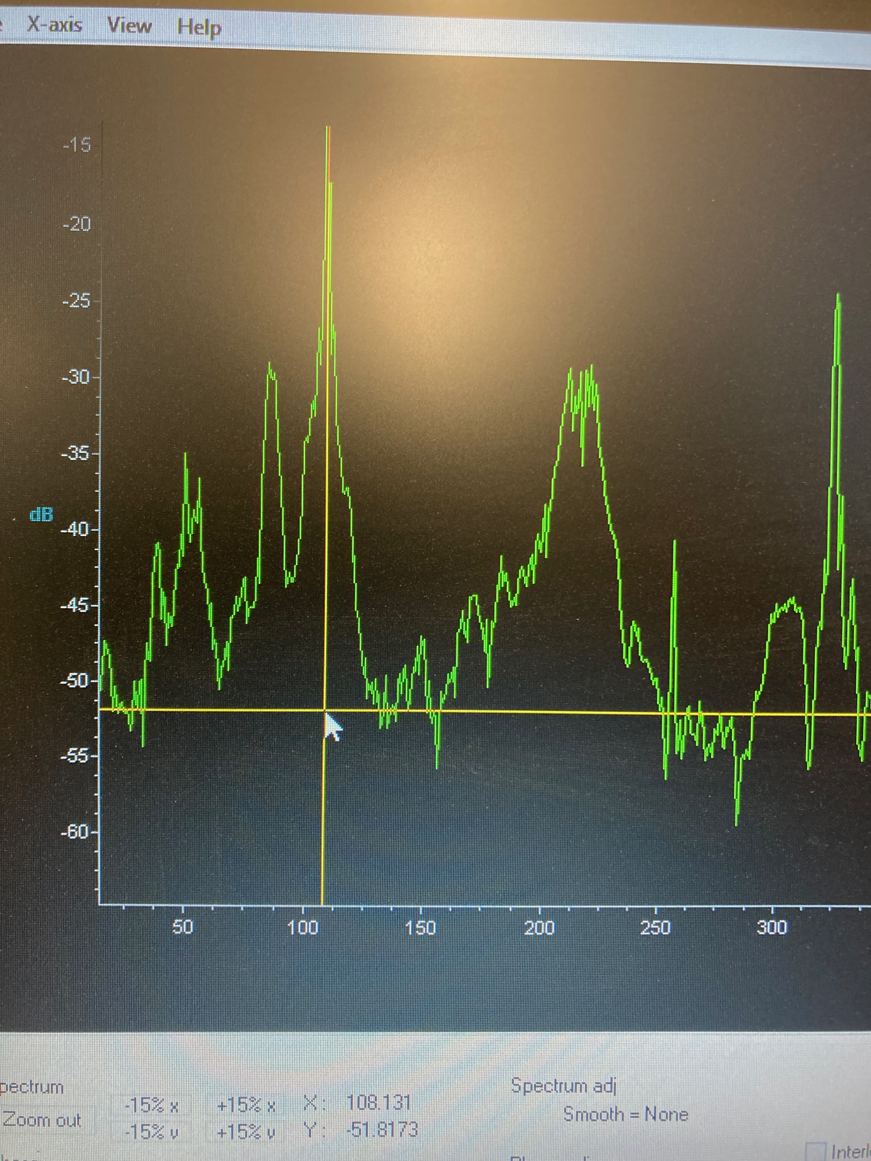

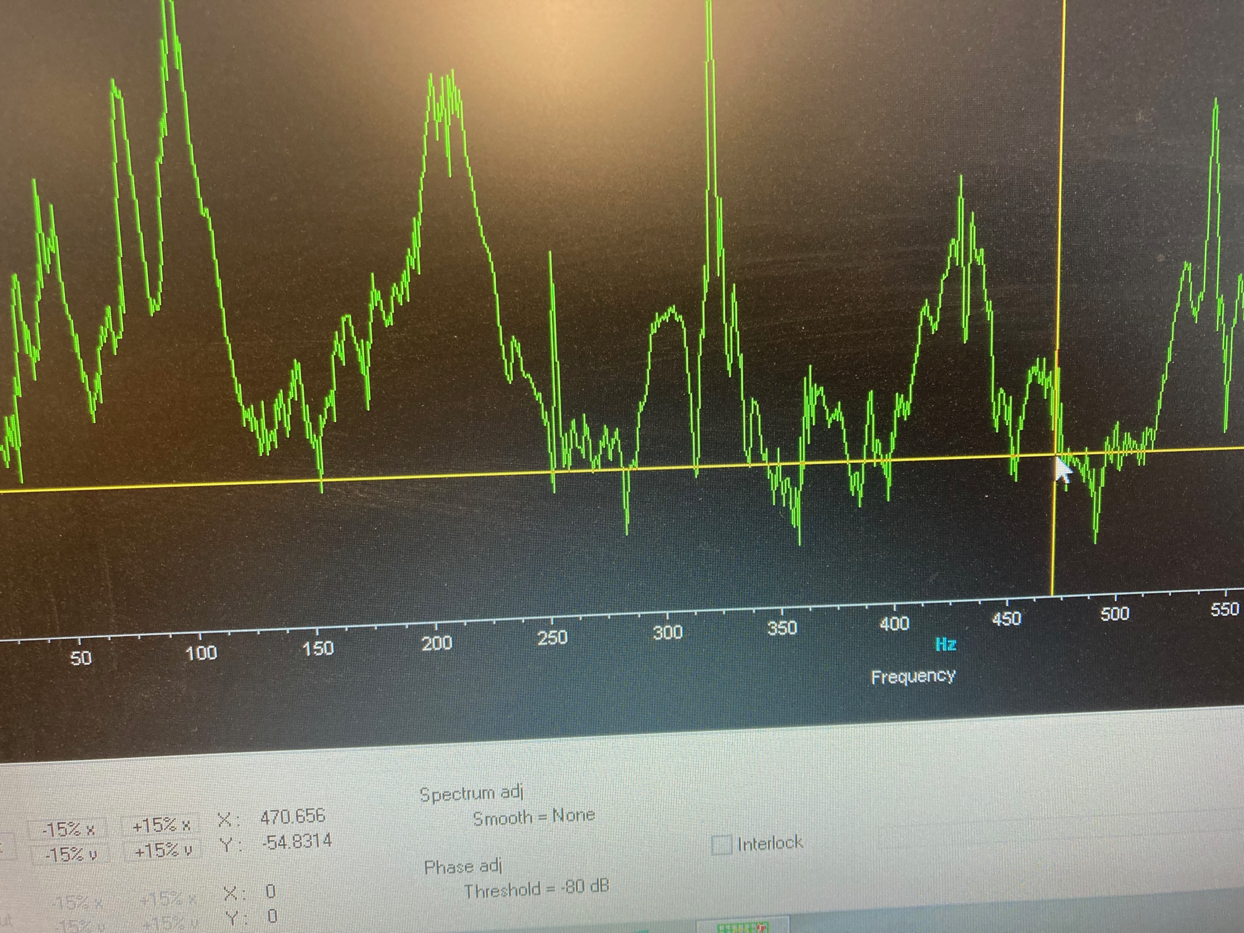

A tap test using VA indicate following:
T(1,1)1 - 108.0Hz T(1,1)2 - 214.5hz T(1,1)3 - 254 Hz Live back At around 466Hz there's a little peak

Those are fairly nasty looking VA plots, Martin. Lots of background noise or something else going on?
Re: Trouble Build
I'm running mic output into laptop via a preamp....might have something to do with the background noise. Ive also got smoothing turned off.Trevor Gore wrote: ↑Tue Jul 04, 2023 10:42 pmThose are fairly nasty looking VA plots, Martin. Lots of background noise or something else going on?
Guitar was lying on its side with neck on a neck rest so there's probably a neck resonance being picked up. It was a quick tap test..I usually hold the guitar in playing position for testing.

I get noise like that when I am clipping. The gain being too high.kiwigeo wrote: ↑Wed Jul 05, 2023 9:30 amI'm running mic output into laptop via a preamp....might have something to do with the background noise. Ive also got smoothing turned off.Trevor Gore wrote: ↑Tue Jul 04, 2023 10:42 pmThose are fairly nasty looking VA plots, Martin. Lots of background noise or something else going on?

As mentioned earlier I'm using a preamp and it's usually turned up fairly high. You may also see peaks at 50Hz and multiples of same which are AC hum being picked from the preamp and laptop powerpacks.
I redid the tap test with preamp turned down and the main peaks are as already reported. I can't see any peaks that correspond to the dead note at B flat 4 or multiples of same.
