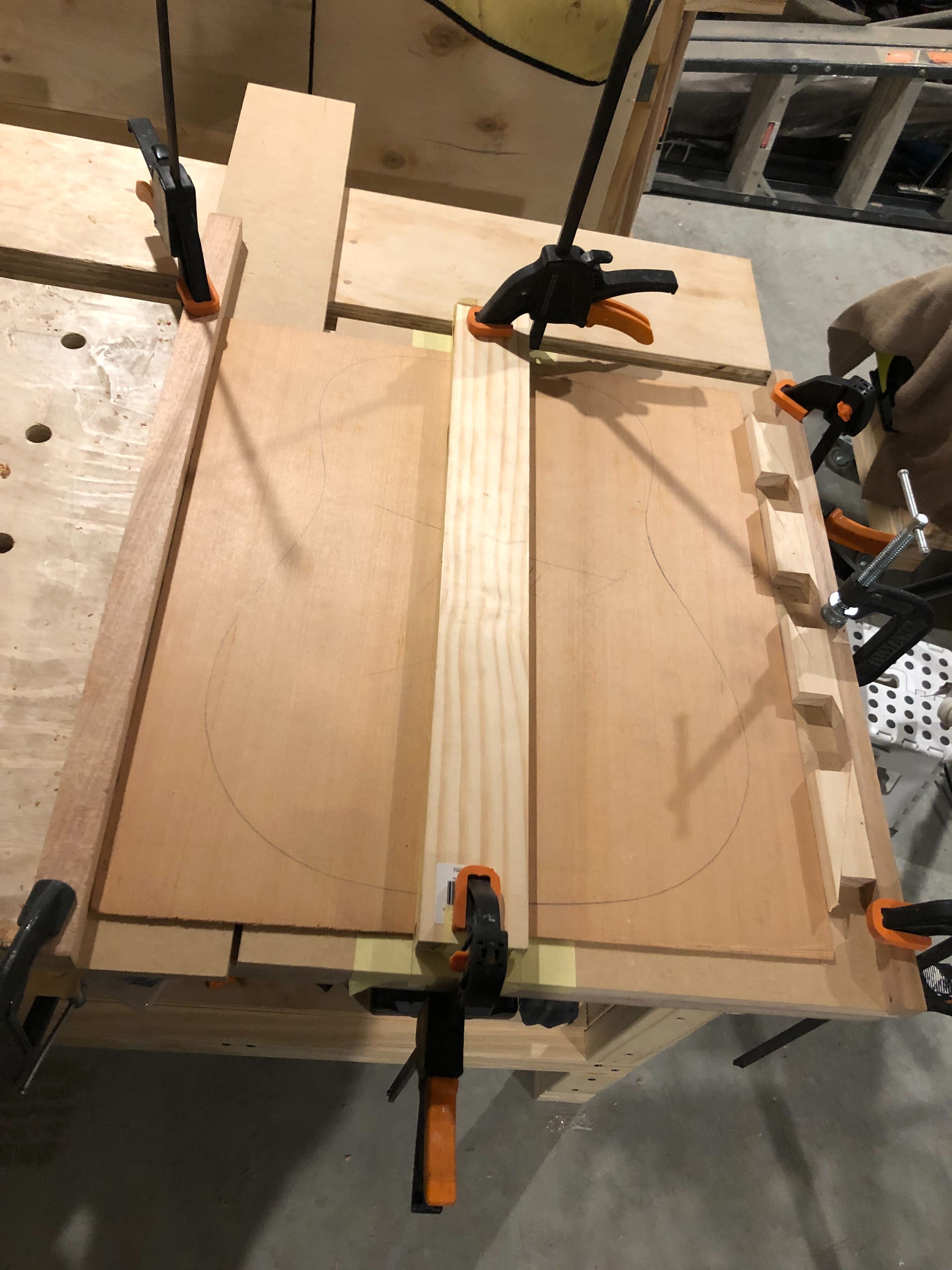

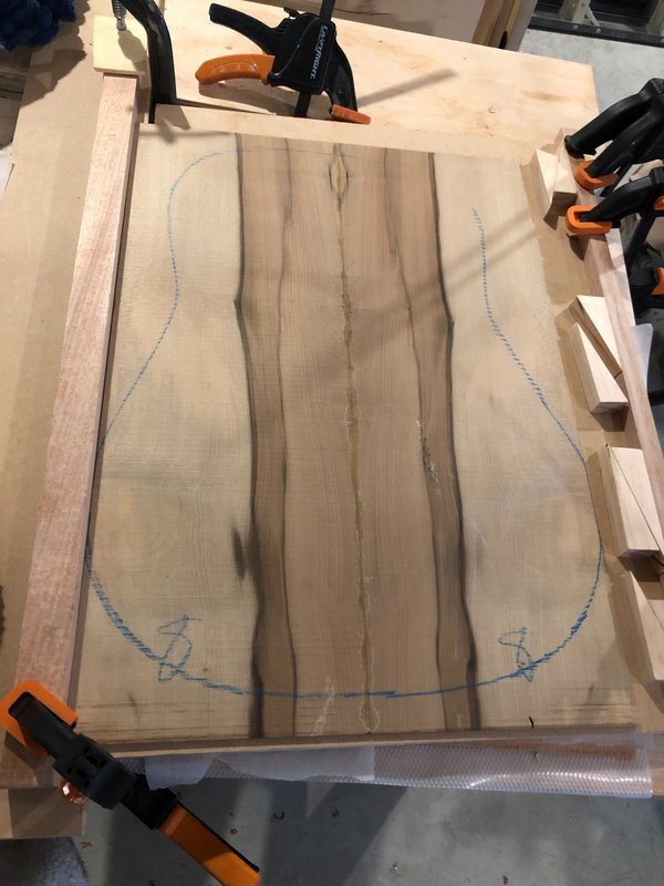

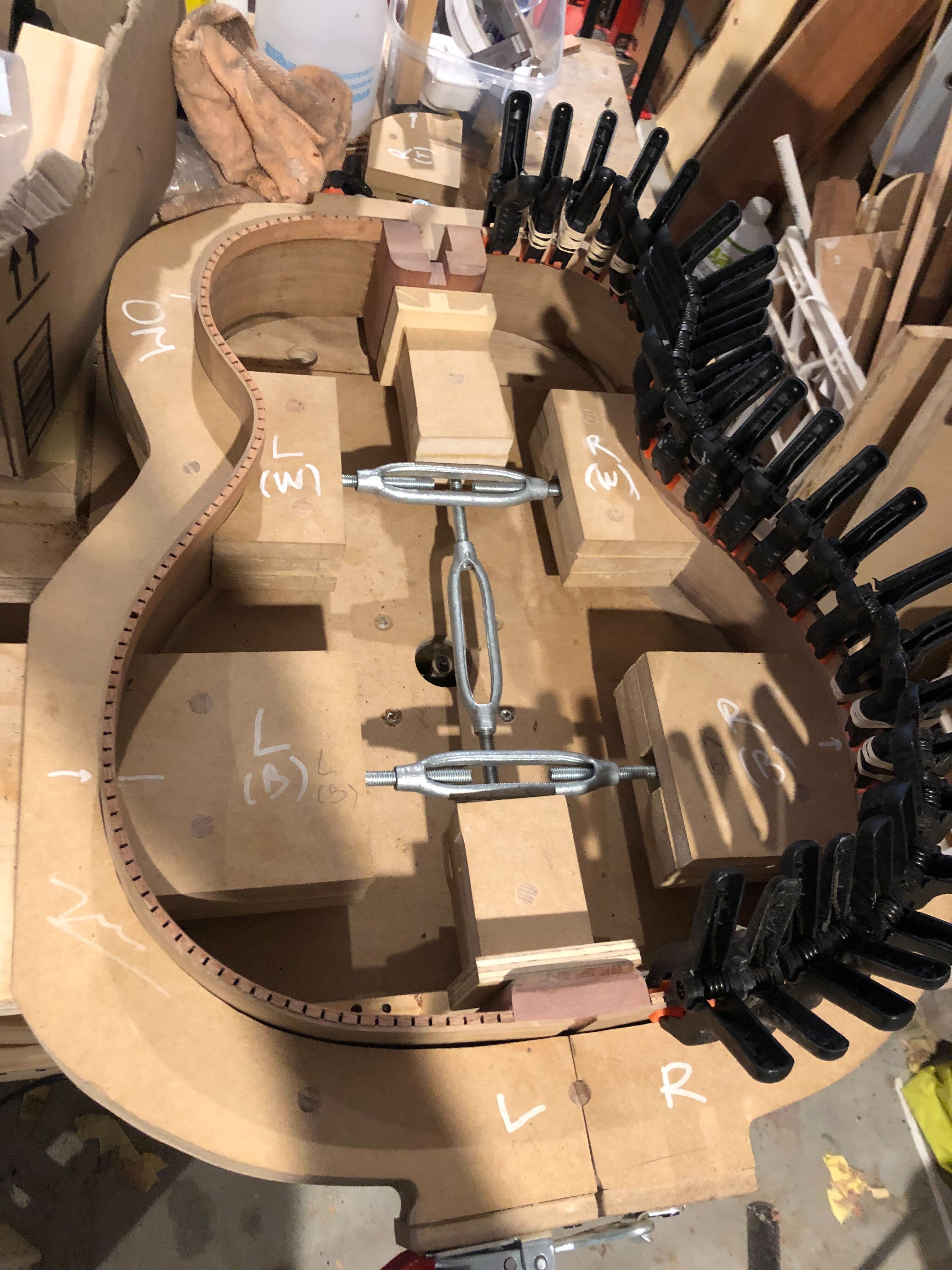

Hello all from Hobart TAS, I've been a guest here for so long but not getting my hand dirty yet until now that I am building my first guitar , it's an OM
I use blackheart sassafras for back and sides and king billy pine for the top. Tonight I'm gonna plan down the top to the right thickness, but I am not sure with King billy pine, it's not very stiff like spruce, may I know how much thickness I should aim for roughly? Thank you everyone.
