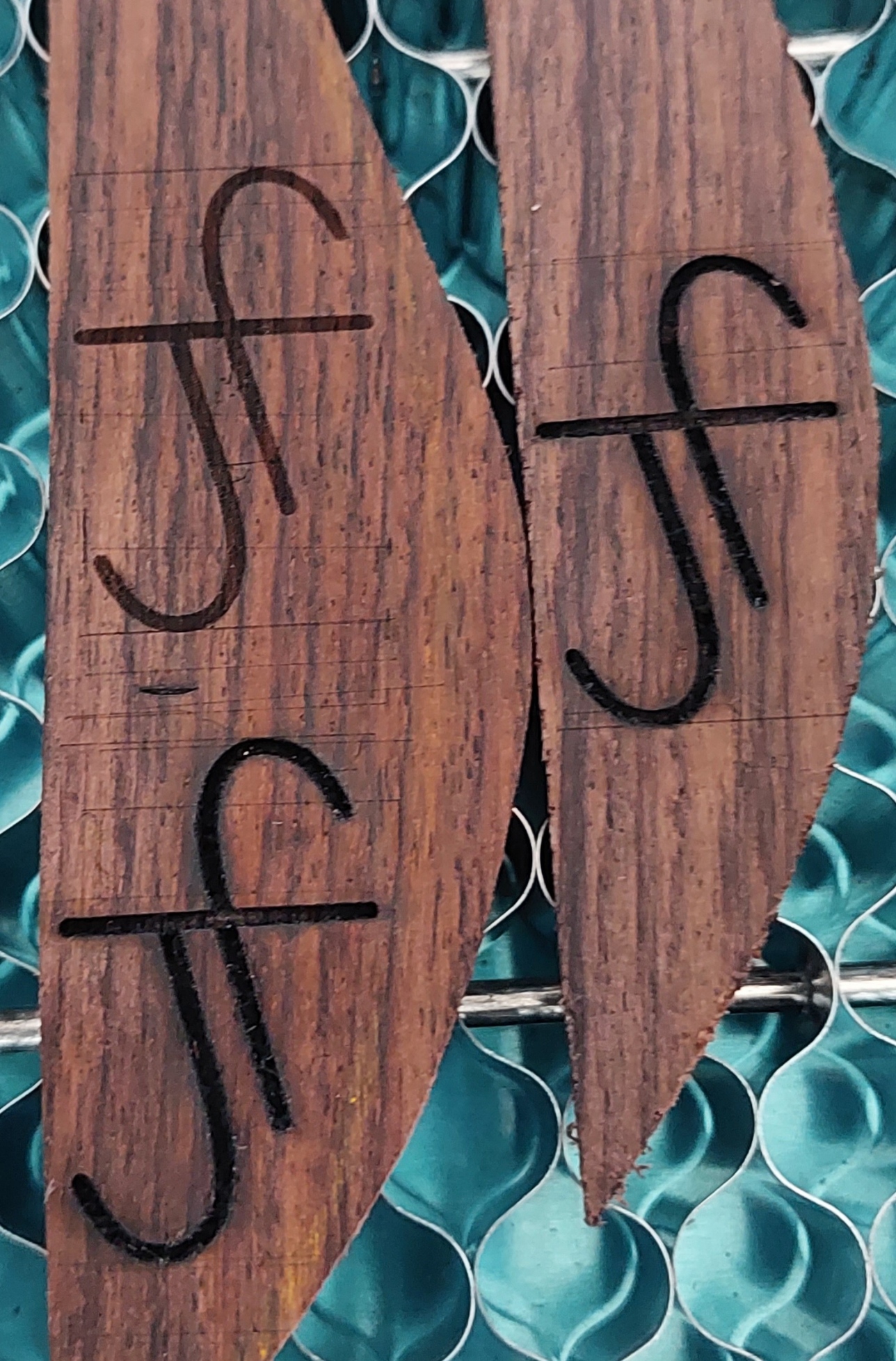

Thanks for the tips gents.
Here's a pic of my initial trial engraves. East Indian Rosewood.
Lowest left hand pic used 75% constant power, max speed (6000mm/min), and 20 lines per mm. Got pretty deep, but there is some scorch marks surrounding the logo.
Right hand pic used 50% constant power, all other settings the same. Pretty good depth, certainly enough for my needs. Less smoke/scorch marks around the cuts. A bit of sanding might remove that.
Top left hand pic was a low dynamic power setting. Looks the best but no depth at all.

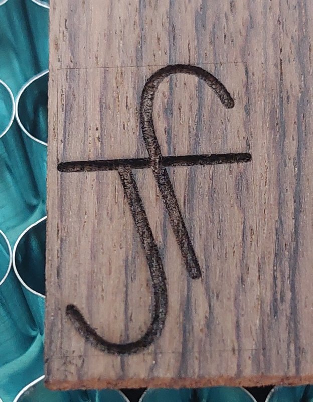

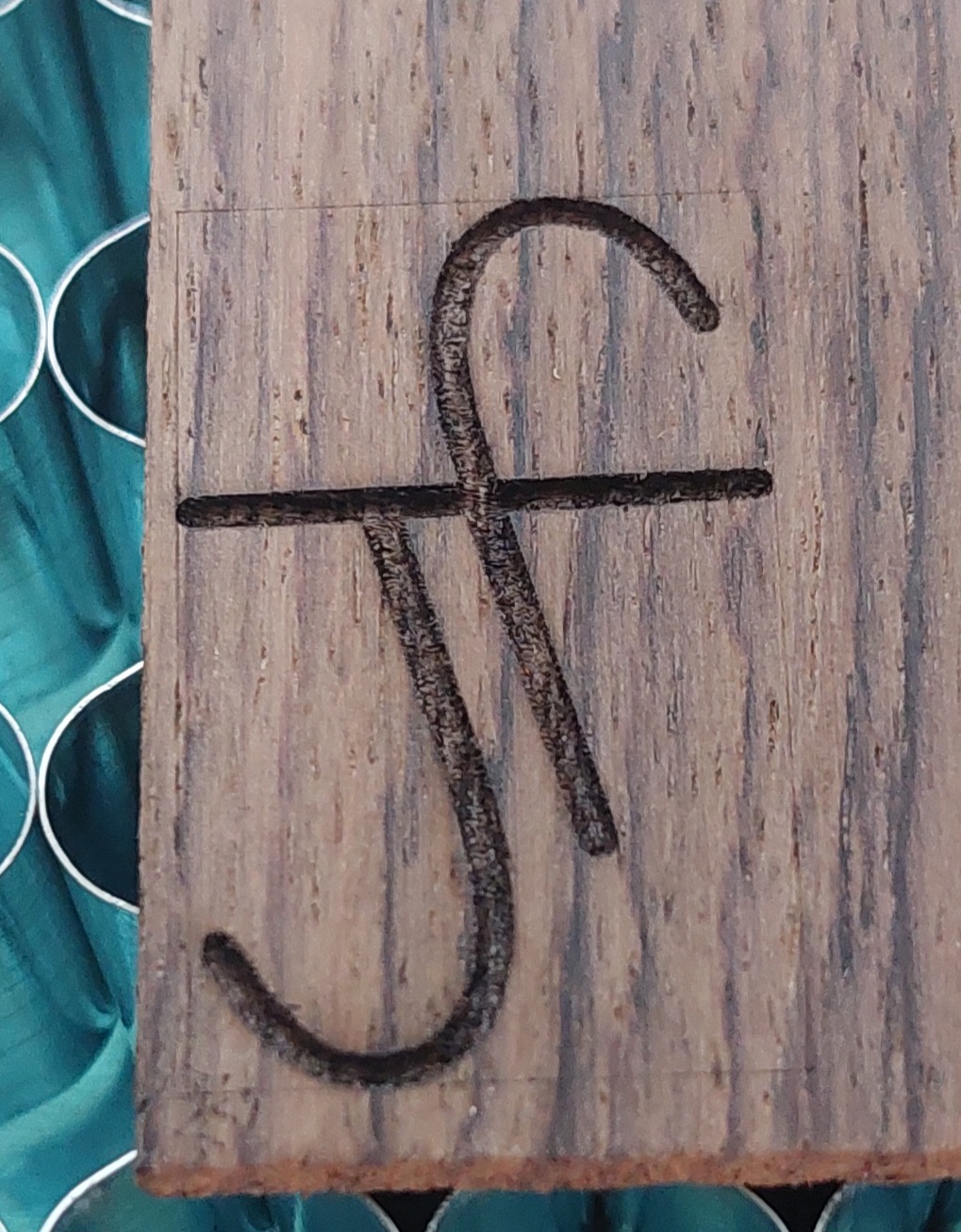

Re: Laser engravers
Patience pays off.
Max 33% dynamic power, 6 passes. Then use a fine tip tool to clean the engraved area out a bit. No heat/burn damage to the surface of the wood and ~0.5mm deep.

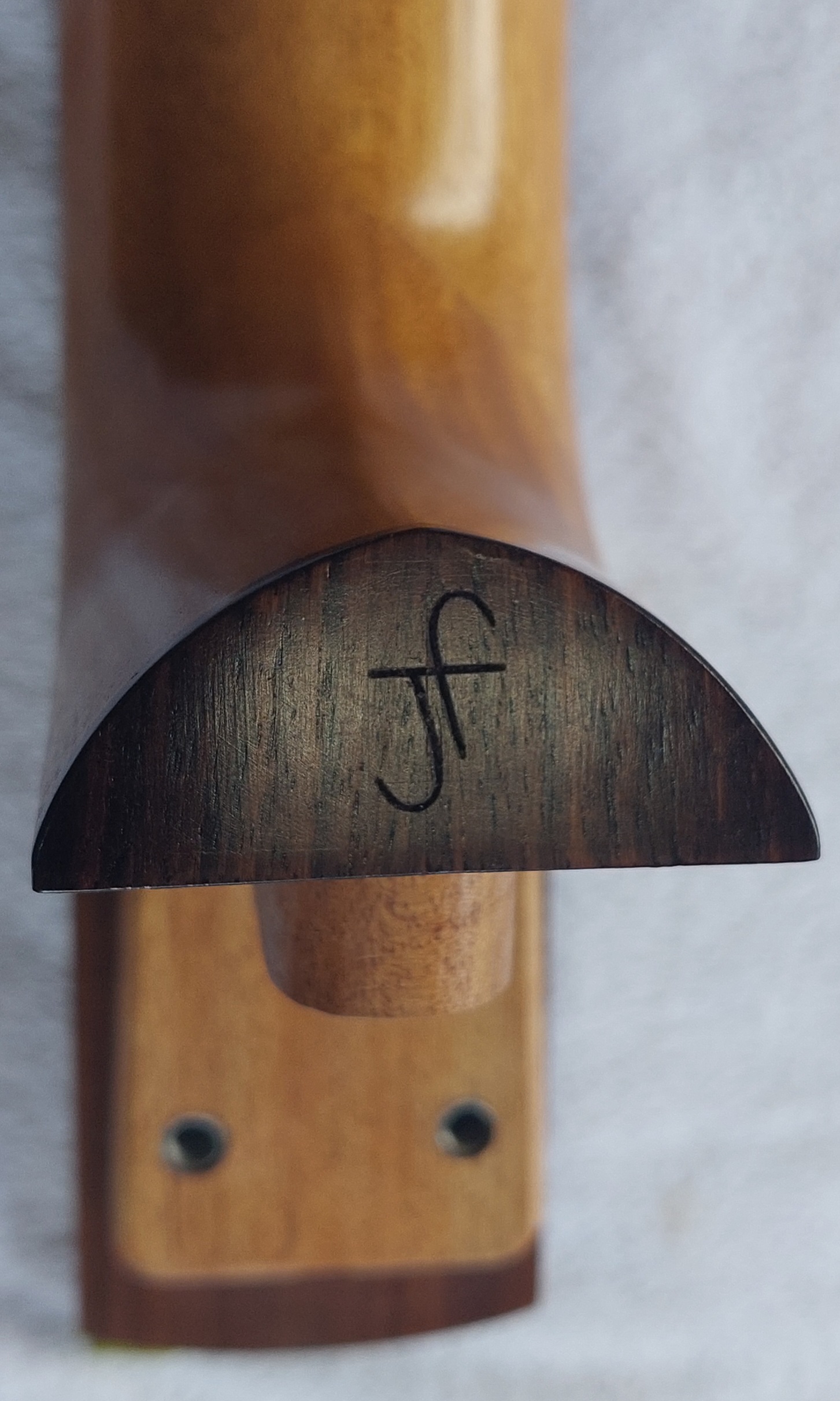

Re: Laser engravers
Ready for filling, sanding, and finishing. Thought a small version on the heel cap would be cool.
