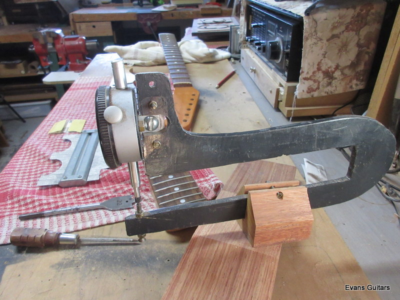

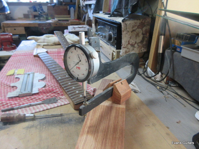

Hi, Here is a photo of the tool I made back in the early 1980s I cut the steel out of an old army vehicle and it works fine.
I have a list of 210 tools and jigs that I made in the shop and not bought.
Cheers Taff

Jezuz Taff.....that caliper gauge is built like a brick shit house! reminds me of my Dads first car....a bright blue Morris Oxford. That car was so solid you could drive it flat tack into a brick wall...and the wall would fall down.
