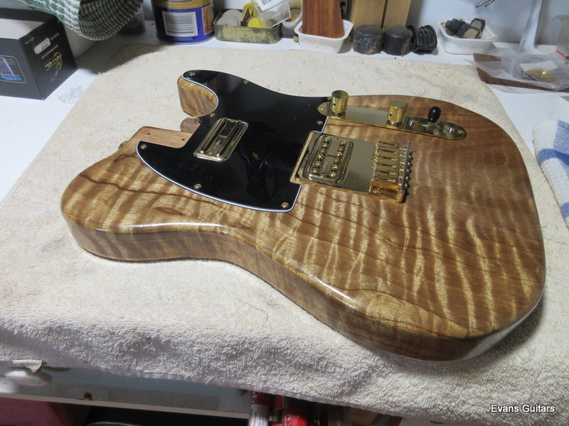

Re: Pore fill question
Hi, Yes, I have nearly finished a build using Aqua Coat wood grain filler. The photo shows the finished job. It worked well. That's new Guinee Rosewood and it took a lot of filling.
Cheers TaffTaff
Lovely work Taffy, I've never seen flamed NGR.
