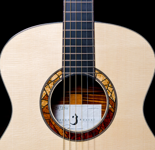

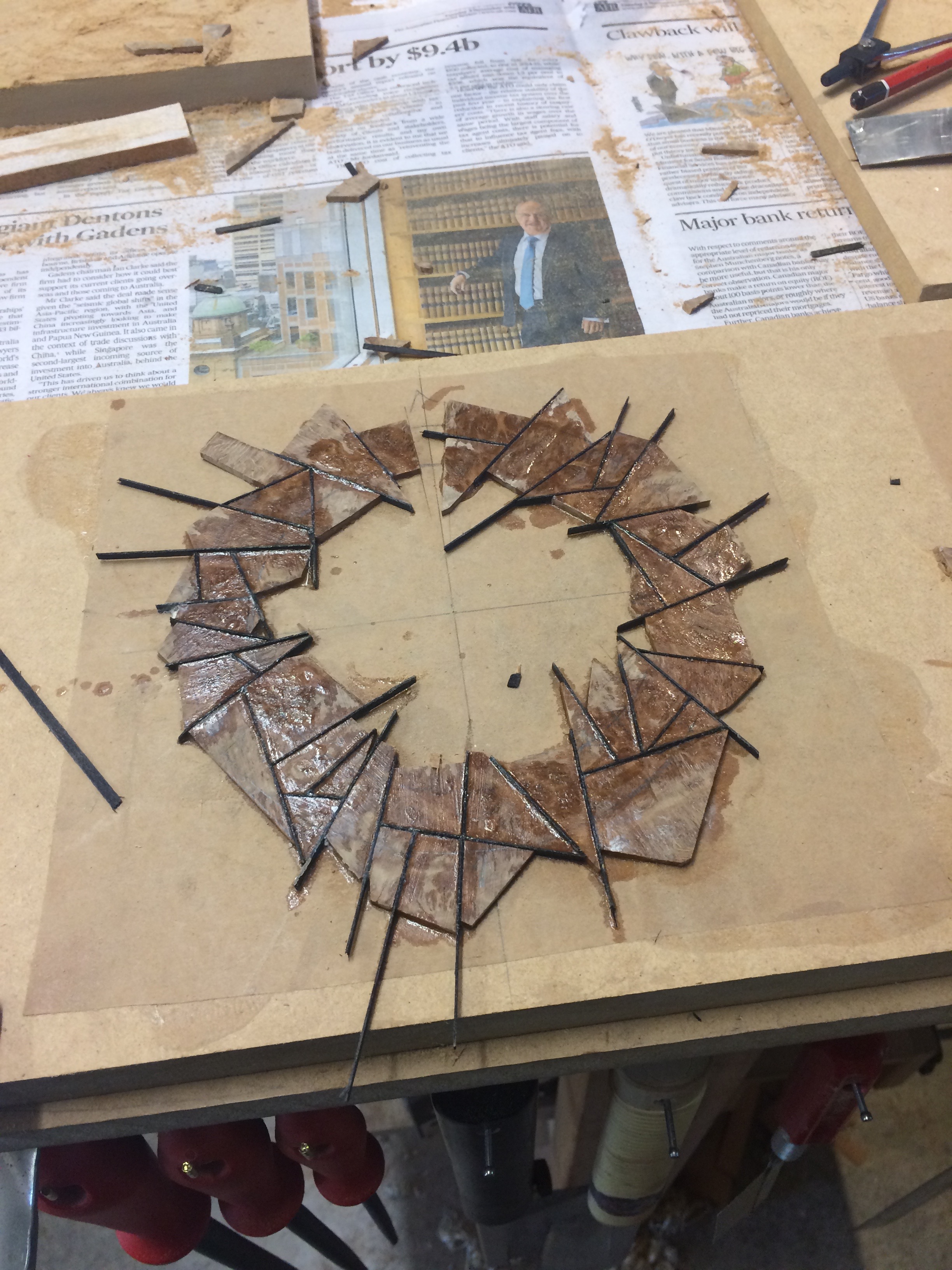

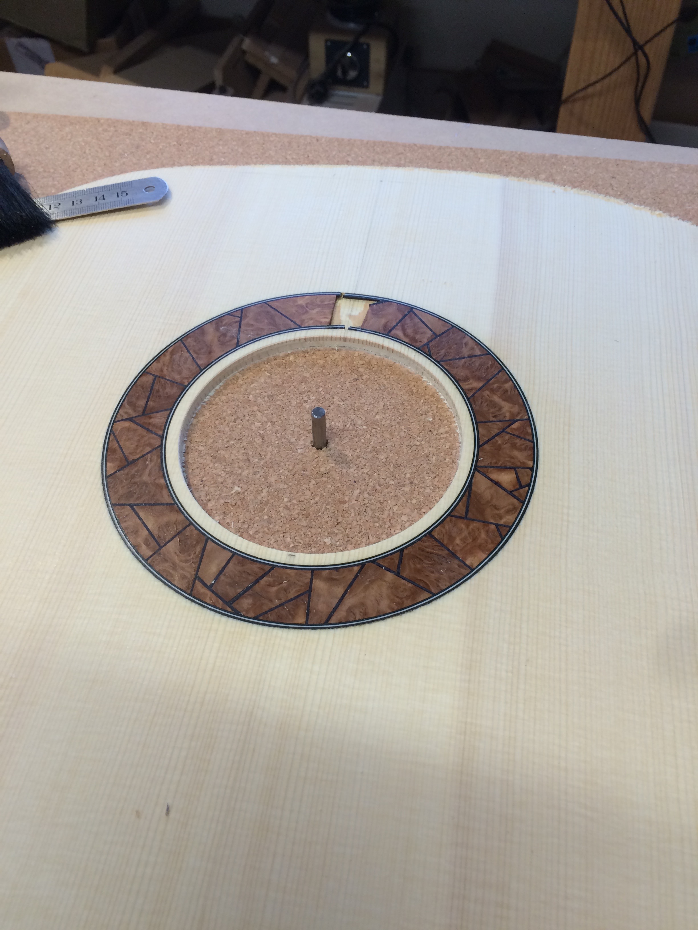

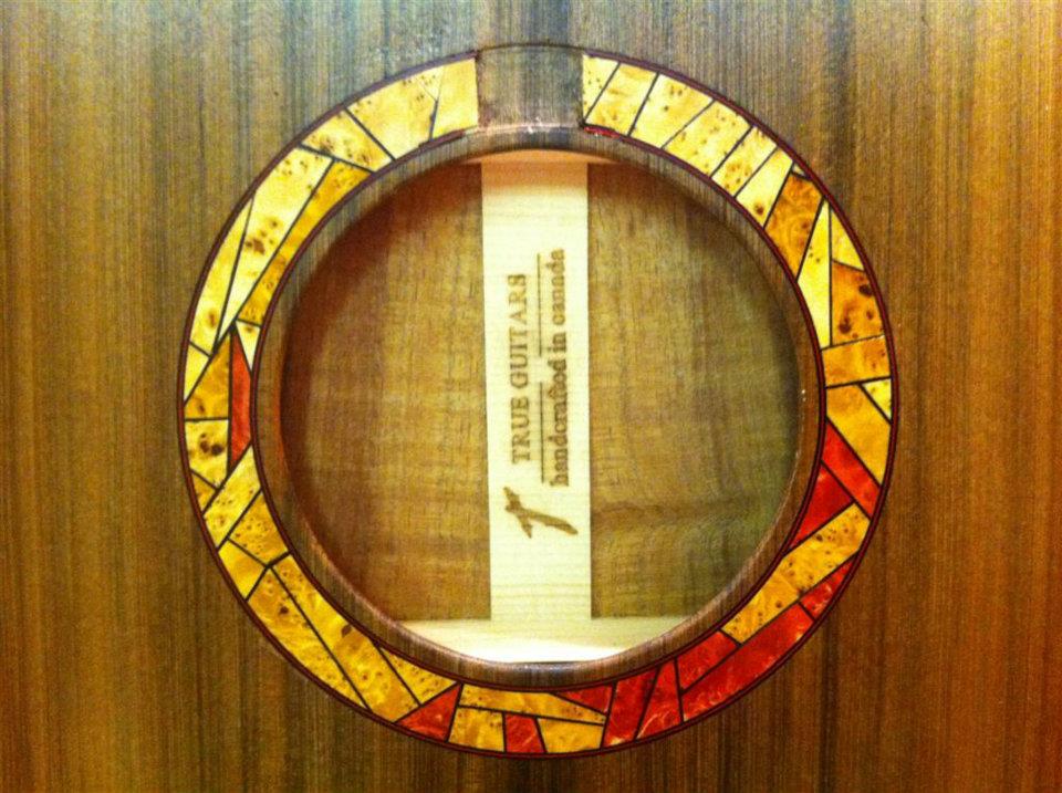

One design that I have liked making is based on the "stained glass" rosettes that Jason Kostal often does. It is a bit time consuming, but not difficult . Looks like this (versions by JK, Rod True, and one of mine below) - you can come up with lots of variations. Just glue strips or blocks together in a mosaic and place accent strips between each one. I glue up a square mosaic on a flat board (a cheap plastic cutting board; glue doesn't stick to it) and then sand it flat and cut out a rosette using a circle cutter. Jason Kostal uses a light coloured timber like maple and stains them a variety of colours before making the mosaic. Mine was just a bunch of different timbers from the scraps drawer:
It is true that using a really thin veneer for a rosette is a challenge because you are likely to sand through it as you try to level it after inlaying in the soundboard. You could glue a number of layers of the same veneer together to make a thicker piece. Or glue a single thin sheet on a backing substrate and then inlay it slightly below the level of the soundboard and carefully sand the soundboard down to it.

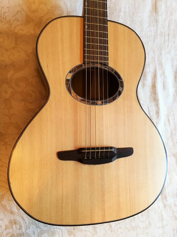

Nice Kostal inspired rosettes there Mark.
I did a similar rosette on a build I did for late ANZLF member Kym Bell. The wood is thin pieces of a Coobah burl and between them is black purfling.
