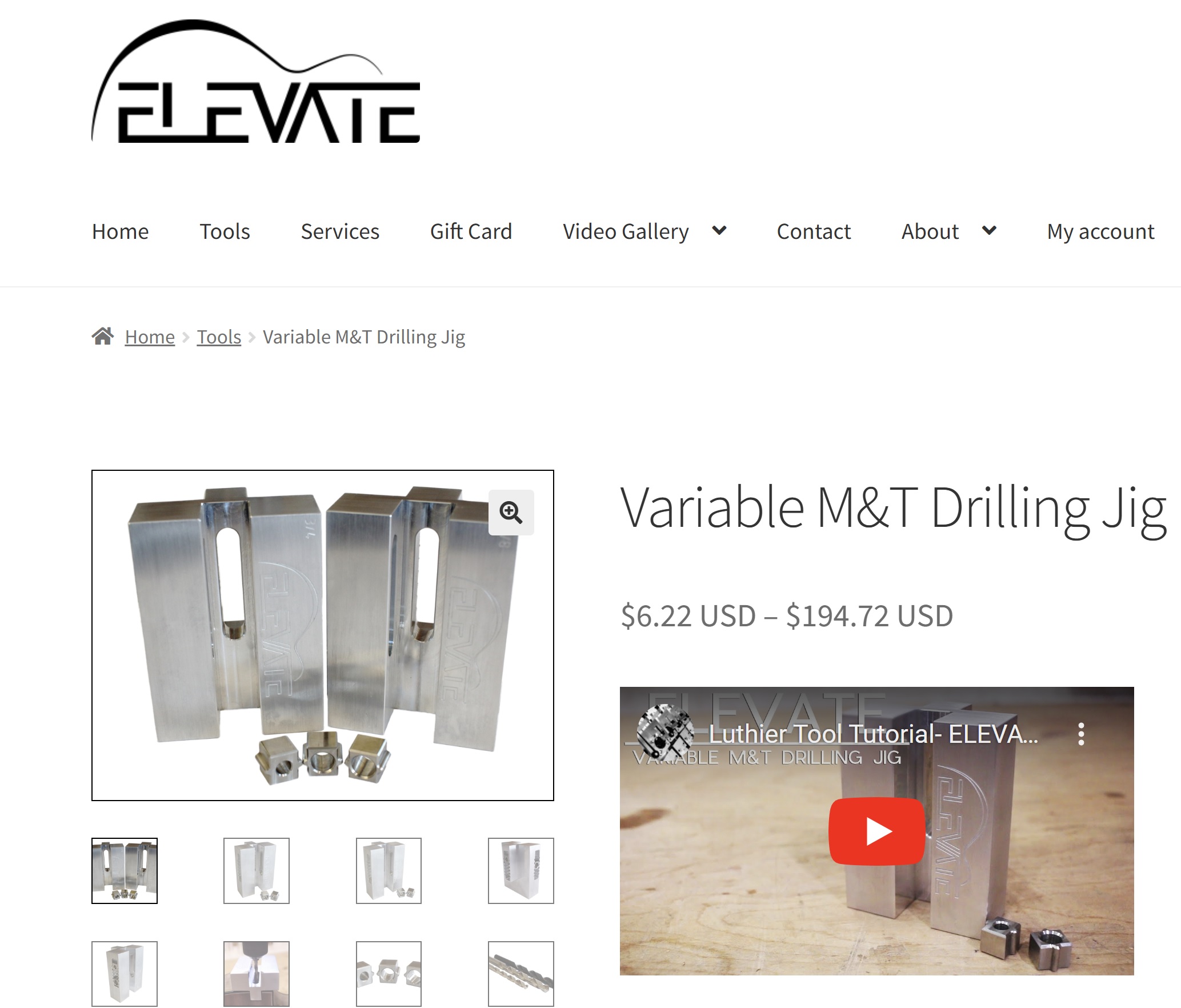

Another jig option that is costly from 'Elevate Luthier' is also very good. See link and photo below.
https://elevatelutherie.com/product/variable-mt/

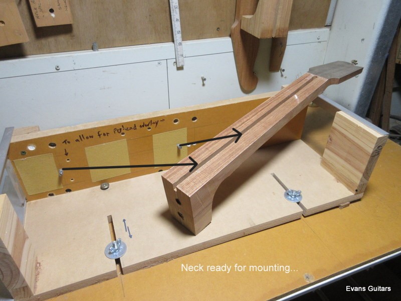

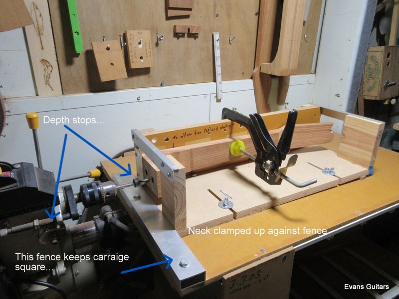

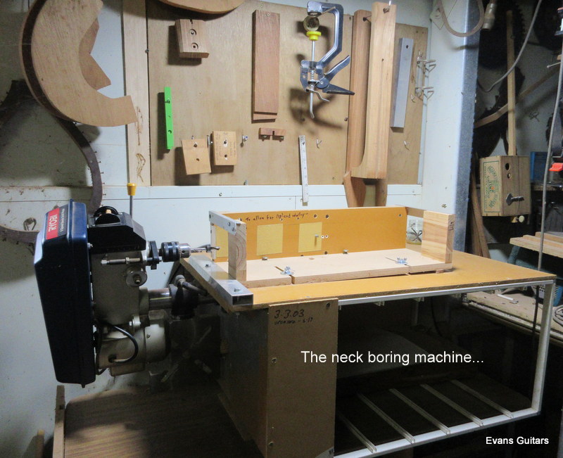

Post by Taffy Evans » Fri Dec 13, 2024 8:40 am

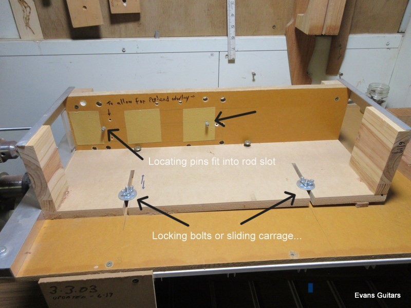

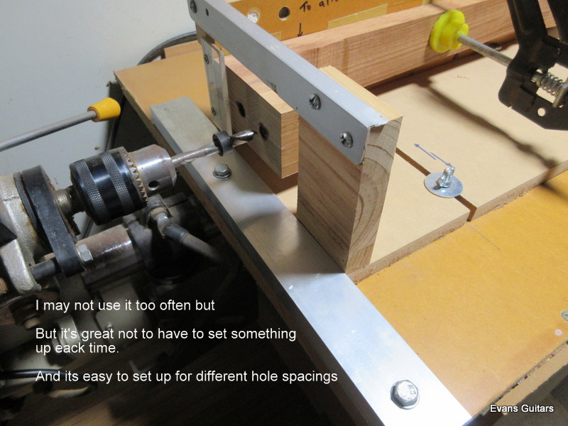

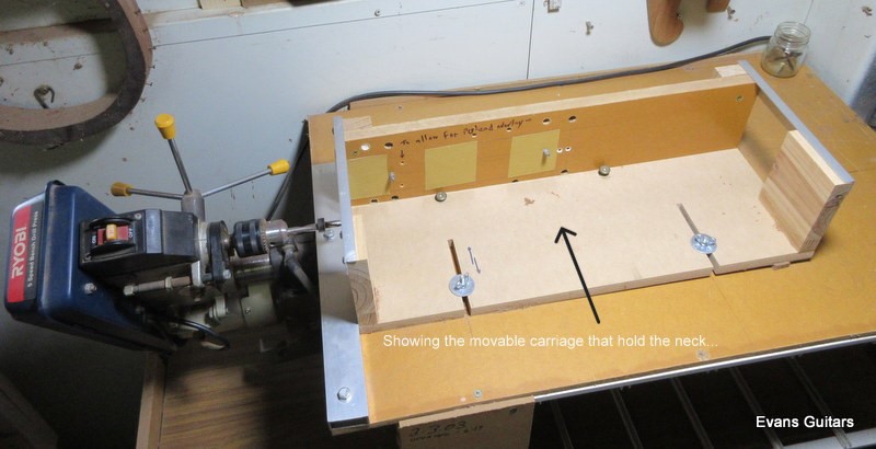

Hi, this unit has served me for 20-odd years, although it is mark 3. As a repairer and builder, I sometimes have to convert different brands of necks from different guitars to a bolt-on system. This jig allows me the flexibility to do this. It will also accommodate other instrument necks.
The jig is made from "found" materials, but I bought the drill press new, which I thought was an expensive way to go at the time. However, seeing the cost of the jigs shown here, I'm well in front.
I have room for it, it works, so no need to change it.

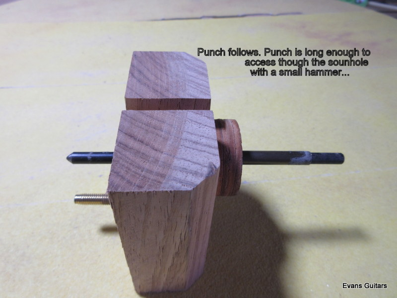

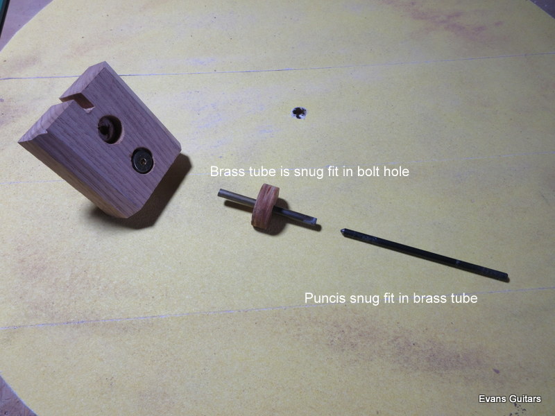

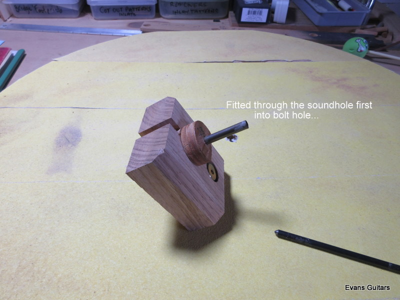

Post by Taffy Evans » Fri Dec 13, 2024 9:05 am
Hi again, here is my method for transferring the bolt-hole positions onto the heal. Pretty much as mentioned above.

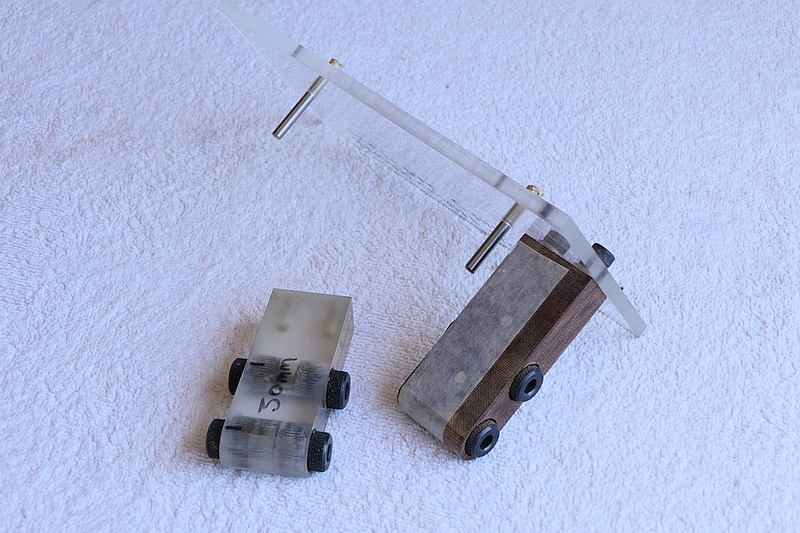

You can make a jig up using drill bushings (and it looks like Nigel did exactly that).
The screw-in drill guide bushings came from Lee Valley Tools:
https://www.leevalley.com/en-gb/search# ... Results=25
One is made of Tufnol, the other Perspex, but wood works too. The "built up" one is 25mm between centers, the other is 30mm. However you make this jig, be careful to make sure everything is square and the bores are parallel. As per the book, you can use it for both the body and neck drillings.

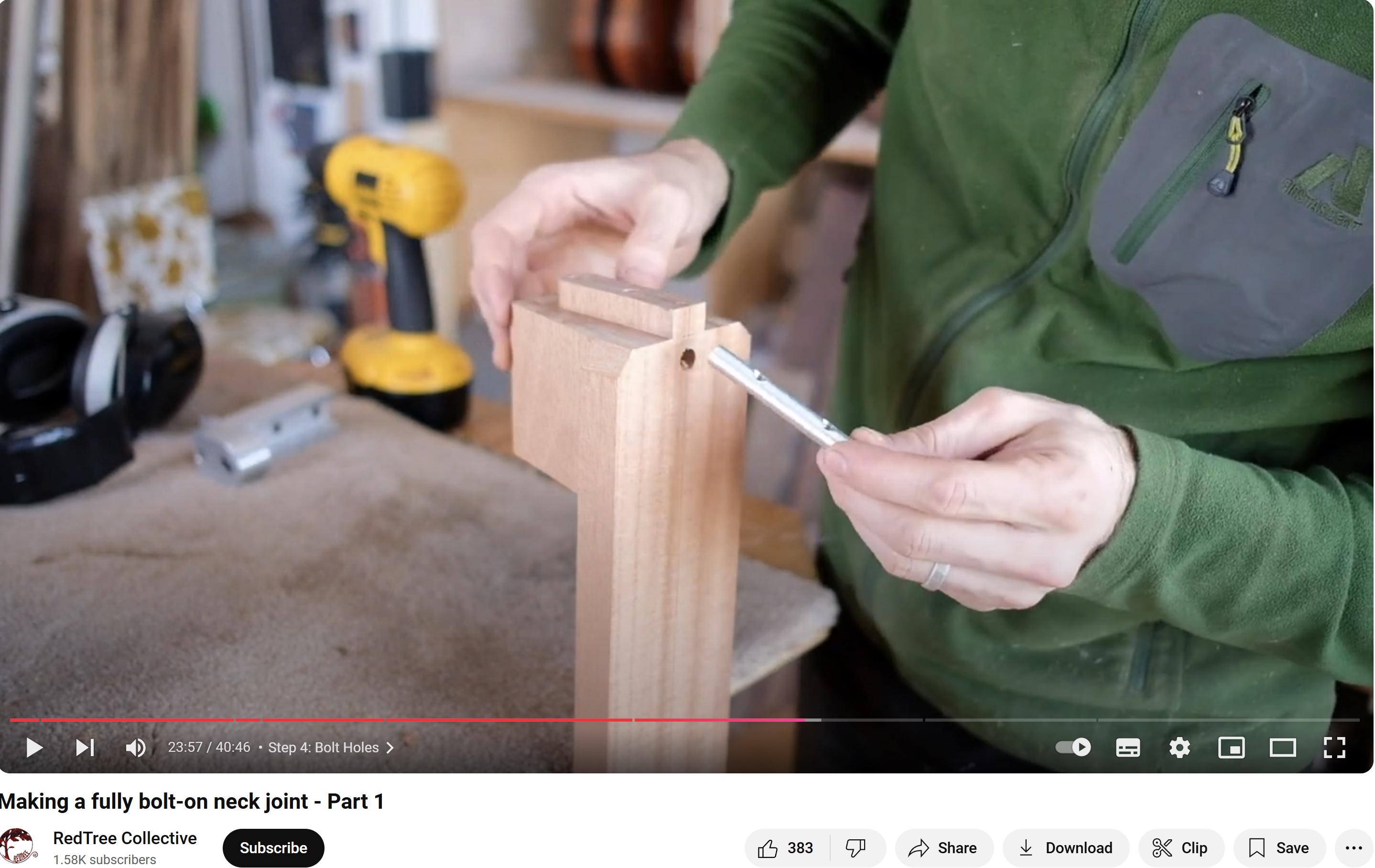

Post by WJ Guitars » Sun Dec 15, 2024 3:36 pm
Here is another alternative option if you don't want to use barrels similar to the square bar in Trevor' design except that it is a round bar insert into the heel. See Youtube link and photo. The video by 'RedTree' includes his method of installation of a round cylinder bar. This video also includes a similar method of construction for a bolt on neck joint and drilling the bolt on holes using a machined jig that is similar to the 'Elevate' jig system mentioned in this posting.
https://www.youtube.com/watch?v=D_RHgngGWMk
