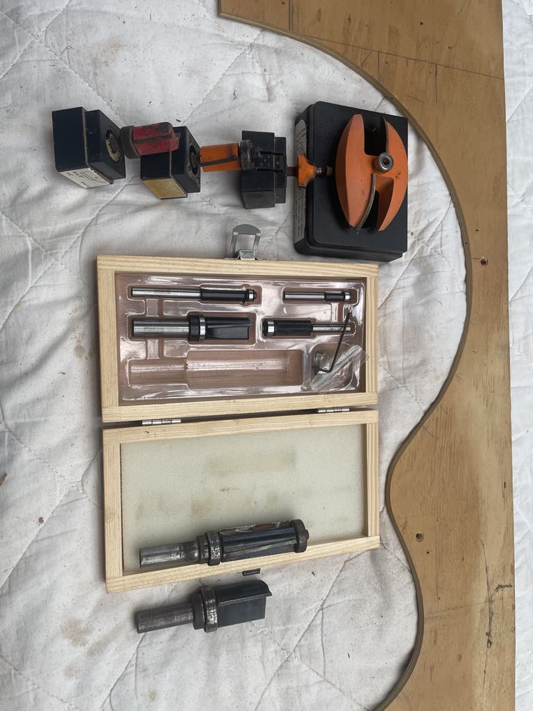

Re: Router bits
Johnny
here is a collection of bits the Orange are cmt bits available from carbatec and the box set are torquata from Timbecon the bit with top and bottom bearing is a triple fluted bit that has a slight spiral and if you are going to rout from templates this is the bit that I would use and from my experience works very well.The third bit I bought direct from carbitool an australian manufacture and have used this bit to rout moulds from templates as pictured, remember that you don't want rout more than 2mm otherwise you will have problems always go against the direction of the cutter, some people do climb cutting with routers this can be very dangerous Iv'e seen a person put a piece of wood into a table router the wrong way and its grabbed the work piece and thrown it twenty metres and almost got there hand so be very careful all power tools are noisy and create lots of dust
Hope this is helpful
Regards Tapslider
Regards Tapslider

Thanks for all the info, picture references and advice.tapslider wrote: ↑Wed Jan 29, 2025 3:36 pmJohnny
Regards Tapslider
I'm very grateful.
