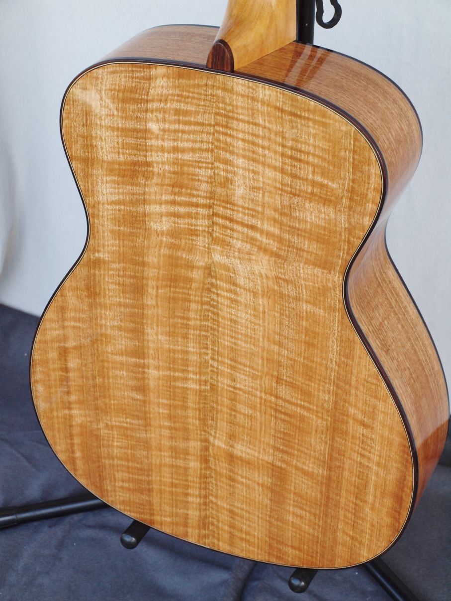

I have seen some nice guitars with spectacular back and sides as you can get some sets with great figure.

I would not use it as a soundboard but have used it for back and sides on guitars and recently an octave mandolin. No idea what species it is, I just kept sniffing around at Bunnings until a nice piece appeared. Nothing wrong with it, it makes nice instruments.

The only real comparisons I have done was with some mandolins I made with Tassie Oak back and sides. With Carpathian Spruce tops, comparing with European Maple and Tassie Myrtle backs, also with Carpathian Spruce tops. The Maple had more clarity, the Myrtle was warmer with less clarity, the Tassie Oak was smack bang in between. So, good clarity, with some warmth, a good compromise. The recent OM has more warmth than a Blackwood OM I made at the same time, less bright but still with good clarity so agrees with the mandolins. I would say it is middle of the road, has everything in moderation, so is nicely balanced. If you are aiming for a big bass or strong treble then it is not recommended.What tone did it produce?
