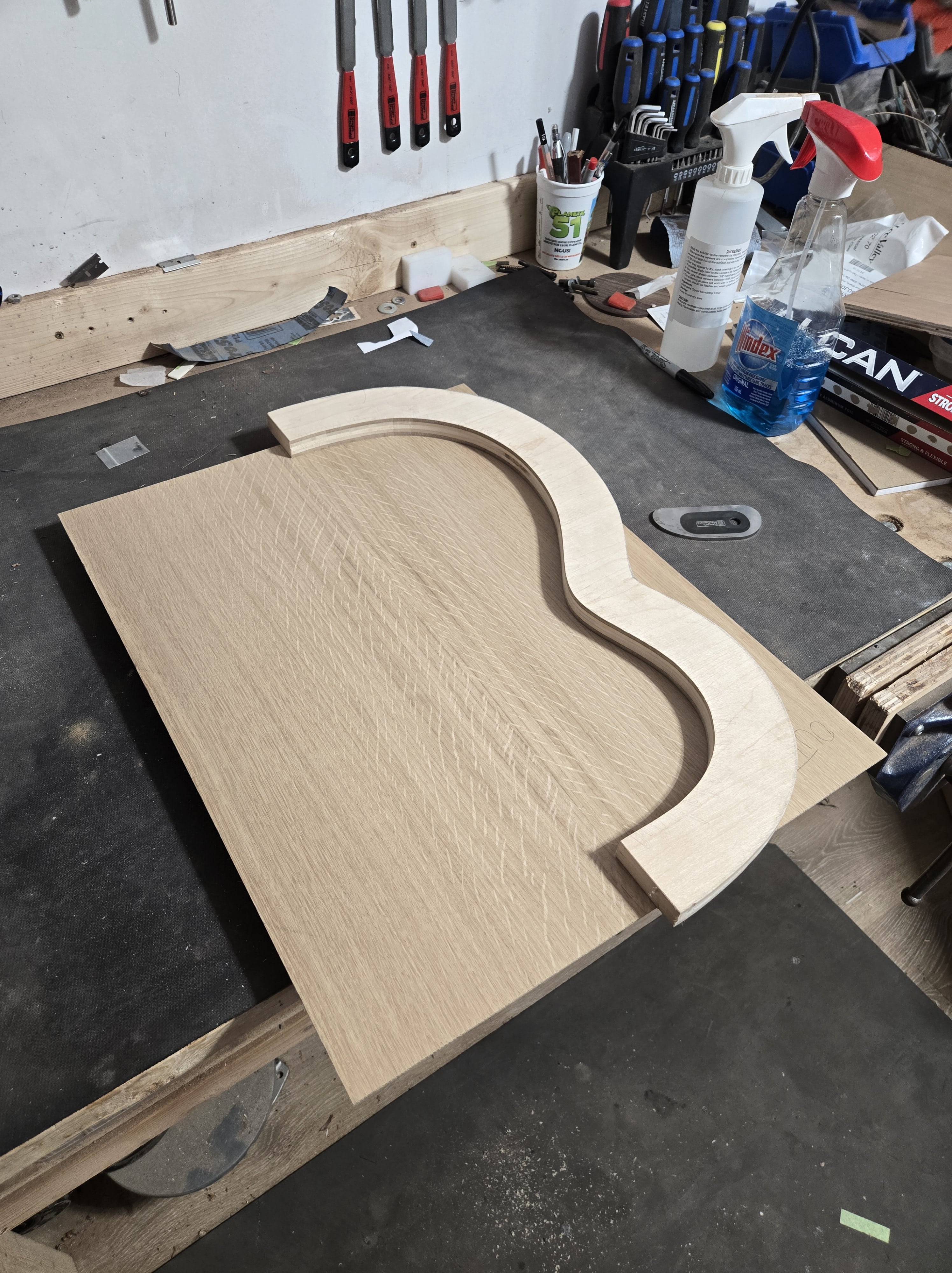

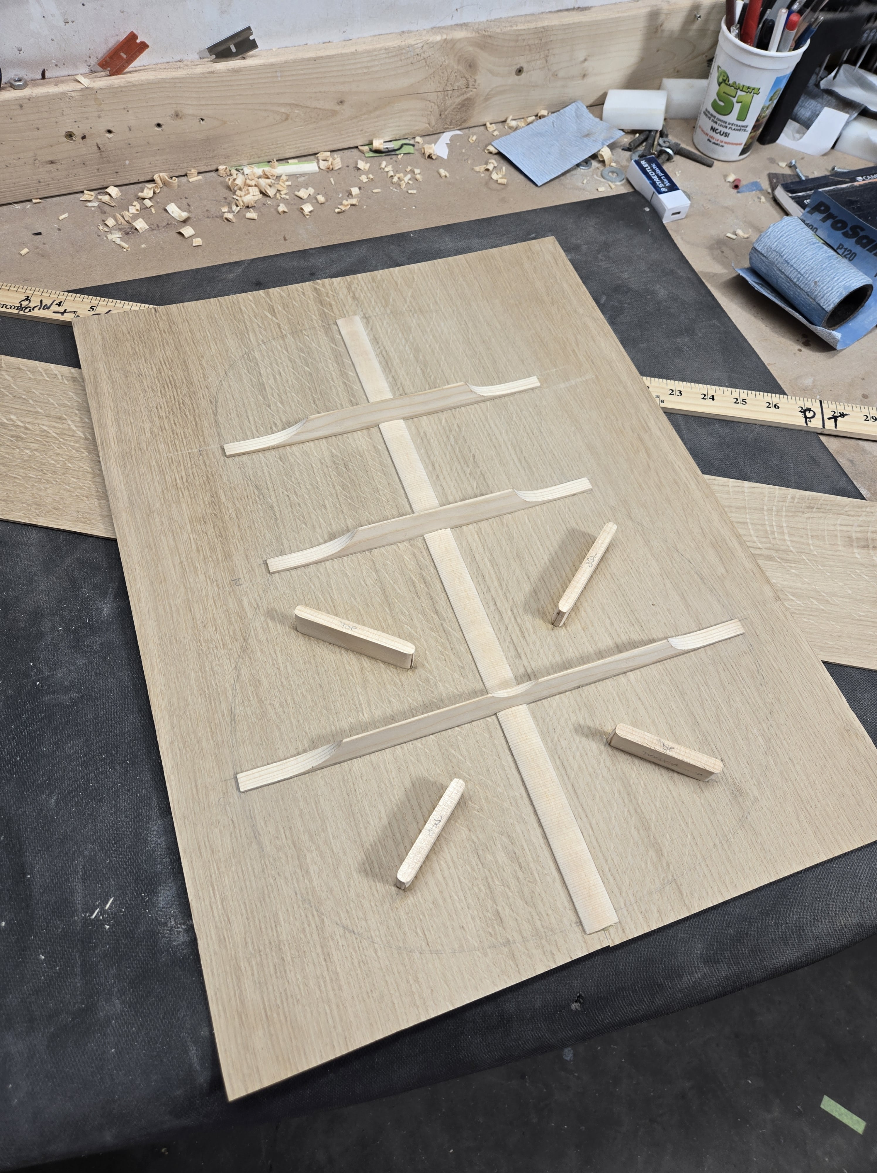

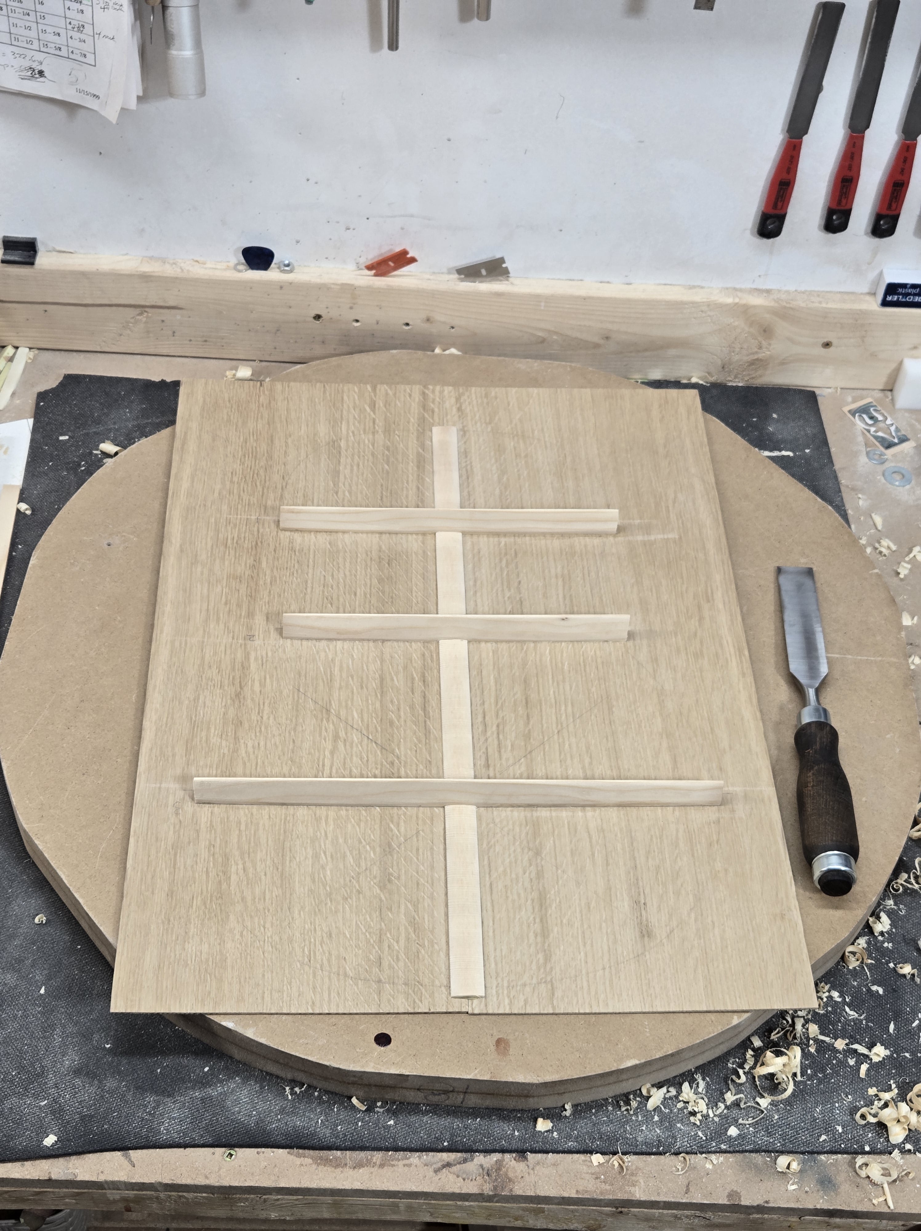

Progress so far. Have to finish shaping the back braces and then moving on momentarily. Sides bent last weekend (this oak bends so easily, btw). Will be doing laminated kerfing so that'll be next.

One question....you've glued in back braces with the back not trimmed to side outline? Is there a reason for this?
I ask because shaping bracing to fit the dish radius is a bit tricky without trimming to final back shape.
Re: Parlour Guitar - first "contemporary" build
I radiused all of the braces beforehand - I have a jig for this (I think similar to the one shown in the books, IIRC). Everything glued up in the radius dish with go-bar deck.I ask because shaping bracing to fit the dish radius is a bit tricky without trimming to final back shape.
This is a good question - I wish I had a better answer than just that's the way I learned itOne question....you've glued in back braces with the back not trimmed to side outline? Is there a reason for this?
Am I missing something?
Braces cut to approximate length, then radiused, then glued to top in dish.

I am like Martin and cut the back into a “guitar shape” before starting to do the bracing. However, I can’t see any problem with the way that you do it as long as it still conforms to the radius that you intend. White oak looks very pretty. Is it heavy?

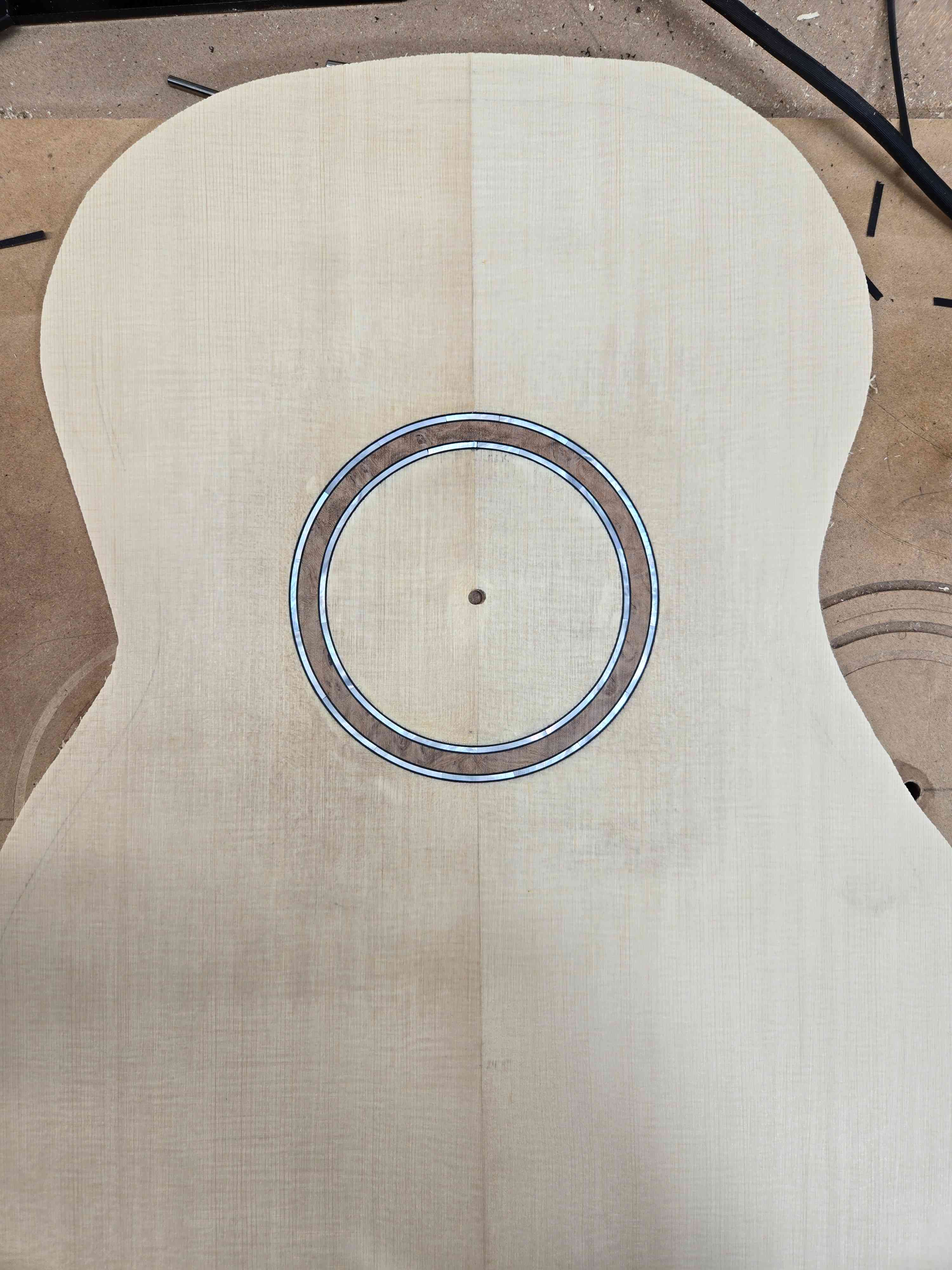

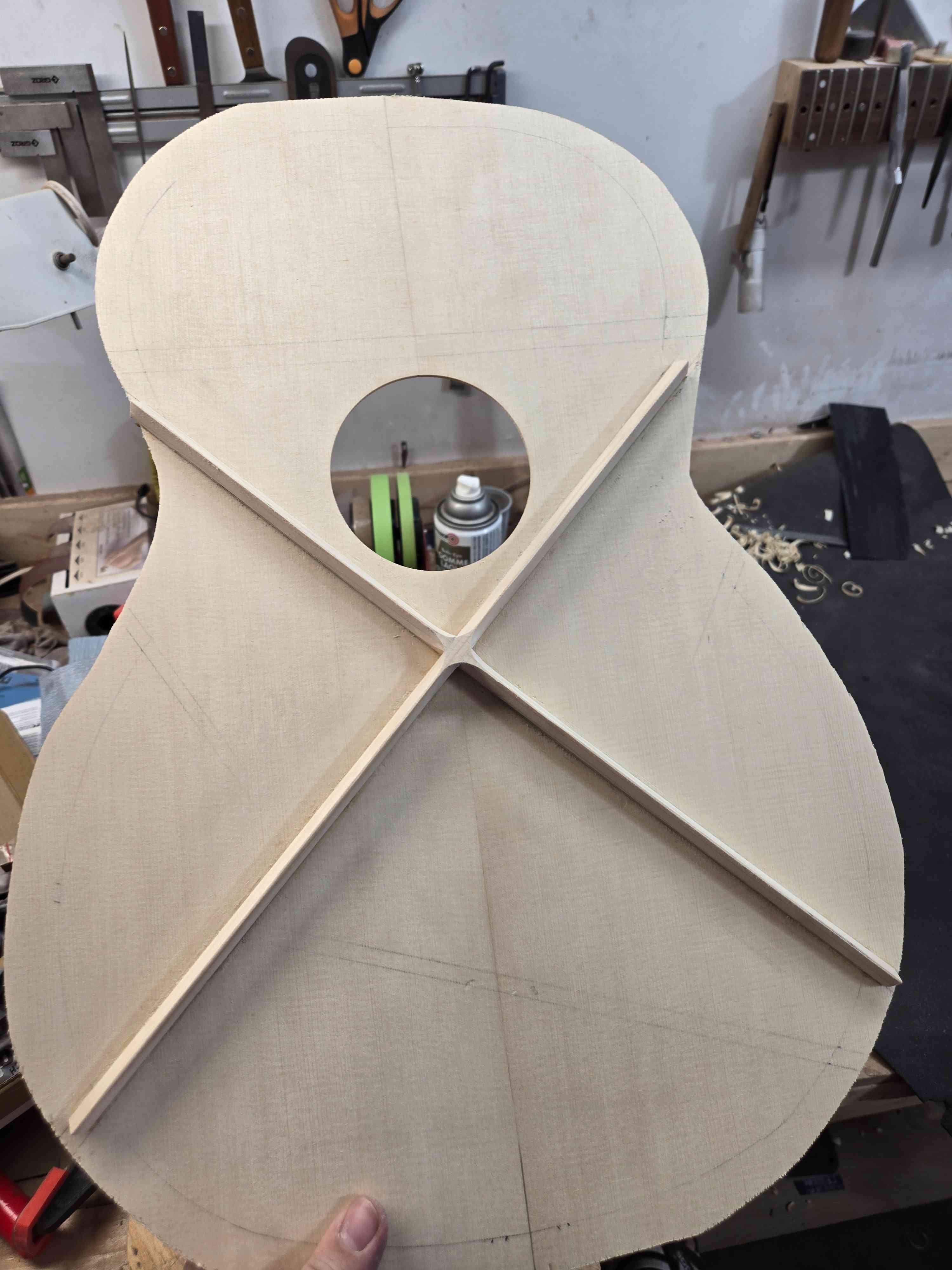

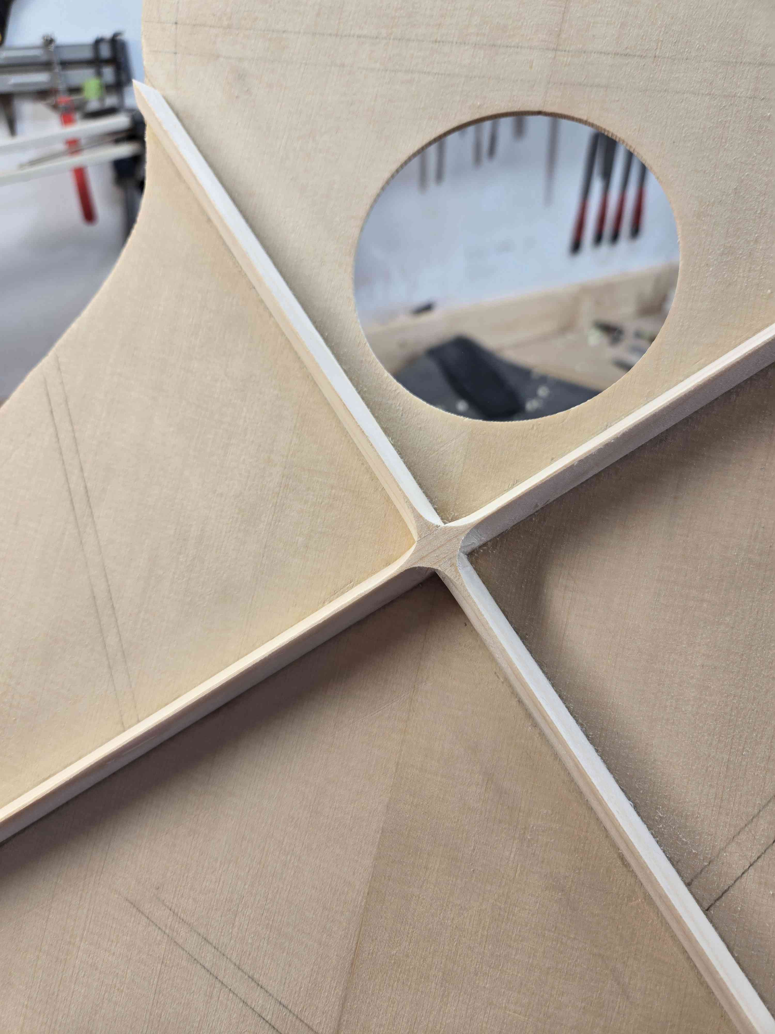

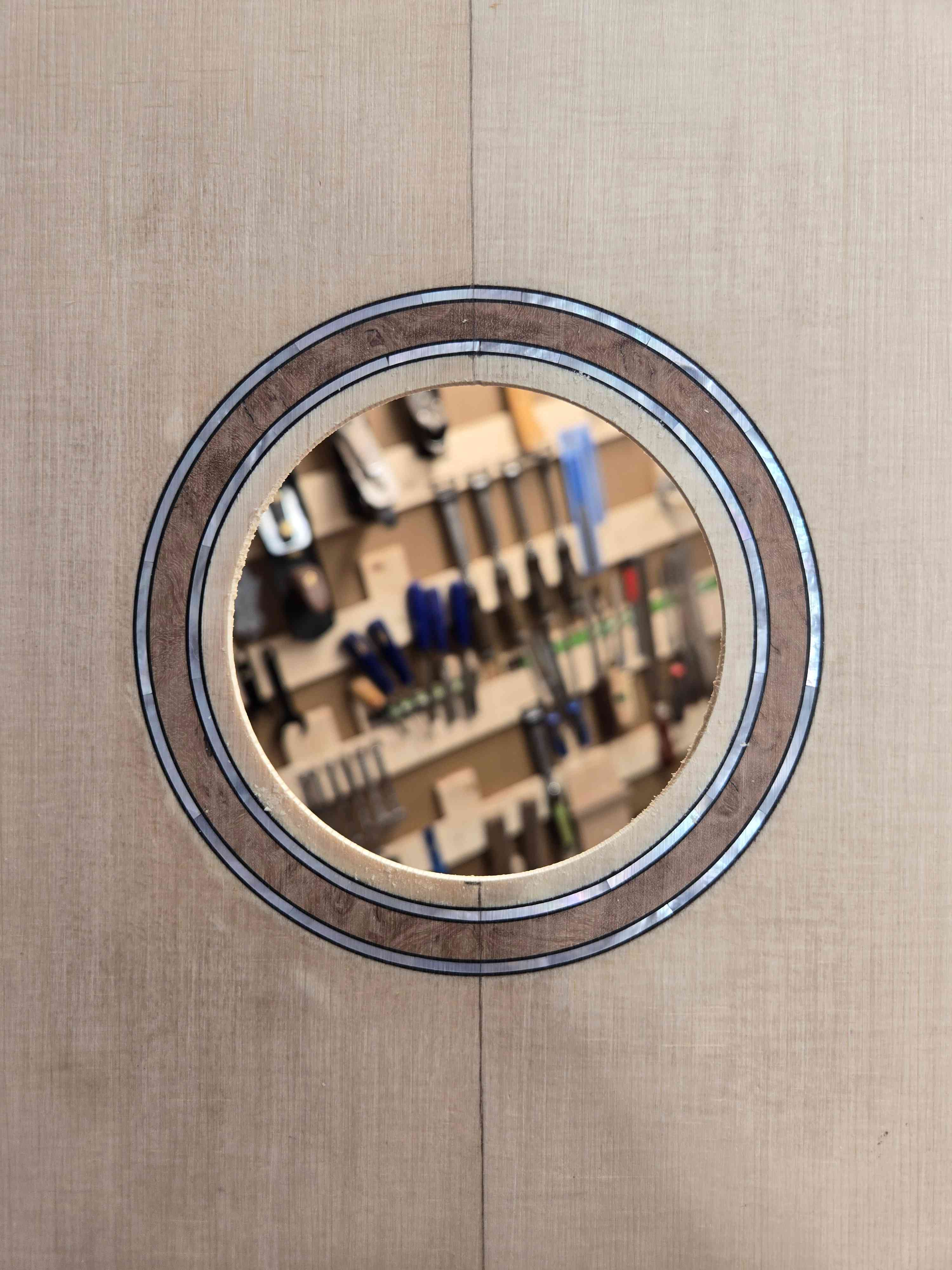

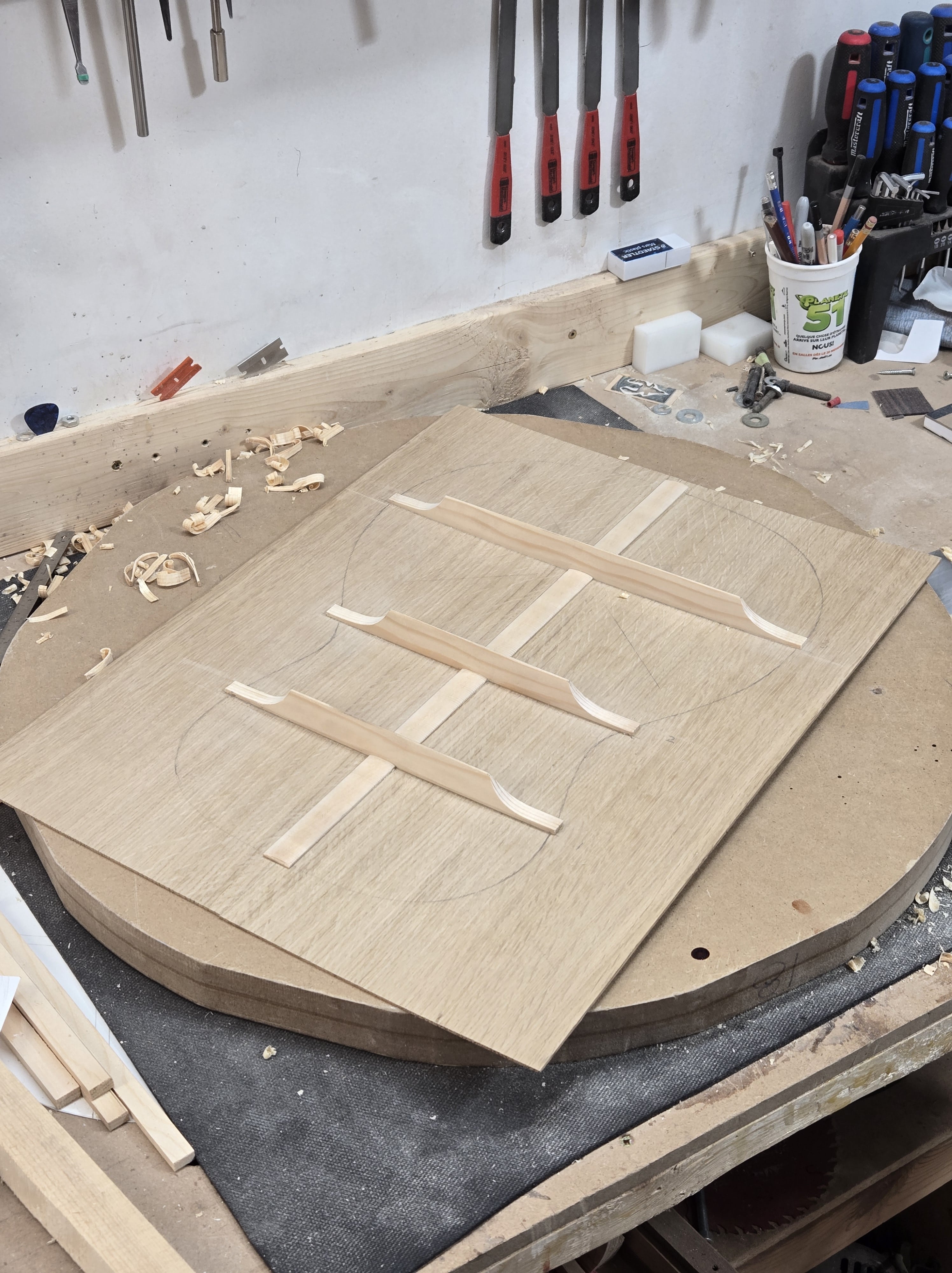

Bit of progress made last weekend. Glued and carved the X-brace and made the rosette. Finger braces/tone bars/whathaveyou glued up.

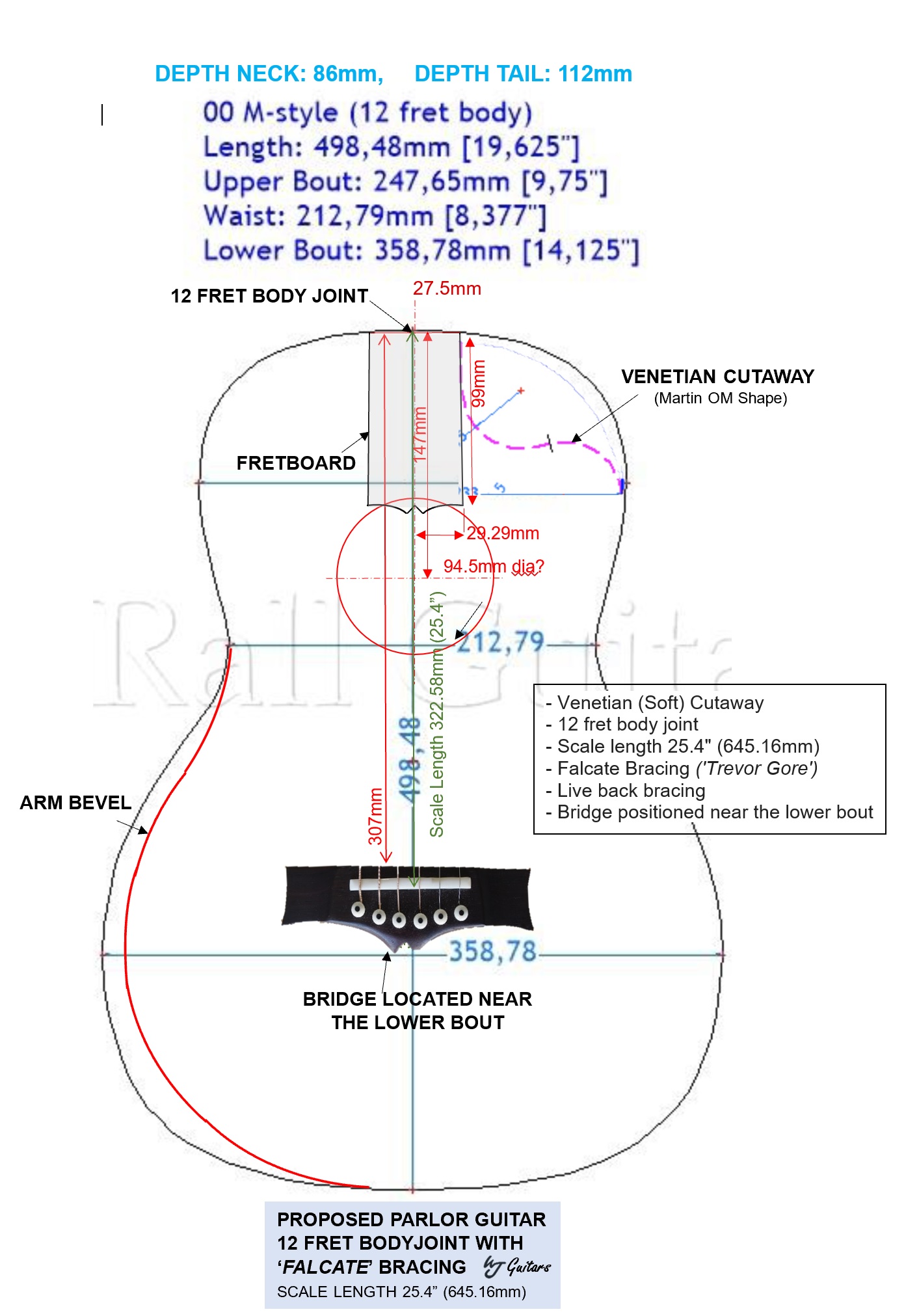

Its early days for me being my first Parlor Guitar build. The body size that I am using is slightly large than yours and the proposed depth is 112mm at the tail and 86mm at the neck. It will a few more months before I will commence building. I need to make a few more jigs to suit my Parlor guitar build. This will include making some falcate bracing jigs that will work for the Parlor guitar design, plus calculating and making side patterns. See photo below
I will keep an eye on your ongoing posts of your Parlor guitar build progress.

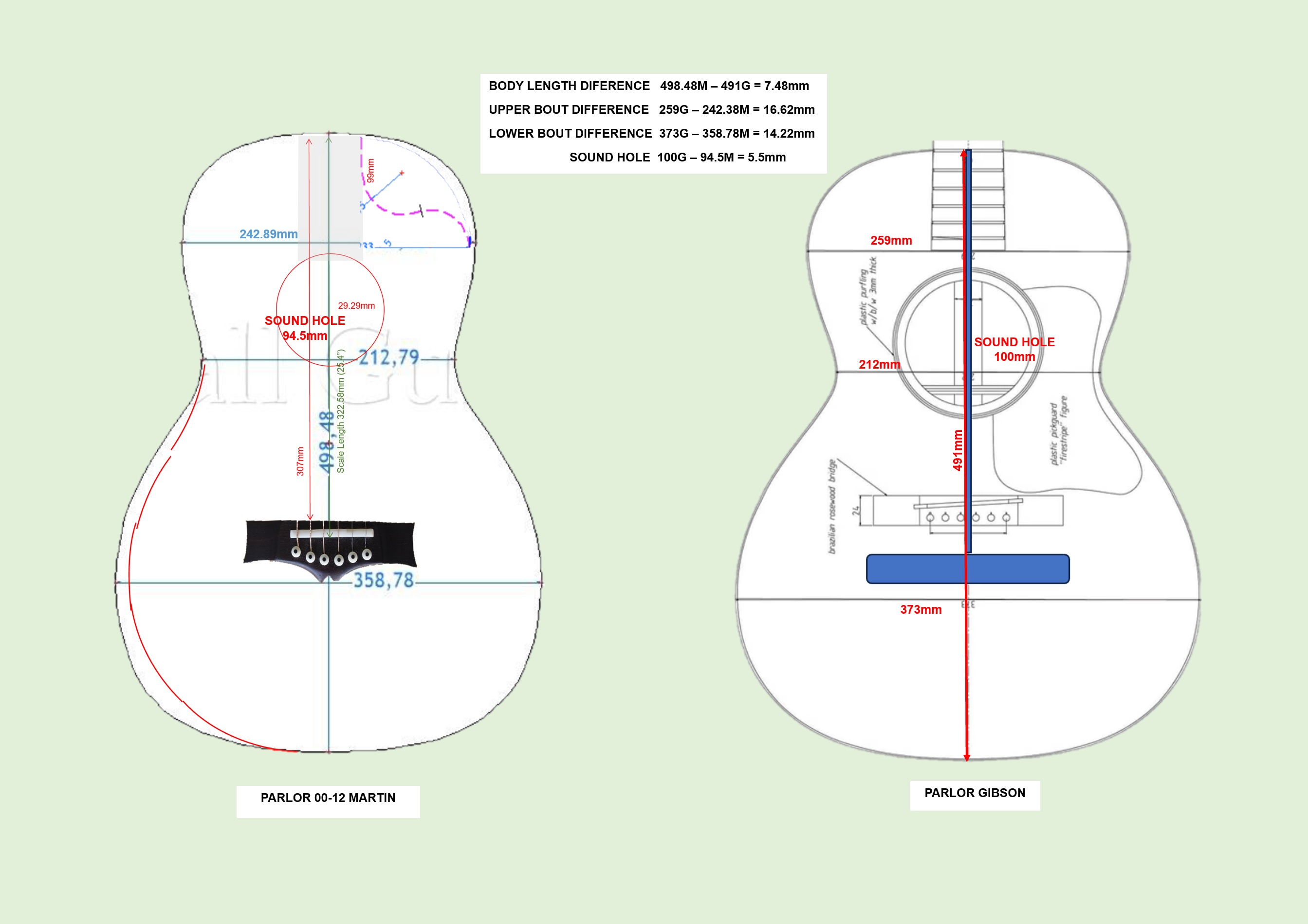

That would great Martin to have this data. I also have the Gibson L00 Plans for comparison with the Martin 00-12 Parlor dimensions

See Photo attachment showing dimension comparison between Parlor Guitar 00-12 Martin and Parlor Guitar Gibson.
