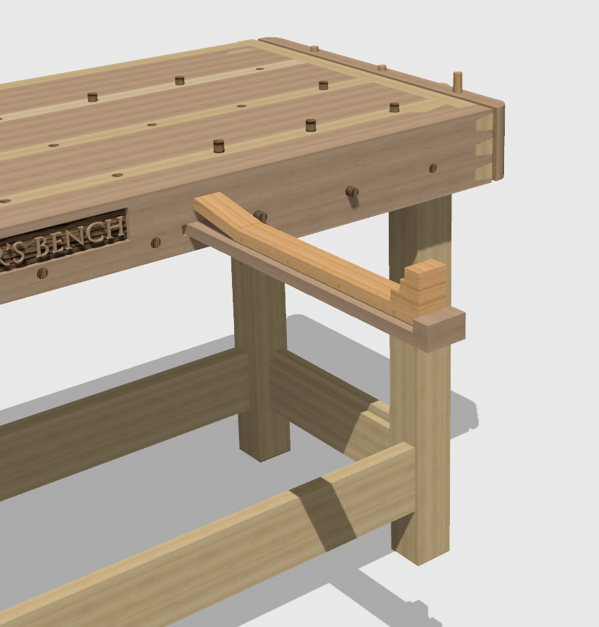

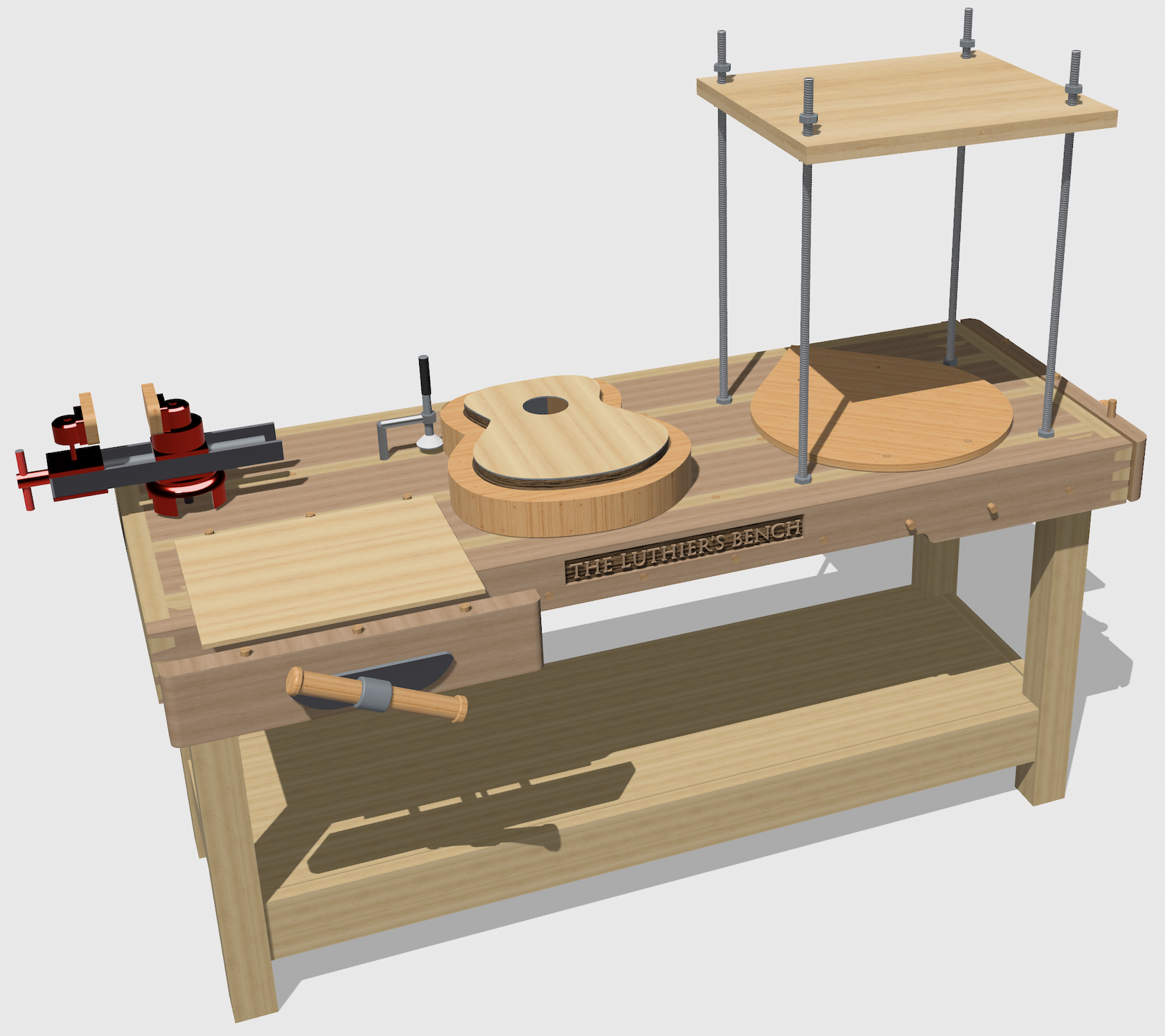

Post by TallDad71 » Mon Mar 03, 2025 6:59 am

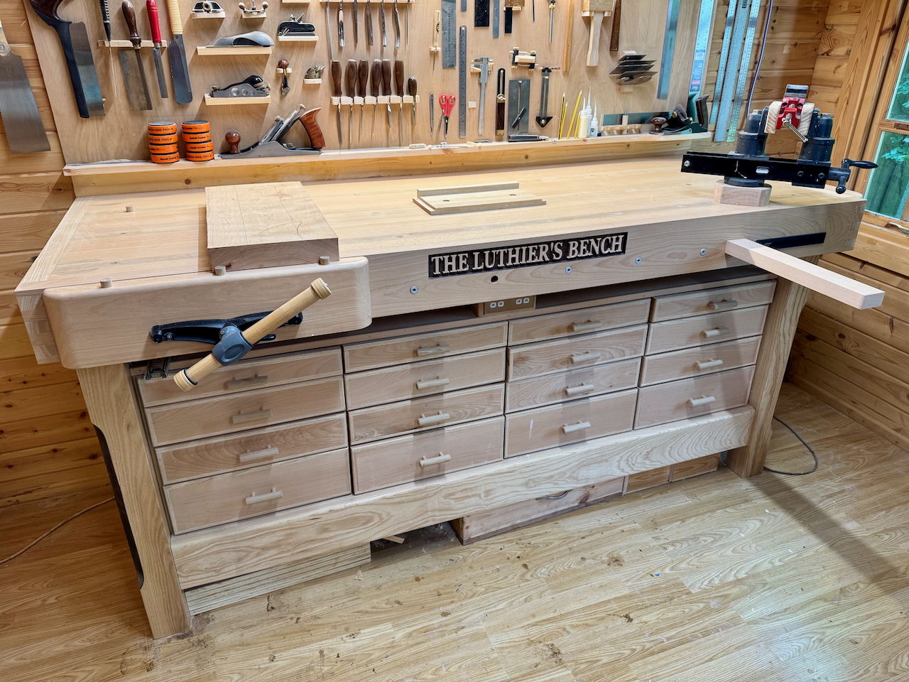

In fact here it is, the timber arrives tomorrow.
So Excited!!!!

Post by Trevor Gore » Mon Mar 03, 2025 9:55 am
In fact here it is, the timber arrives tomorrow....
That looks remarkably like my bench!
Having used mine for ~20 years, here's a few things to consider:
Make both the bench vises double screw (the wide front vise will wrack too much on a single screw). One day, I'll make that change!
Make at least one of the bench vises "wrackable" by design, so you can hold tapered pieces (fret boards and necks) over their full length
The swivel vice does not need to mount to the bench, it can just be mounted onto a large block of wood and be held in one of the bench vises and can be easily mounted elsewhere (using F clamps). I use a Parrot vise which is good for lots of things including nuts, saddles etc..
Arrange the dog holes so you can hold the outside mould using the front vise and dog holes placed about where the swivel vice is (gives three sides access)
If you intend to use the bench for general woodwork too, it is handy to arrange the tail vice so it will pull (via the dog holes) as well as push. But you need to figure out the vise fixings so it will take those pull loads.
If you're going to plane a lot of wood, square dogs work better than round dogs.
It's handy to have power points on the bench legs.
Here are a few random pics:
...looks like that was cut with a coping saw (front vise)...
Tail vise, carving a neck pre BOBO days...
There are lots more pics in the books. Have fun!

Post by TallDad71 » Mon Mar 03, 2025 7:44 pm
That's really interesting what you say regarding the twin vice Trevor.
I had two vices in mind for the front fixing, the twin vice and a quick release single screw model. I went for the latter in the end as it just seemed more convenient to bring the vice out to different depths 100mm for the body height, 5mm for planing edges. I will test it out for racking as it only arrived yesterday. Thank you.
The pattern makers vice is new to me, but already it has proved itself to be a bit of a game changer. Not least because I'm a really tall fella and this vice just bring the work closer to my ever aging eyeballs. That said my new bench is one meter tall so that need is going. I like your suggestion about mounting it on a block, the occasional clamber under the bench to screw it tight will become tiresome.
In terms of square dogs I think I agree. At present all of the 43 dog holes!!! are 19mm round to suit other hardware. All of the dogs are fitted with a spring load underneath so they push up and push to go flush. I chose round as that allow a lot of different angles. Perhaps square would just be more steady. I will have a rethink.
Thanks again for your thoughts.

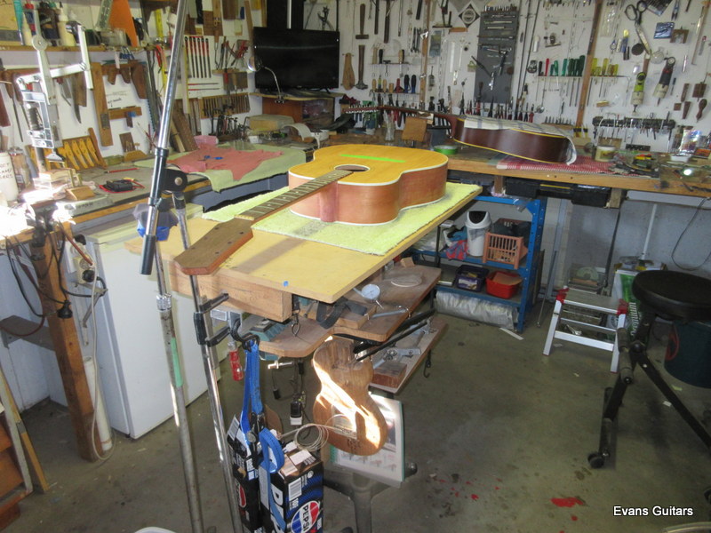

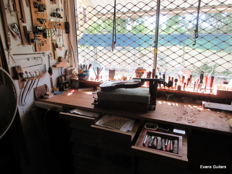

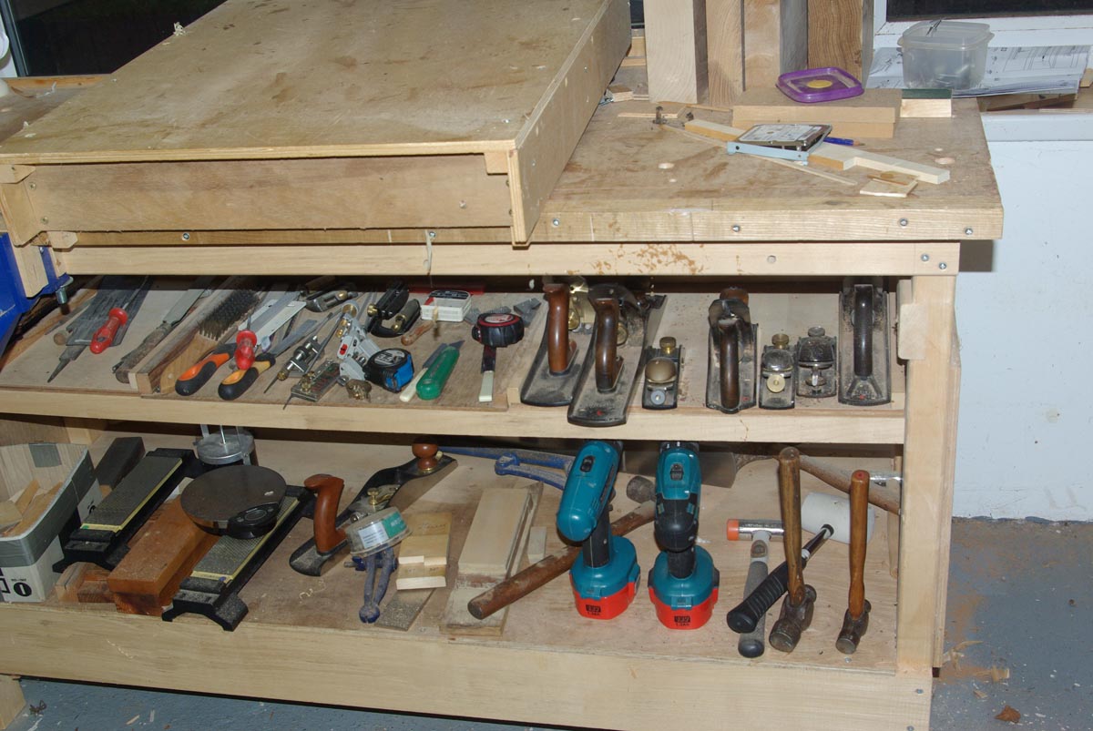

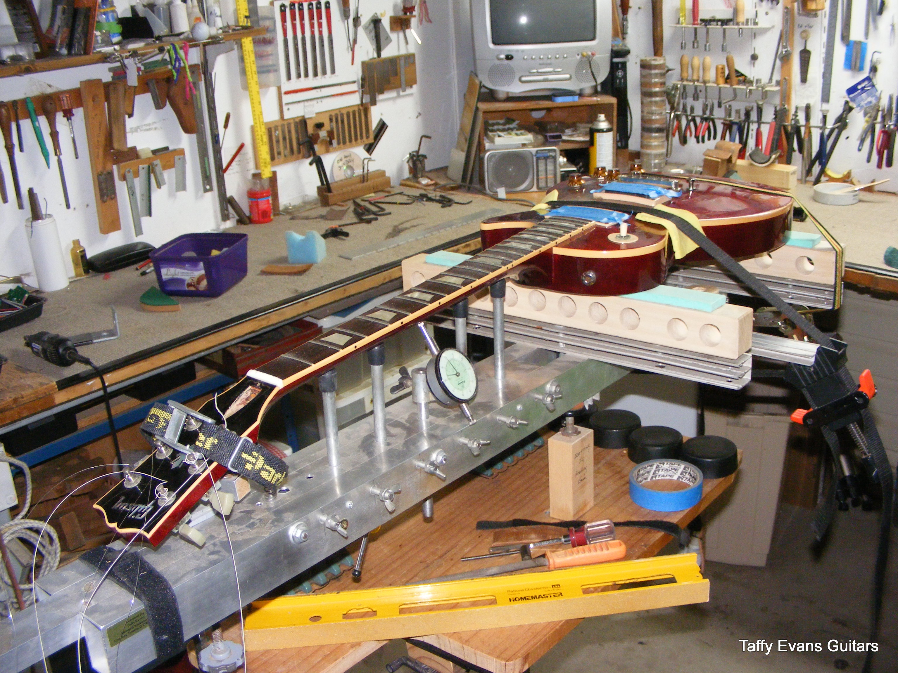

Hi Alan, that’s a very nice looking bench, sturdy too. But I think it would be too small for the way I work. I have too many benches some would say.
I have five in my repair area, four in my building area including a mobile go-bar deck, and one long bench in my machine shop. All of these I have made myself over the years, and I must admit they may not be pretty, but they are very suited to the use I give them.
Having so many benches means having too many tools to, to save walking back and fourth from one workshop to another, but I like tools so that keeps me happy.
I can also assemble two island work tables if needed, these take a variety of jigs, many are at different heights, I rarely work sitting down.
Although It is good to work all around a bench at times, in the repair shop mine are up against a wall with tools along the back of the bench. I place the tool back in its place soon after its used, this keeps the bench tidier.
In the build shop I have a shadow board for all the tools, just two or three steps away from any of the four benches. Yep, its pretty cosy in that shop.

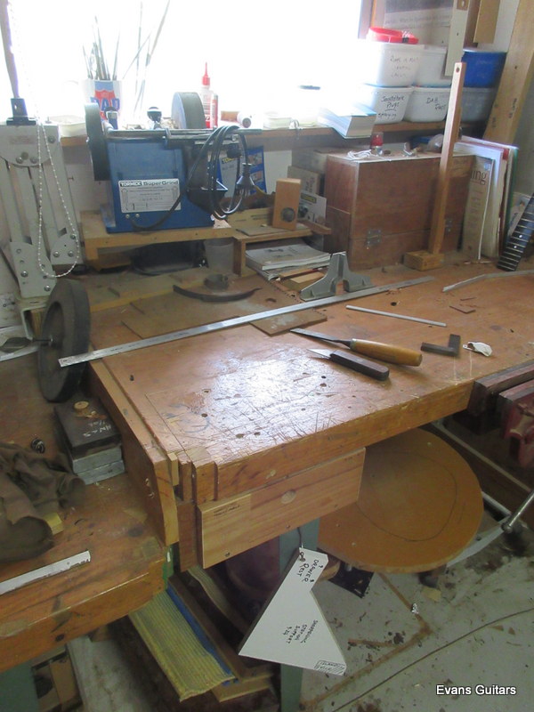

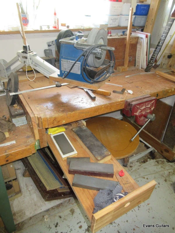

I’ll just show a couple of additions I made to some benches, for convenience and space-saving.
Cheers Taff

First of all thanks for sharing, I have been super zooming in on your photos for ideas.
Ten workbenches with an optional two islands, and double-ups of your tools!!!!! You know that if you were talking about booze or cocaine here they'd be a therapy group for your addiction, "Hi, my name is Taffy, its been three days since I bought a workshop tool!" Instead we're all just looking on from our little workshops agog wishing we had more space.
I love your little sharpening station. Certainly the shallow nature of some of the drawers is something I need to incorporate. . I use whetstones so that will take some thinking about. I have a shadow tool wall, however I am less good at returning tools after use.
Your Tormek is on an extendable arm, I don't think I've ver seen that before. Brilliant.

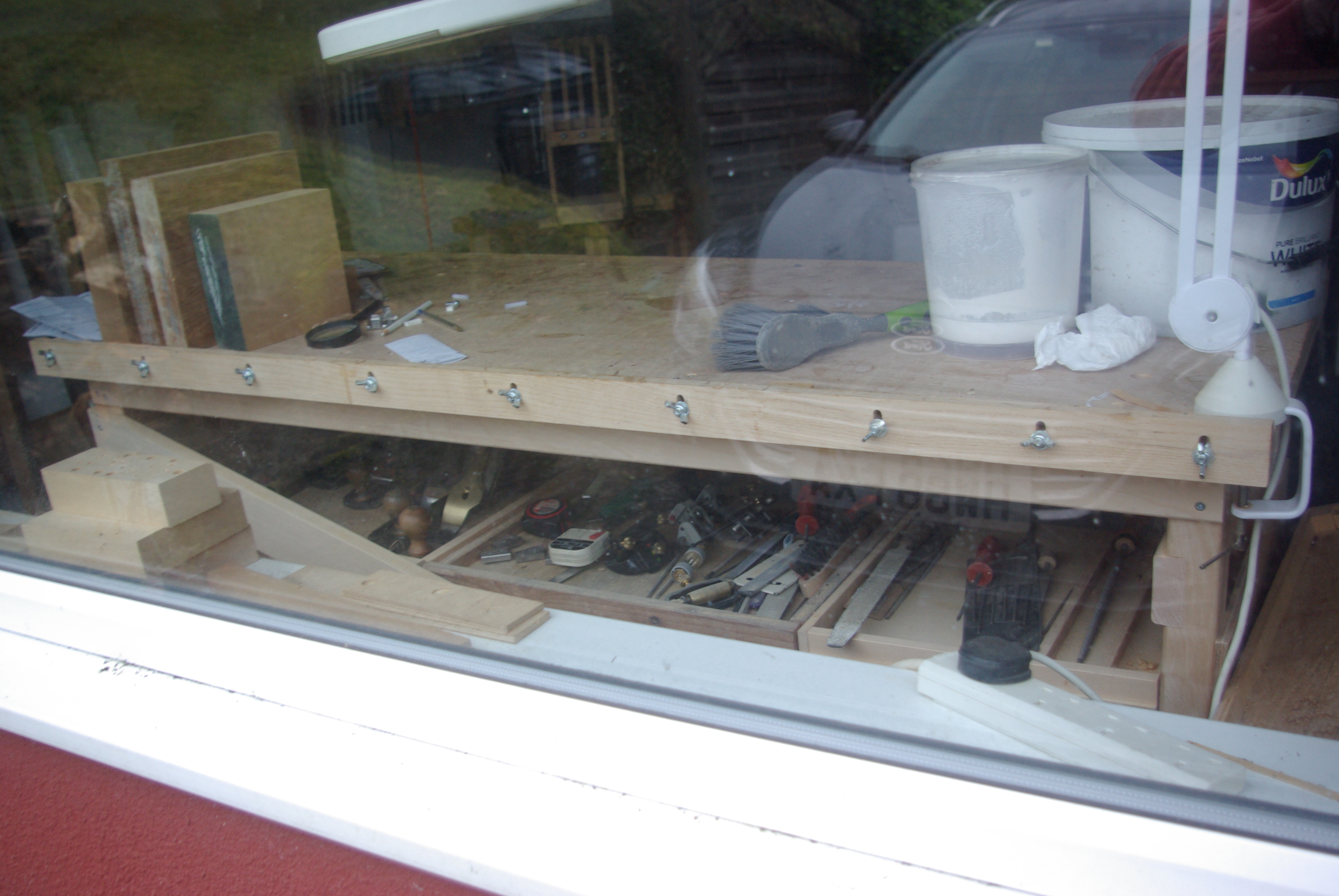

Hi again Alan, thanks for the comments. Tools, many I have created myself.
In a recent count, I had 97 tools, jigs, and machines, that I could have bought from instrument suppliers but made them myself. Then again there are many, many store-bought tools in my shop.
Here are a few more photos.
The island work table is my fretting jig, to which I attach a worktop when needed.
The three shallow draws also support an extended bench top for when things get too crowded.
Cheers Taff.

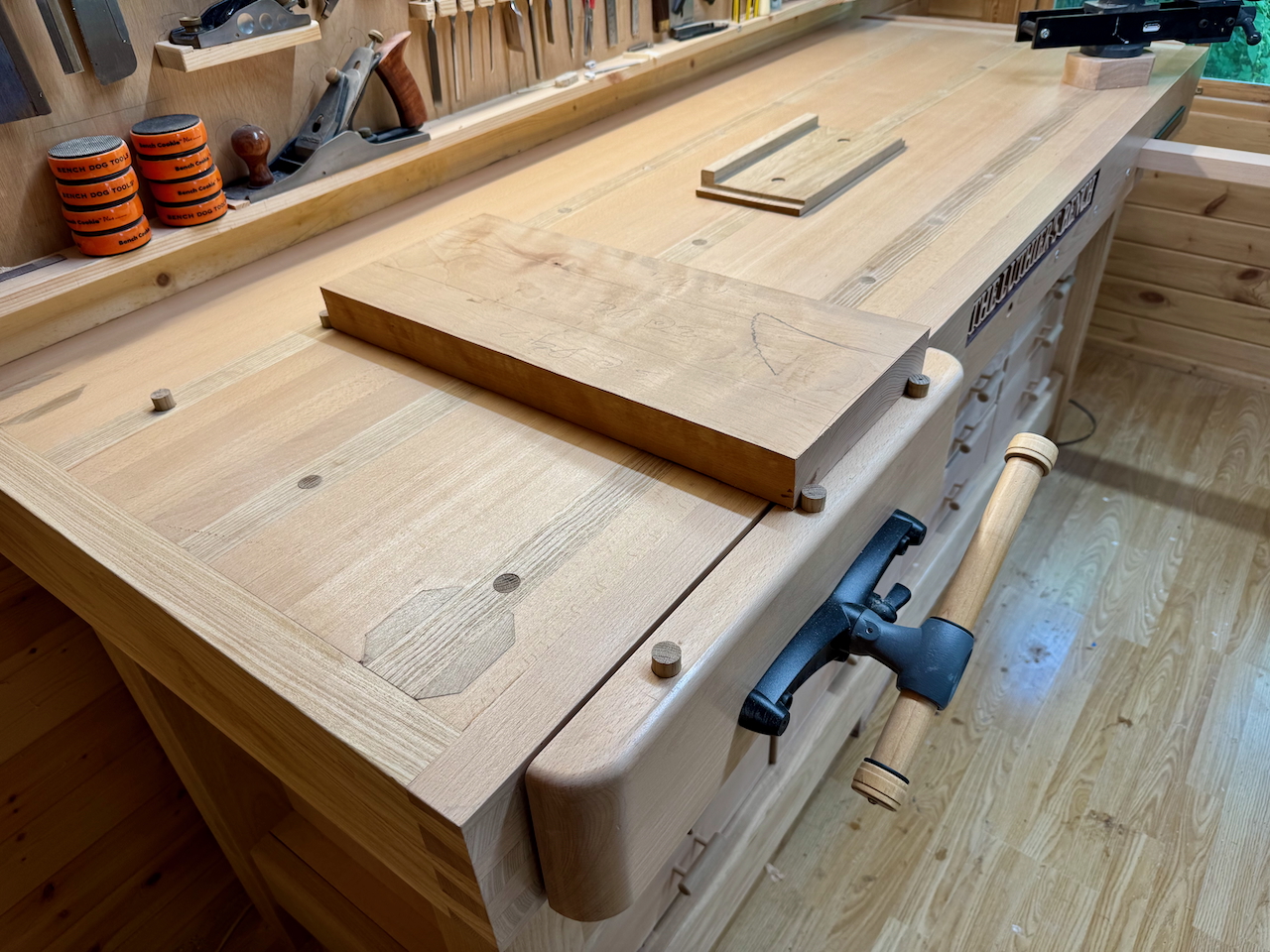

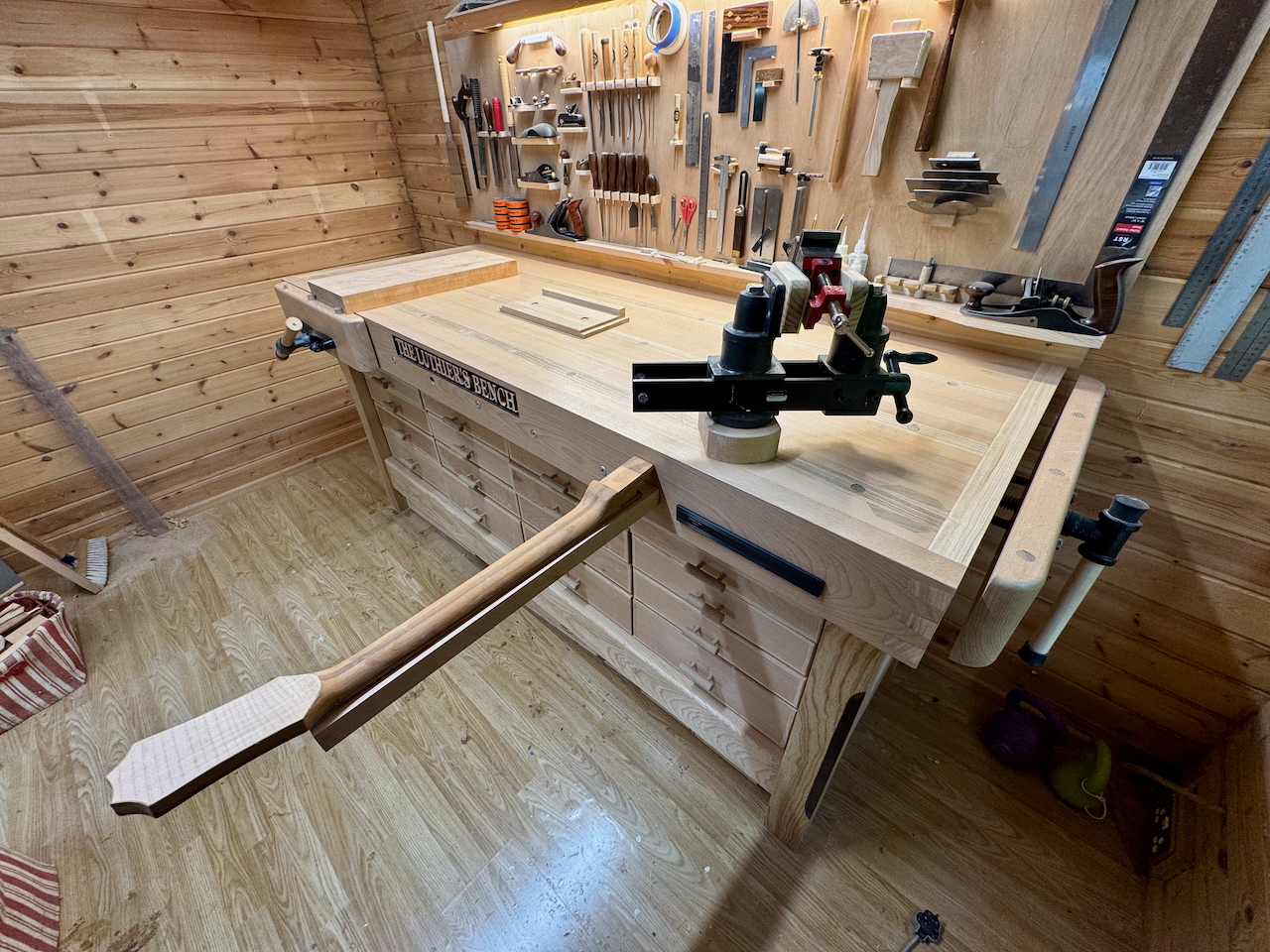

Post by TallDad71 » Wed May 07, 2025 11:17 pm
Finally finished my bench, I thought some might like to see the result.
Coming in at 140Kg it will remain in my workshop for many years longer than I. I haven't had much to do with luthiery for the last couple of months but can see that every job will be made just a little easier by the existence of so many pop up dogs, clamping points and vices. Plus for me, finally a 1 metre tall workbench for my 1.96m height.
16 Drawers, several empty have allowed my to take down cramped shelving. Just can't remember which drawer they are in. :)
Clamping pieces is now a breeze, note the sacrificial mitre block, the bench is still too precious for saw work!!! :shock:
The sliding neck bench-ette is perfect for working on the curvature as well as clamping frets. 8)
