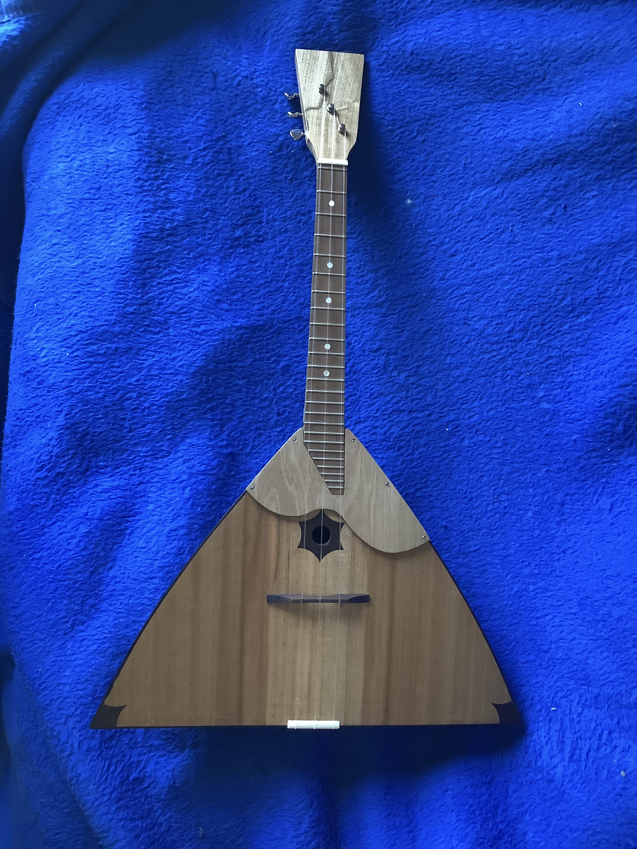

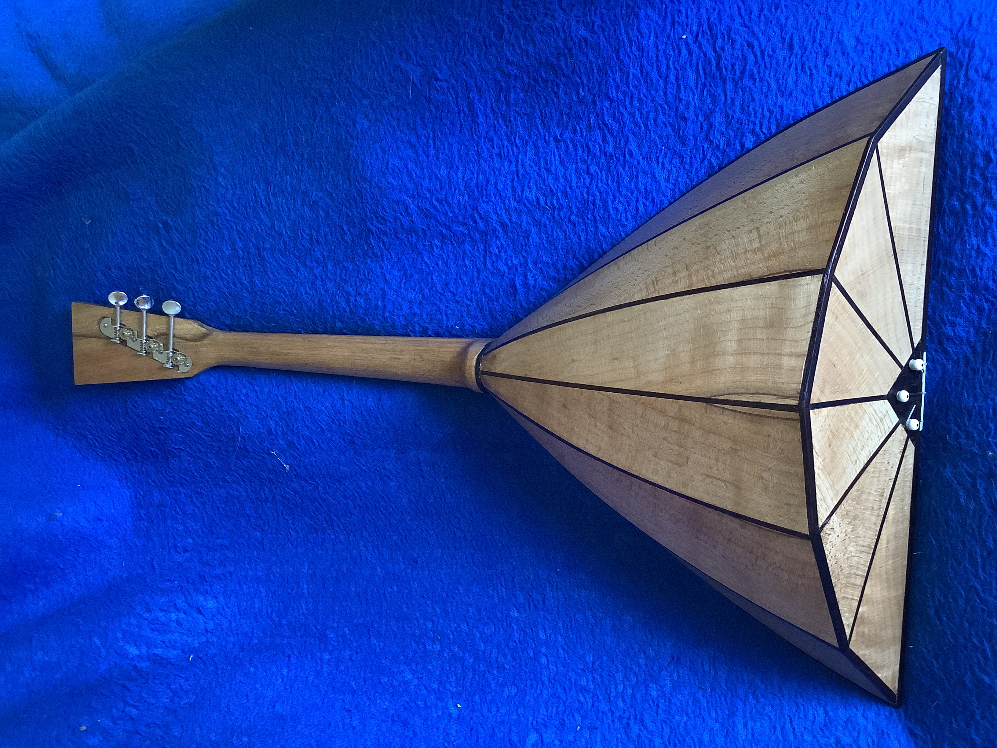

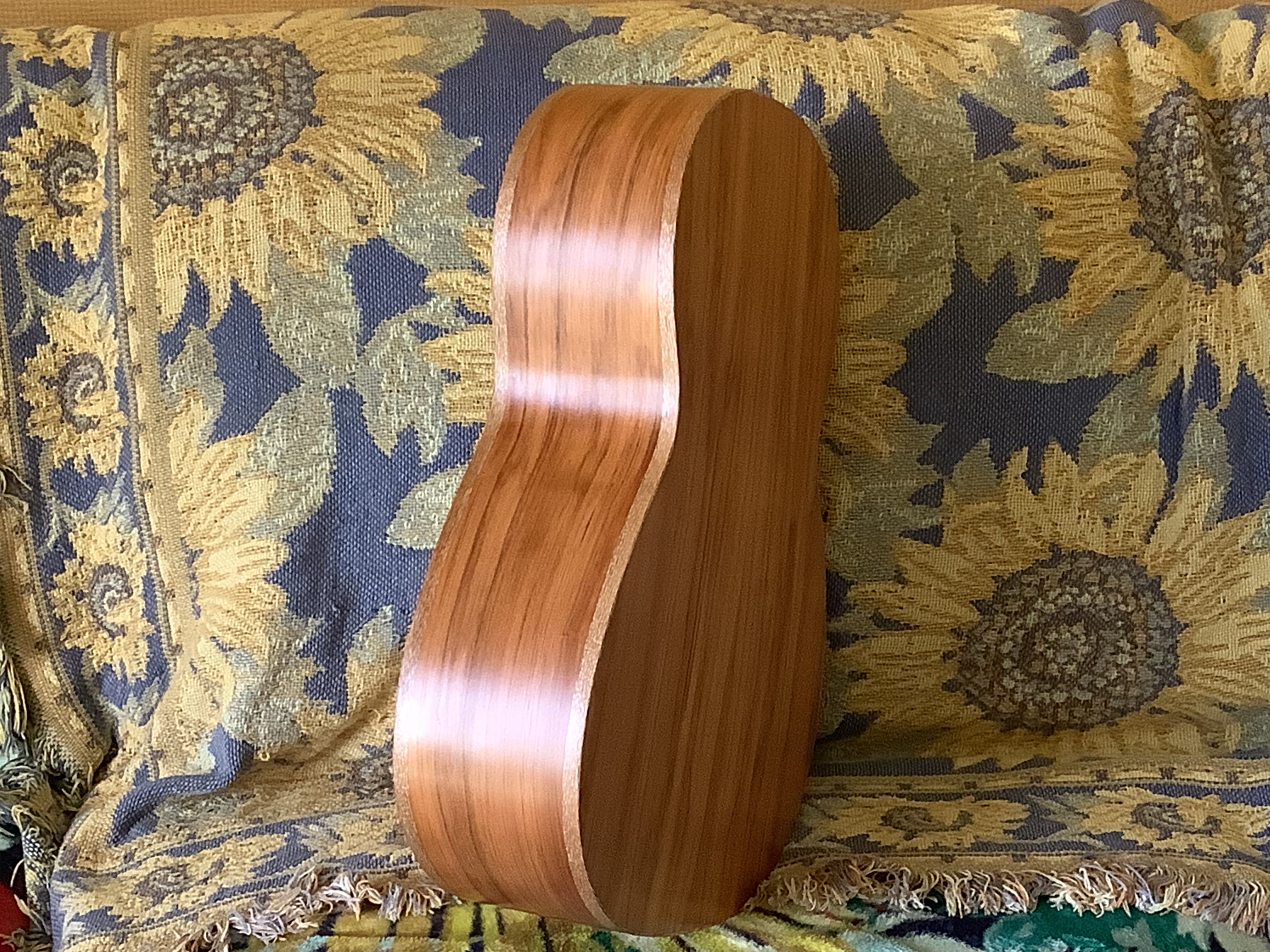

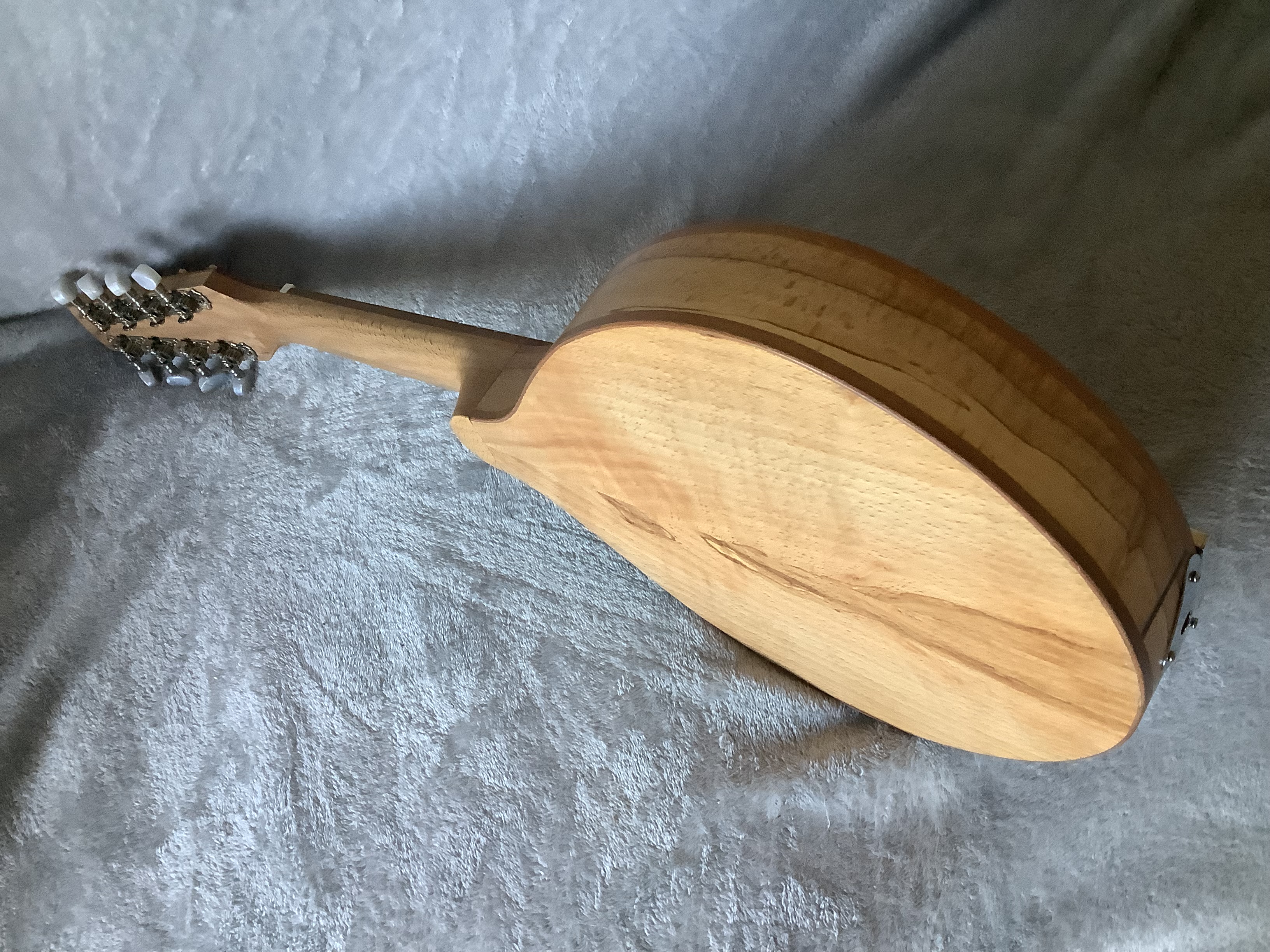

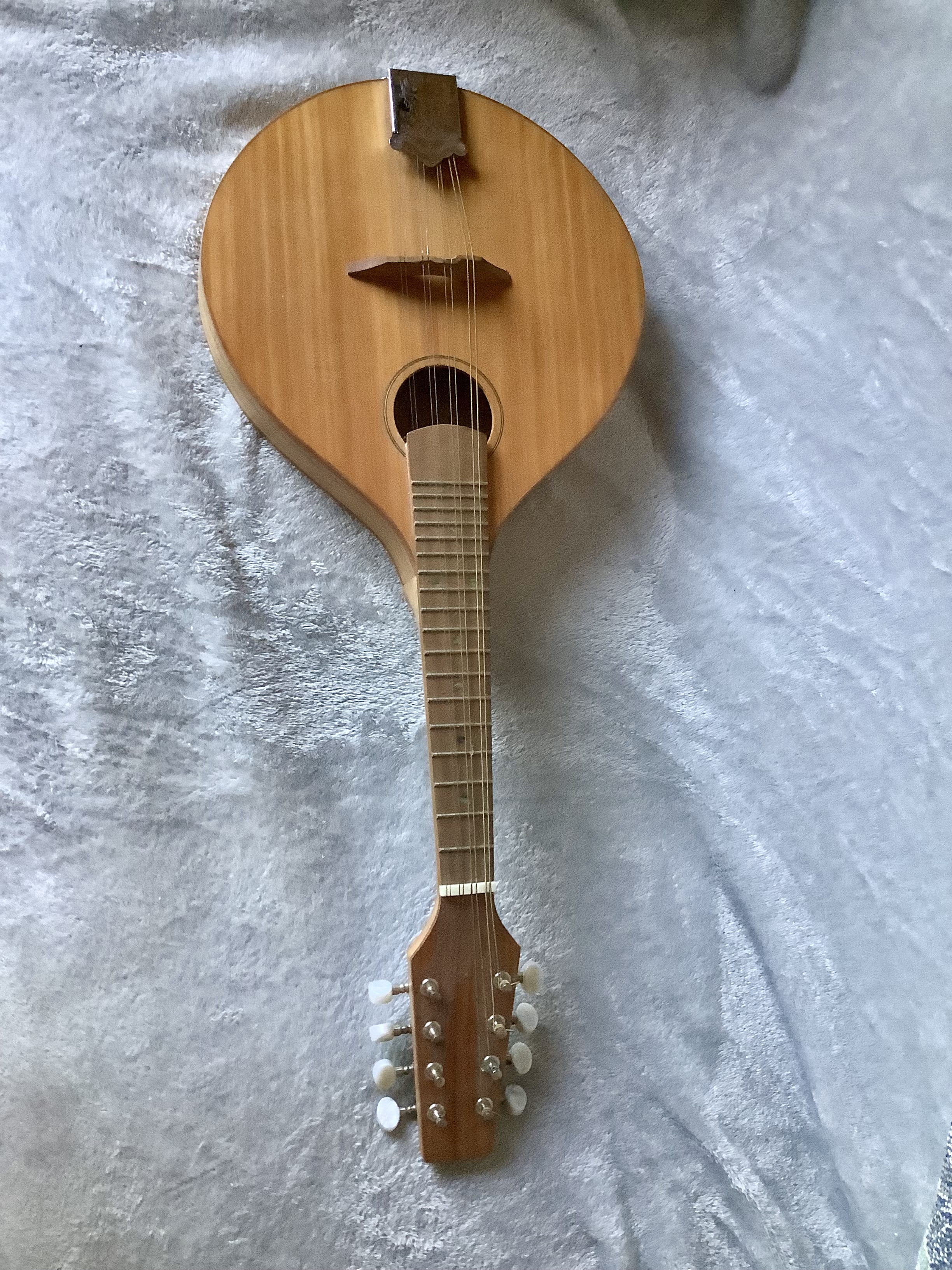

Sorry, the reply is a bit late but “You’ll be back!”
Tops
Kaihikatea, as already mentioned
Mangeao, kauri, matai
Mangeao is my preferred.
Back & sides
Rewarewa, any of the maires, tairere, tawa, puriri, pohutakawa, rata, rimu
Necks
Tairere, tawa
Finding it is the hard part and some of the woods can only be exported as a finished product.
Rarefied is the only commercial seller of guitar woods that I know of but they are expensive.
Check around for the local small sawmillers and be prepared to do a lot of driving. They often have wee gems hidden away, but they usually come as slabs or planks and don’t resaw down to guitar thicknesses,
Pohutakawa starts as a lovely soft pink and puriri a deep green but both fade to brown. If you don’t get a finish on pohutakawa fairy quickly it goes grey, as does black maire if left under light.
Rimu is probably the most stable but least acoustic. I’ve heard good reports about rewarewa but I’ve never had a large enough piece to make a body from.
This is just my opinion as a very amateur luthier. Im sure there are plenty of others who would argue otherwise on some of the points above.

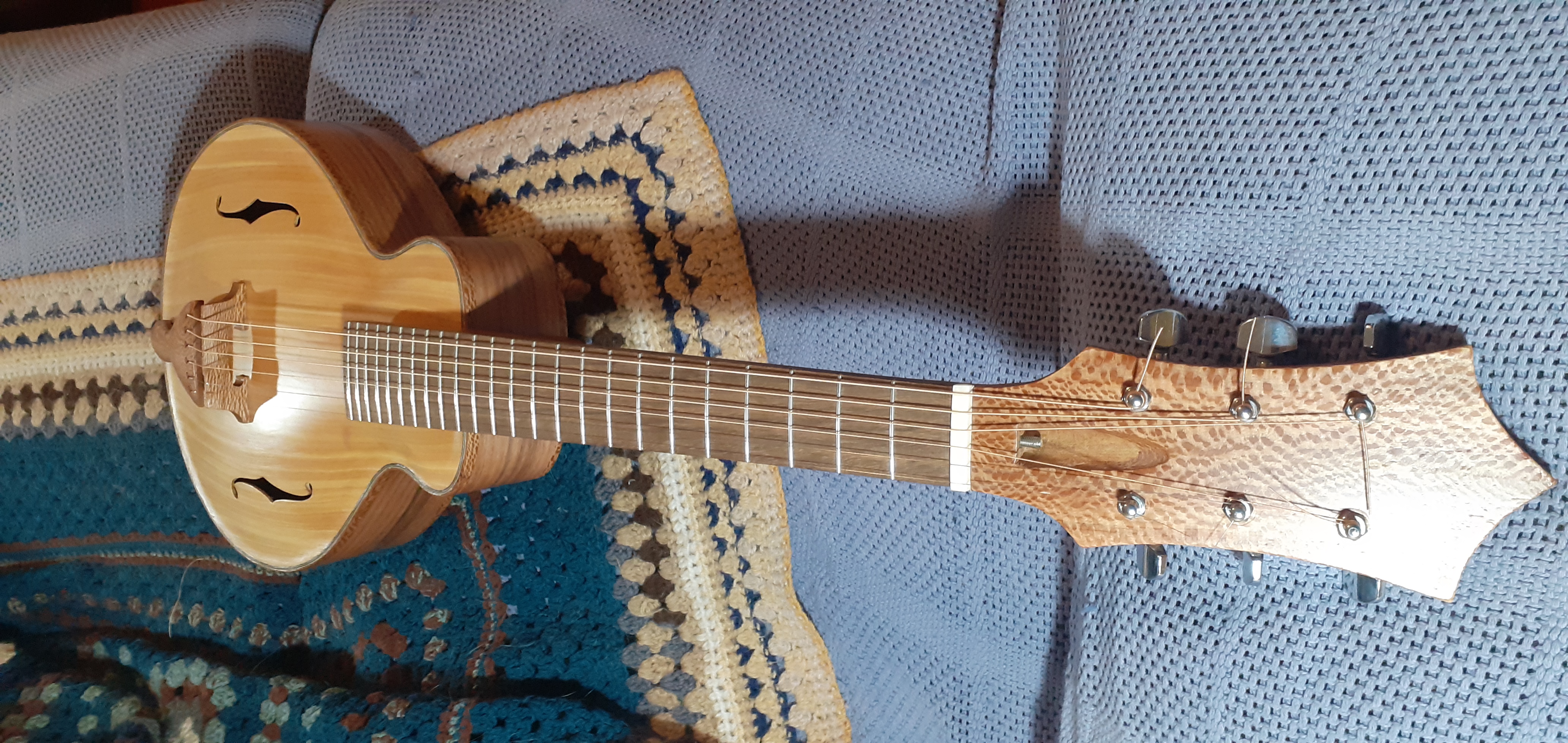

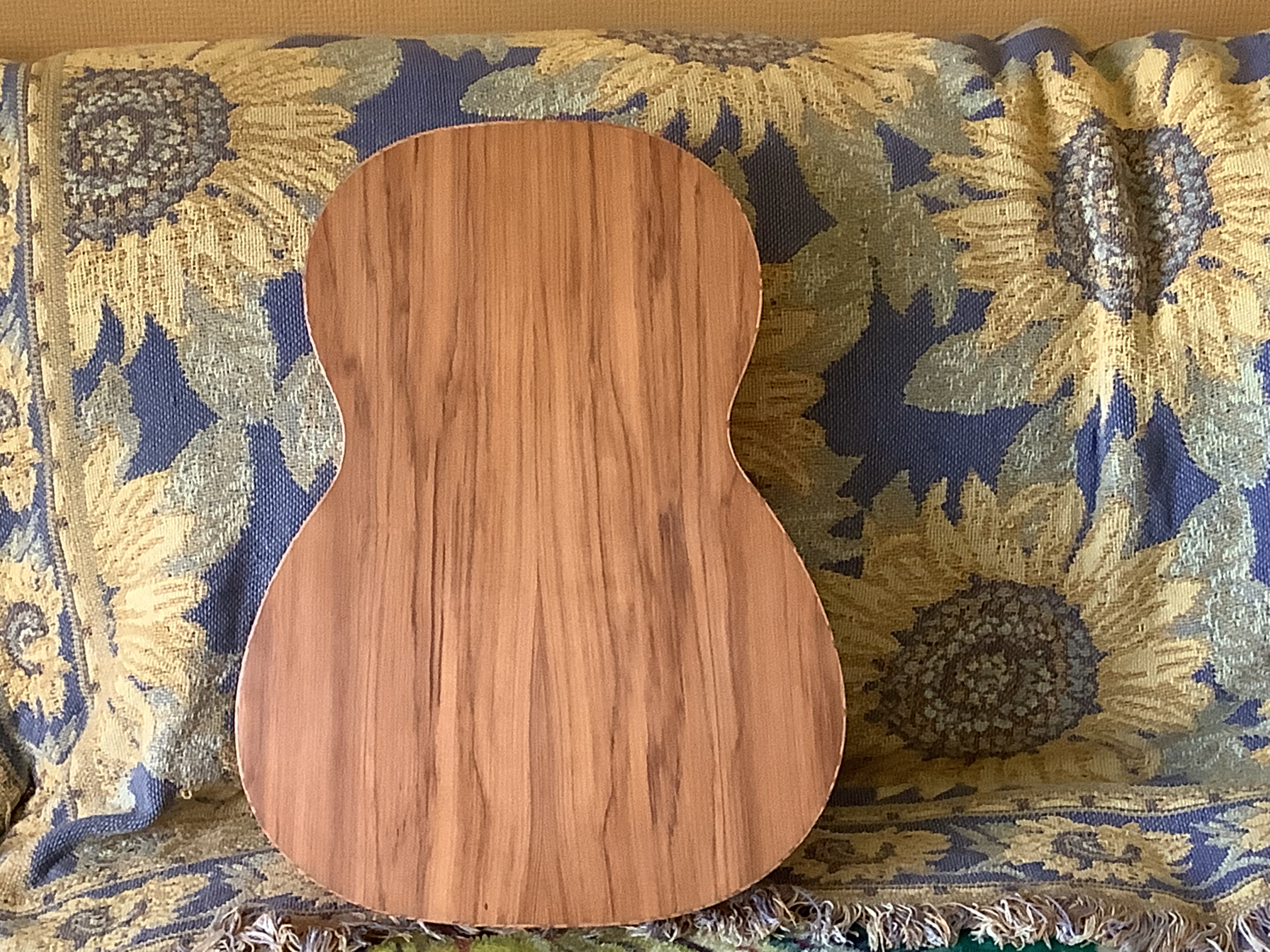

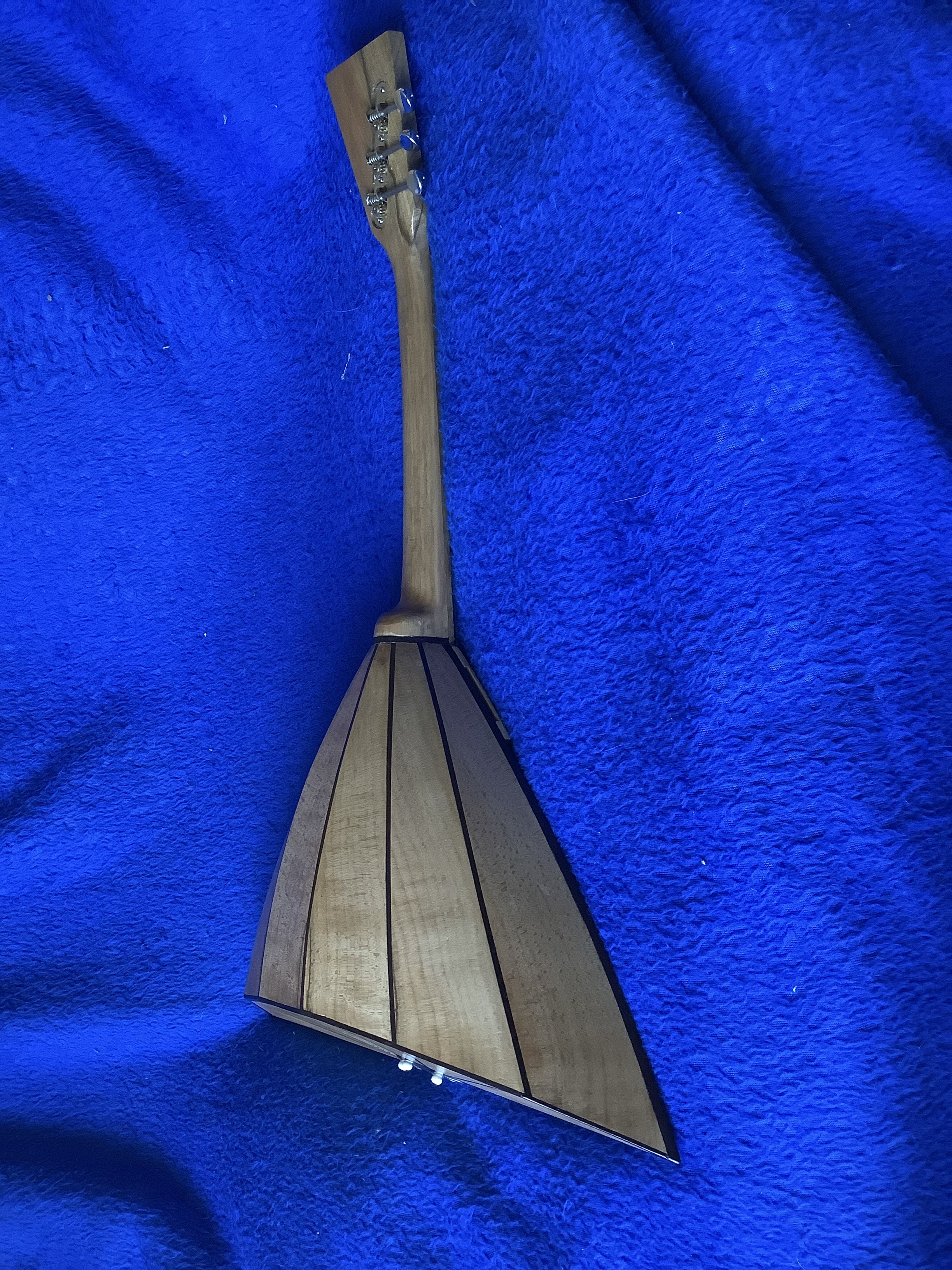

Mangeao top, black maire b&s
Rimu body, rewarewa bindings
Black maire b&s, matai top, river salvaged swamp maire fret board

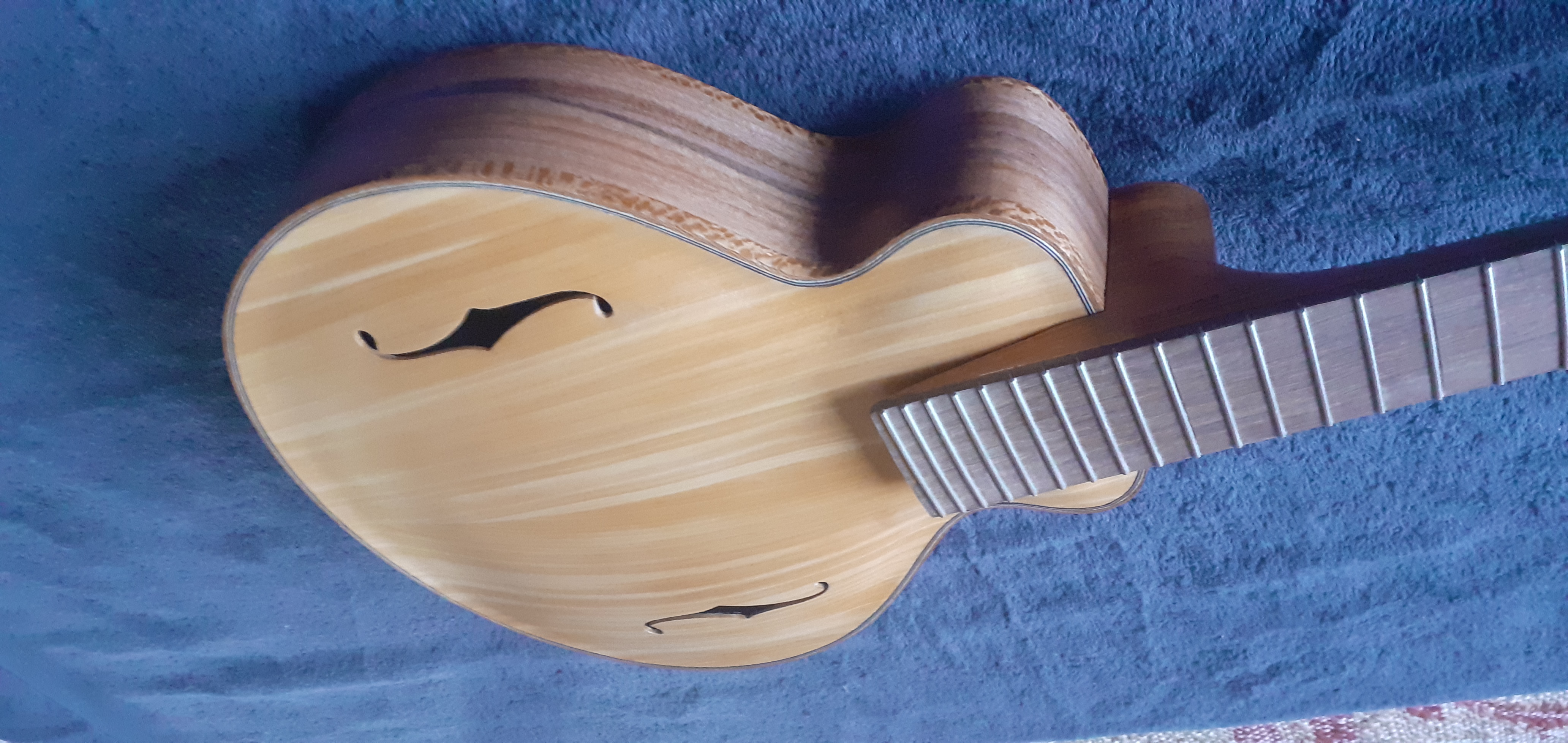

Post by Andos » Thu Jun 12, 2025 5:43 pm

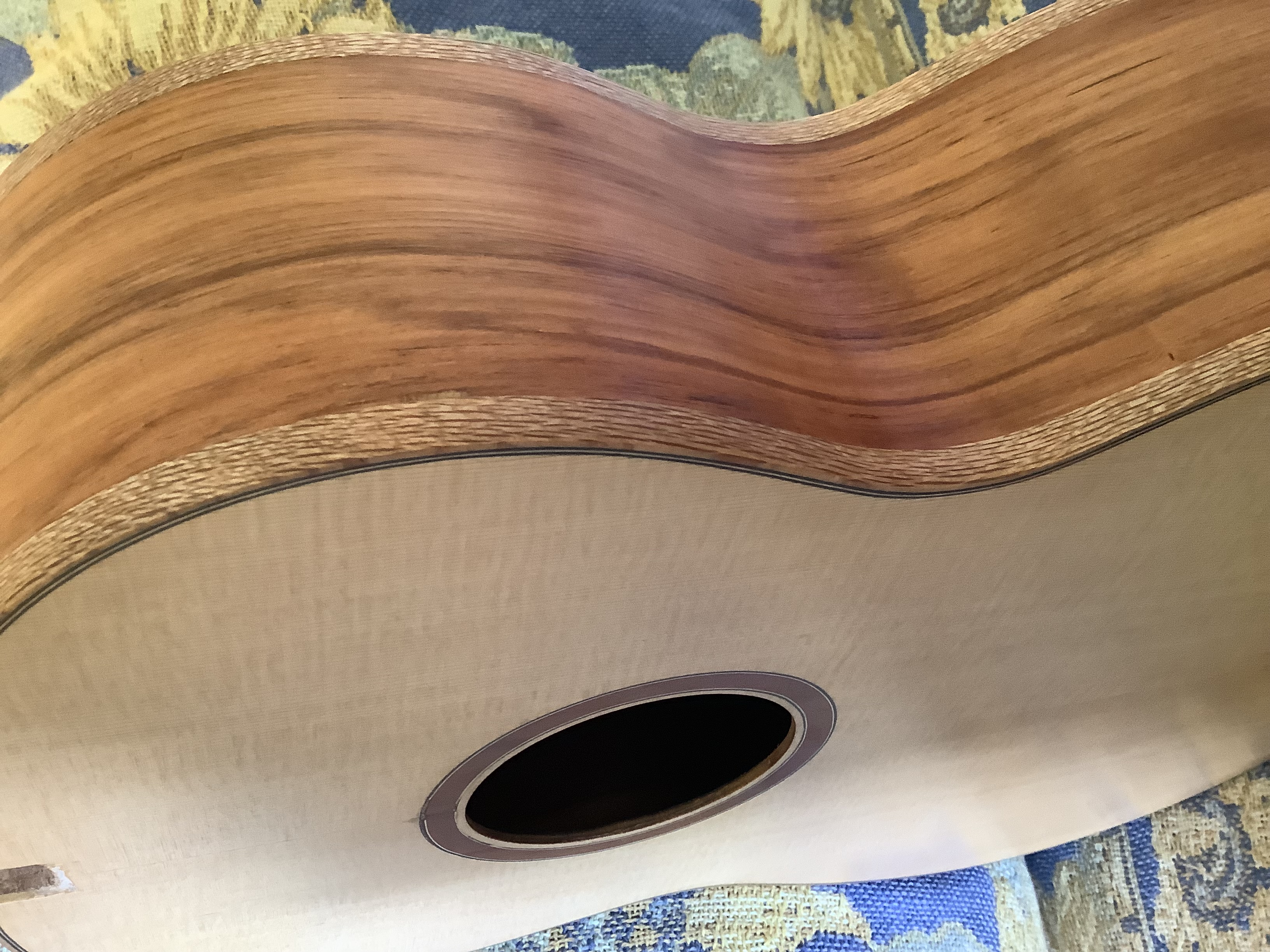

And a pohutakawa small body archtop.
Andos
Posts: 120
Joined: Tue Apr 25, 2017 4:12 pm
Location: Taranaki
Re: Local Classical Tone Wood from New Zealand (Back and Sides - Soundboard???)
Post by Andos » Thu Jun 12, 2025 6:21 pm
Damn predictive txt.
Archtop not arthropods
