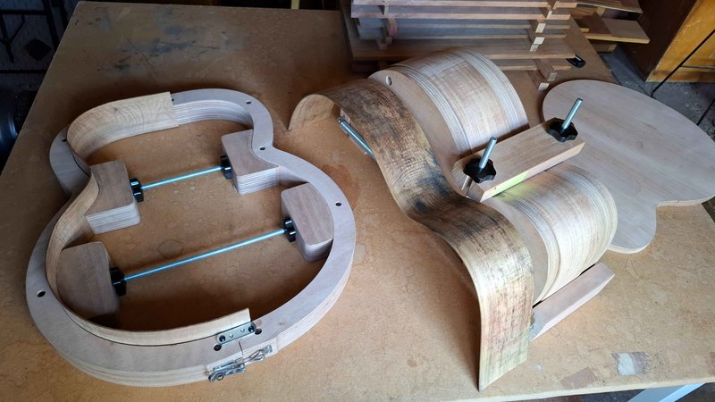

Progress has been slow and the work shop is cold. The back has been joined and some Bunyas in the mail. I have also found a few hours over the last fortnight to build some jigs and finished the form mold today. Hoping to get the side bender done soon
I'm still in the process of reading on sidebending with heat blankets. Has anyone got some links to share that describes a timeline of temperature and preferable methods. I've learnt that you can cause a kink in the lower waist and hoped to understand more of what causes this..

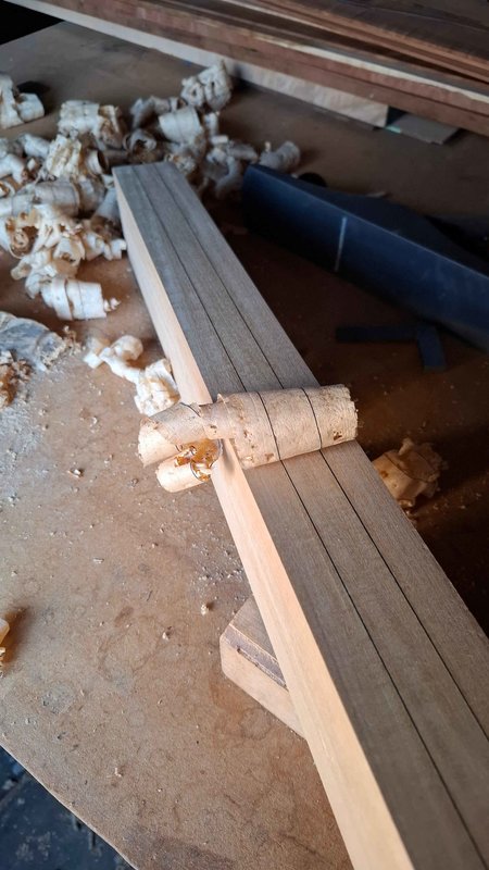

Today was spent levelling the back in prep for carving.

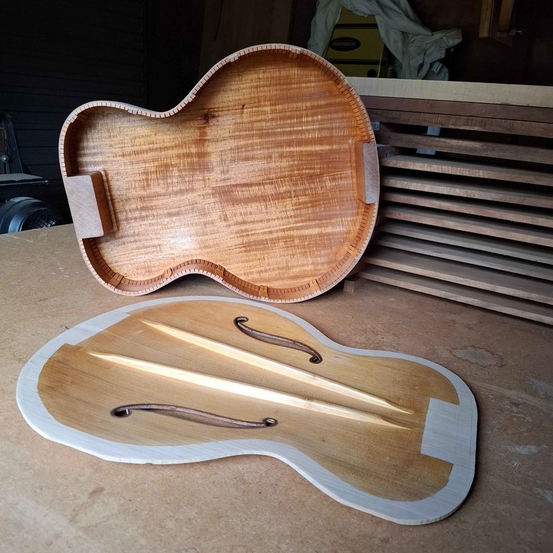

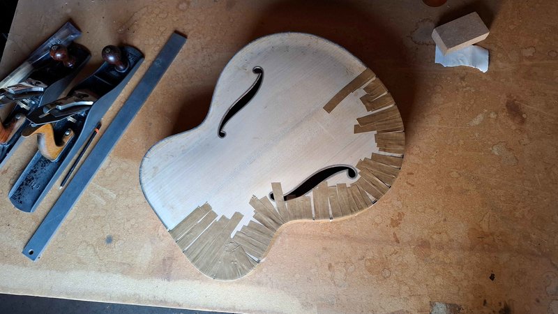

I've finally reached a milestone with the top and back mostly complete.. Many hiccups and some lateral problem solving has made the journey enjoyable so far. Carving the bunya pine top was fairly straight forward and I've managed to keep the gradations fairly close to Benedetto's plans. I built a small violin makers plan with a jig to shape the blade and used some gidgee off cuts to build the body.

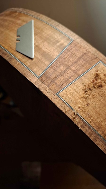

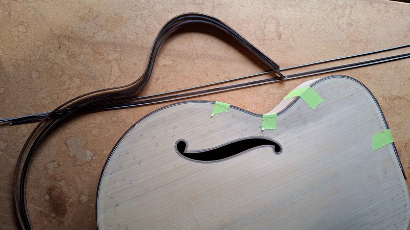

I really struggled bending the f hole binding on a soldering iron. After a good month of trialling and failing I needed to find a process that would work within my skill set. So I did some testing using the steam wand on a coffee machine and managed to get replicable results. In the end I 3D printed some jigs and slowly bent the bindings by focusing the steam at the point of the wood bending around the jig. Unfortunately I experienced some CA super fine run out when installing them which has stained a small area around the F holes. Live and you learn!

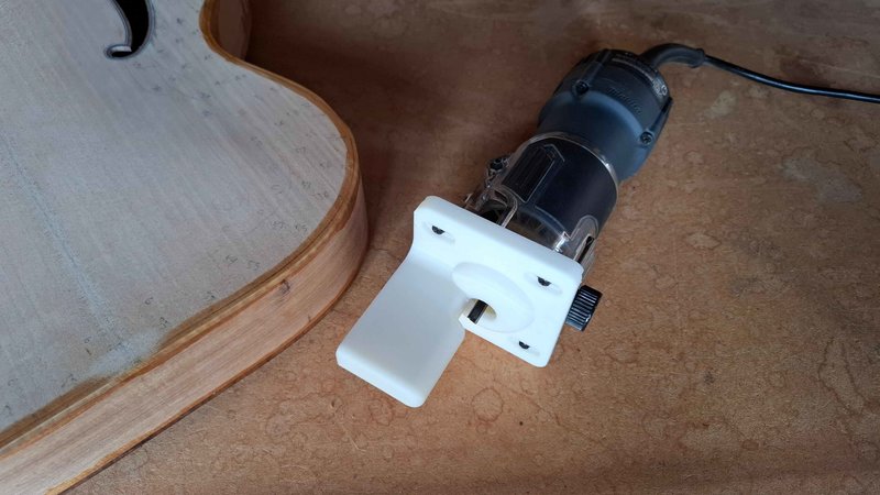

I spent some time in CAD to see if I could make some other fixtures to help with carving the tops and backs. An opportunity came up to use a friends CNC machine and he kindly roughed in the back for me - In the future I think ill stick to the hand planes. Only afterwards did I learn about curtate cycloids and plan to revisit the original jig idea with improved curvature. Hopefully it will make the initial steps of rough carving tops and backs a little easier.
Currently the top with braces ( .5" high) is 600g. There does seem to be quite a bit of deflection under thumb pressure which I need to understand some more. I am anxious about the re carve. I think my biggest concern is that I've only recently felt that this Bunya pine top isn't as stiff as spruce. So while the carve is close to Benedetto's, it may be too thin for this piece of wood. The back is 796g.
Do any members run deflection tests on braced tops?
Looking forward to bending these sides and closing the box. This site has continued to be a great source of information throughout the build - thankyou!

LOL...a valiant effort with those F hole bindings. 10/10 for persistence and tenacity.

Have to agree with Martin, binding f holes is a real challenge especially if you're using timber you've done well to get them that nice,well done. Wayne

That top looks sensational. Love the f-hole bindings.

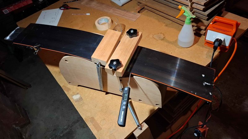

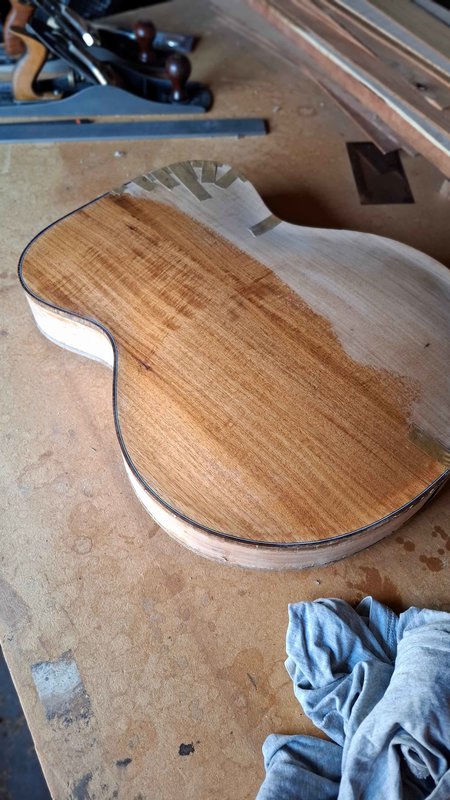

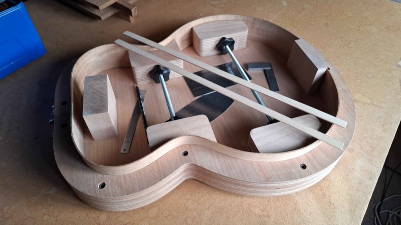

I've finally managed to close the box after a few slow weekends in the shed. The blackwood bent nicely sandwiched between a silicone heat blanket Alibaba special. Using the 3D printer I made a very basic binding cutter jig which worked relatively well considering it's construction and bound the guitar with a few F***, Sh** and whiskeys.

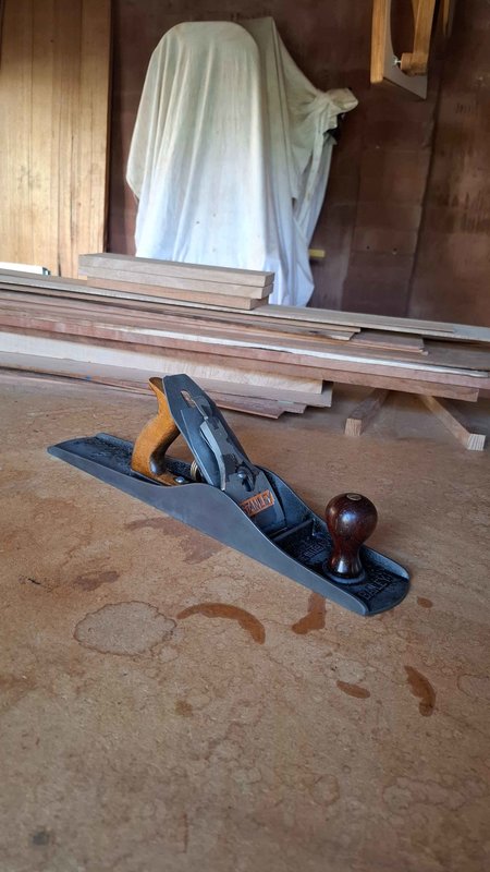

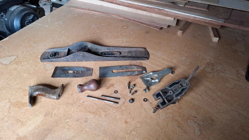

Digging through some crates at the Narracorte auto swap meet I managed to find a busted old Stanley No.6 USA. After 24hrs in some Evaporust I was able to clean up all the parts and put it back together with some TLC. It's really come up nicely and cuts well.
I've really enjoyed learning and seeing how the tone of the guitar changes through the many steps.. I know nothing on tap tones, but it's resonating like a drum.
