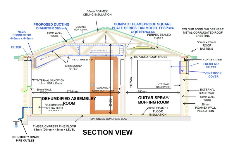

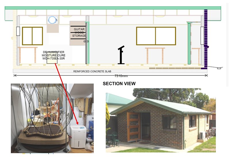

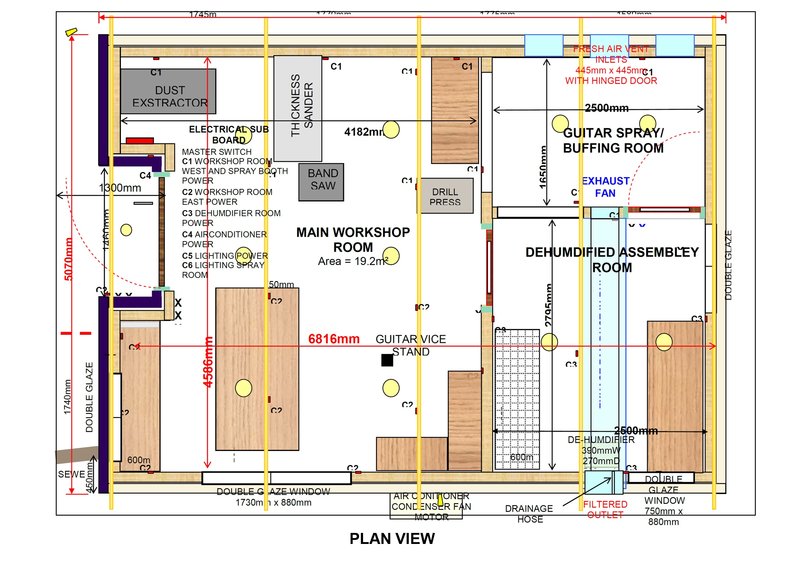

Re: Shed Advice
When I built my workshop I insulated the floor ceilings and walls. The workshop includes an assembly room with a dehumidify with a drain pipe outlet through the wall. See photos below.
Onlinekiwigeo
- Admin
- Posts: 10859
- Joined: Sat Sep 29, 2007 5:57 pm
Re: Shed Advice
Wayne writes up a detailed plan complete with full scale drawings before eating breakfast each morning
Love the attention to detail.
