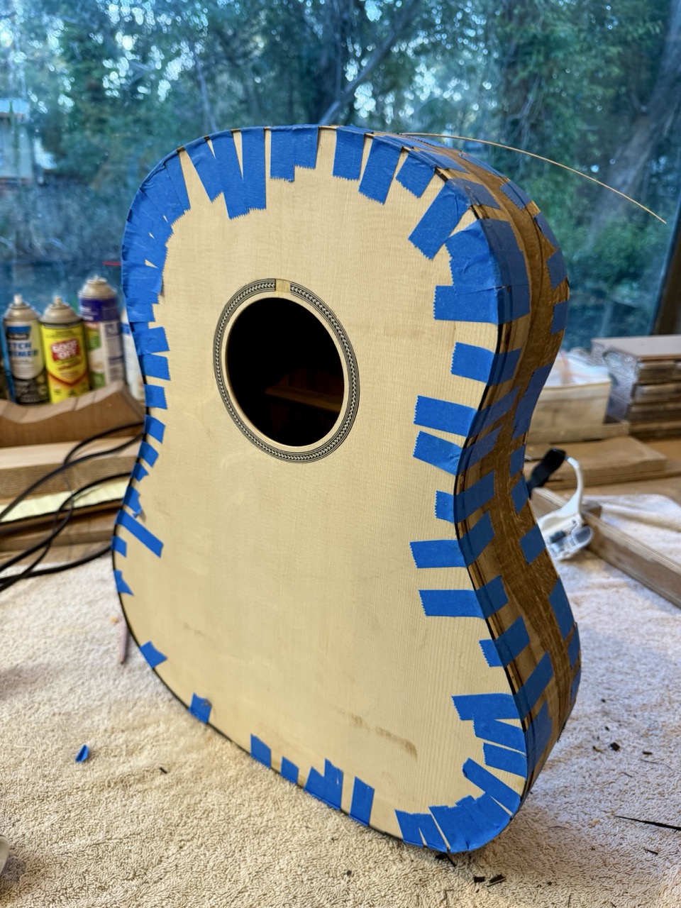

I'm a little nervous about posting progress photos of my current, and very first, acoustic build, given my very beginner skill level, but here goes. I'm building this at Jim Cargill's workshop with his guidance.
It's a lefty J45-ish body, but with a 25.4" scale length. The back and sides is spalted Oregon myrtle (AKA Californian laurel), and the top is Italian spruce with a bit of bearclaw figuring.
I just closed the box on it, and this past weekend trimmed the soundboard, got the tail wedge in and made the bindings, which are ebony with WB purfling like the backstrip.
I felt like my bracing wasn't as exact as I'd like, but it's got a pretty good, loud tap tone now that the top is on, so fingers crossed.
Oregon myrtle and Italian spruce J45-ish build

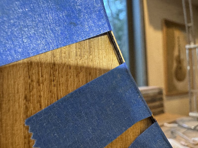

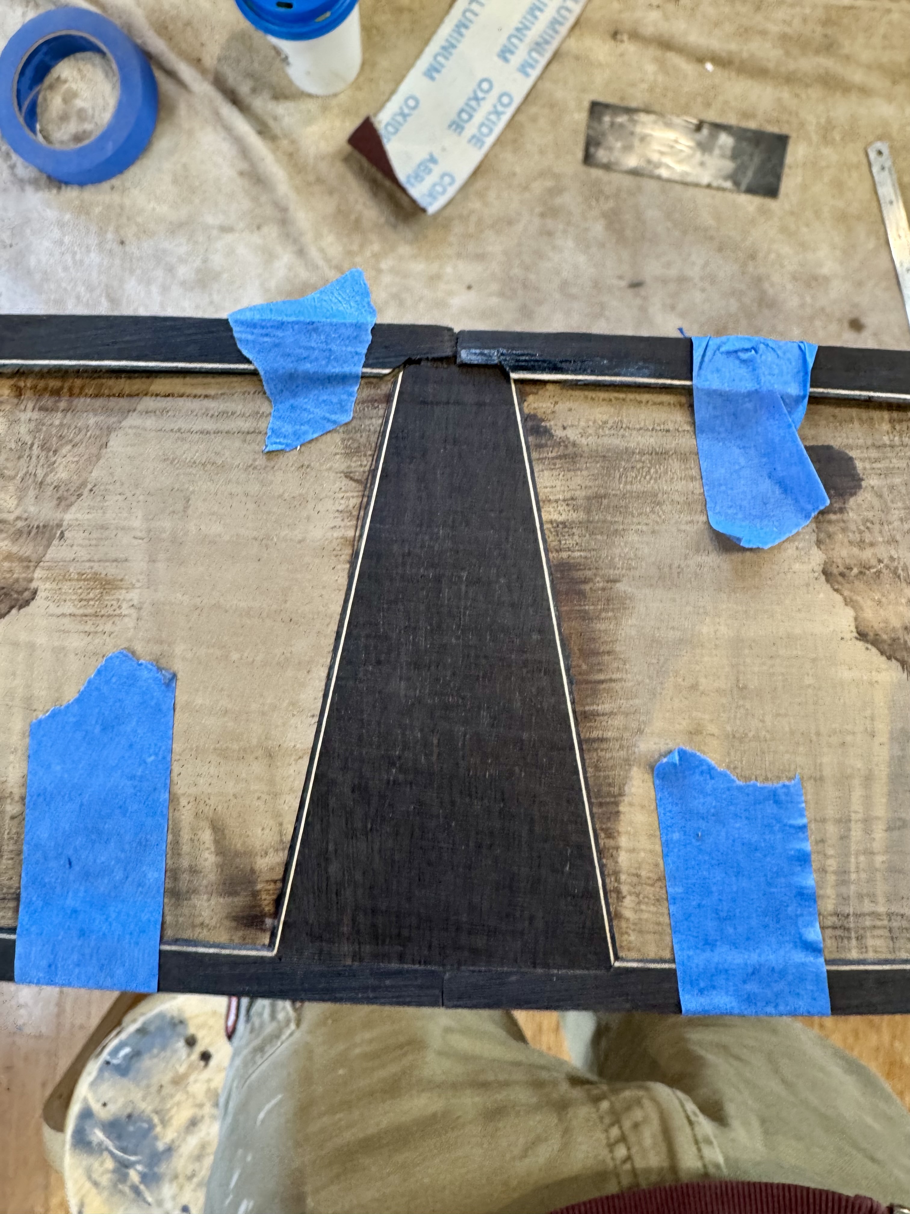

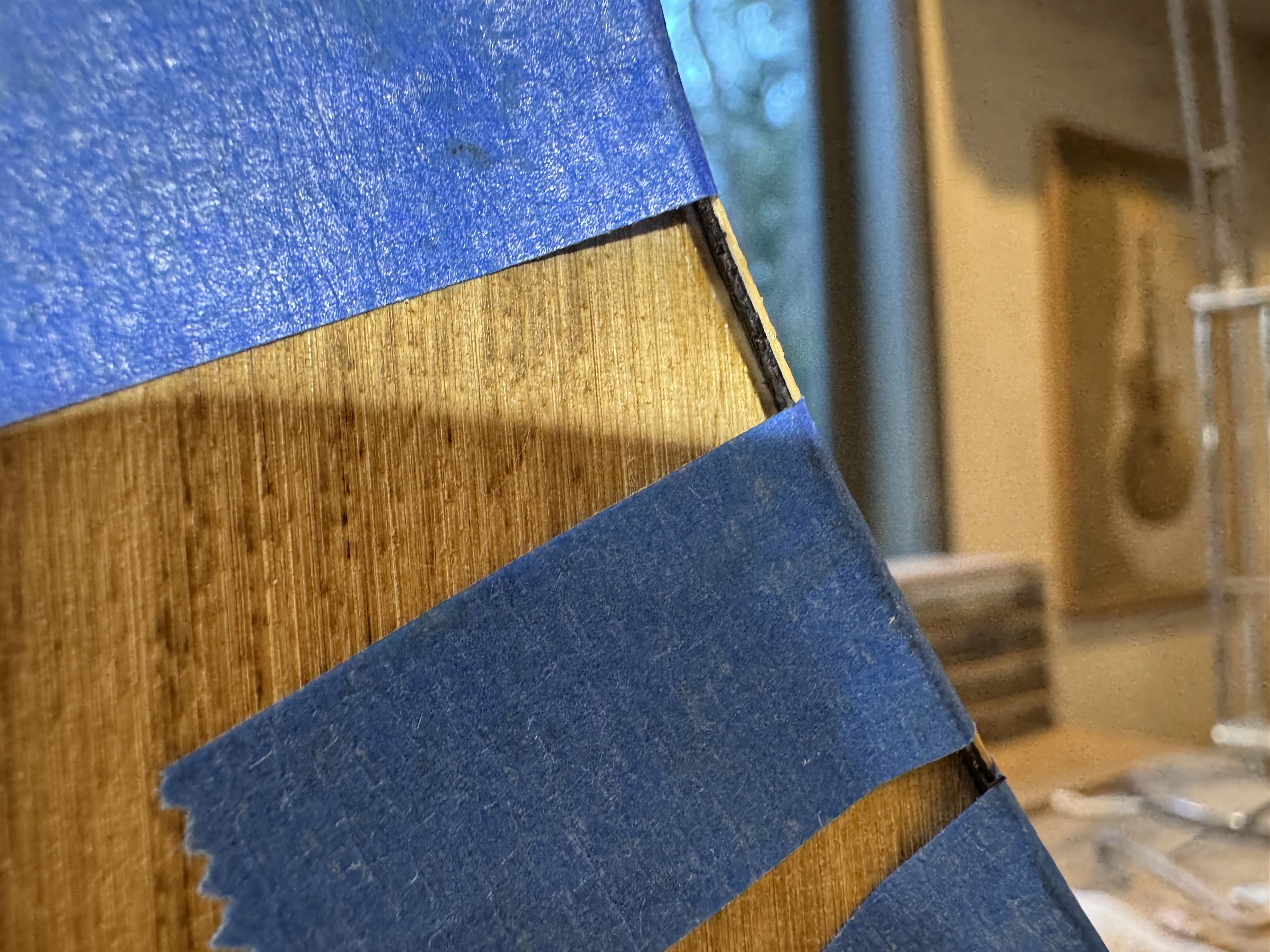

A couple more progress shots. I spent all day Saturday working on the body bindings, and I still didn’t get them finished.
I’m continuing the back strip and tail wedge around into the binding, which is ebony with white and black purfling. Getting the white purfling to line up perfectly where it joined the wedge was a big faff, partly because I routed off the ends of the wedge, instead of just trimming off the purfling so I could mitre in the binding to join it. Lots of lessons learned for next time, and there’s a few little gaps I’ll have to fill with the old glue and ebony dust trick.
But I got the binding bent and cut decently, and I got the inner purfling strips glued on, so next time I’m in the workshop I can get the binding on.
In hindsight, I probably should have tried some simpler binding for my first attempt.
