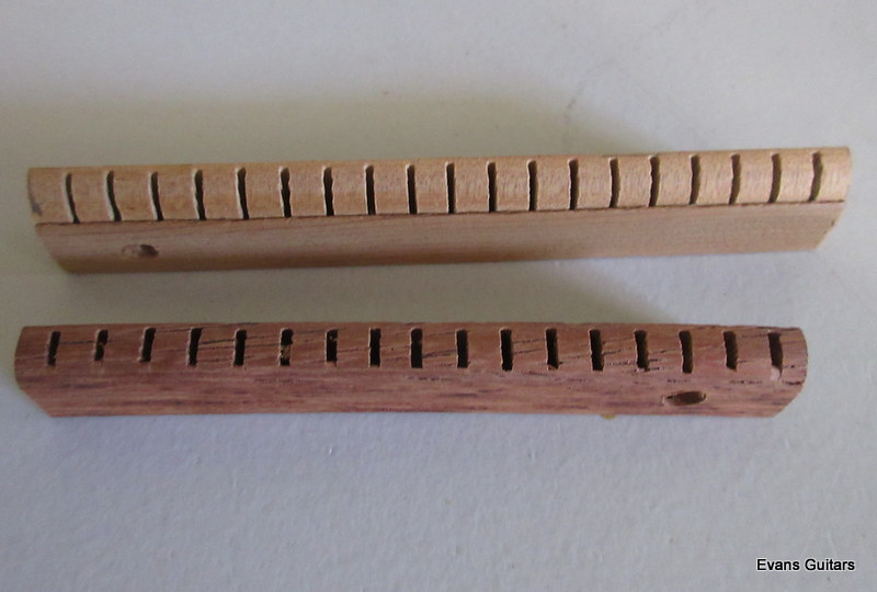

Re: NGR/Cedar build
Hi Alan, I only used the laminated side option due to making a blooper on one of the sets of sides, so, as not to waste them, I used one set as a lamination. I would sooner stiffen the sides using both a “boxed” Kerfed binding, as shown here, and heavier side reinforcement. The kerfing shown adds a lot of stiffness to the sides.
Cheers TaffTaff

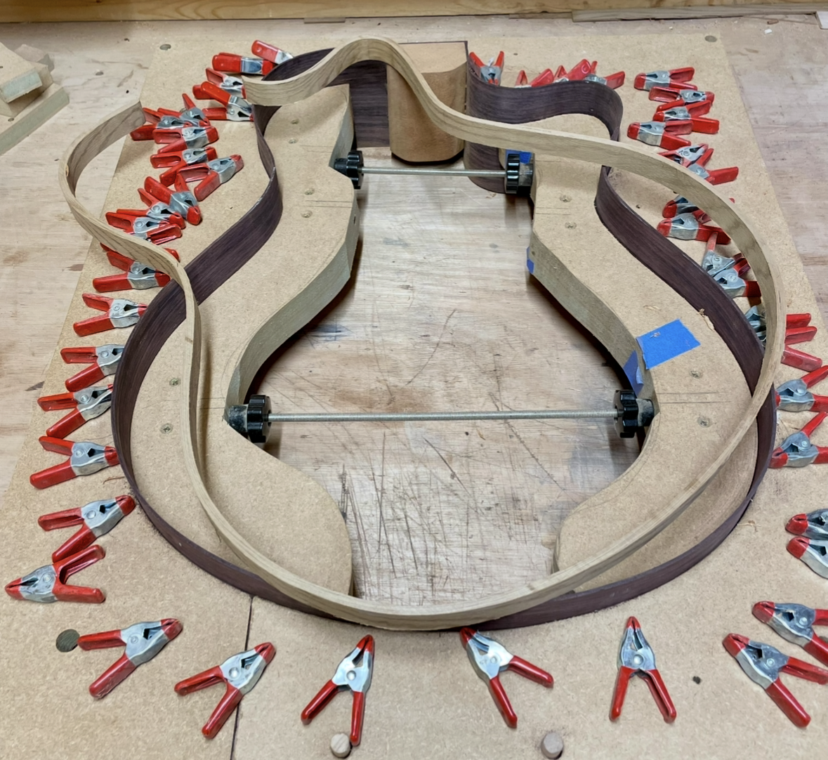

Re: NGR/Cedar build
I love your admission of making mistakes. I’m of the mind that whenever you see a feature in woodworking, it is probably a cock up that’s been made good or hidden.
I still make far too many ‘features’
This is my lining, super stiff when glued in place.

Re: NGR/Cedar build
Loving this discussion!
I saw a video recently of a luthier called Chuck Morrison explaining his use of 'full kerfed lining' - essentially kerfed binding that's the full height of the side, which he'd laminate onto the outer side kerfed side down, and then laminate a veneer on the inner solid side, partly for appearance and partly for reflective qualities. From memory he was using pine for the kerfed lining, with a rosewood veneer on top.
I think the idea was that it took care of the laminated sides and the lining all in one go, and it only required bending the outer layer of the sides, with the other layers just glued and clamped. It also made it relatively easy to run a single, continuous length of the kerfed lining and/or the veneer all the way around the sides, giving a strong connection between the two halves.
For some reason the idea has really stuck with me as an interesting approach. Here's the video: https://www.youtube.com/watch?v=9msh_4l0t6U

Re: NGR/Cedar build
I agree, the weight’s a bit much, but I guess he’s trying out a few things at once. The experimental back and top bout bracing didn’t appeal to me much, but the sides seem like an interesting idea.
Re: NGR/Cedar build
The sides are an interesting idea, I wonder about laminating them though. It must use up an awful lot of glue, and ensuring that both pieces are adhered throughout the whole of their surfaces, around all those bends must be very tricky.
I know if I was to try it, I would have a lot of gaps between the surfaces, almost untraceable but none of it good.
Just laminating my 4 ply linings leads to a number of dry spots. There only 20mm deep.

Re: NGR/Cedar build
If I remember right, he said he uses polyurethane glue that foams up a bit, which fills any little gaps and gets into the kerfing for a good hold.
