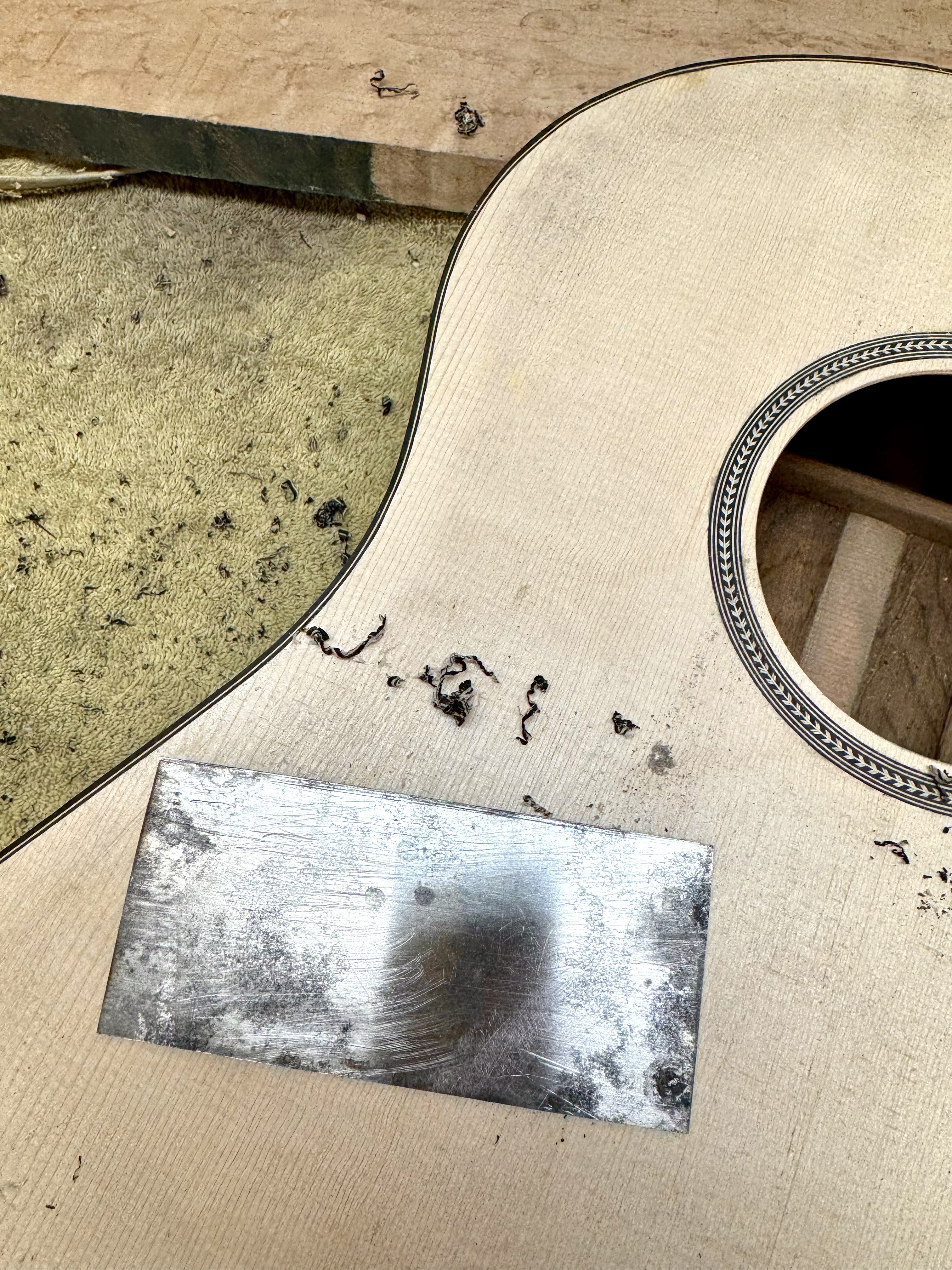

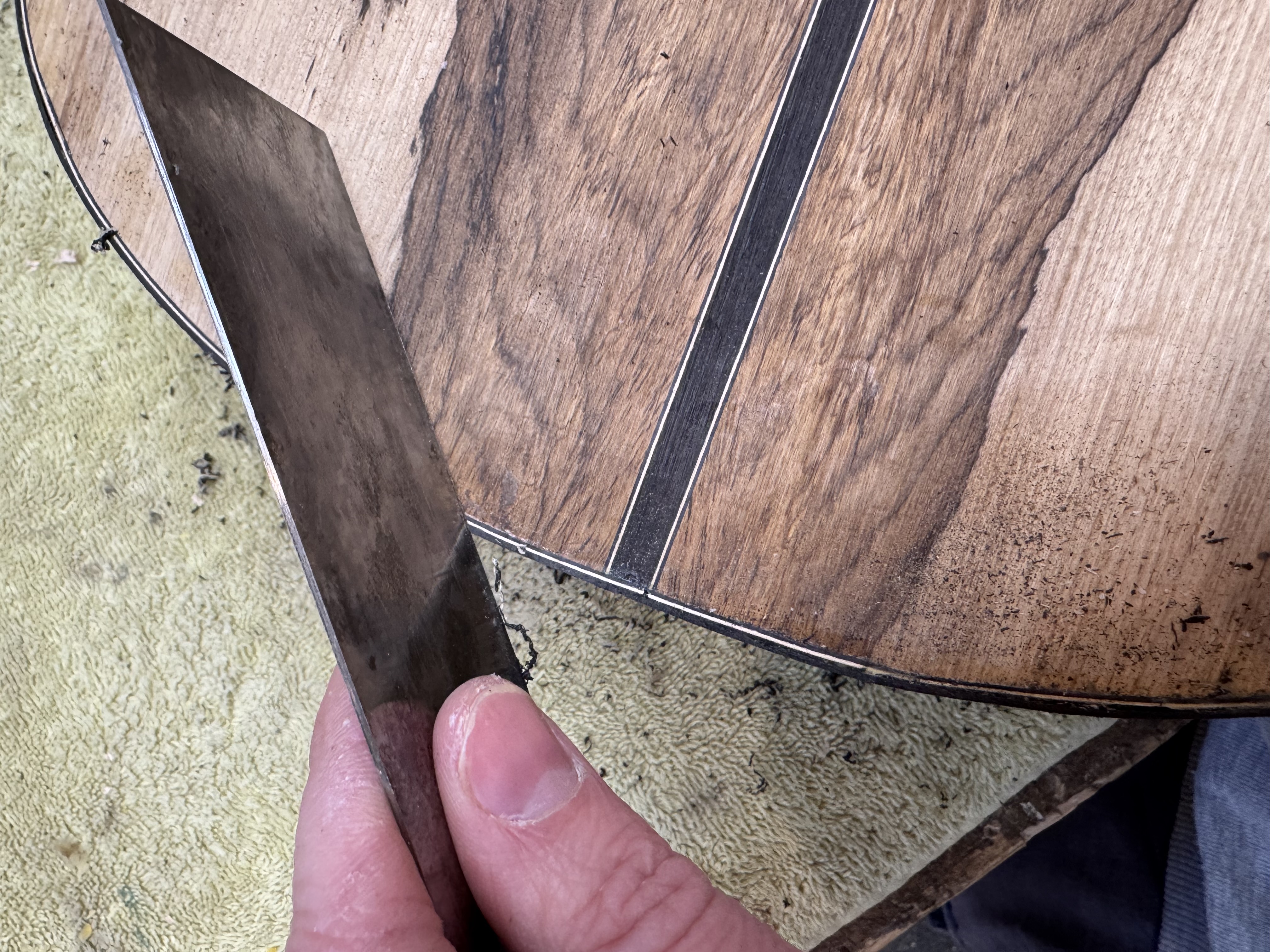

A couple more progress shots. I spent all day Saturday working on the body bindings, and I still didn’t get them finished.
I’m continuing the back strip and tail wedge around into the binding, which is ebony with white and black purfling. Getting the white purfling to line up perfectly where it joined the wedge was a big faff, partly because I routed off the ends of the wedge, instead of just trimming off the purfling so I could mitre in the binding to join it. Lots of lessons learned for next time, and there’s a few little gaps I’ll have to fill with the old glue and ebony dust trick.
But I got the binding bent and cut decently, and I got the inner purfling strips glued on, so next time I’m in the workshop I can get the binding on.
In hindsight, I probably should have tried some simpler binding for my first attempt.

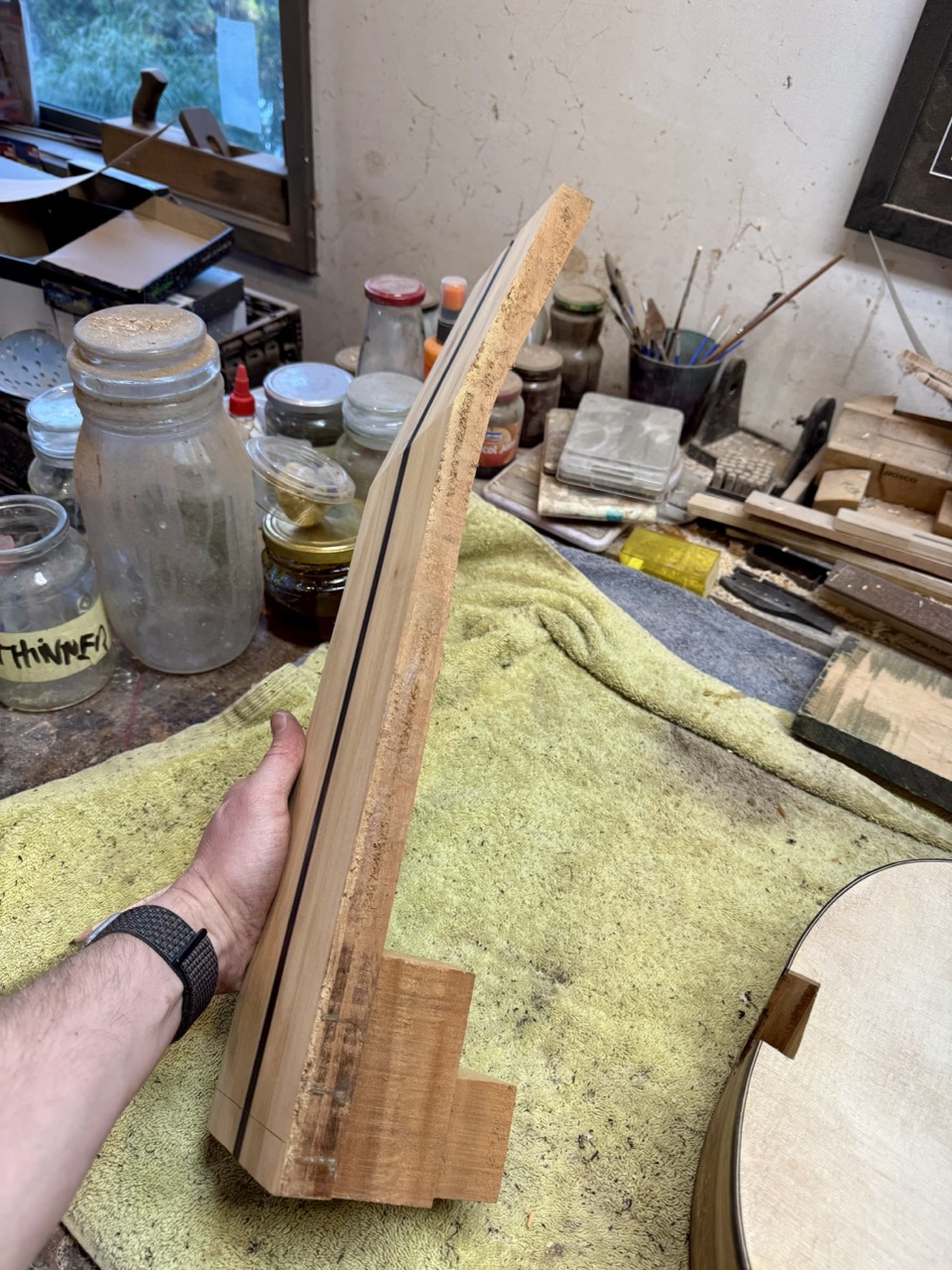

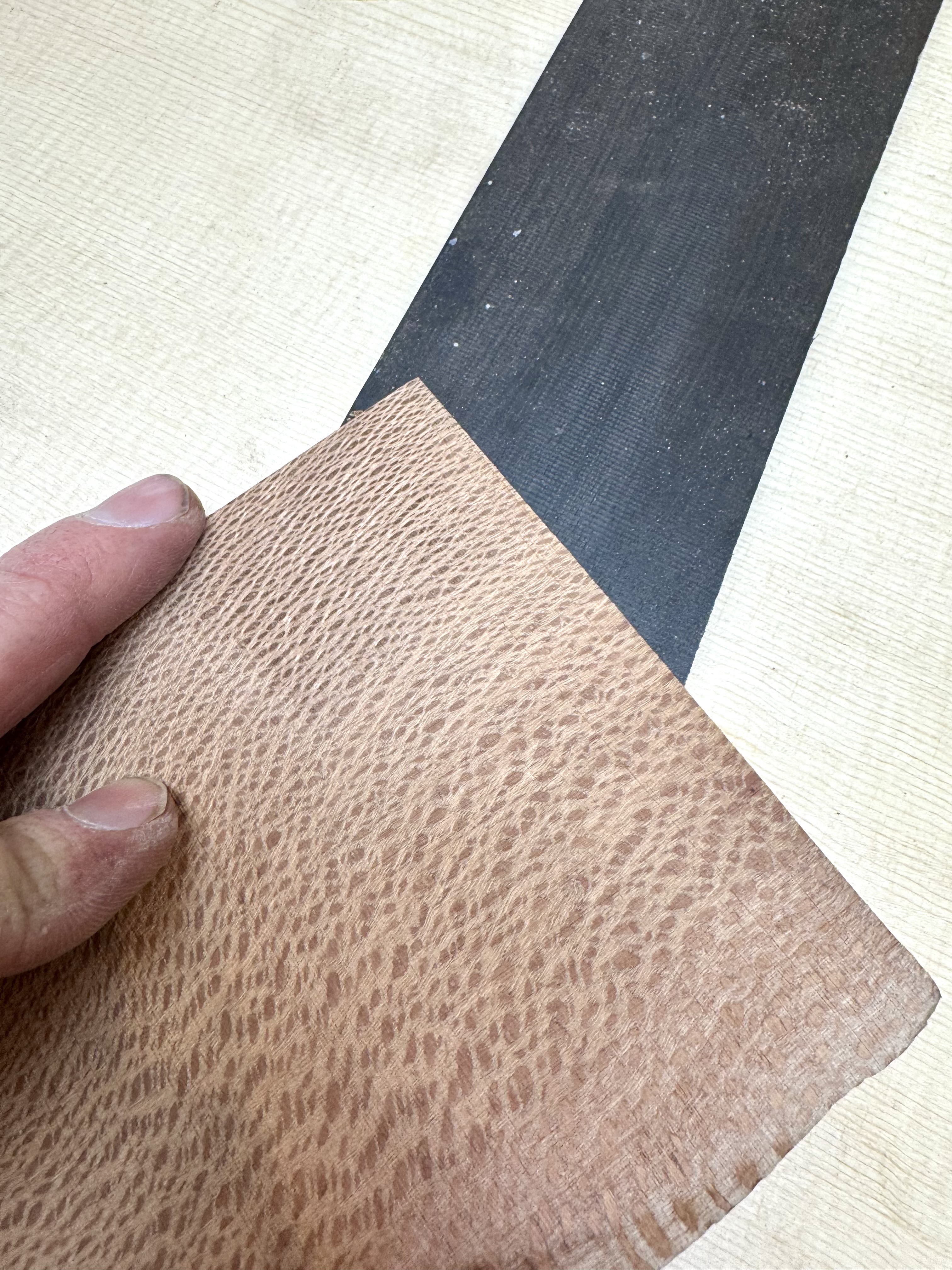

Some more progress shots. Spent a good chunk of the day getting sore hands from scraping ebony bindings, and thanking the gods for ebony dust and superglue.
Started work on the neck, which is laminated Fijian mahogany with an ebony strip.
I also sliced off a bit of what I think is macadamia to use as fret markers. It’s hard and heavy, with gorgeous medullary rays.
