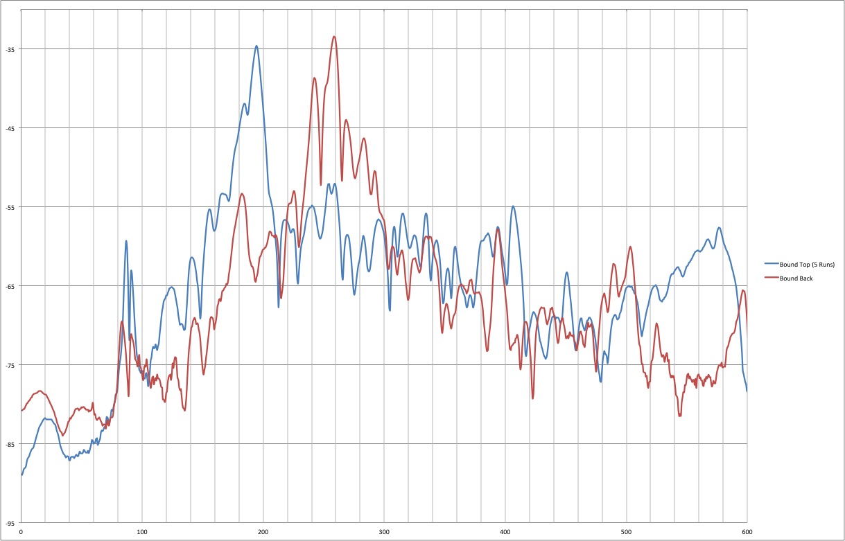

Post by kiwigeo » Mon Sep 03, 2012 6:57 pm
This bldi guitar is going to be the end of me. I redid the tap testing but had guitar sitting on foam pads on my table saw this time around. results are significantly different. Plot shows top and back testing results...average of 5 runs for each. Back resonance has dropped significantly to 257Hz.
T(1,1)1 has dropped to 86.8Hz and T(1,1)2 has dropped to 194Hz. I have yet to re-do Chladni tests on all peaks. Will do this tomorrow and put up results.

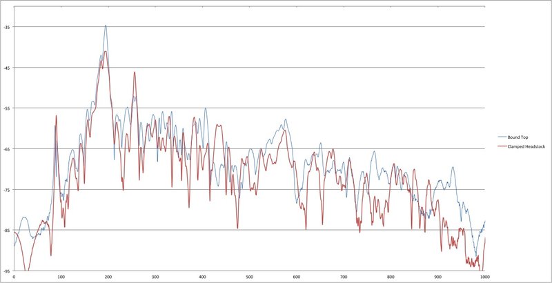

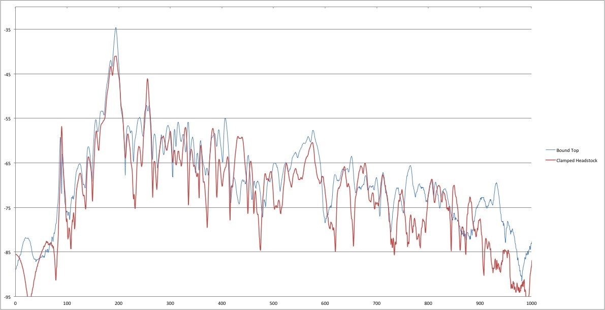

Post by kiwigeo » Mon Sep 03, 2012 8:44 pm
A plot showing spectrum of top with and without 2 G clamps attached to the headstock. Note that with the clamps on the headstock the peak at circa 18Hz disappears but all other peaks remain with some peaks reduced in amplitude. Im no expert (yet) but to me this suggests that the peak at 18Hz is definitely a corpus mode peak but what the other "extra peaks" between the T(1,1)1 and T(1,1)2 peaks are remains uncertain.
