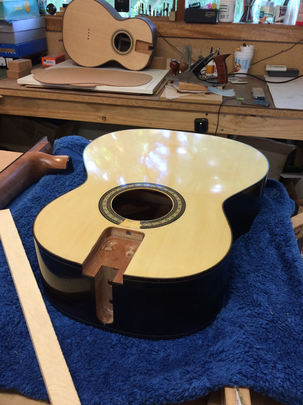

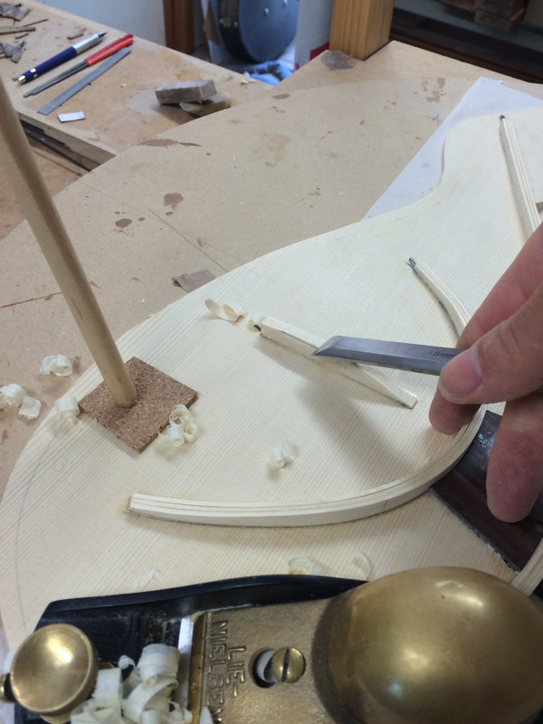

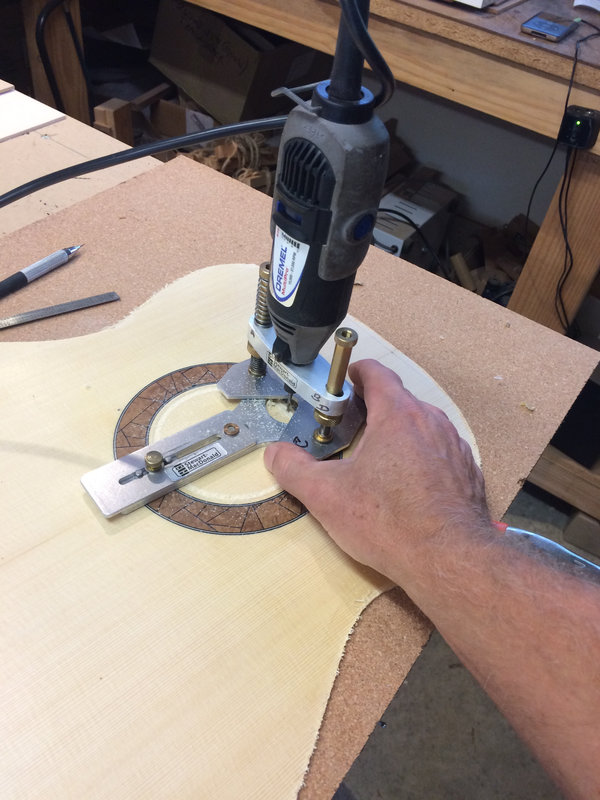

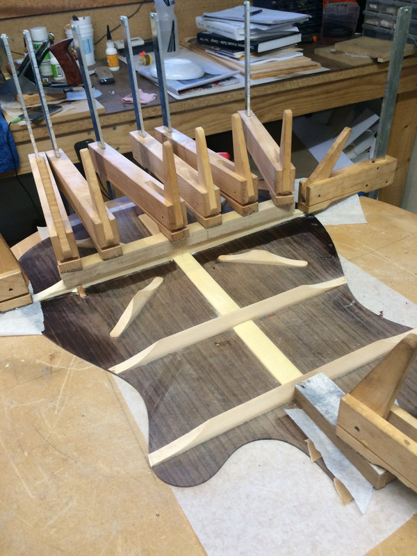

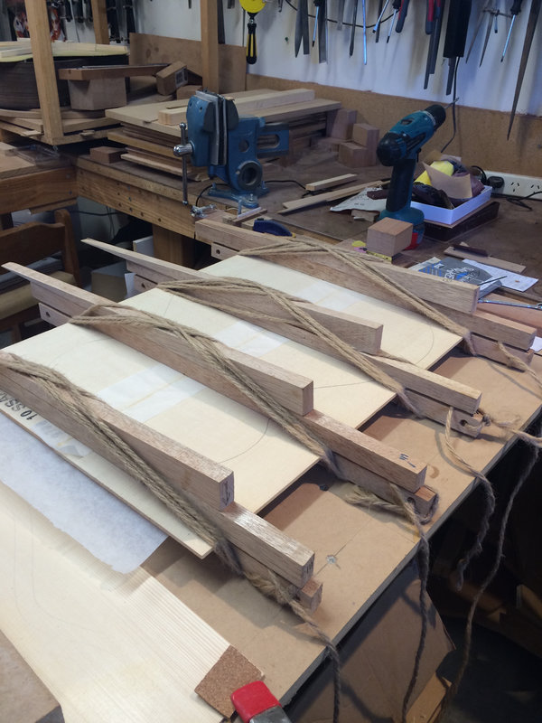

I opted to make up a whole new top rather than modify existing bracing on the old top. The old top centre joins closed up after a day or two and can be fixed with a bit of hide glue and a centre seam patch or two.
A new swiss spruce top (from same log by the look of the wood and serial no) was thicknessed to around 2.8mm (2.7mm final target) and braced up using red spruce for the bracing. Bracing will be 9mm high over the bridge. A new rosette was made up...IMO it turned out a bit better than the first one. The lower back brace has been modified to stiffen it up a bit.

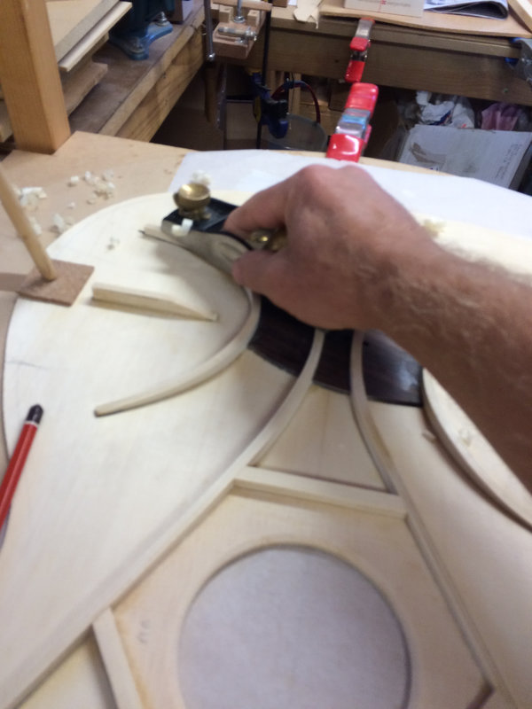

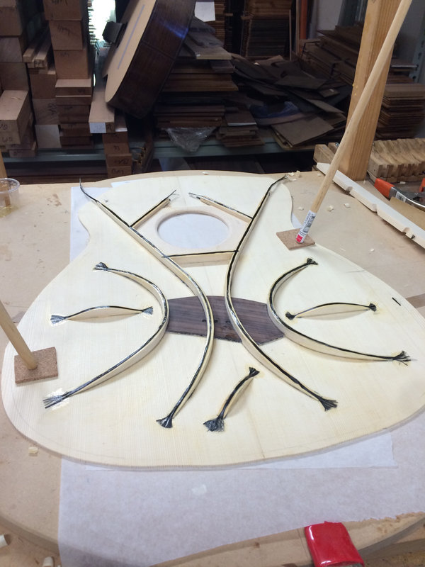

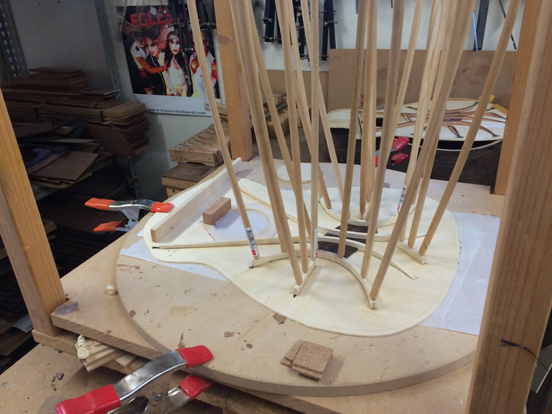

Bracing all done and topped with CF tow. UTB has been slotted and is ready to glue in and the top is finished.
Also managed to get the top of a falcate braced classical started...this guitar has been on the bench for 2 years. First neck wasn't quite right so made another one. The top is Englemann and was furry as hell even after several egg white sizing and sanding back sessions. The sheallc seal coat raised enough grain that the fibres were breaking through the shellac after a few body sessions. I gave it a good level with 800 grit wet and dry and walnut oil and it seems to have got rid of most of the nibs. In the background is a parlour guitar (falcate braced) waiting pore filling and french polishing.

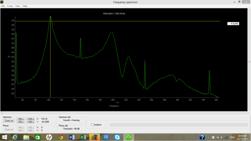

Got the new top on last night and this morning did some tap testing. Results as follows:
T(1,1)1: 103Hz
T(1,1)2: 197Hz
T(1,1)3: 224Hz

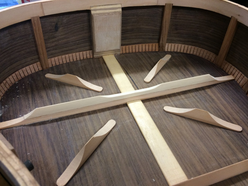

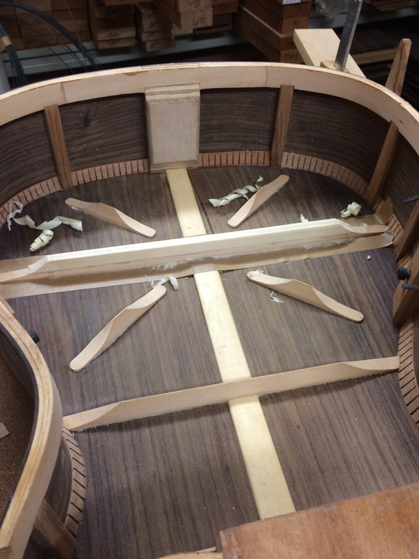

Pics of the modified lower back brace. The centre section of the brace was taken from 21mm down to 15mm.

That looks a bit more normal, but the back still seems low in frequency for a brace that big.
What produces the odd harmonics on the mains frequency?
Re: Current Build - Falcate Braced Multiscale OM cutaway
The odd harmonics are from the laptop power pack. I normally run on the battery when doing testing but this was just a quick run. Theres also a power pack for the pre-amp which sometimes puts out a bit of noise. I also usually run mic and preamp cables more carefully but this time the mic cable was probably closer than usual to the pre-amp power pack.Trevor Gore wrote:That looks a bit more normal, but the back still seems low in frequency for a brace that big.

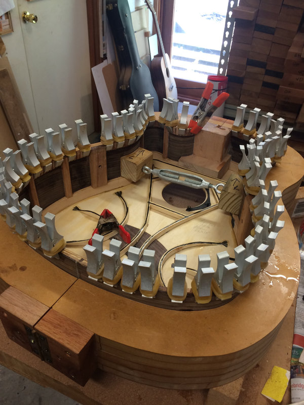

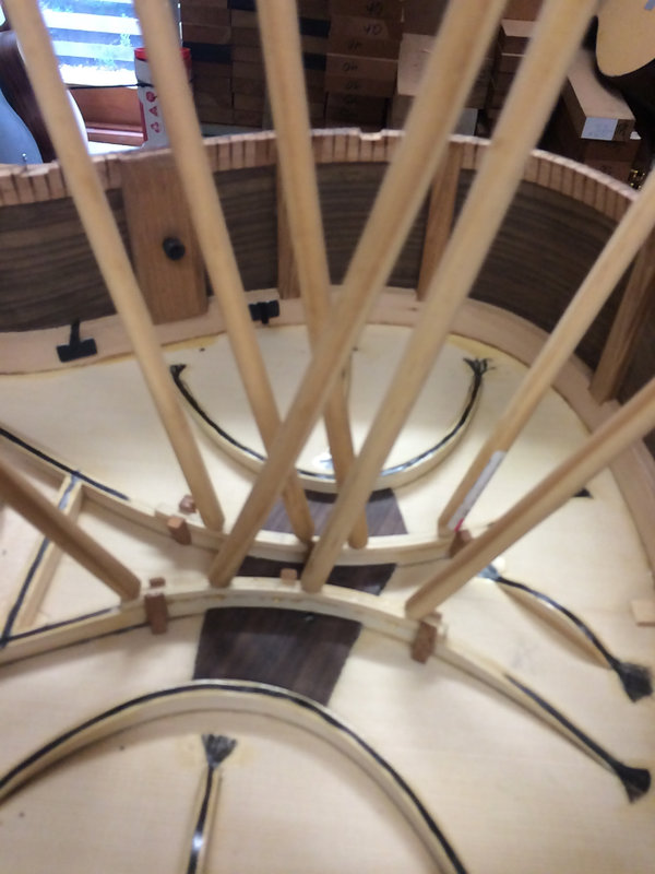

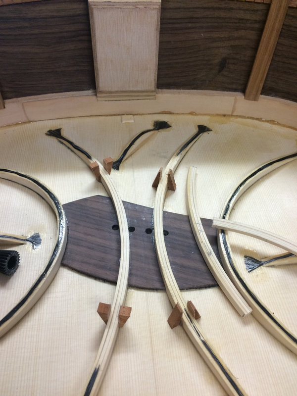

The back is off and the patient is undergoing surgery:
1. beefing up primary top bracing to get T(1,1)2 up over 200Hz.
2. Replacing lower back brace with a new one....slightly higher to get T(1,1)3 up a bit.
Am I crazy? No...just completely anal.

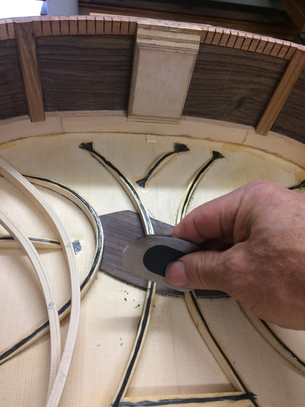

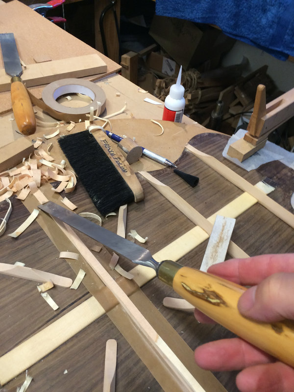

Shaving CF tow off top of primary braces Tantelone guides for the brace extensions. Brace extensions glued in Off with the old back brace And on with the new one

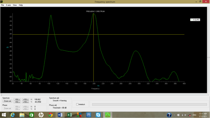

Got the back on and did a quick tap test:
T(1,1)1 - 104Hz
T(1,1)2 - 199Hz
T(1,1)3 - 239Hz taping and micing back. The peak is not coming through when tapping the top. The back brace is 23mm high and I didnt take any meat out of the middle so there's room for trimming this peak down to 226Hz

Did some more thorough Tap testing today (average of ten runs) and got some better results:
T(1,1)1 - 104Hz
T(1,1)2 - 202Hz
T(1,1)3 - 240Hz (from testing on back - peak not visible on top spectrum)
Plan now is to drop T(1,1)2 by a maximum of 5Hz with thinning of the periphery of the lower bout.
Do the binding and then address trimming of the back resonance by trimming the lower back brace.

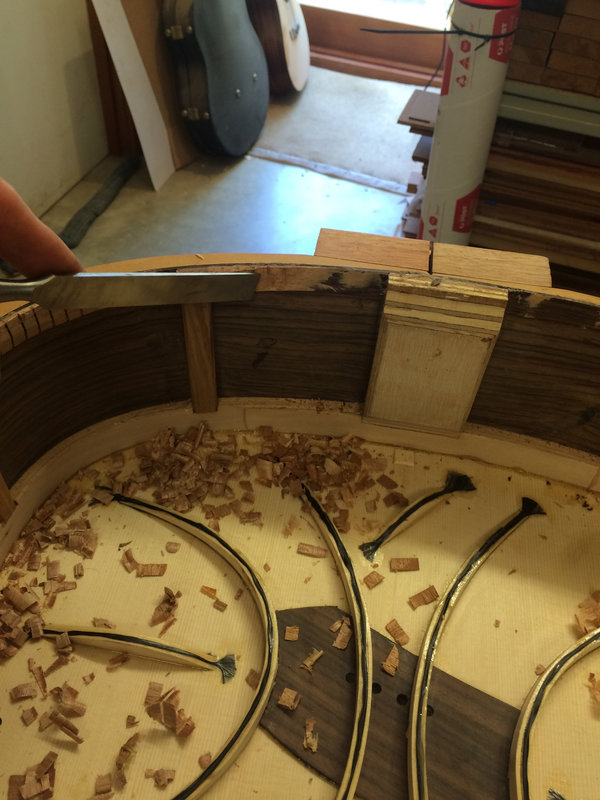

Back's off again......was a bit "humpy" around the edges in two spots. Good enough for most but not good enough for me.
While the backs off I replaced the back linings, laid some extra CF tow on the primary and secondary braces to add a bit more stiffness and took a bit of mass off the side mass anchor splints.

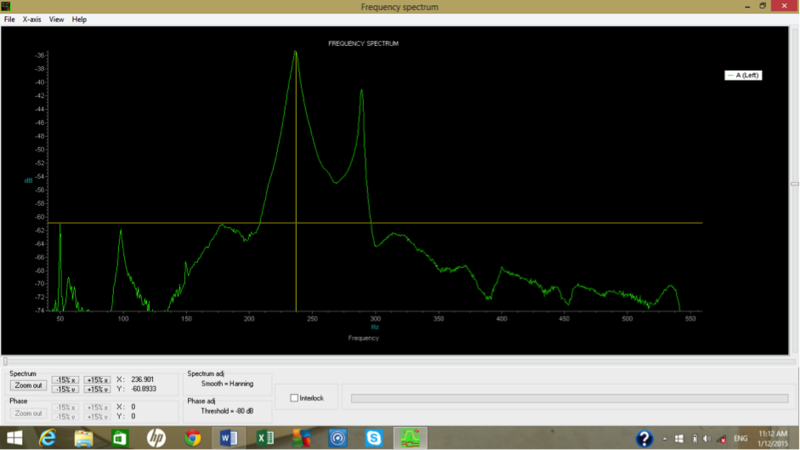

Got the back on the instrument and have done some Tap testing.
T(1,1)1 - 104.5Hz
T(1,1)2 - 200Hz the extra CF on the top braces doesnt seem to have added much stiffness.
T(1,1)3 - 235Hz. Another strong peak at 288.9Hz

I tried sticking some dummy bridges to the top and noted drops in T(1,1)2. Frequency drops worked out at 0.6Hz/gm pretty much as in the books. Assuming a bridge weight of 27gms Im expecting the bridge to drop T(1,1)2 by about 16Hz. This means I can only afford to drop the main top resonance by around 4Hz.
With the above in mind I plan to do some minimal thinning of top periphery keeping a careful eye on frequencies.
Back does not appear to be coupling with the top at present. Ill address any modifications to the lower back brace once bindings are on.
