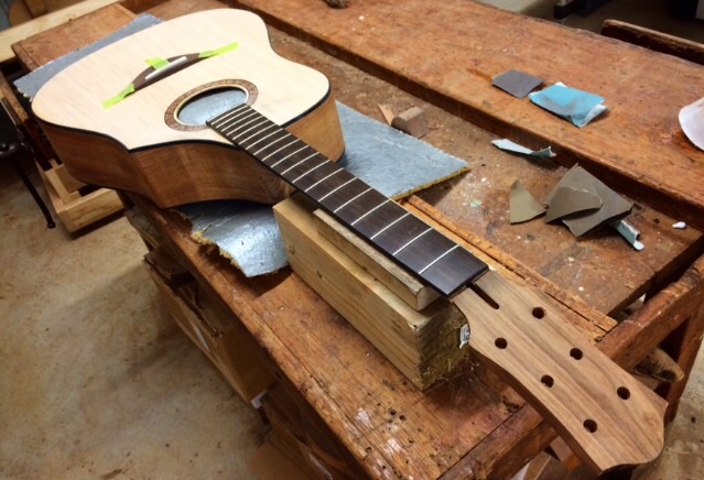

Fretwork done this arvo. This was the third guitar I fretted this arvo. Pretty much over fretwork for the day.

Scandinavian Redwood top with Silky Oak back and sides:
