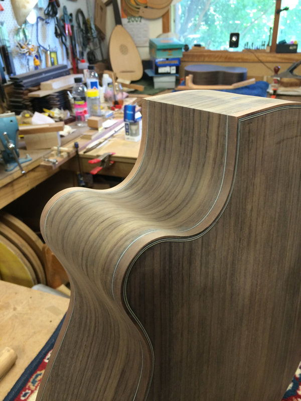

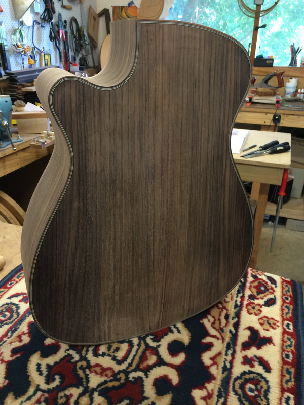

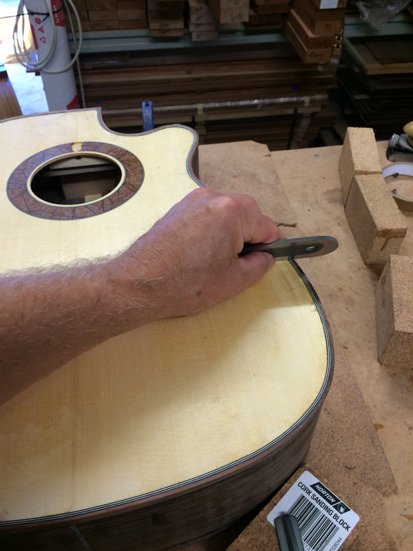

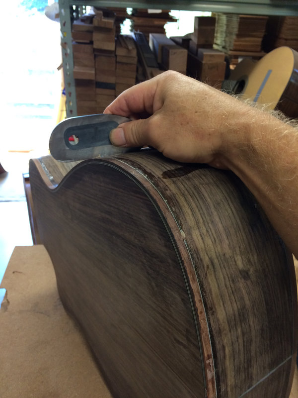

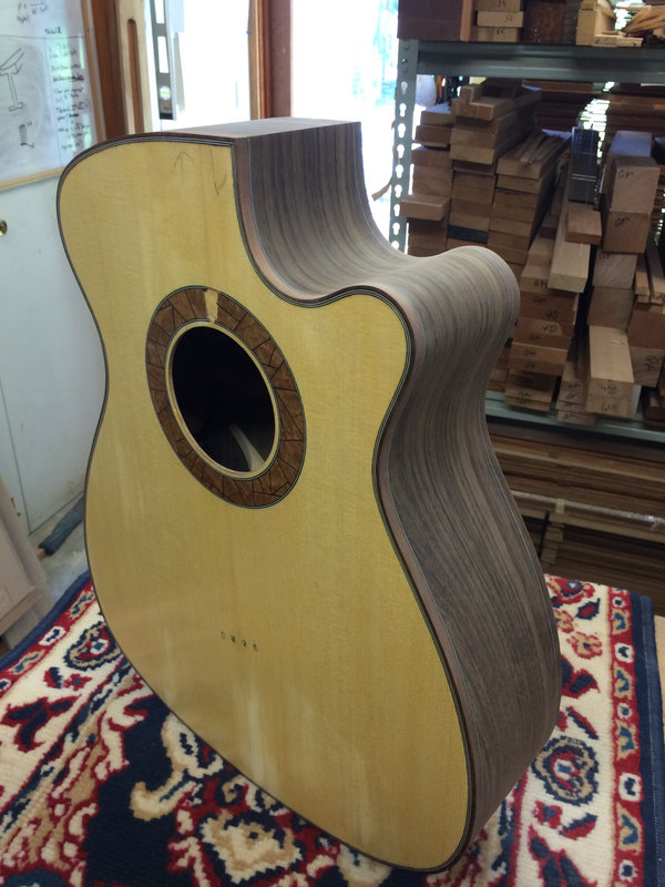

Post by kiwigeo » Wed Dec 09, 2015 5:09 pm
Top bindings scraped back and everything trued and trimmed up. Just the butt graft to go on and thats the body done. That cutaway was a f****ng pain to get right...but man with the binding done it sure looks worth the effort!! :gui
Trevor Gore
Posts: 1643
Re: Current Build - Falcate Braced Multiscale OM cutaway
Post by Trevor Gore » Wed Dec 09, 2015 5:30 pm
kiwigeo wrote:
Trevor Gore wrote:Hey Martin, how thick are those bindings? Maybe that's why the blackwood was so difficult?
These BRW bindings are 2mm thick but the blackwood bindings were alot thinner. The BRW bends easily even at 2mm thick.
Must be a trick of the lens :D. They look a lot thicker than my 2mm bindings. I was assuming each B and each W was 0.5mm.
I do the blackwood ones at 2.0mm, about 6.5 - 7.0 high and then a B/W on the bottom takes them to ~8.0mm high, all up. Bending around the cutaway tends to go OK, but getting the "crown" bent in bindings that tall for the 3m back dome isn't too easy.
Anyway the BRW is looking pretty good!

Hi Martin,
Build is looking great. I wanted to ask you about your technique with the stewmac scraper. I might just be an idiot but I bought one and tried it on the binding on my latest build and couldn't get it to work well. I went back to traditional card scraper which was much more effective. Any tips?
Jeremy D
Post by kiwigeo » Thu Dec 10, 2015 8:33 am
Jeremy D wrote:Hi Martin,
Hi Jeremy,
I find Im using my Carruth scrapers more than my card scrapers these days. The main trick with the Carruth scrapers is to get a good edge on them on the grind stone. I first lap both sides of the scraper on a Japanese water stone and then dress the edge on the grinder with a fine stone. The important thing is to make sure the face of the wheel is exactly flush with the edge face of the scraper. I run a felt pen over a section of the edge so i can see where the stone is taking metal off the edge. Working on bindings I use the larger Carruth scraper and I make sure that most of the flat edge is registered on the guitar side so the bindings stay square to the top.
Hope this helps
Post by kiwigeo » Thu Dec 10, 2015 8:48 am
Jeremy D wrote:Thanks Martin,
I guess I just assumed they came sharp enough to use. I will have a look at sharpening it.
Cheers.
Jeremy, those scrapers come with instructions on dressing them. Let me know if you don't have the instruction sheet and I can flick you a scan of mine.
Post by Mark McLean » Thu Dec 10, 2015 10:34 am
When I got my Carruth scraper I tried it straight out of the box and it did nothing. But after you set them up they are great, and I now prefer it to a traditional card scraper.
Martin has covered it above, but if you prefer pictures, Al's video on the Stew-Mac website walks you through the sharpening process pretty well.

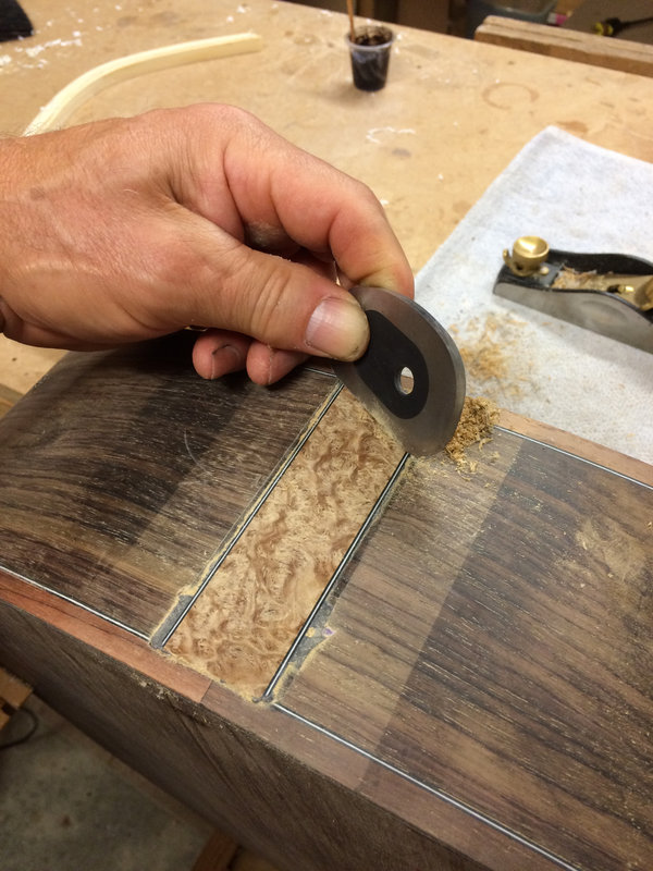

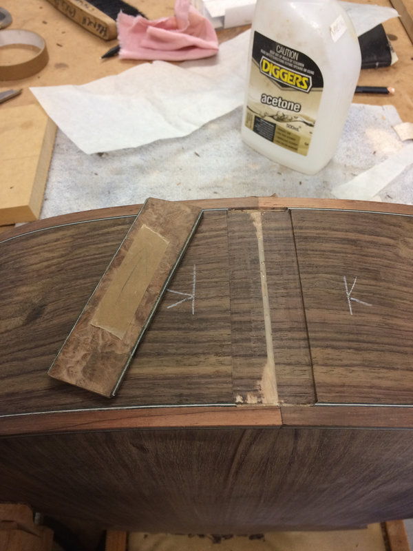

Post by kiwigeo » Fri Dec 11, 2015 10:42 pm
Not much work in the shop today. Ran some Coobah burl through the drum sander for the butt strip but cracked the wood in half while prizing it off the carrier board. Gave up and went to the pub for the rest of the day. :gui :gui

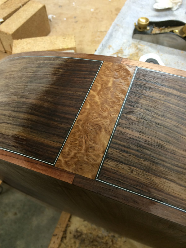

Post by kiwigeo » Mon Dec 14, 2015 9:27 pm
Coobah burl butt strip to match the rosette.

Post by johnparchem » Tue Dec 15, 2015 2:49 pm
The burl looks great! Nice choice.
Post by kiwigeo » Tue Dec 15, 2015 3:45 pm
johnparchem wrote:The burl looks great! Nice choice.
Thanks John. The coobah is brittle stuff to work with but I managed to pull it off in the end.

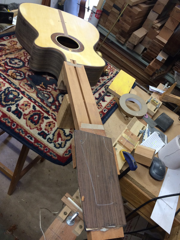

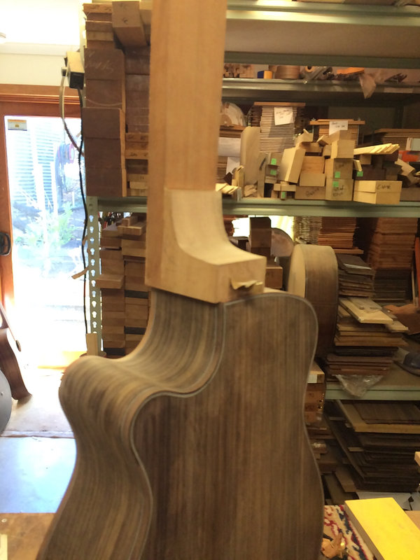

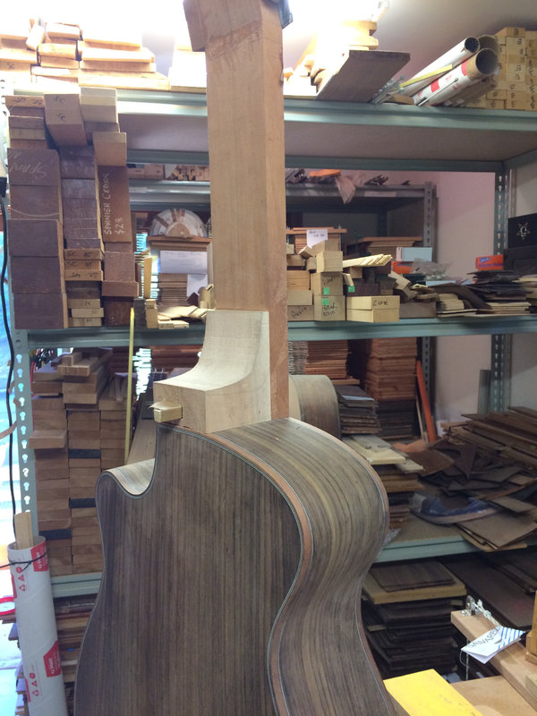

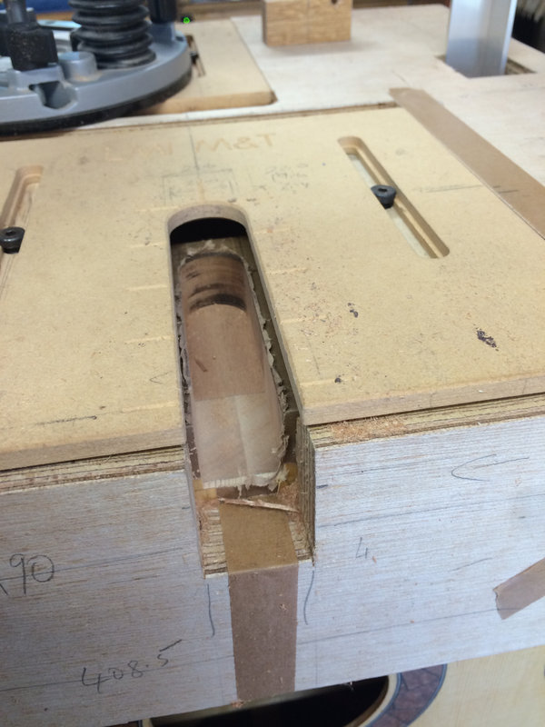

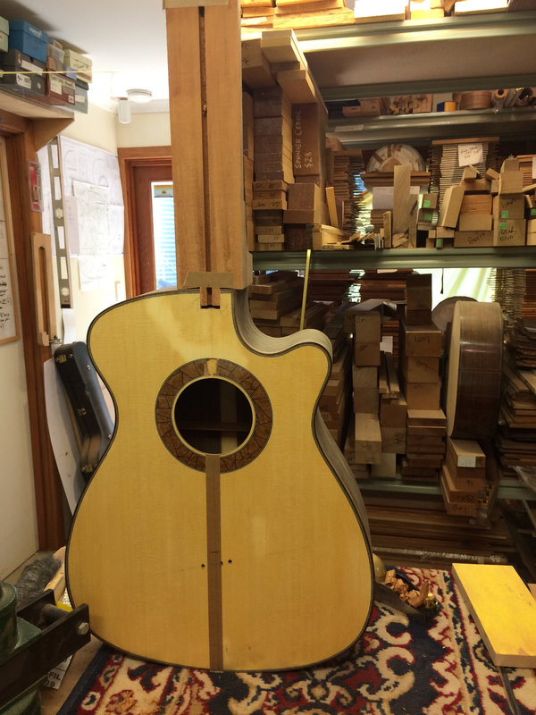

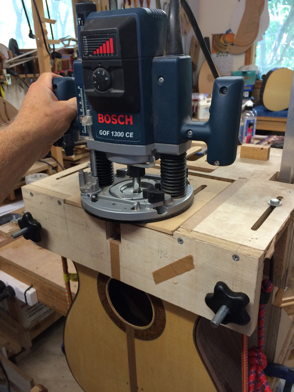

Post by kiwigeo » Tue Dec 22, 2015 11:34 am
A bit more progress in between heat waves here in Adelaide. Got the neck mortise cut and the neck bolt holes drilled after rough fitting the neck. Still about 0.5mm low at the saddle but will fine tune that to the requisite 2.5mm.
Post by Mark McLean » Tue Dec 22, 2015 1:35 pm
So - a piece of masking tape up the middle of the top so you can draw a line to get the neck aligned with. That is very simple and smart. Am I the only one who hasn't ever thought to do that?
And just how many neck blanks do you have stashed away there?
Post by kiwigeo » Tue Dec 22, 2015 4:50 pm
Mark McLean wrote:So - a piece of masking tape up the middle of the top so you can draw a line to get the neck aligned with. That is very simple and smart. Am I the only one who hasn't ever thought to do that?
The masking tape...it's there because the centre line doesn't always coincide exactly with the top join.
The pile of neck blanks in the background....left side of the pile is Fijian Mahogany but it's flat sawn. I slice it up and make laminated necks with the grain going in a more favourable direction. Also in the pile is a fair bit of Spanish Cedar...alot of it bought before it got CITES listed.

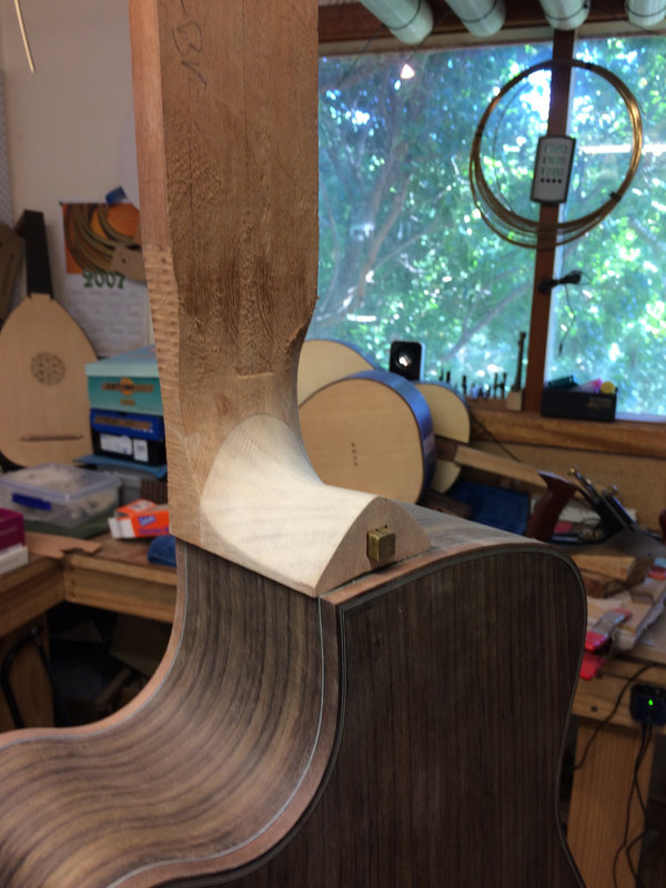

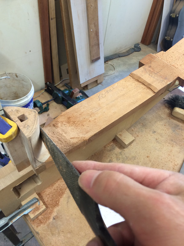

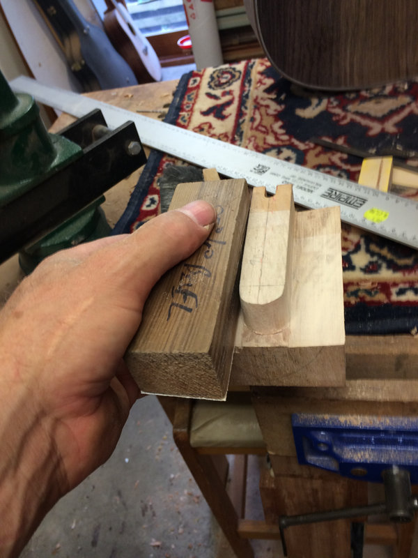

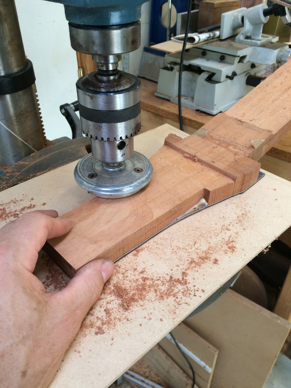

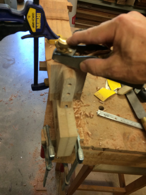

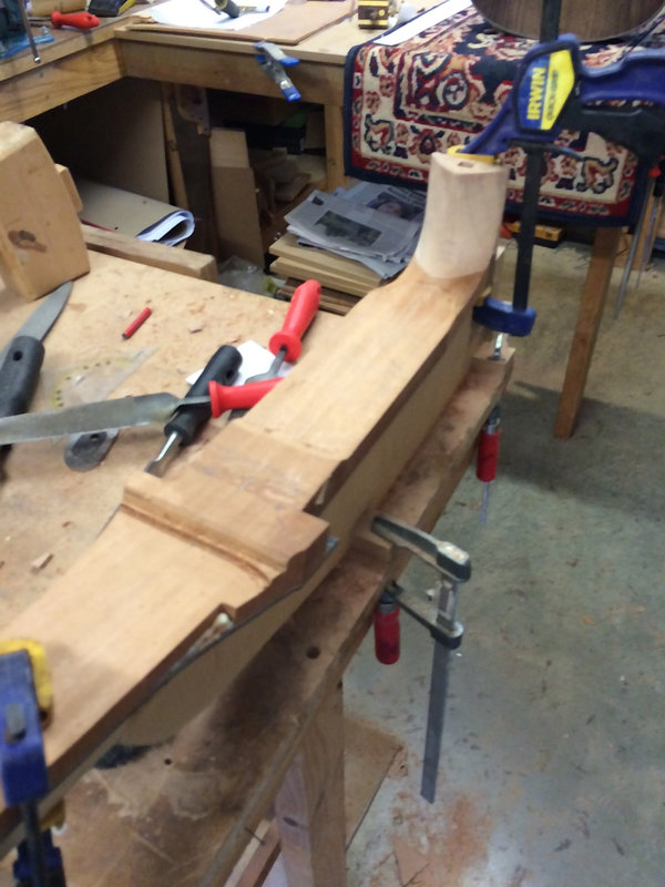

Post by kiwigeo » Sun Dec 27, 2015 7:38 pm
Neck thicknessed with the Safe-T-Planer and the heel block shaped.
