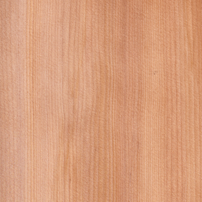

What's the new block made from Matthew? Looks like it might be Douglas Fir.

this one is made from western red cedar, as dense as I could find, built up from three pieces

That neck block looks a lot like hemlock to me. They can be similar in appearance, but hemlock lacks the hamster cage smell and it doesn't dent as easily.
