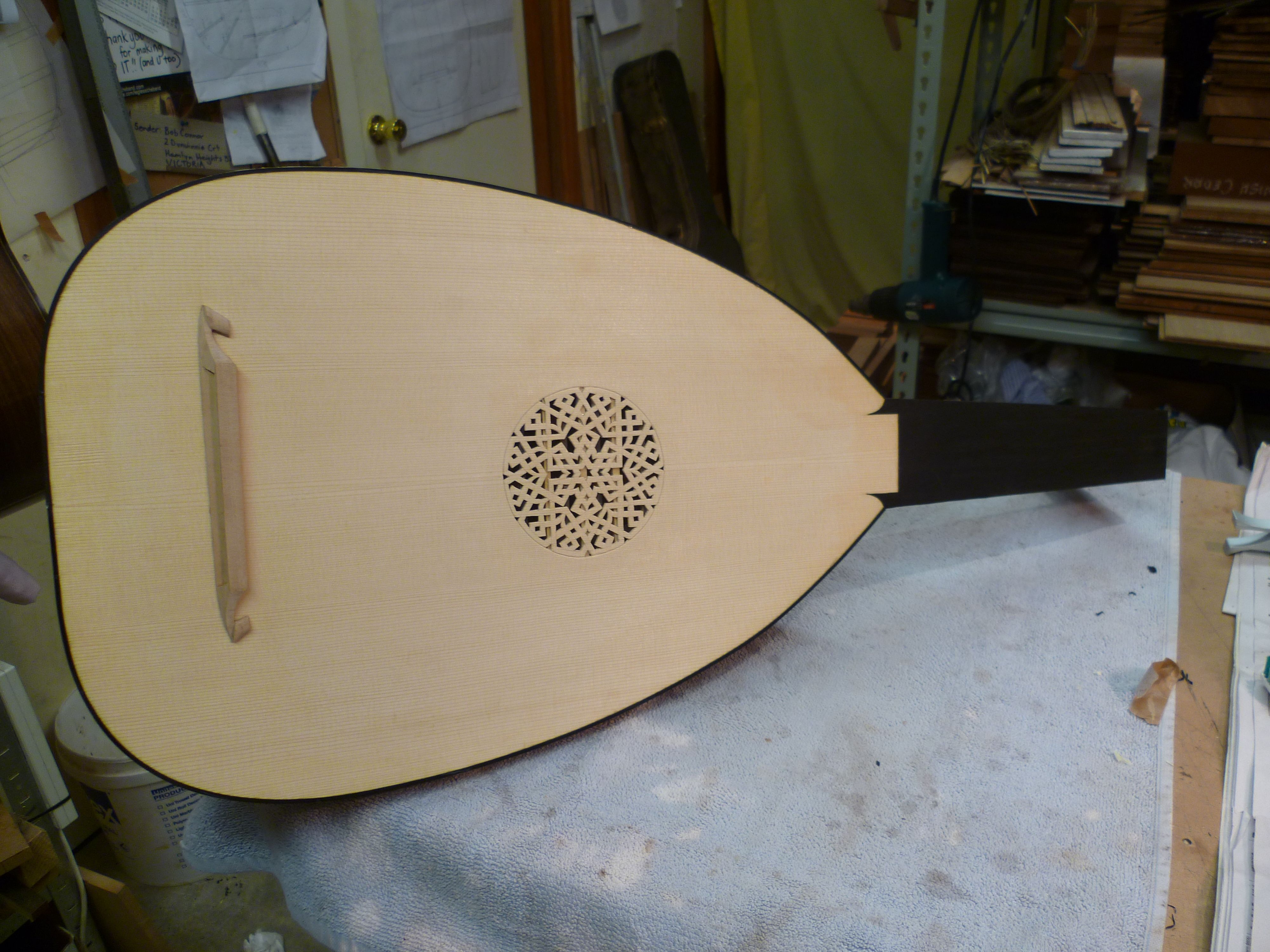

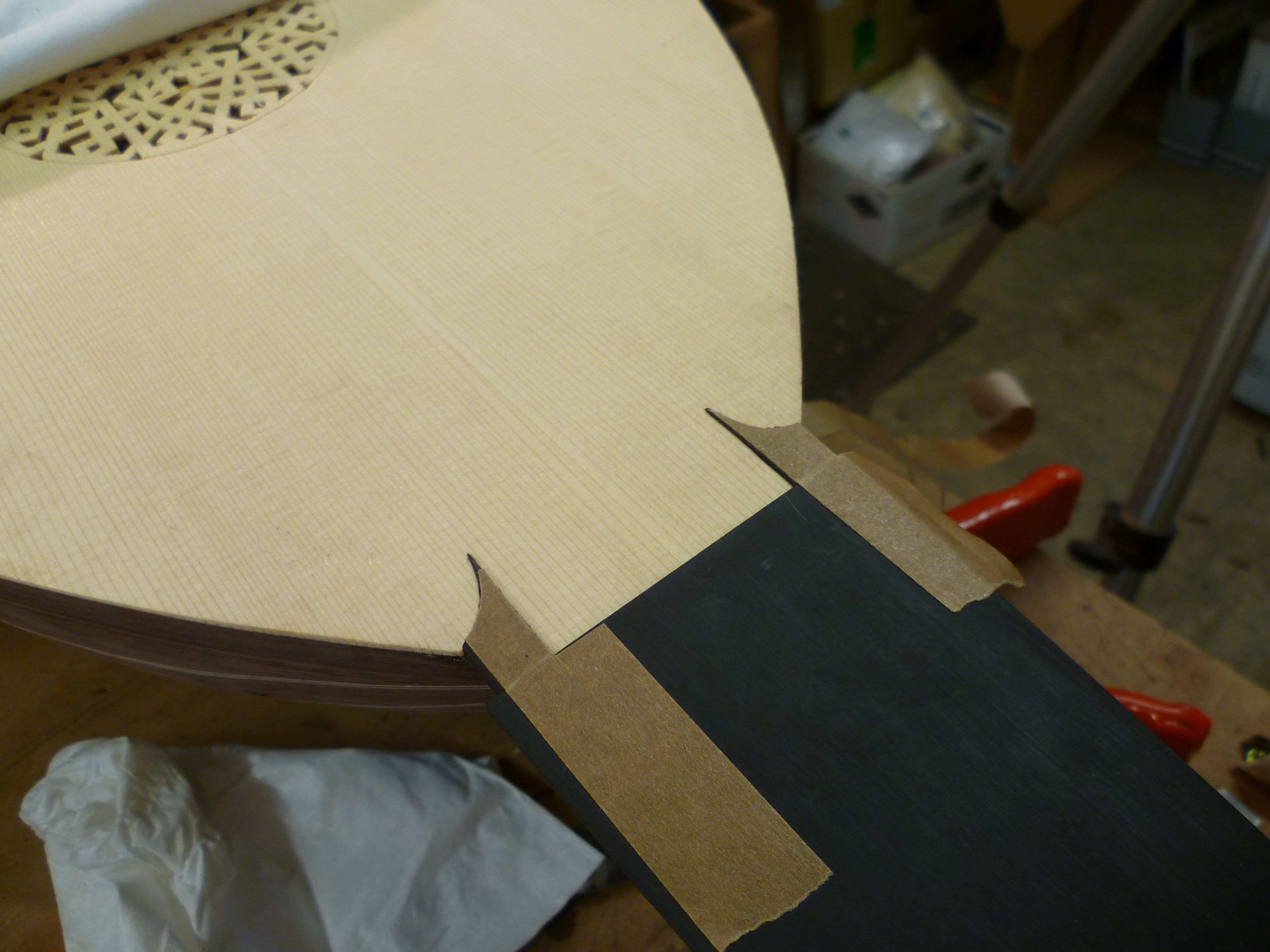

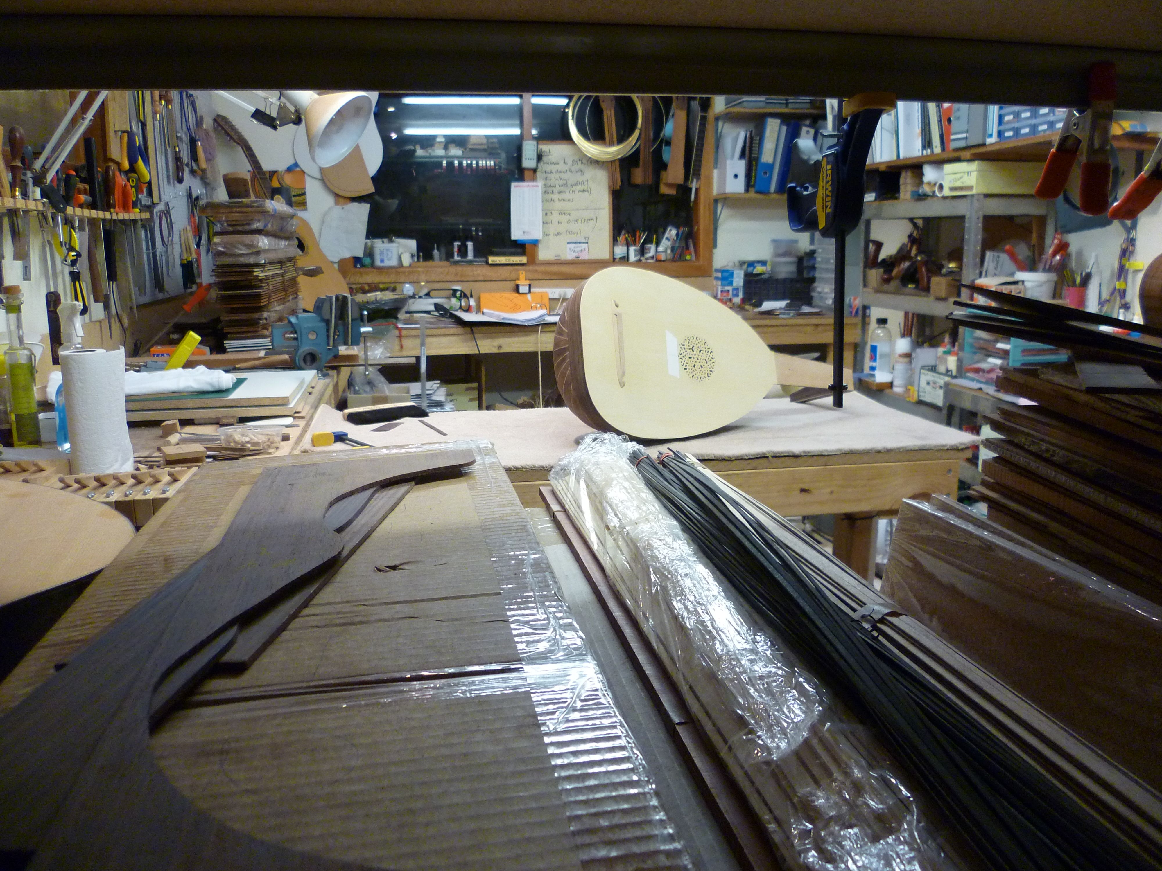

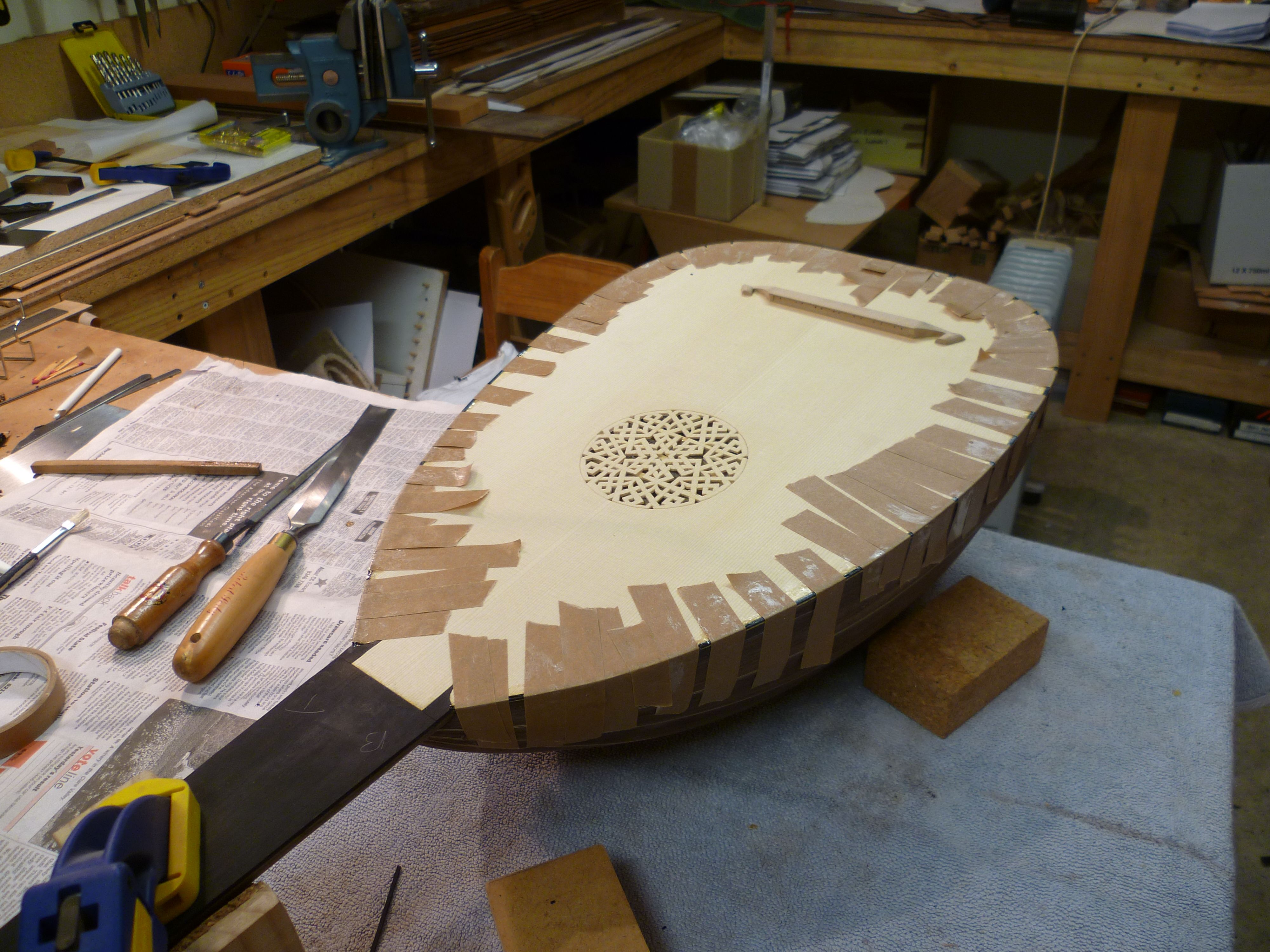

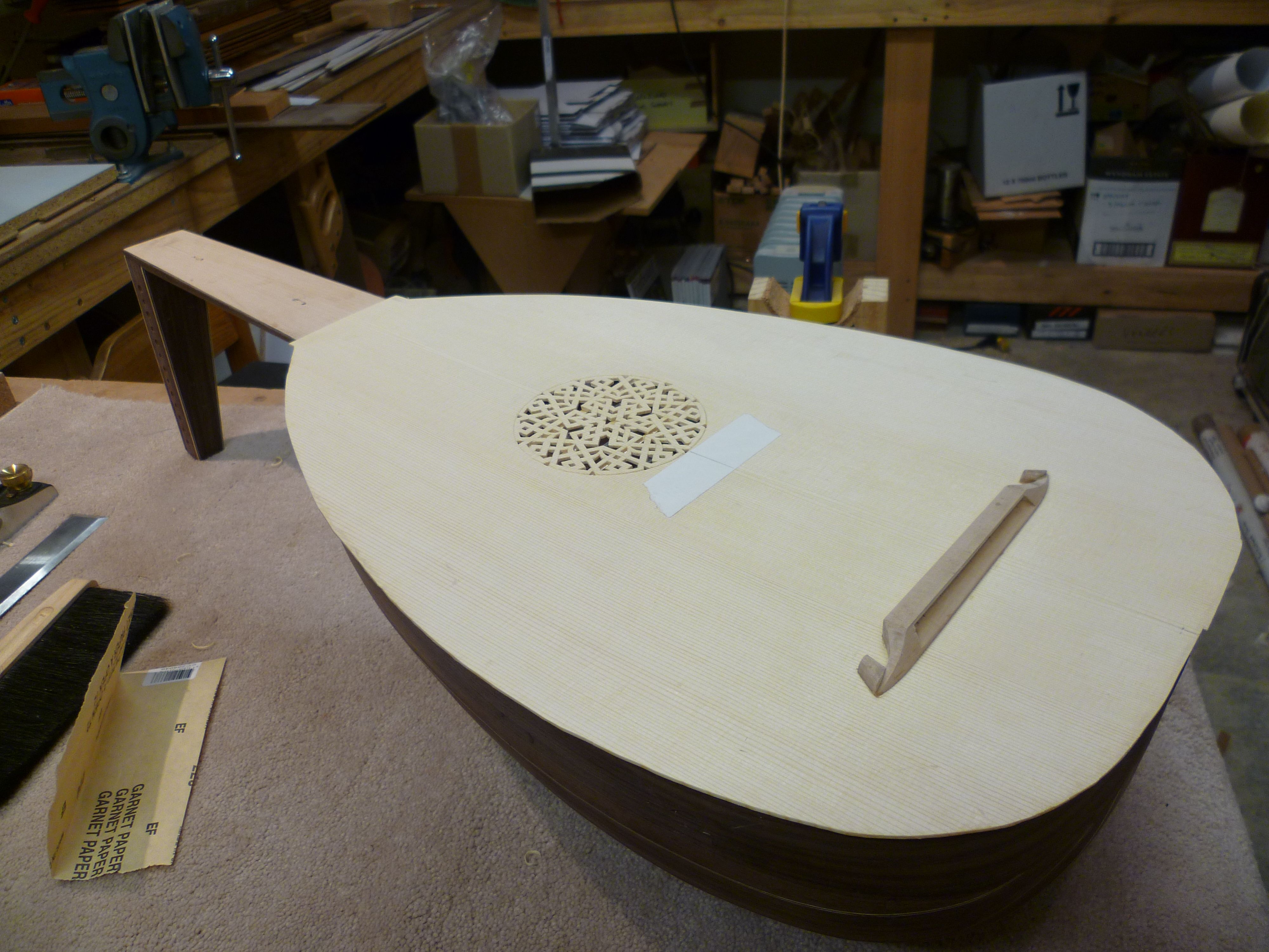

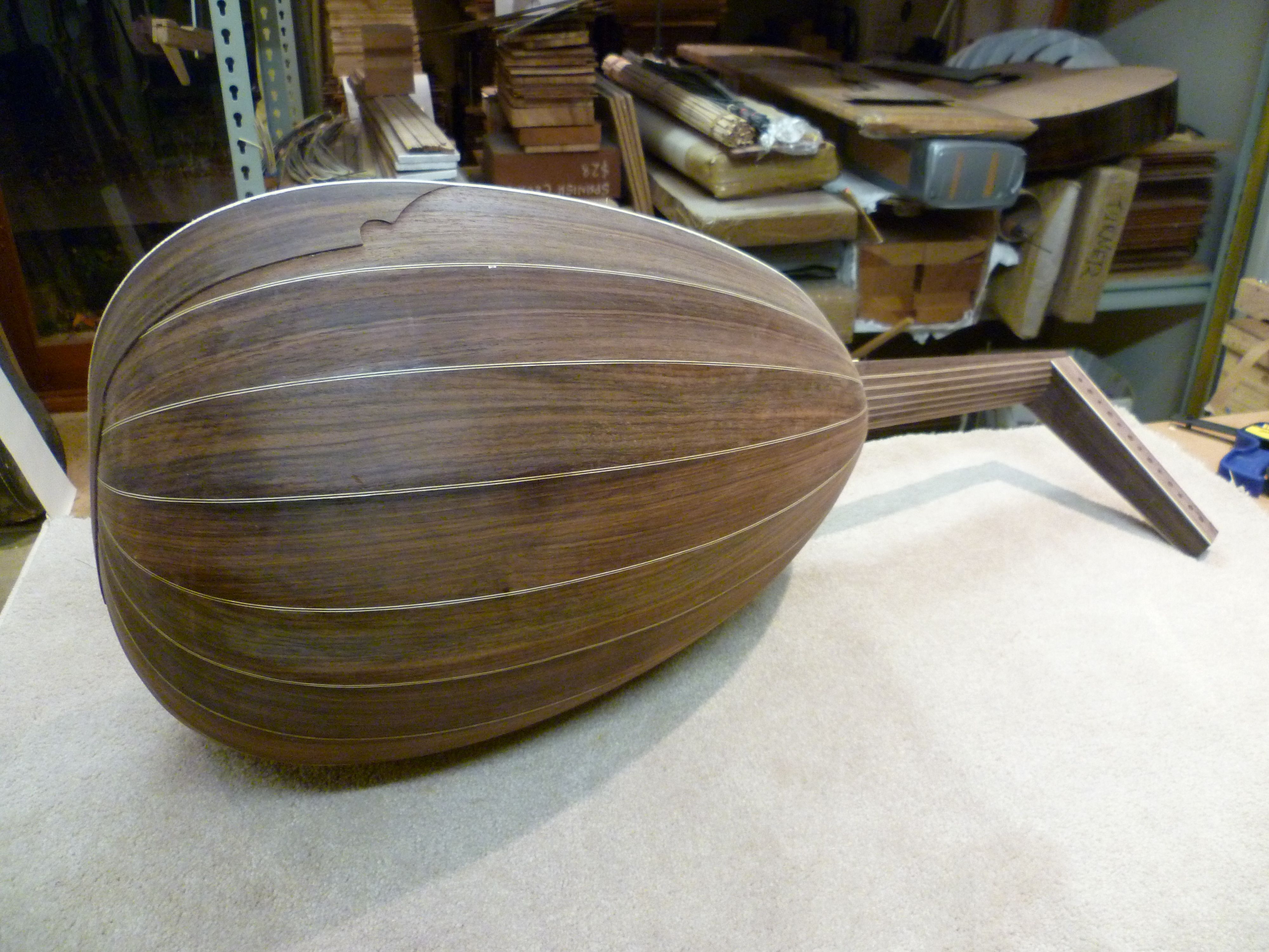

One last pic of the beast with the binding tape and top rough trimmed. This will be about as far as I go for a while.

Thanks Lillian. Stunning but also exhausting. Ive had a week and a half of working on this instrument and I now need a rest. The learning curve on this one is really steep and there's just so much room for disaster. Ill be glad to get back to work next week and have a rest from the lute.

Umm, looking at your stash there I see several packages yet to be decanted. Just wondering why you haven't opened them. Most of mine arrive in plastic, but that could be because I have 9 months of rain a year up here. 8)
Lack of time Lillian......my wood shelves need a good clean up and I need to find out exactly what I have on them.

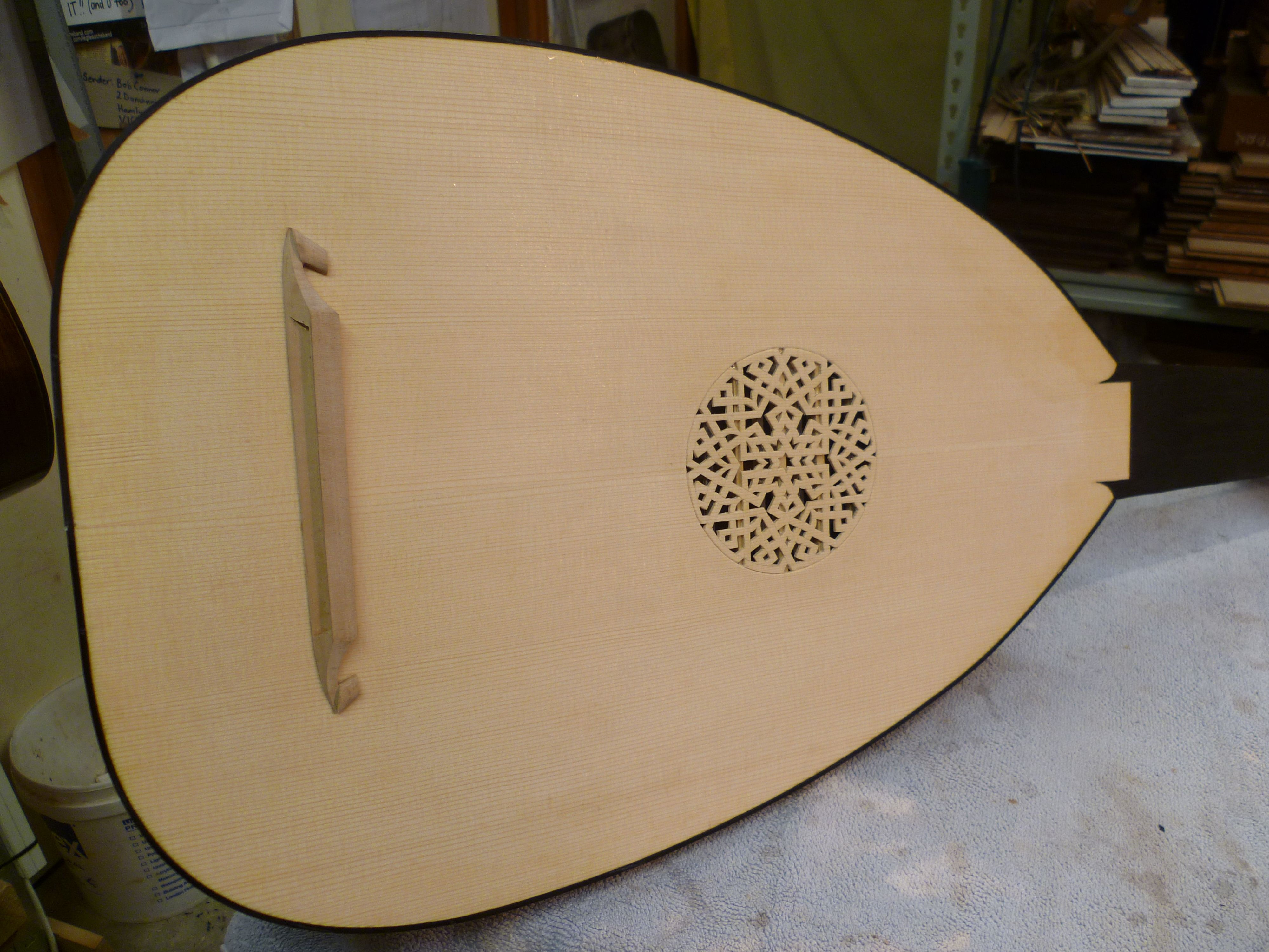

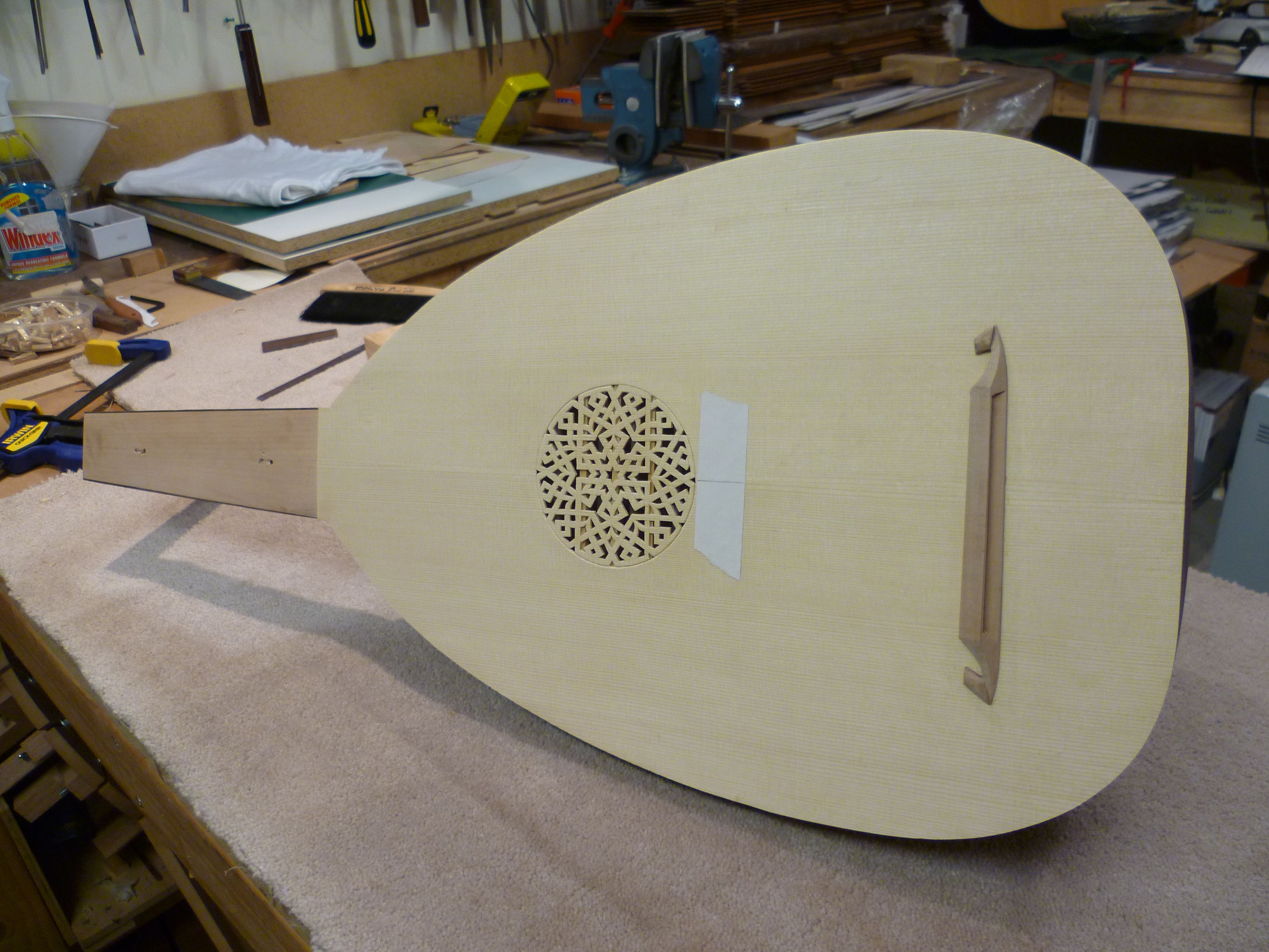

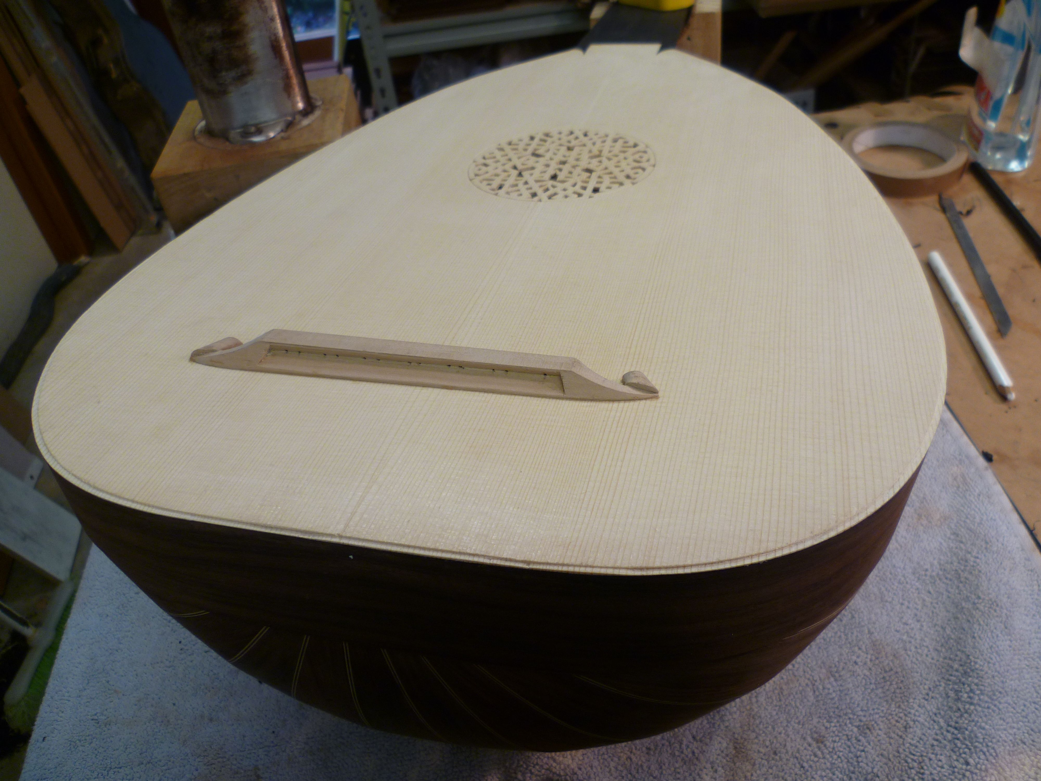

Top trimmed up. It's amazing how strong this instrument is once the top is glued on....

It'd make a good squash racquet if it doesn't play very well :wink: . Looks great Martin & I'll expect a full recital (complete with cod piece) on your next visit home.
I see you are a bit like me & hord your offcuts as well :oops: (the "that could be useful one day" approach) I almost feel guilty throwing nice bits of wood away.

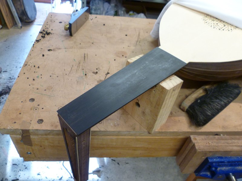

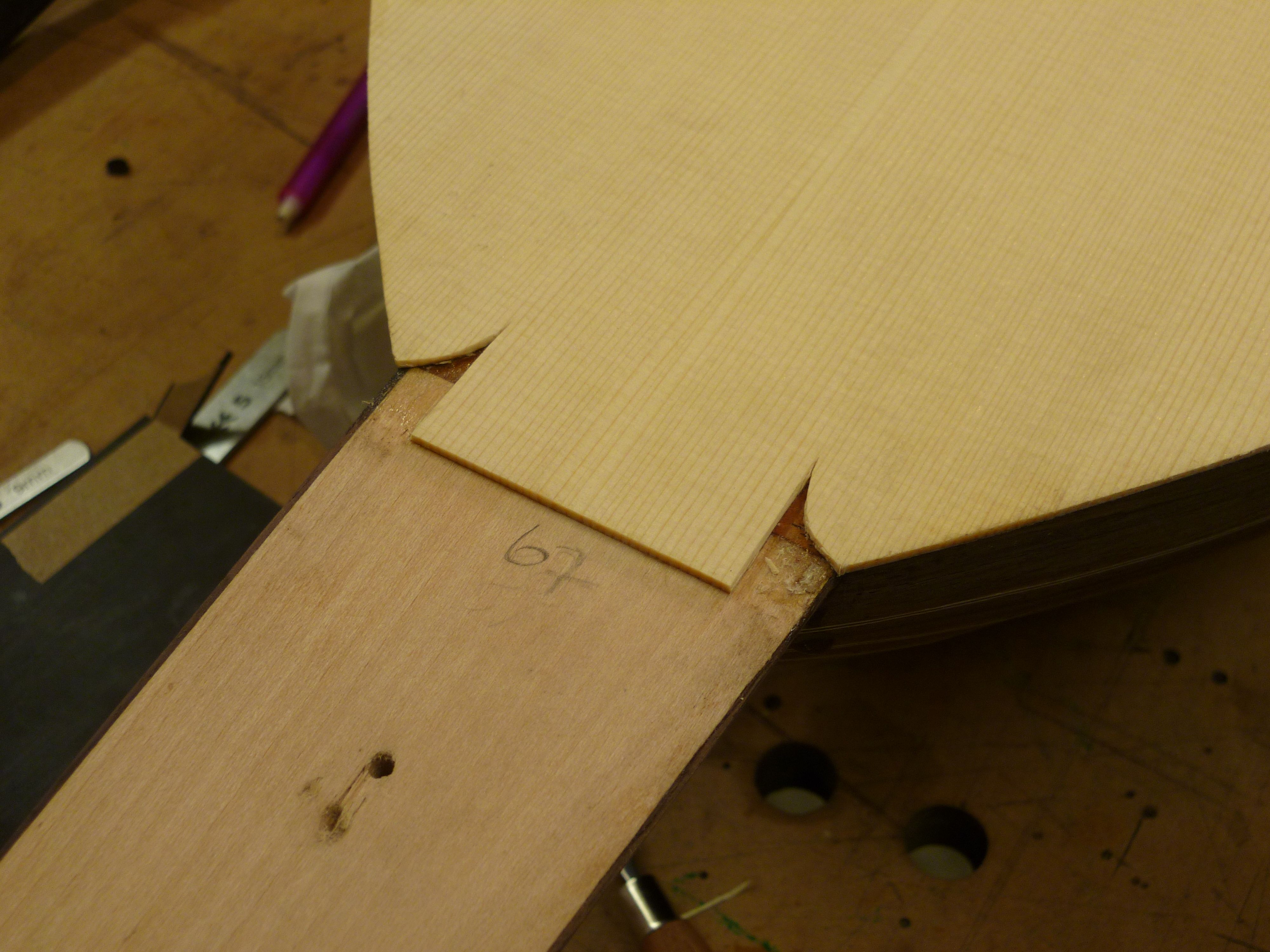

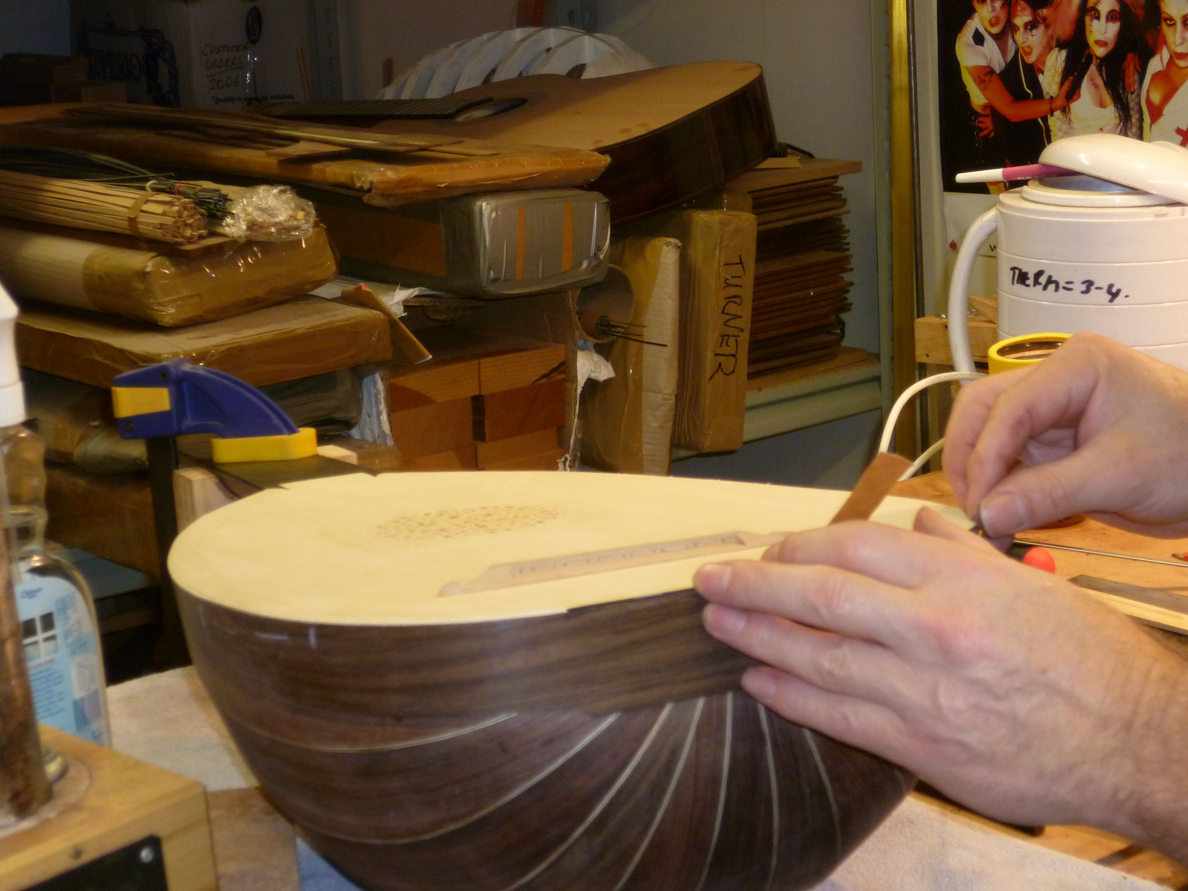

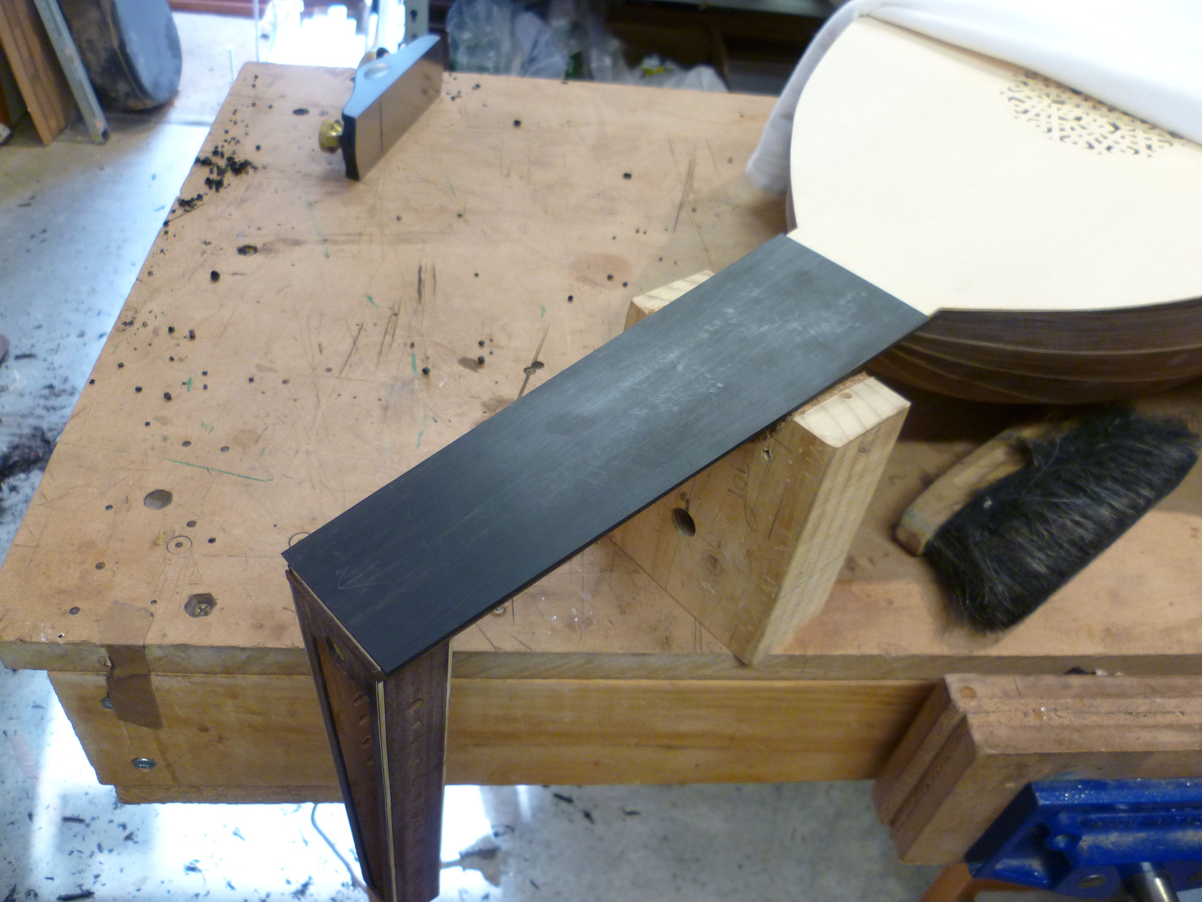

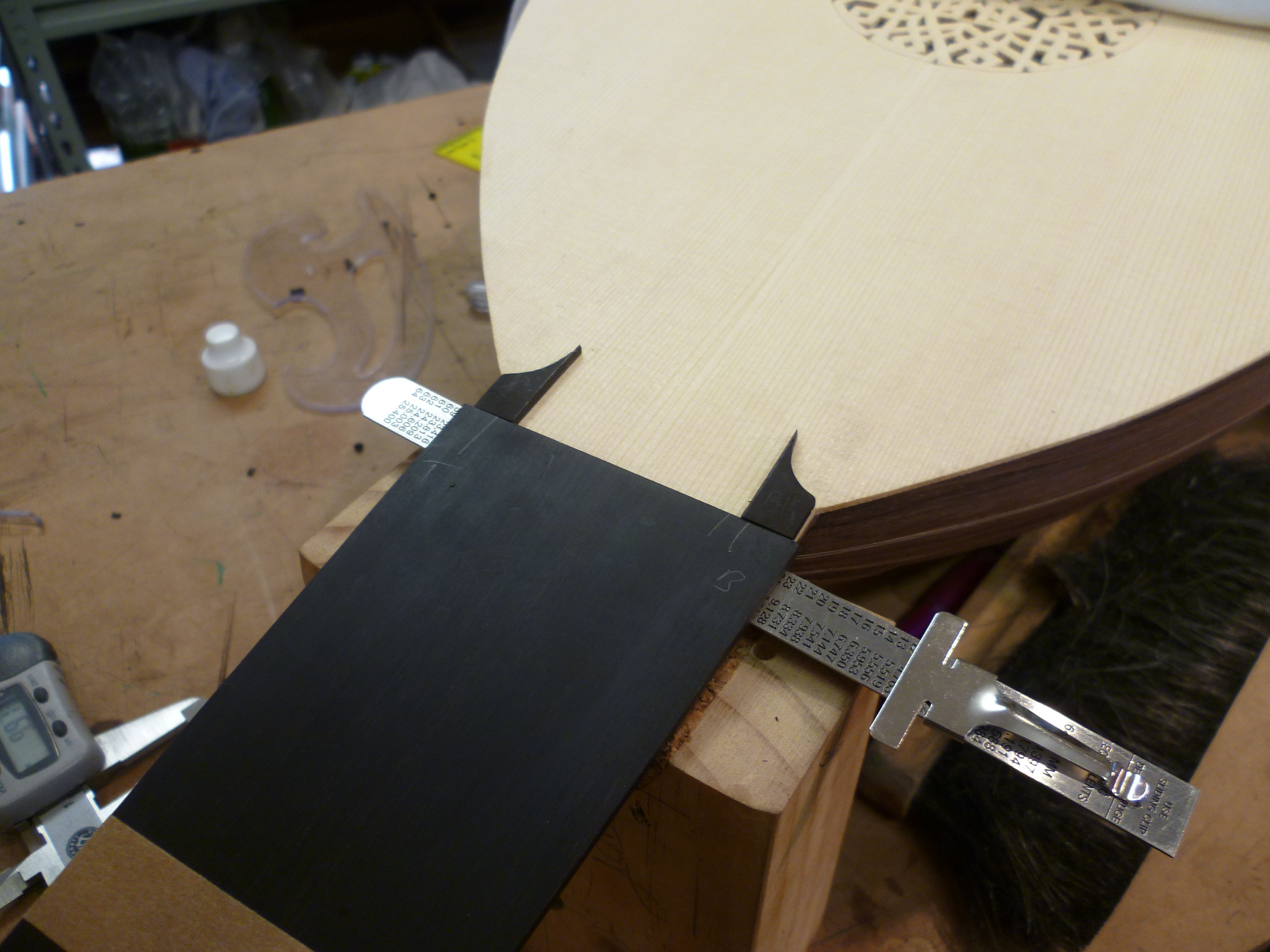

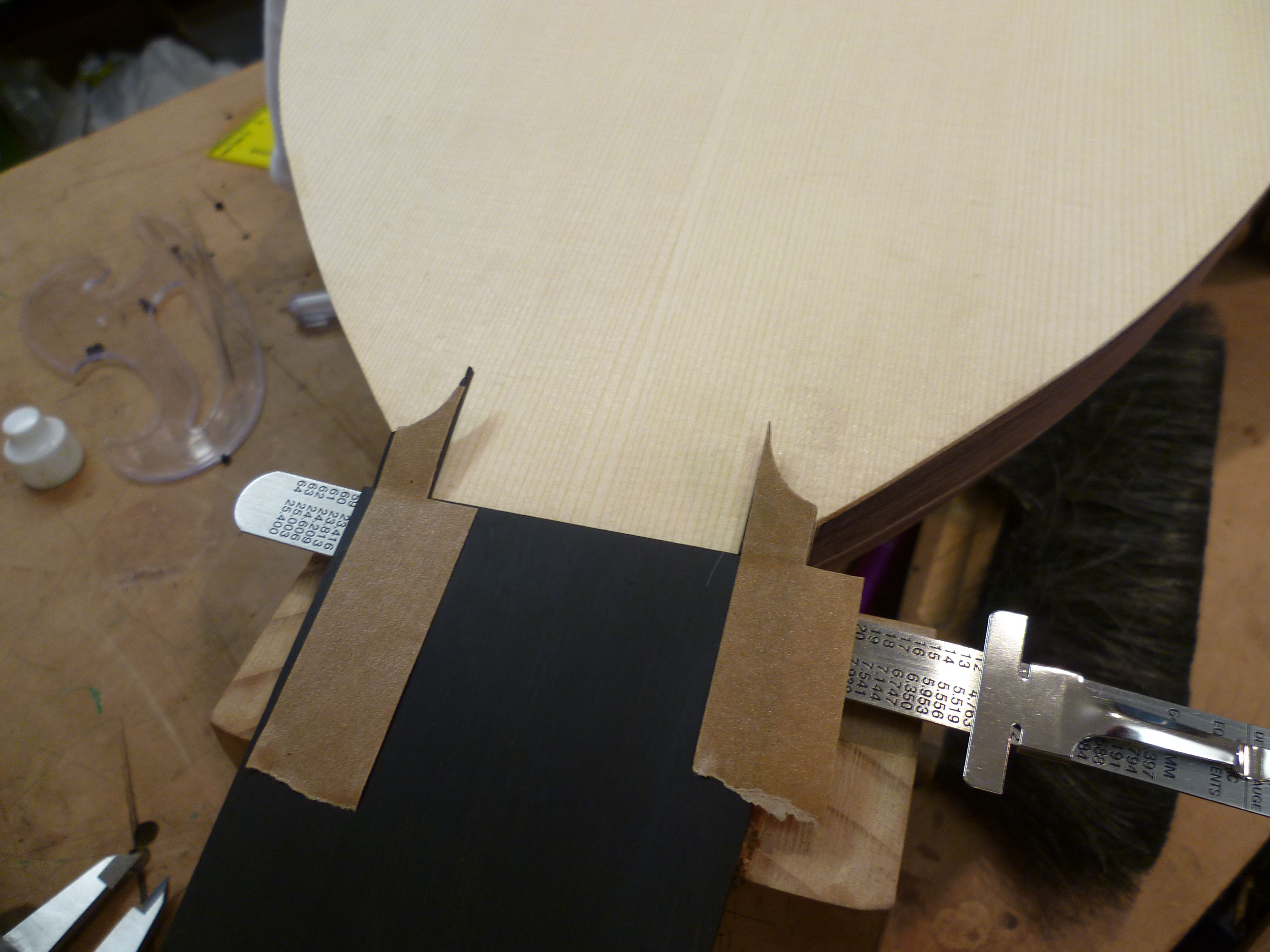

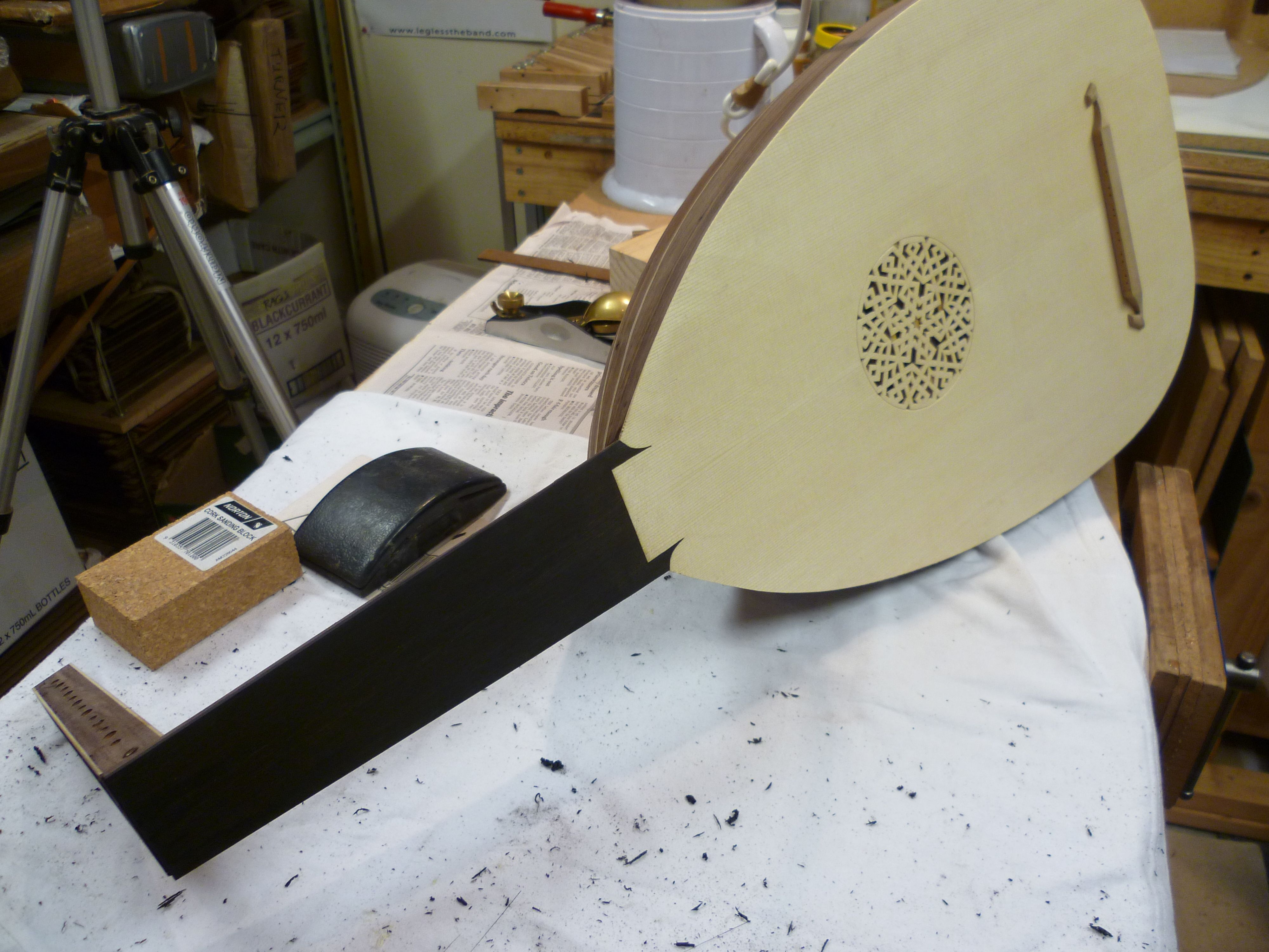

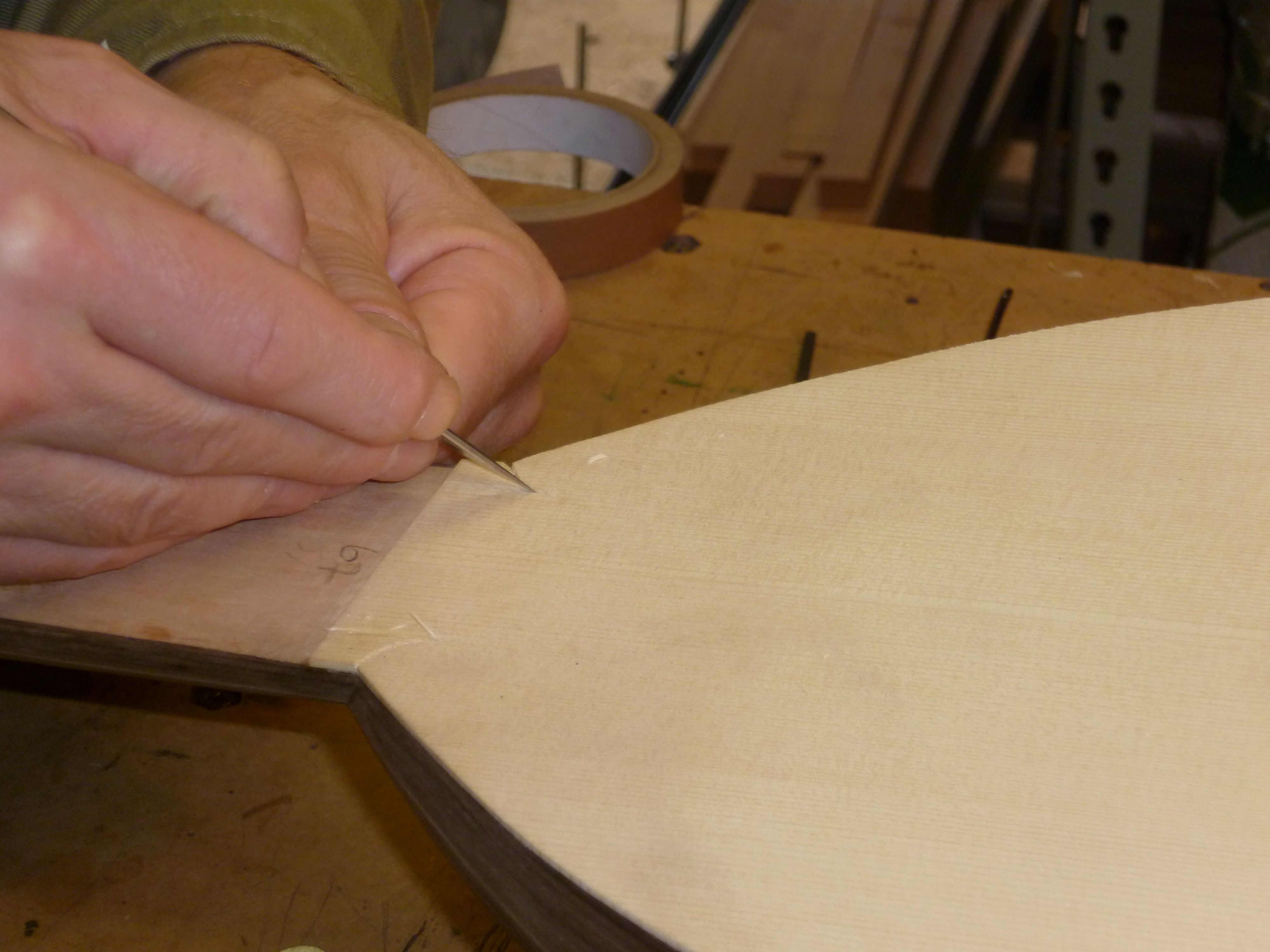

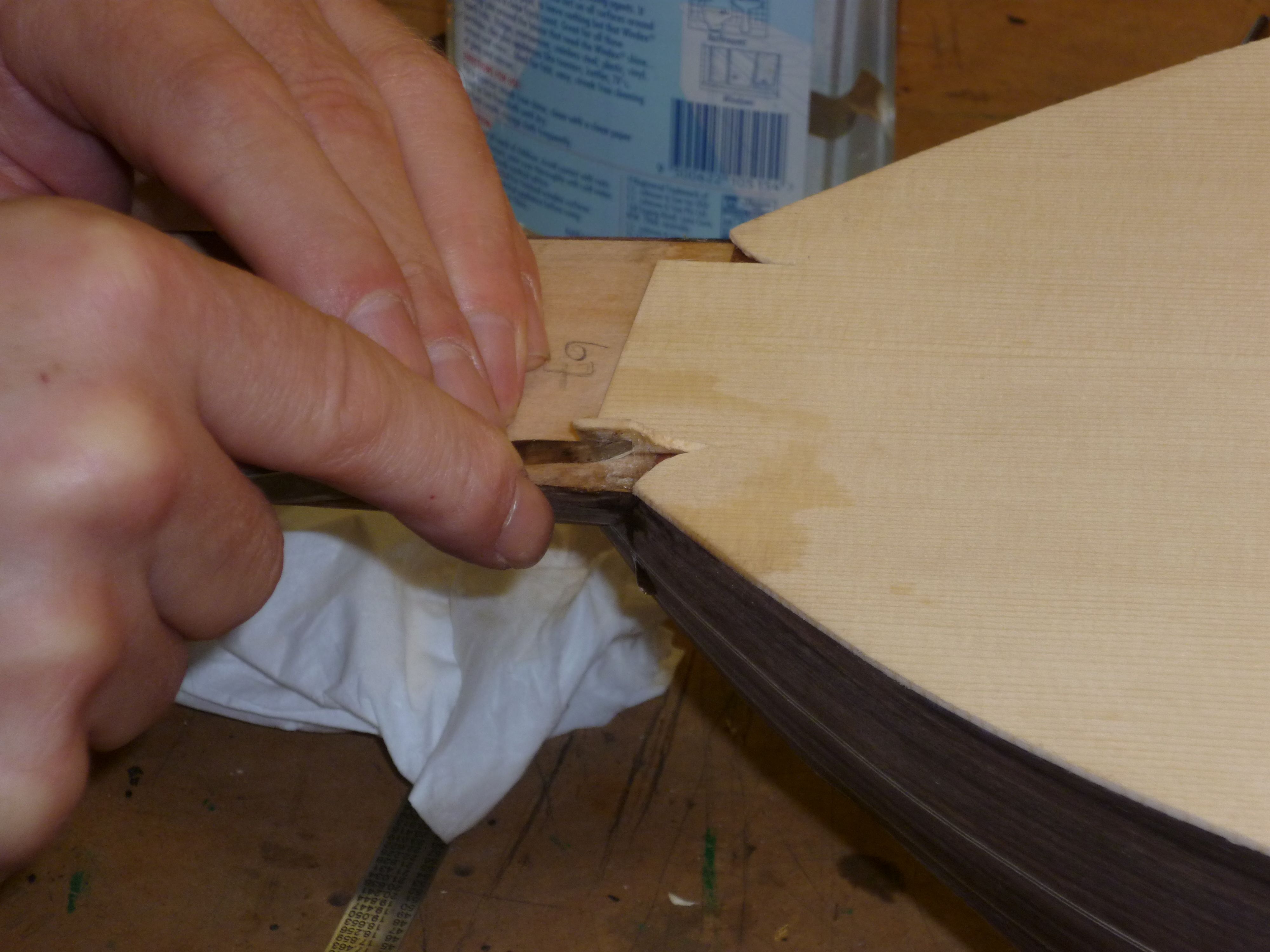

A day in the workshop today. Got the ebony fingerboard thicknessed down to 2mm, shaped the finger points, cut the soundboard to fit the points and then glued up the fingerboard and points. Hardest part of this job was cutting the recesses into the soundboard to get a tight fit with the points. My Pfeil violin knives proved the best tool for the job. The Swiss do really make some good ****.....they make some pretty decent people too. The origin of the fingerboard points is interesting..one theory is that they came about when instruments with a small number of courses got modified for more courses. To widen the fingerboard strips were added either side of the original fingerboard and let into the soundboard with the points.

Looking really good Martin, starting to get those little 'elegant' touches to it! I always wondered why they had those little bits extending into the top....now I know! Todays new bit of knowlege learnt already and it's only half eight! I can go home now :lol: .

Re: Lute Progress -
Post by charangohabsburg » Fri Jul 08, 2011 10:48 am
Hide glue rulez! 8)
Very neat work as usual, Martin.

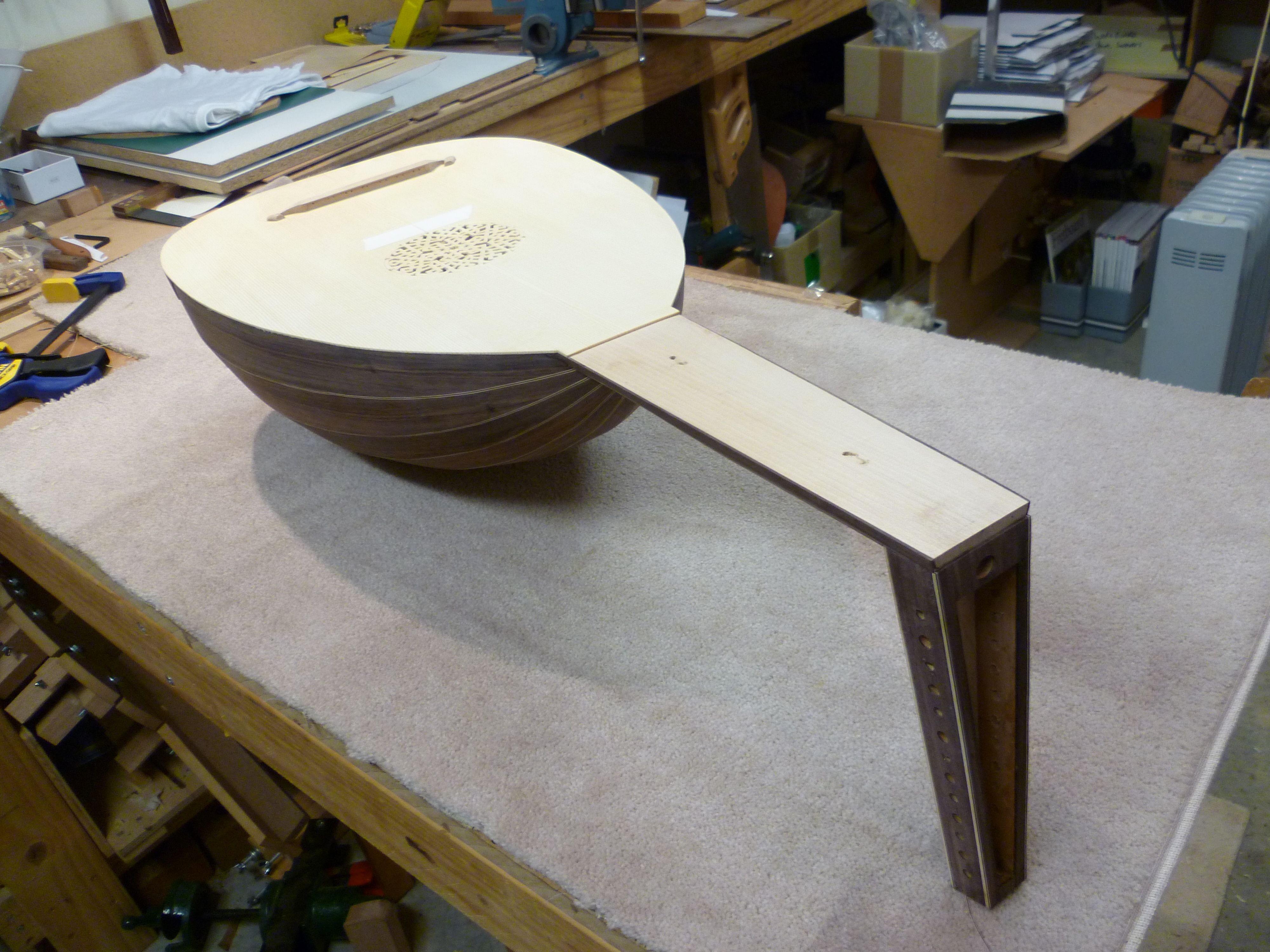

Are these...
... the clamping marks from the neck shaping procedure?

Post by kiwigeo » Fri Jul 08, 2011 1:30 pm
charangohabsburg wrote:Hide glue rulez! 8)
Are these...

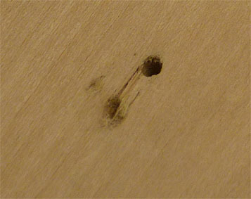

Correct, while shaping the neck core and doing the neck veneer I screw on a piece of mdf so I have something to clamp onto.

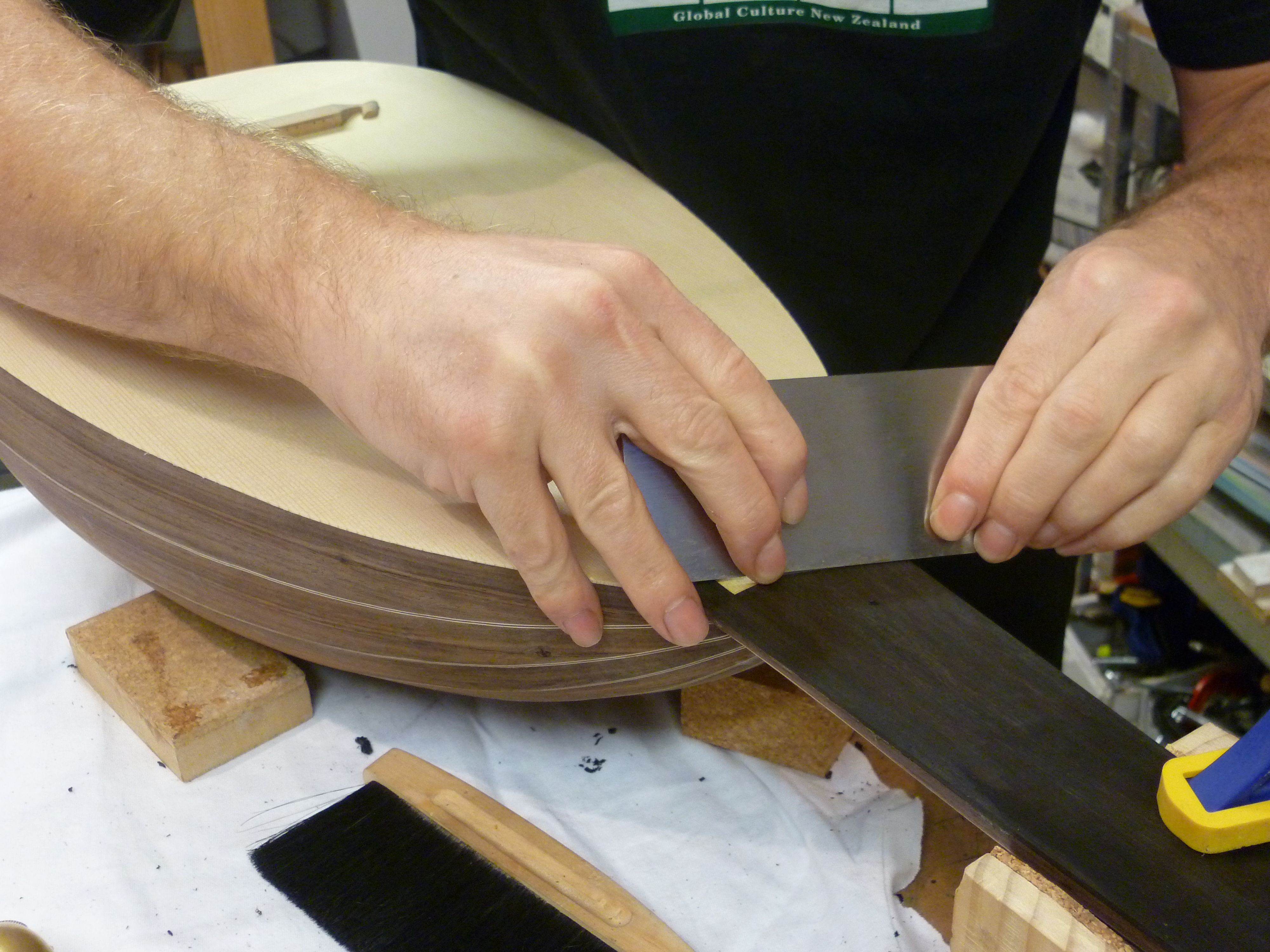

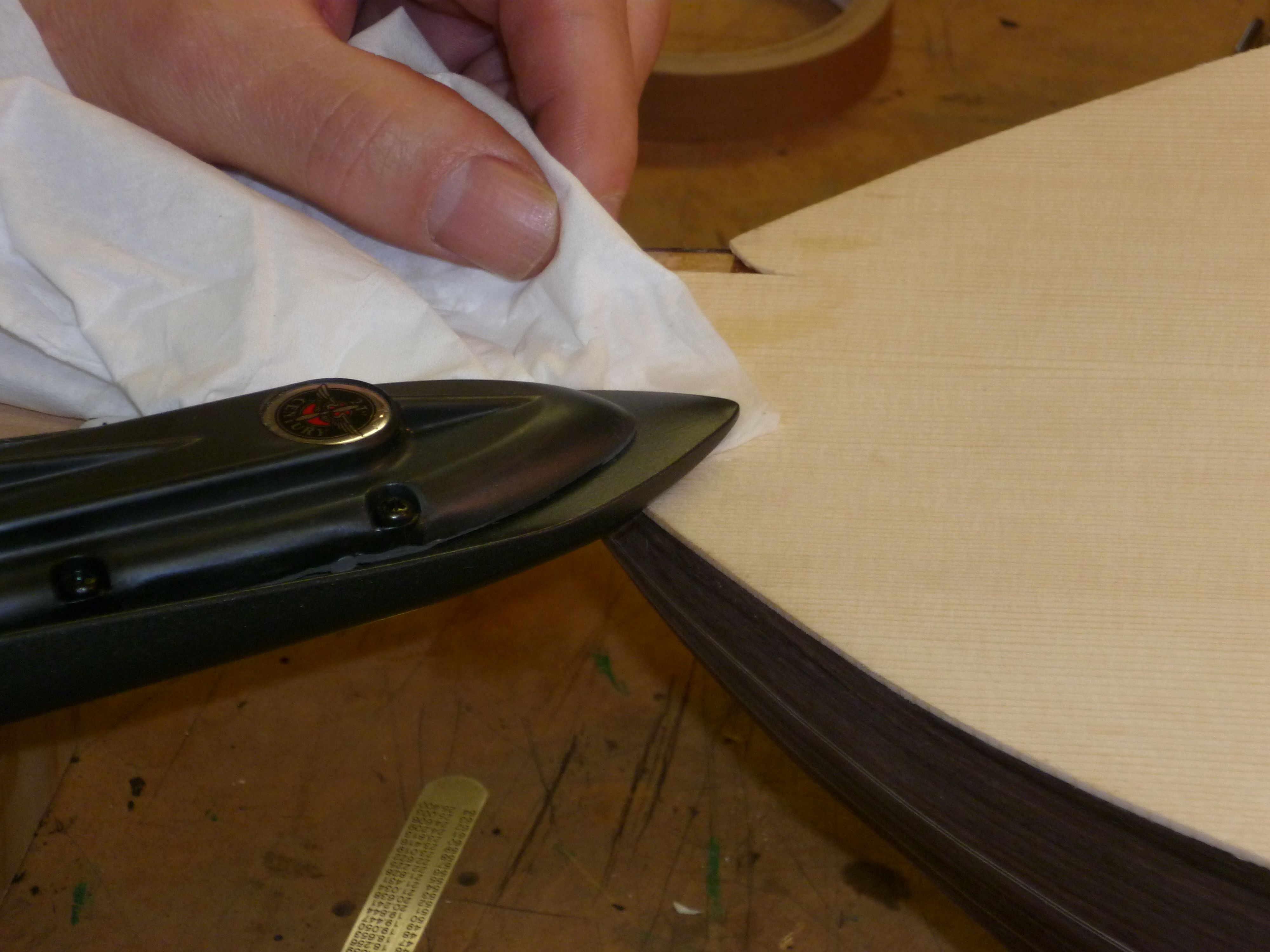

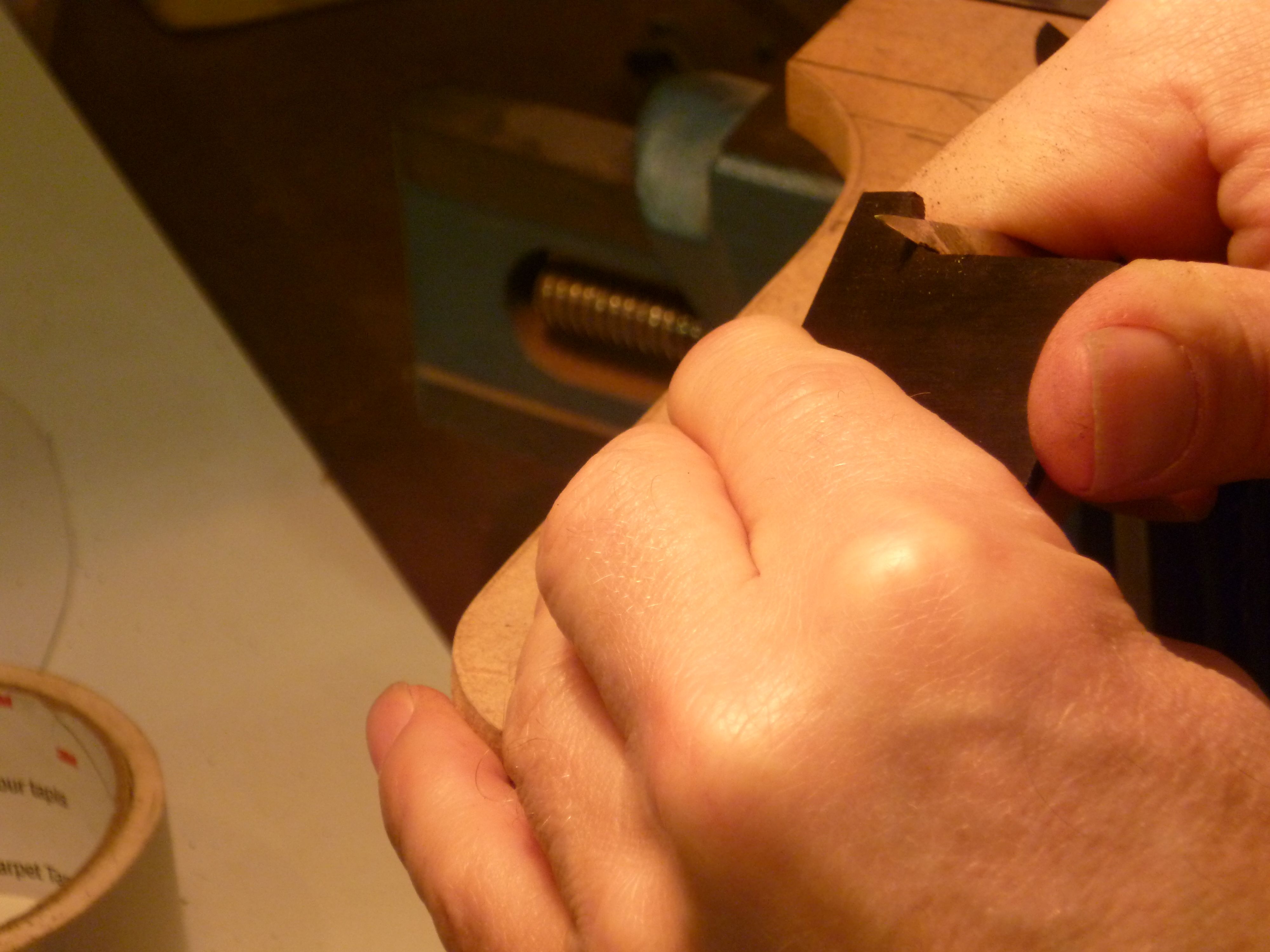

Post by kiwigeo » Fri Jul 08, 2011 5:14 pm

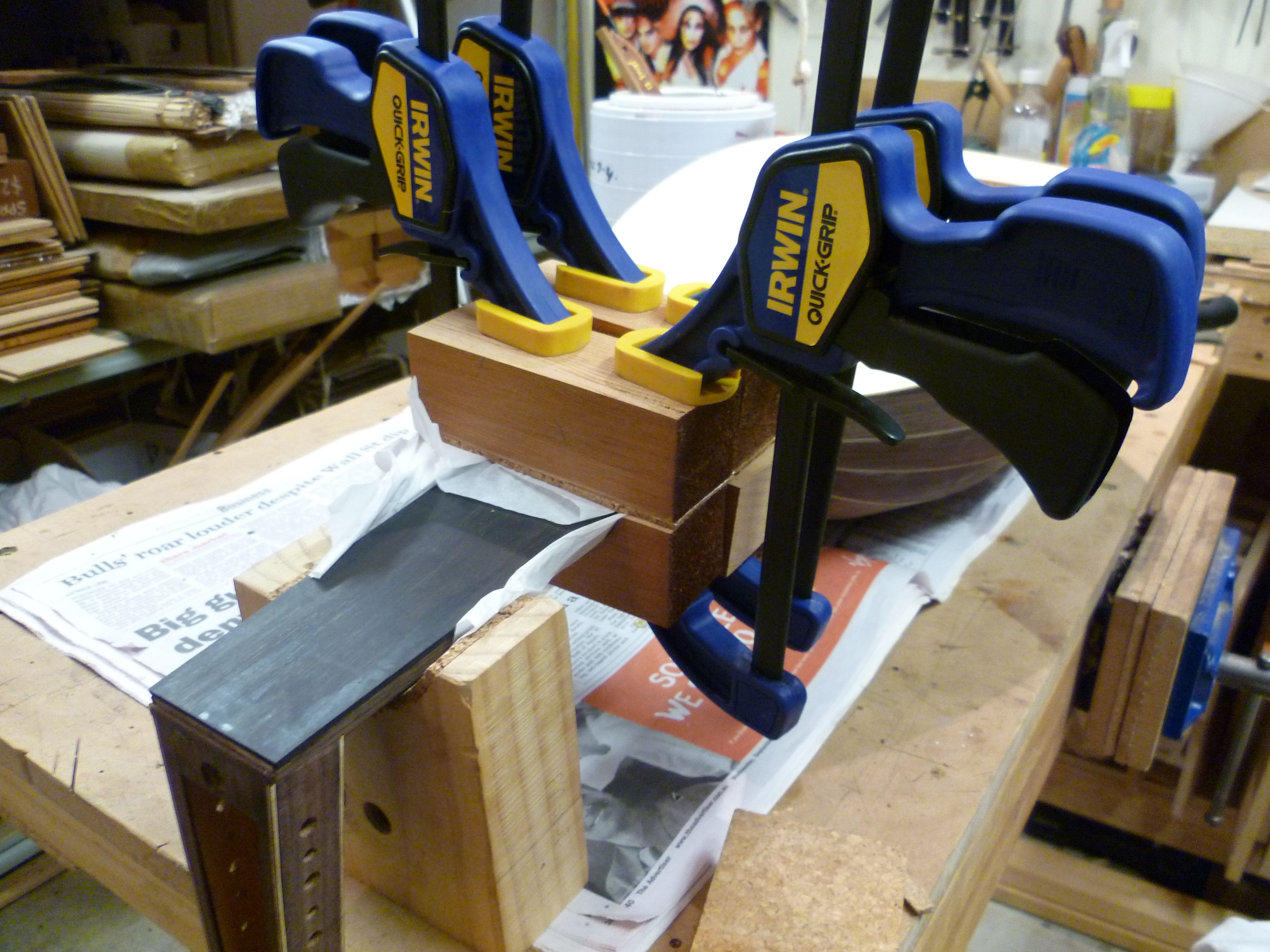

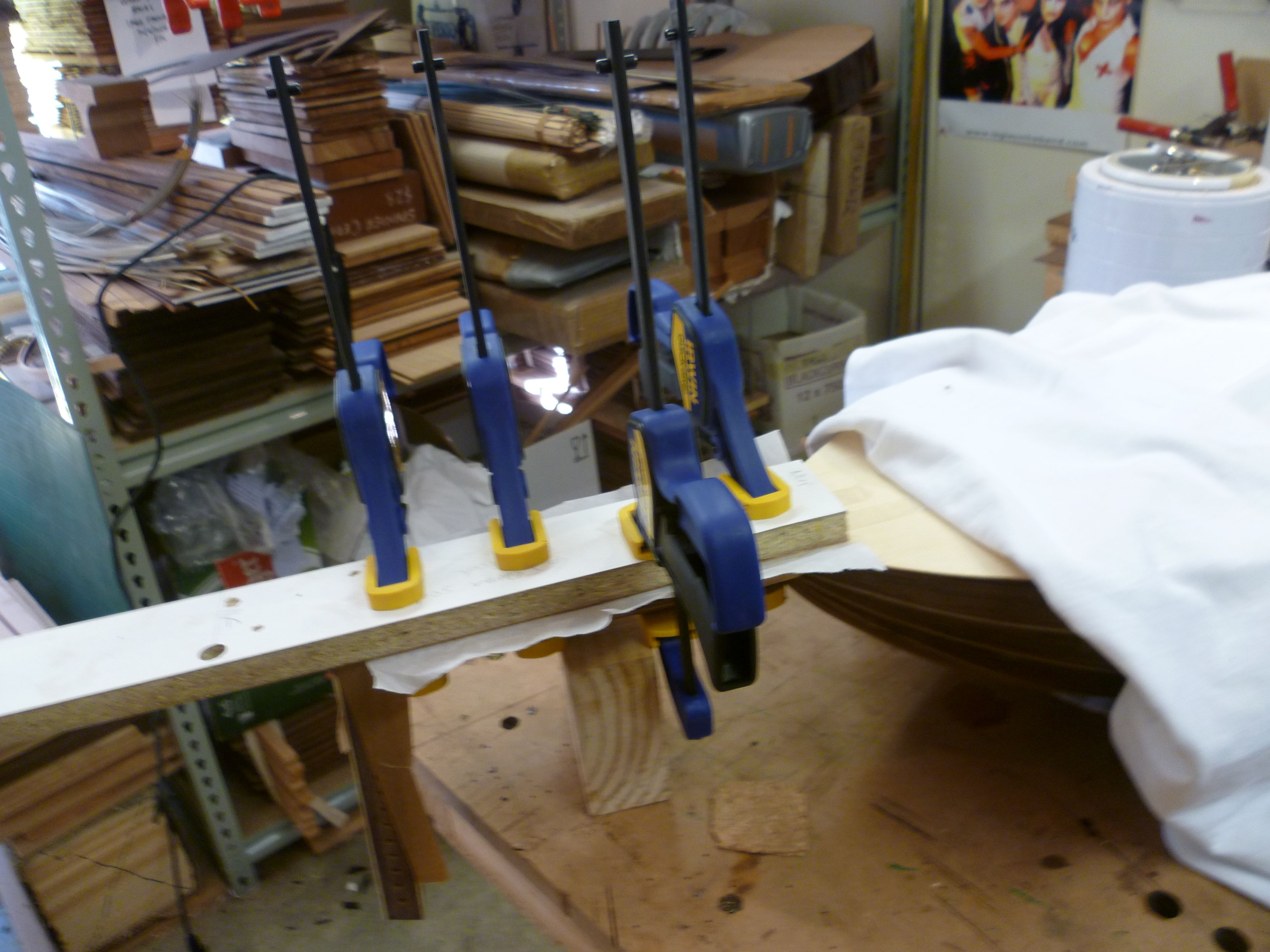

Scraping down the fingerboard flush with the soundboard....a hard job to do without getting ebony dust on the top. The fingerboard glue up didnt go 100% and I had to re-glue along one side and apply better clamping pressure with some specially made clamping cauls.

Another productive day in the shop. Got the ebony half bindings glued in. The half bindings had to be worked down from some standard Stewmac bindings with a block plane. The binding channel is 0.7mm deep and was cut with a home made channel cutter. No photos of this stage of the operation sorry. The lute is now structurally complete. All that needs doing is fitting of tuning pegs and finishing of the body, neck and fingerboard of the instrument.
