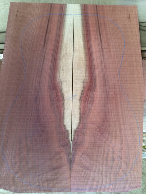

That ebay seller did indeed buy a couple of pallets of mixed ungraded stock from the liquidation of Big Sky Timber , a company I used to work for .
I need to clarify that it was not bought from myself personally . I grade my stock .
I'd proceed with caution there as a LOT of went out was not musical stock . In fact a lot of it was rubbish as the old boss wouldn't let us get rid of our fall down to the extent that we were drowning under it .
Your faces are Sequiadendron giganteum . Big tree or Sierra Redwood . The tree grew on a hill in Dean , just down the road from you Allan. The red streaking is the result of the tree having been ringbarked by horses ! The tree flooded the live heartwood edge with extractives in an attempt to protect itself as it died slowly .
Apologies that you have got caught in that . It's really the responsibility of the seller to be clear with what he has and the grades its being sold at . That and the fault of the $#@!wit that I used to work for in the whole enterprise turning to shit >
On the plus side if you like that stock Allan you could come and get more at no charge . I've forked a heap of it onto the Big Sky bonfire ! Just promise you wont list it on ebay as AAA soundboards ! Some of it would make good lightweight solid body blanks , with the prettier stuff being caps .

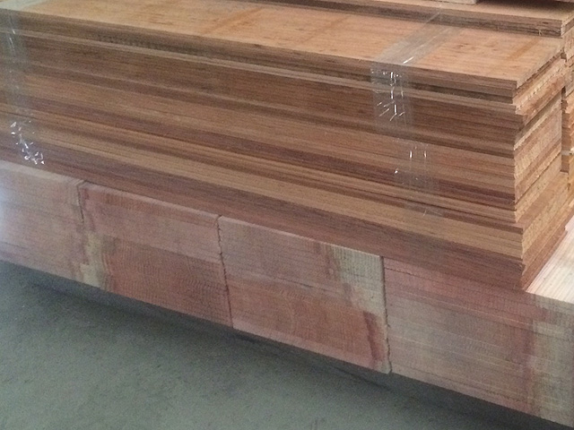

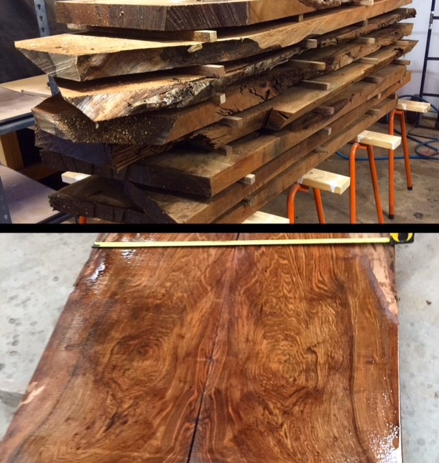

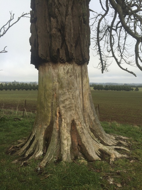

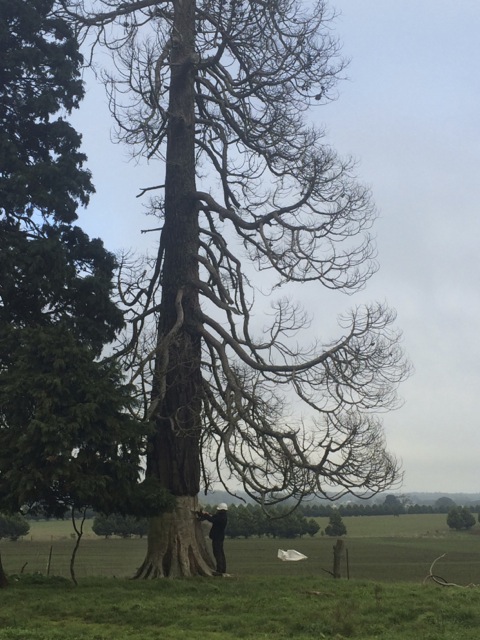

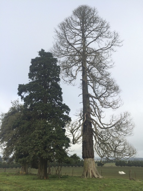

For your interest, here is the tree itself (the dead one next to a live Western Red Cedar) -
And the SERIOUS ring barking inflicted by horses! That bark was up to 300mm thick!! Hungry horses :shock:
Finally, some perspective for size reference -
Here is a bunch of them processed and ready to ship to CC and note (with reference to another thread on the topic of CC redwood) they are 1/4 sawn... Also the darker band of colour alongside the sapwood which Pete referenced -
And one of the figured stump cuts. Very pretty, but most of which had some wild and rolling grain, cut and supplied due to "customer specific request" -
Funny that Pete mentioned the back and side set being Plane tree - I thought exactly the same when I saw it but did not want to muddy the waters any further :D I figured likely it is, but it did not really matter because Plane or Silky, it is a bargain that you got.

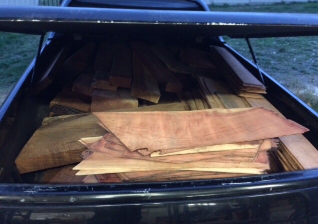

Couldn't help myself. When I was at Curly's yesterday I saw this stack of English Walnut slabs (approx 2000x500x50) and we all know how things can play on your mind. I had to have some, so I dropped back in today and bought the lot.
If anyone is looking for back and side sets or other bits and pieces, when these guys get their storefront up and running I highly recommend. I've seen the prettiest Gidgee and the highest figured Blackwood I've ever seen over the last couple of days, so dust off your wallets and get yourself something special.

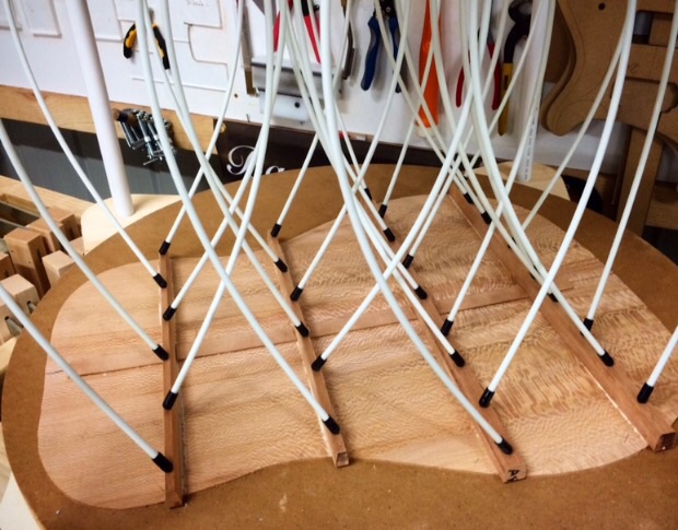

Post by demonx » Tue May 26, 2015 2:07 pm

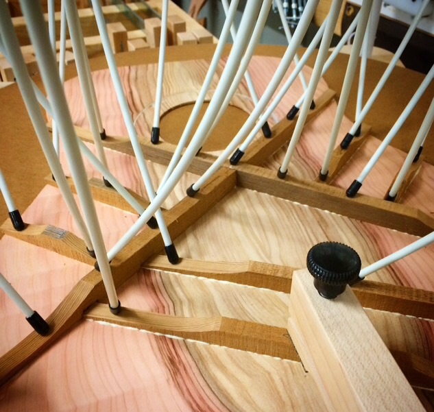

Few more updates on the Redwood Top guitar
Posts: 10873
Re: Build thread - Blackwood & Bunya Dreadnought

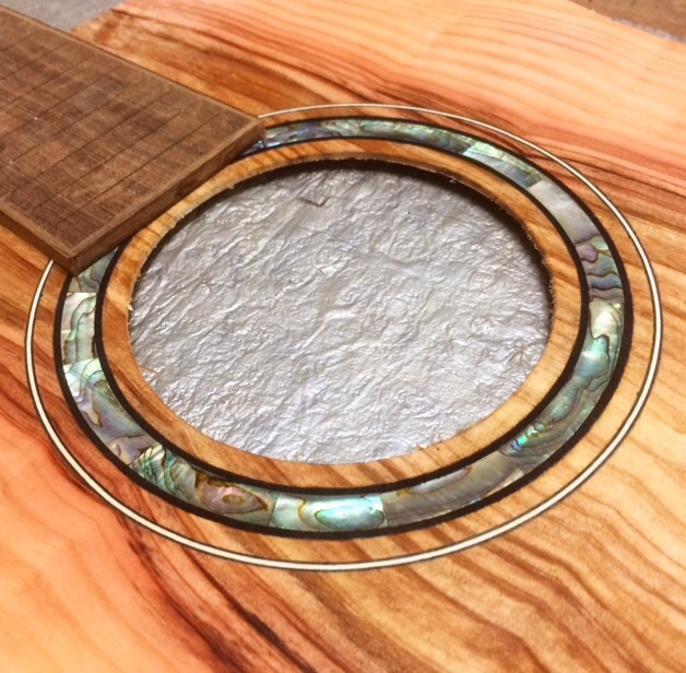

Post by kiwigeo » Tue May 26, 2015 8:07 pm
All looking good...apart from that rosette.
Maybe it's just me being overly anal but the grain of the top doesn't quite match the grain of the same wood within the rosette. You obviously haven't simply cut channels into the top and inlaid the purfs and abalone/paua. It wouldn't bother a player or alot of builders but I'm the sort of builder who obsesses at night about such things :shock:
I realize those braces are going to get some chisel work but I'm a bit concerned about the thickness of same. Looking at the top wood you're using I think you should be aiming at going as light as possible on the bracing.
Just my thoughts and others may have different ideas.

Post by demonx » Wed May 27, 2015 8:34 am
kiwigeo wrote:All looking good...apart from that rosette.

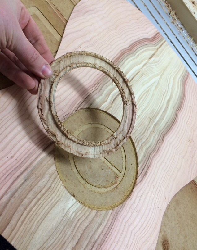

When I was cutting the rosette channel, the CNC decided to loose it's Z zero (height reference) and cut the purf channel right through the entire top, so it became a repair rather than a rosette. I initially planned on the two black circles bordering the abalone being black white black purf to match the outside strip, but as the centre had popped out of the rosette, I had nothing to zero back onto to fix the problem. So I had to make do with what I had and the bugger turned during glue up and I didn't notice until it was too late.
As far as the bracing, I've made it oversized for a reason. It's WRC bracing and I've added a millimetre or two width to each piece. If you'd held the top in your hands you would understand why. Both Curly and Jeremy (who originally processed this tree) touched on the subject of this Redwood being a bit "flimsier" than normal and requiring extra bracing.

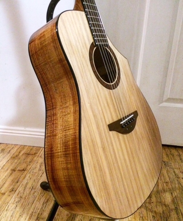

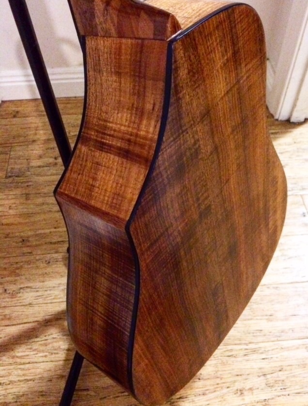

Spent a bit of time on this old beast today, it was time to get the thing out of the workshop.
After all the stuff ups I had through the build I was expecting it to sound like a tin can with rubber bands wrapped around it, I didn't bother to put in the pickup, saving that for the next build. I didn't bother to spend much time on the finish, I didn't bother with a truss rod cover and I didn't even cap the bolts on the bridge. It was a case of get the strings on and get it out of the workshop.
I didn't have any acoustic strings, so I made up a set from a bunch of electric singles I had in a draw, as again I was expecting the guitar to be crap so I didn't want to waste money buying good strings.
To my surprise it sounded pretty good! I recently played a Bunya/Blackwood Cole Clarke and even though it's not a side by side comparison, this probably sounds better. But that's just from memory.
I played this side by side with my WRC topped Churchill, the Churchill has a lot more depth and more projection. The Bunya top was more of a "tinny" sound than the WRC guitar. Id say the Churchill has a more complex range of sounds compared to my Bunya/Blackwood, which sounded simpler, but not of the same tonal quality.
After comparing my first acoustic build side by side (sound wise) to the Churchill, which built by a world renowned luthier with hundreds and hundreds of builds under his belt over a several decades long career, I feel pretty confident that my guitar wasn't entirely a failure, and even though it's not in the same league as the Churchill, it's not far enough away that I feel bad about it, overall the sound came out much better than I had anticipated.
Here's a quick mobile snap shot, I will take others one day in sunlight but it's too dark now.
Posts: 10873
Post by kiwigeo » Sat May 30, 2015 6:16 pm
You're being a bit hard on yourself with the self assessment of your build...visually it looks great. Considering you don't have that many acoustic builds under your belt I reckon you've done pretty well.

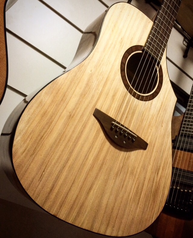

I forgot to take it outside for pics today, but here are another couple of indoor mobile phone snaps.
Post by Mark McLean » Sun May 31, 2015 9:10 pm
Allan, I reckon it looks great. It looks like a real player's axe - not too fancy but really well put together and nice timber. I hope you get to enjoy it.

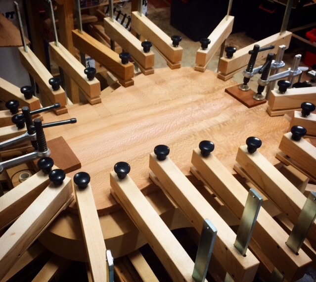

Post by demonx » Wed Jun 03, 2015 11:28 am
Moving along with the Redwood guitar:
Back done: I wiped a coat of Danish oil around the surfaces, avoiding the next to be glued surface. It was a mix left over from an electric I was oiling and there was a bit left in the cup, so I thought I'd try something different.

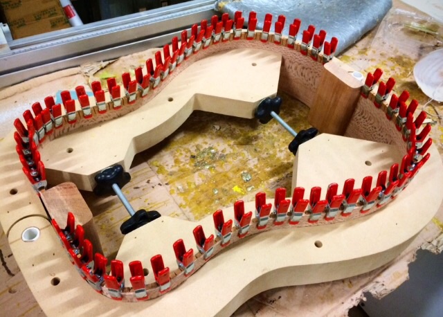

Post by demonx » Fri Jun 12, 2015 4:26 pm

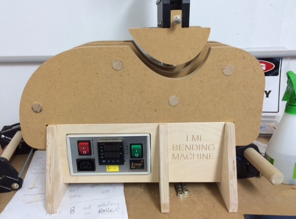

Spent a bit of time making this to fit into the LMI bender.
I'm hoping I'll get an easy to bend and consistent cutaway with this jig. Will test it one day soon.
