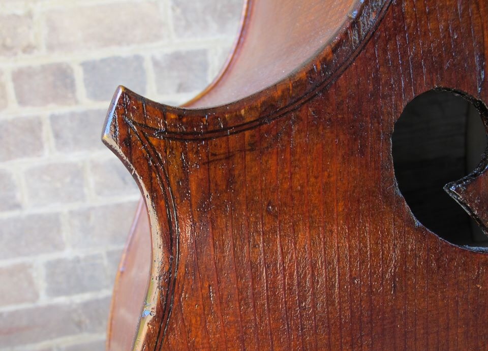

That black liquid you were stripping off is reminding much more of a car repair than of a musical instrument restoration!
Was that originally an oil varnish? (I'm just saying it because I ignore if luthiers used to use something else than just that). Do you have an idea why it had tuned like this?
What kind of solvent did you use to clean off that terrible remains of deteriorated varnish? Just alcohol?

originally the varnish would have been a transparent red-brown spirit varnish ie shellac and other resins and colourants.
over the years and due to heat (the instrument was found in an attic) the colourants have oxidised and the finish has crazed, melted and clumped and probably encapsulated a fair amount of dirt and tannin from the wood too.
So yes, just using spirits of wine to remove the treacle. I might keep some of it in a jar - may help with matching new wood colour undr varnish later.

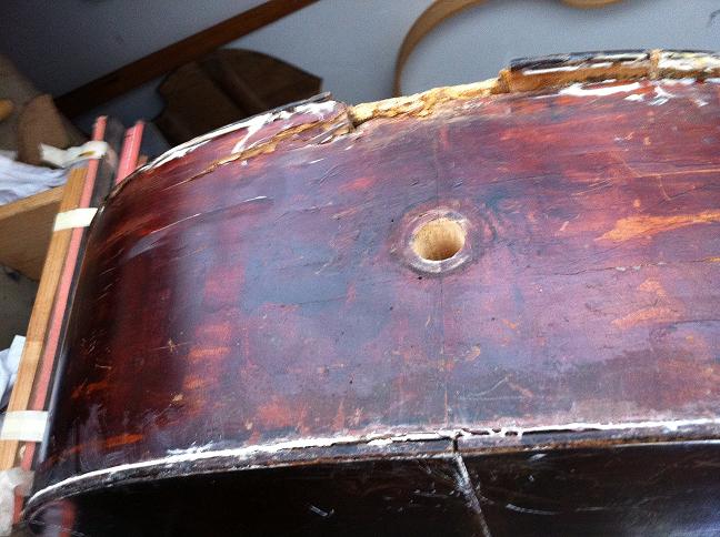

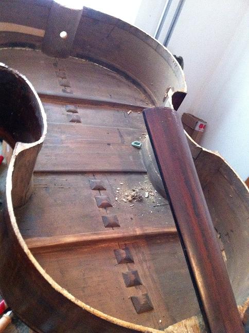

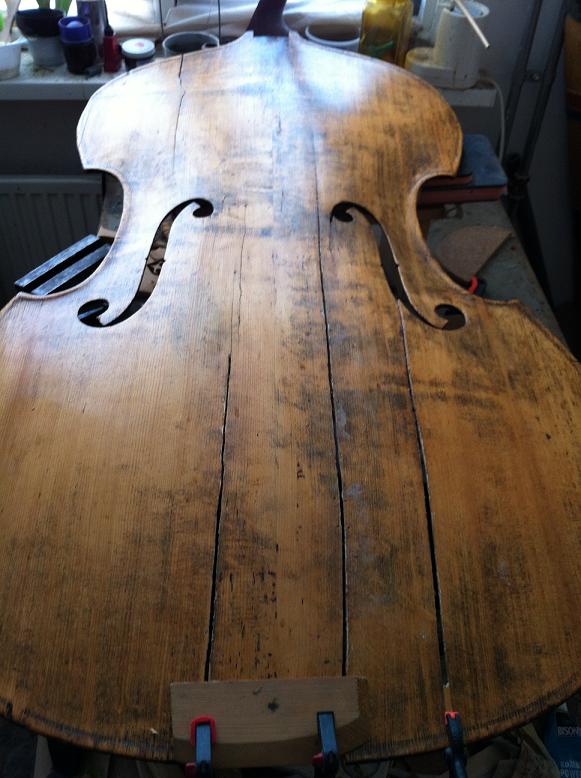

Hello Matthew,
very inspiring work on that Bass!

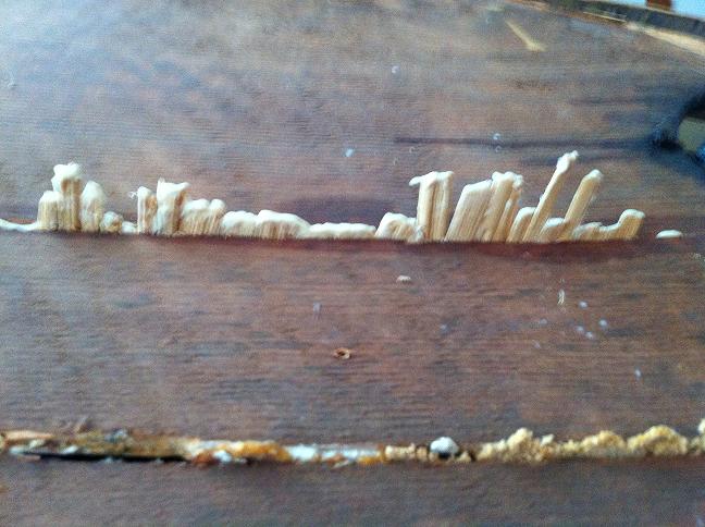

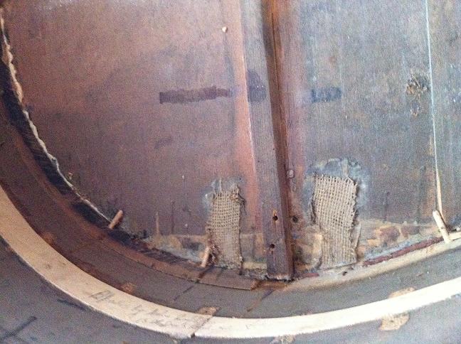

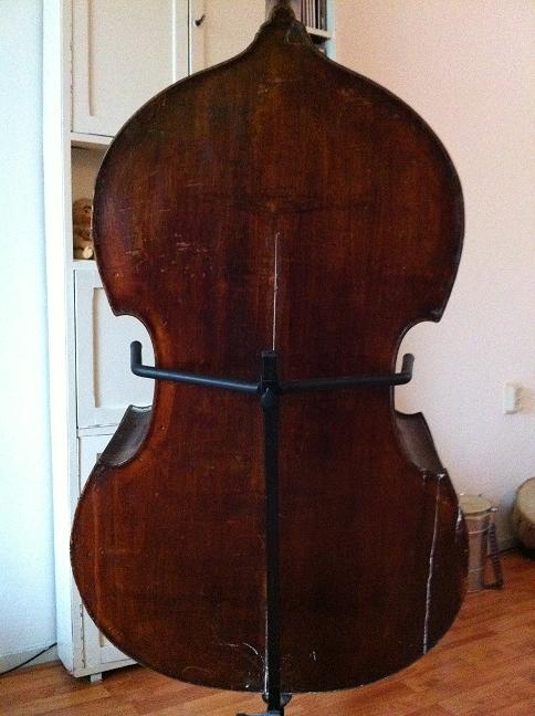

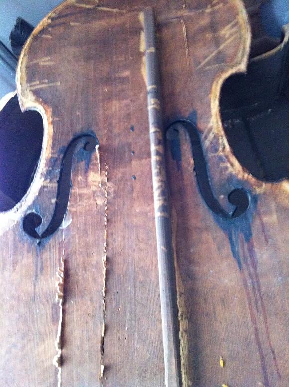

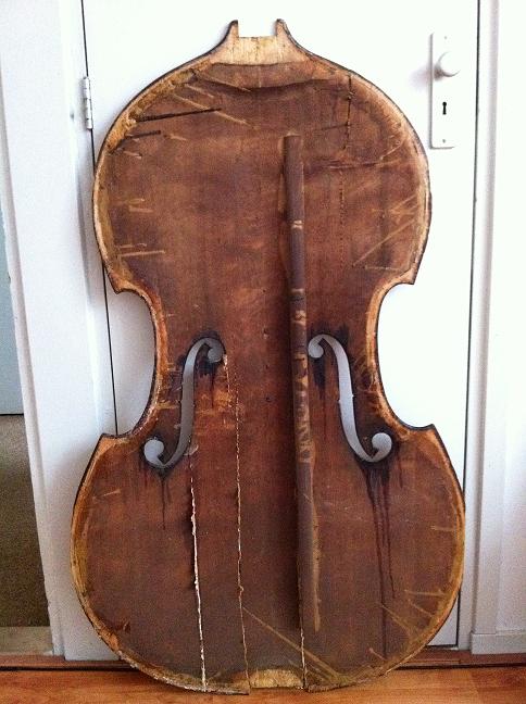

I am working on a similar French Bass, here are some pics.
It took me a few weeks to get the former "restorations" undone and clean it. Will absolutely try to use some of your techniques in my restoration.
Look at the way the cracks in the front are filled up from the outside with little chips of wood dipped in white glue.
Pics in File (hope it works, dont know how to get pics in the message)
I am searching for an old set of French Tuners, in any condition, will pay a good price and/or can give very old German tuners as an extra.

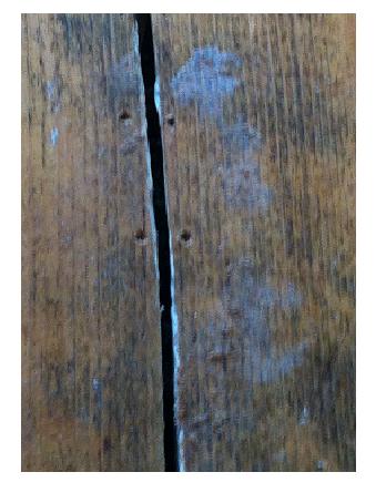

Re: Old French Bass full Restoration
That crack fillers technique is interesting ... how are you going to get all that white glue out?
And ... are you in Australia or are you ... "rest of the world"?
Most of the glue is out. I used water, heat and a lot of patience with a little knife.
I am in doubt wether I should fit the cracks back together or carve large strips of spruce that fit in the cracks as to keep the form. One crack is aprox 5 mm.
The body and back are in bad shape as well. lots of strange repairs, two additional bars were installed, which is not very french.
I am in Europe, otherwise I would gladly visit you for some expertise.
As the cracks have already been "repaired" once before I doubt whether you will be able to pull them back together. You might be better off cleaning up the sides of the cracks and replacing with new wood splints as you said. Sometimes it is easier to break open the whole crack end to end, clean it up, and re-join. It will be difficult to keep the arch intact and the edges flat. Think about shaping some cross-bars from pine that match the arching across at several points. You can tack-glue these to the top, then trim off the pine flush with the bottom edges of the plate so you have a temporary internal frame that will sit on a flat surface and keep the arch intact. Then fit your splints. Jim Hamm invented a technique where the splints are rolled/compressed between a steel roller bearing and a hard surface, particularly at the thin ends. these are then glued in with hide glue and as they are wet, they expand to fit the crack. I haven't done this though yet.
Good luck! That thing looks to be a bit of a mess!
Here: http://www.thestrad.com/pdfs/HamTradeSecrets.pdfmatthew wrote:Jim Hamm invented a technique where the splints are rolled/compressed between a steel roller bearing and a hard surface, particularly at the thin ends. these are then glued in with hide glue and as they are wet, they expand to fit the crack. I haven't done this though yet.
I have used James Ham's technique, but on much smaller instruments than double basses. It works like a charm. Of course you need "a gap which holds its shape", and this is where I guess the temporary frame Matthew suggests will shine too.

I've been assuming that is NOT Martin's repair techniquesimso wrote:Dubass, Ive never seen someone fill cracks like that method you have shown, would love to see the finished repair prior to colouring if you could.
No, no, that would never be my repair technique!
I once had the idea of making the inside of a Bass a kind of "Magic Box", where you can look through the endpin-hole and shine a light through the F-Holes.
The "woodchip" repair (which was there when I bought the Bass) would make a nice Big City Skyline
I will go and try to go with the Hamm technique, the cracks are much longer and wider than in the example.
42 cm, 40 cm an one of 67 cm!
Oh, and did I mention that I found little holes drilled on either side of the previous repairs. I believe they have used the method of pulling wire through those to pull the crack close till the glue was dry.
Mostly used as een ouside repair thechnique in guitars.
