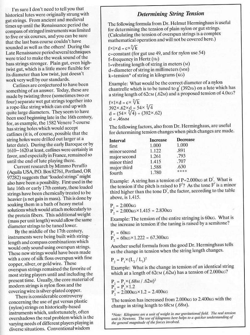

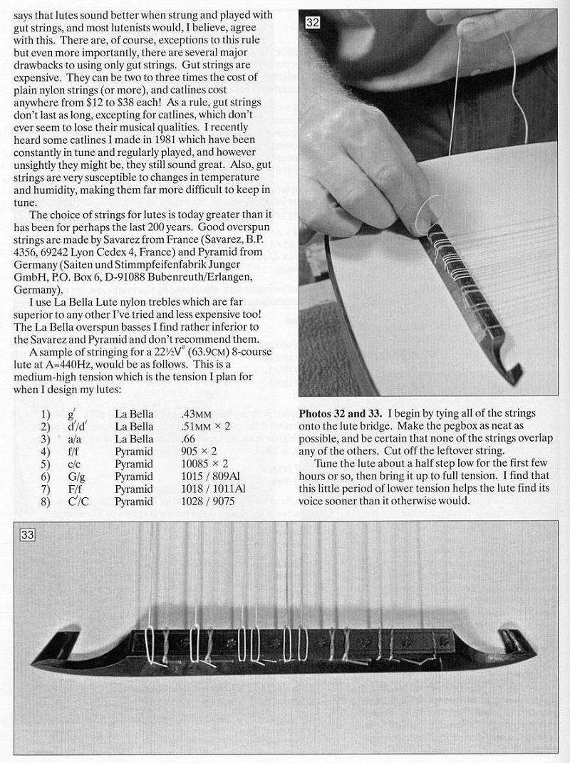

What thickness of strings? How recommends Lundberg?
Re: Lute Progress -
Post by charangohabsburg » Sun Jul 10, 2011 4:59 am
I can't recall Lundberg mentioned string thickness, at least not in his book. But I also may be wrong here.

Sergy wrote:What thickness of strings? How recommends Lundberg?
Lundberg recomends strings...a mixture of Pyramid and La Bellas with guages specified. Cant quote the figures as my copy of his book is out in the workshop right now and its pouring with rain!

charangohabsburg wrote:I can't recall Lundberg mentioned string thickness, at least not in his book. But I also may be wrong here.
This is an interesting article about strings of historical lutes.
Thanks for link, very interesting 8)
charangohabsburg, I scanned some pages from the book -
kiwigeo wrote: Lundberg recomends strings...a mixture of Pyramid and La Bellas with guages specified.
I read many good responses about Aquila brown nilgut strings.
Aquila nilgut + Pyramid silver wound, too a good combination. :)

Sergy wrote:charangohabsburg, I scanned some pages from the book
Perfect!

Ok , Ive spent alot of time looking at strings and have decided on following Aquila strings:
g' - Nylgut 0.40mm
d'/d' - Nylgut 0.52mm
a/a - Nylgut 0.64mm
f/f - Nylgut 0.82mm (also ordered 0.42mm for an alternative octave tuning on this course)
c/c - Copper wound Nylgut 1.08mm
G/g - as above 1.45mm / Nylgut 0.73mm
F/f - as above 1.55mm / Nylgut 0.76mm
Also ordered was a variety of fret gut from .70mm up to 1.00mm.
