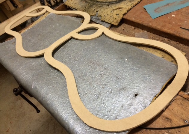

Haven't really touched the acoustic build since last update as I've been flat out doing customer builds, but I did run these off on the CNC this morning.
A couple of clamping caulks for the top and back.
I made them out of 6mm MDF. Thick enough that it will spread the clamping pressure and cushion the clamp pad, but thin enough it will bend with the radius of the body. I also made them dual purpose by adding the cutaway section.

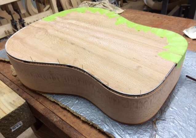

Little bit more on the Redwood dread.
Cocobolo binding with a black white black veneer pref. I'm not sure if I got more glue on my fingers or the timber while doing this!

Handy little trick I learned: pin the purf before trying to glue the binding.
Made a pain in the a job a walk in the park.

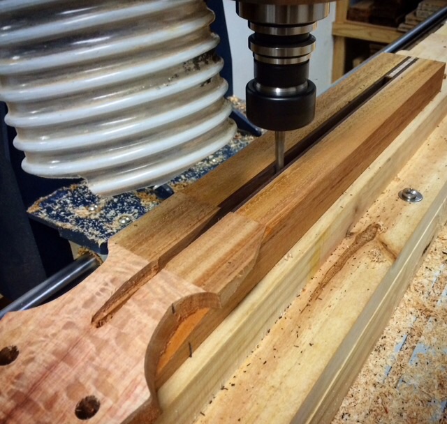

Routing the truss rod slot:

Post by kiwigeo » Sat Jun 27, 2015 3:29 pm

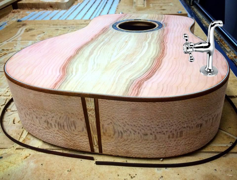

Would be good to see some tap test results on the finished instrument.
Re: Build thread - Blackwood & Bunya Dreadnought
Post by Nick » Mon Jun 29, 2015 6:40 am
kiwigeo wrote:Would be good to see some tap test results on the finished instrument.
Na, don't think it will quite take off, doesn't look right somehow. :wink:
Posts: 10873
Post by kiwigeo » Mon Jun 29, 2015 9:36 am
Thats a hot tap..it should be on the treble side of the soundboard.

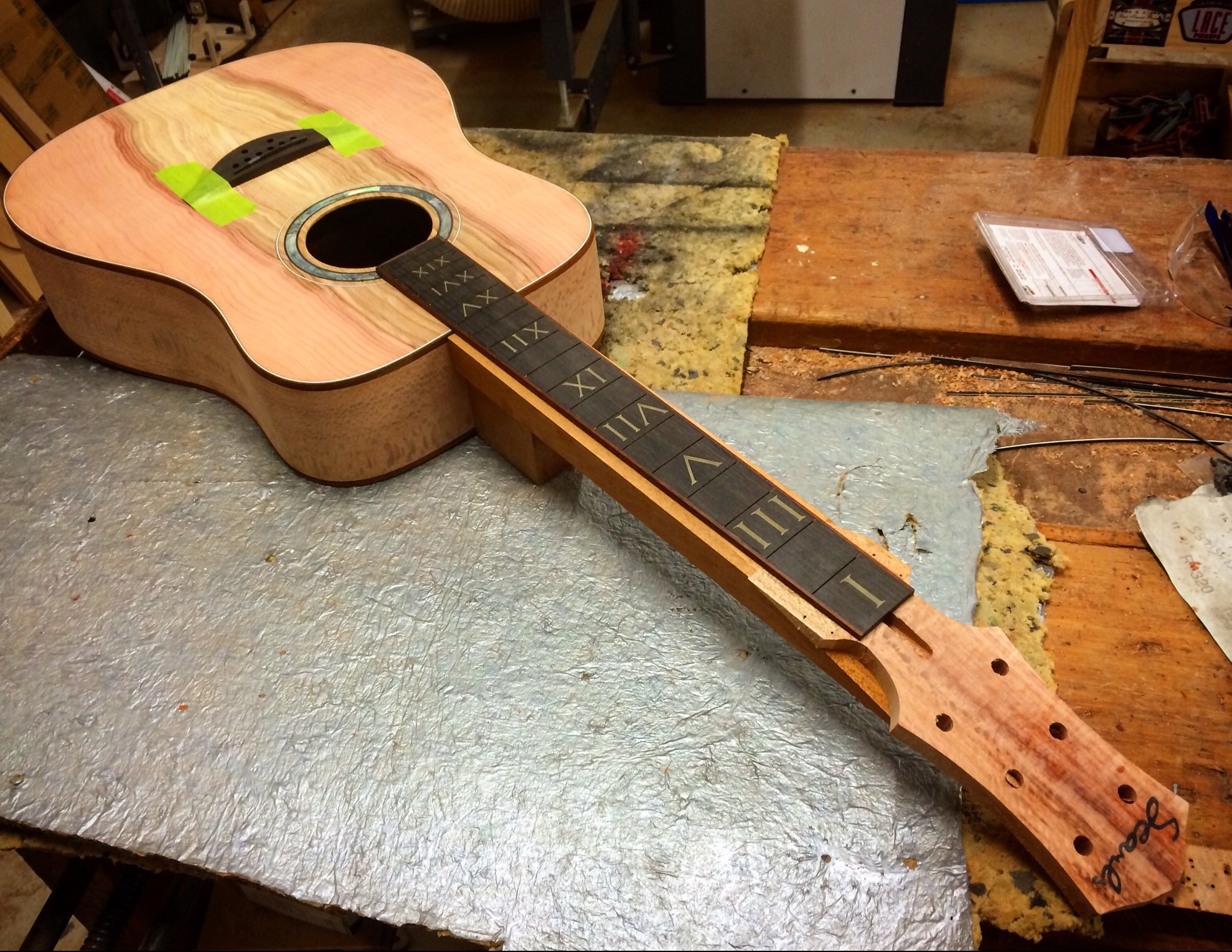

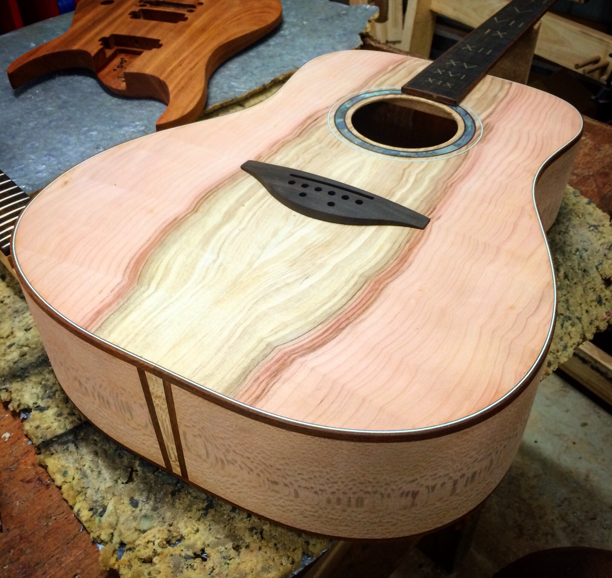

Post by demonx » Fri Jul 10, 2015 12:28 pm
Spend a bit more time in this one today. Now that the bridge is done so I can move forward with the neck.

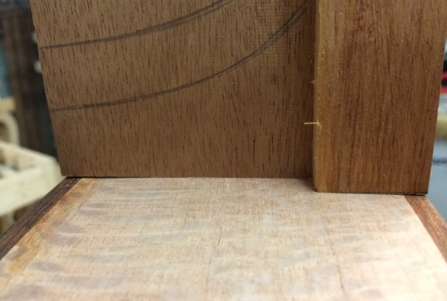

Had a look at the neck joint today. Will need a touch more finessing than the last build, but it's pretty good. I won't know till I install the bolts and pull it up.

It's actually a bit worse than I thought. I just installed the neck bolts and pulled it up. Looks like when I sanded back the binding I went a bit overboard. Something for me to think about next time.
Anyway, it could be worse since this is fresh off the router. A bit of attention and it should sit flush.

Allan, probably a stupid question and something you've already addressed but have you checked the front face of the body is perfectly flat?

kiwigeo wrote:Allan, probably a stupid question and something you've already addressed but have you checked the front face of the body is perfectly flat?
My post above yours was just talking about that - maybe I was too subtle in saying I went overboard with sanding the binding.

The gap isnt huge and I think you've got enough side thickness to sand the front of the body flat.....it'll save you alot of cursing and swearing while getting the neck fit right.
About a second or two on the linisher should do the trick. I'll have a look at it next week at some stage.

Post by colburge » Sun Jul 12, 2015 8:16 am
Looks nice, cant wait to see it with a finish on it.
