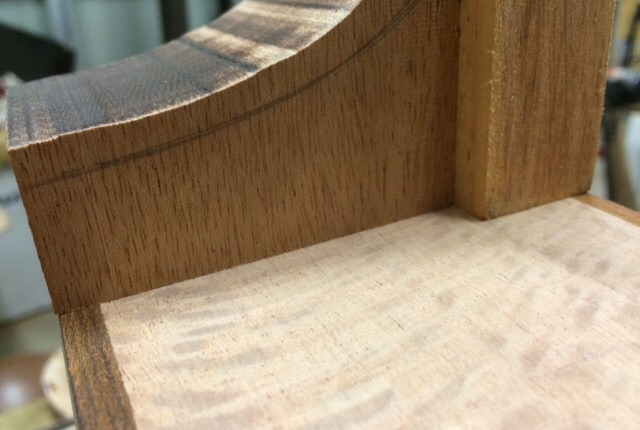

Coming along nicely Allan.
Just be wary (although I'm sure you're already aware), if you're going to linish that face, a second or two too long on the belt and you could change the neck angle. The linisher is my most used tool in my shop but personally, in this instance, I'd be creeping up on that face. A scraper may take a few minutes more but a cock up would take longer to correct.

A few wipes with a 120grit sanding board is how I would handle this.....
You're right. I'll probably give it a gentle block sand with 80grit and see how that goes. I was happy with my efforts on the angle with this one so I would like to keep it in tact!

About thirty seconds with a cork block and 80 grit and it's looking much better. This is only just sitting in there, not even pulled tight with bolts.
Looks like I need to find time to carve the neck now.

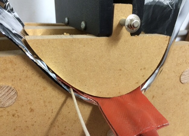

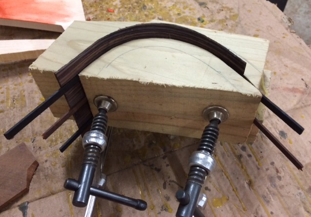

I got around to trying the cutaway jig I made up for the LMI bender today.
Rosewood cutaway and two strips of ebony. I took it extra slow and it bent without drama.
