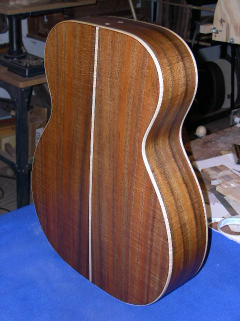

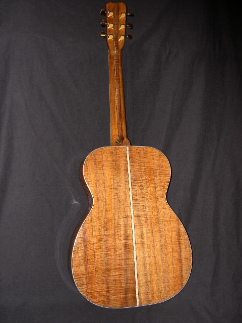

A few more shots--

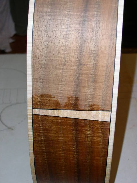

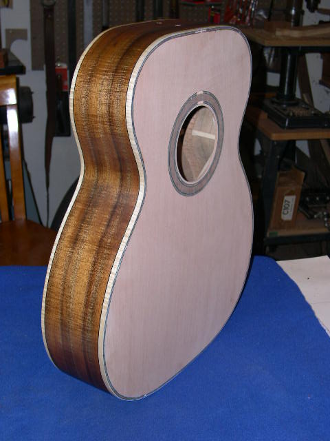

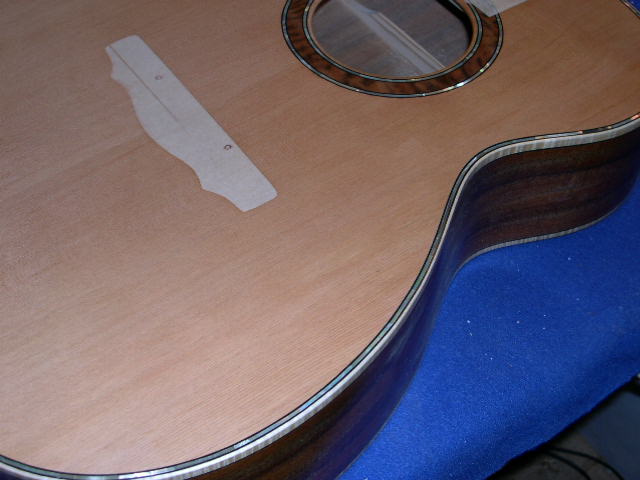

These first two show the Blackwood coming to life with the thin wipe coat of Danish oil:

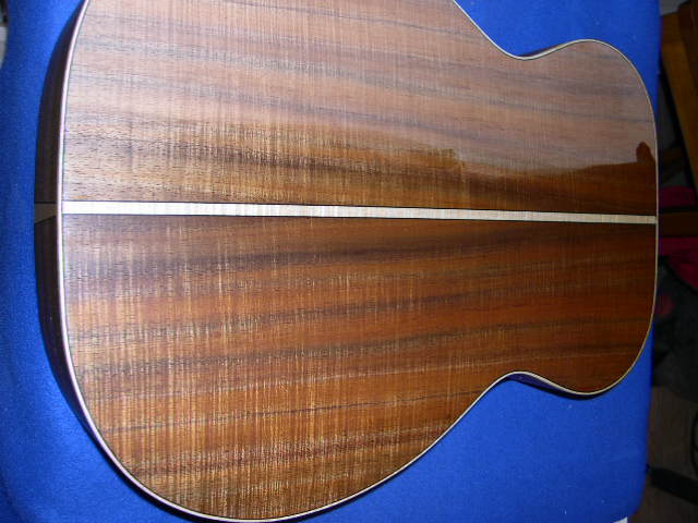

Here's the back/side view with the Danish oil treatment complete:
And the side/top view:

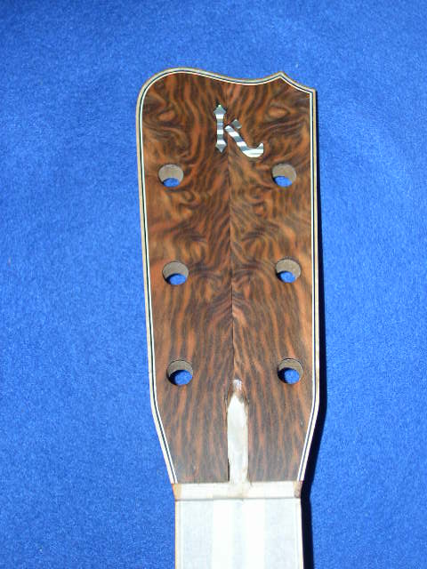

Finally, a view of the peghead with our logo installed.
Ryan went in a bold direction and cut the logo out of highly curled green ab-- it's a busy peg head:

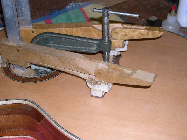

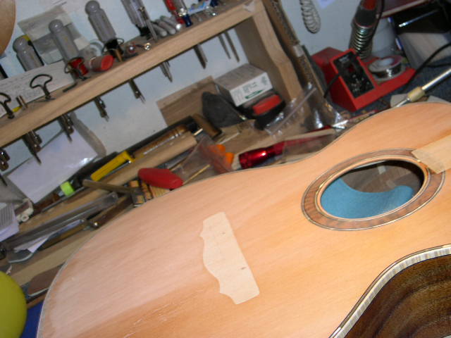

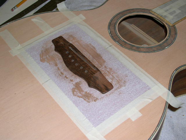

Fitting the bridge to the dome of the top.
The bulk is removed with a scraper, then a bit of back & forth on this sand paper reveals what little bit more needs to be removed for a tight fit:

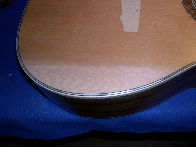

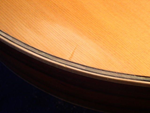

They say that misery loves company. If so, you'll love this installment.

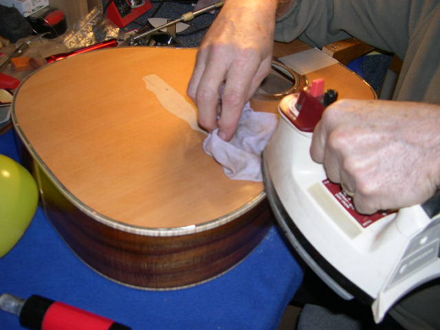

So the finish prep was going along just fine. Actually starting to spray lacquer on the body.
Started spraying first top coat on the KB Pine, when my handle (that holds the body) broke.
So while I'm taking the body off to dry, that thing snaps, and the guitar flies downward, bouncing off the steps into the garage. Of course, top first.
I feared the worst, like cracked top, broken *anything*--but this is all that happened:
It's just a dent I tell myself, and wonder if a drop fill will fix it. However, we all know better--a drop fill here will just advertise the problem. So, sand down to bare wood and steam it out:
This is how it looked after steaming--dent is gone.
Then the thought that I'll only have to refinish that small stripe on the right side. But I've found that finish blending or repair--on tops--is the most unforgiving problem in lutherie.
Eventually just stripped all the finish off.
So here we are, all the top resanded, and ready for the (new) sealer coat.
Which I'm happy to report looks good, and we're ready to start where we were yesterday.
Oh, and the handles are also repaired, as well as strengthened against similar disasters.

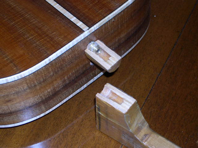

A happy event occurred this afternoon: got the neck on this KB Pine/Blackwood 000.
Always a nice moment.
What took so long? Finish glitches, then more of the same. Just thought it would be easier to do the touch-up sans neck.
So here it sits, with the neck newly attached. We use two bolts in the heel, and glue down the fretboard extension:
Thanks for your patience,

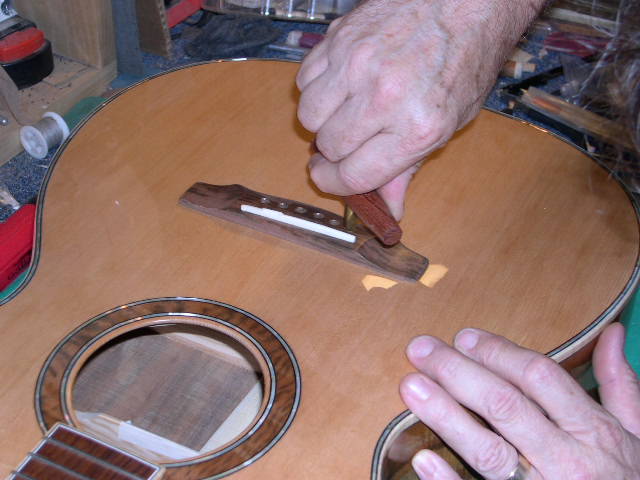

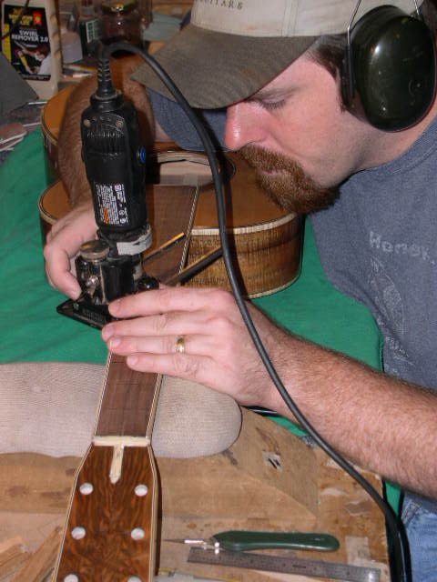

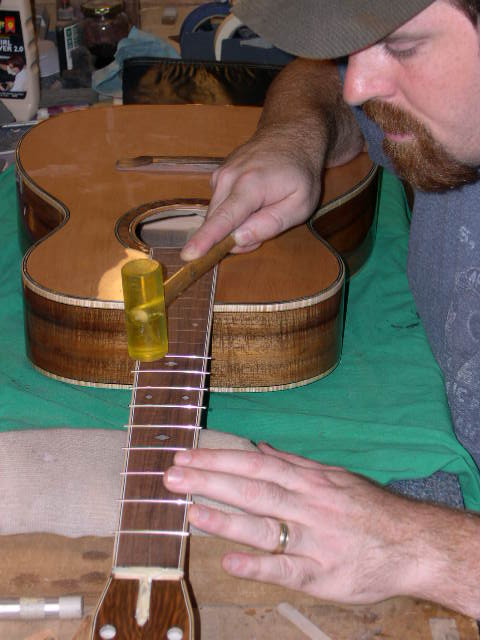

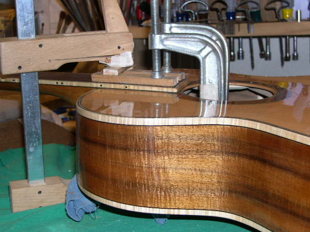

Another nice couple of days:

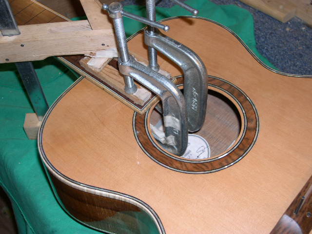

Gluing on the bridge:
Routing the fretboard for inlays. We went traditional, as there seemed too many overtones to inlay the Southern Cross. So, the old "Diamond and Squares" inlay it will be:
Ane here is Ryan rapping in the frets:
Thanks mates,

Re: KB Pine/Blackwood OOO
Ooooh, how did that ^ sneak in? Not sure, but there it is-- reaming out the pin holes.
