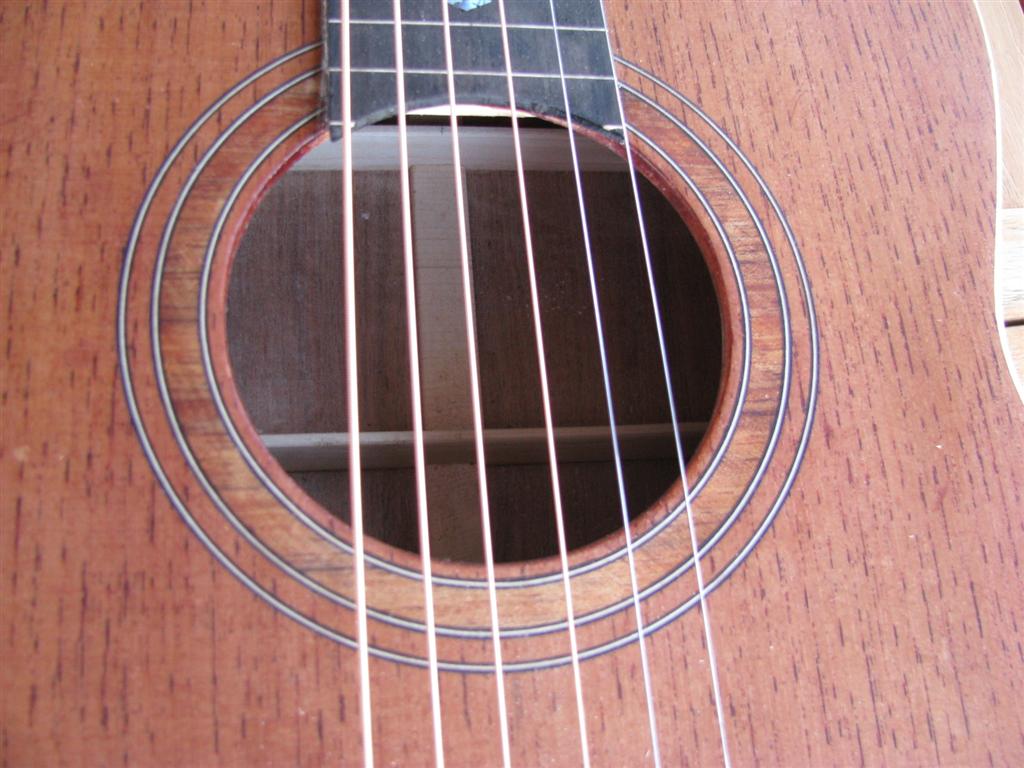

This one will be for a dropped D tuning Kim (DADF#AD) and a 24.9" scale so there won't be too much tension on the top.
Having said that I did tuck the lower legs of the X brace into the linings as a bit of extra insurance.
I would like to build one for a dobro type tuning (GBDGBD) which has much higher tension so I'd brace that one a little heavier.
Seeing as this is the first one I've built I'm erring on being conservative but the worst thing that can happen is that you have to replace the top.

Hey, Bob, I'm curious as to what the x brace height is, on the one that runs under the taller one.

They are both 12mm Alan or half an inch. There's a cap on the X-brace lap joint that makes one look taller than the other.
They are also 8mm wide - same sort of bracing I'd use on a dreadnought.
Just bear in mind this is the first Weiss I've built so it may explode when I string it up

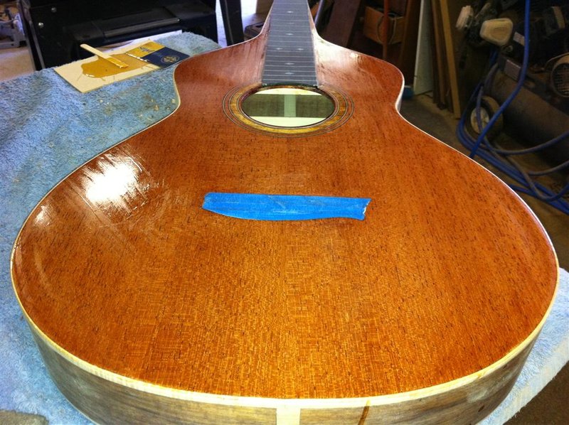

I'm pore filling with Z-poxy and this is the fourth application. It will also be the last
I've been leveling with Mirka Abranet 150 which doesn't clog with the epoxy dust. I swapped to this on the lasy two coats of Z-poxy after going through a heap of normal 240 grit sandpaper. The Abranet's not cheap but is so much better than standard sandpaper for this job.
Here's what the Surian comes up like. It's a warm, golden brown and the pores stand out which gives it an old sort of look, which is what I was after.

I always use a very sharp cabinet scraper to level the epoxy and get the worts of it off Bob. Sure is a lot quicker and saves heaps on sandpaper.
That Surian looks beautiful. Got that old world look to it.

It's a lot lighter in weight than Australian Cedar Allen so I'm looking forward to hearing what it sounds like.
I really like the look of it too.
I'm going to finish this with 30% gloss so it'll have a satin finish.
Re: Weissenborn Copy Build
Love that old amber glow you have going on there Bob, she's gonna have much mojo me thinks.

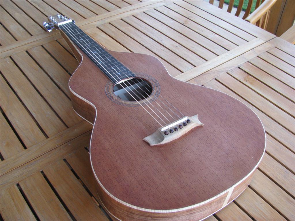

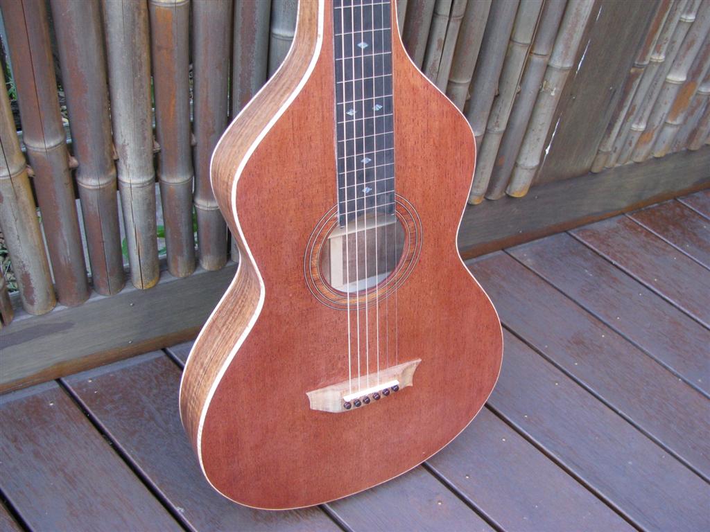

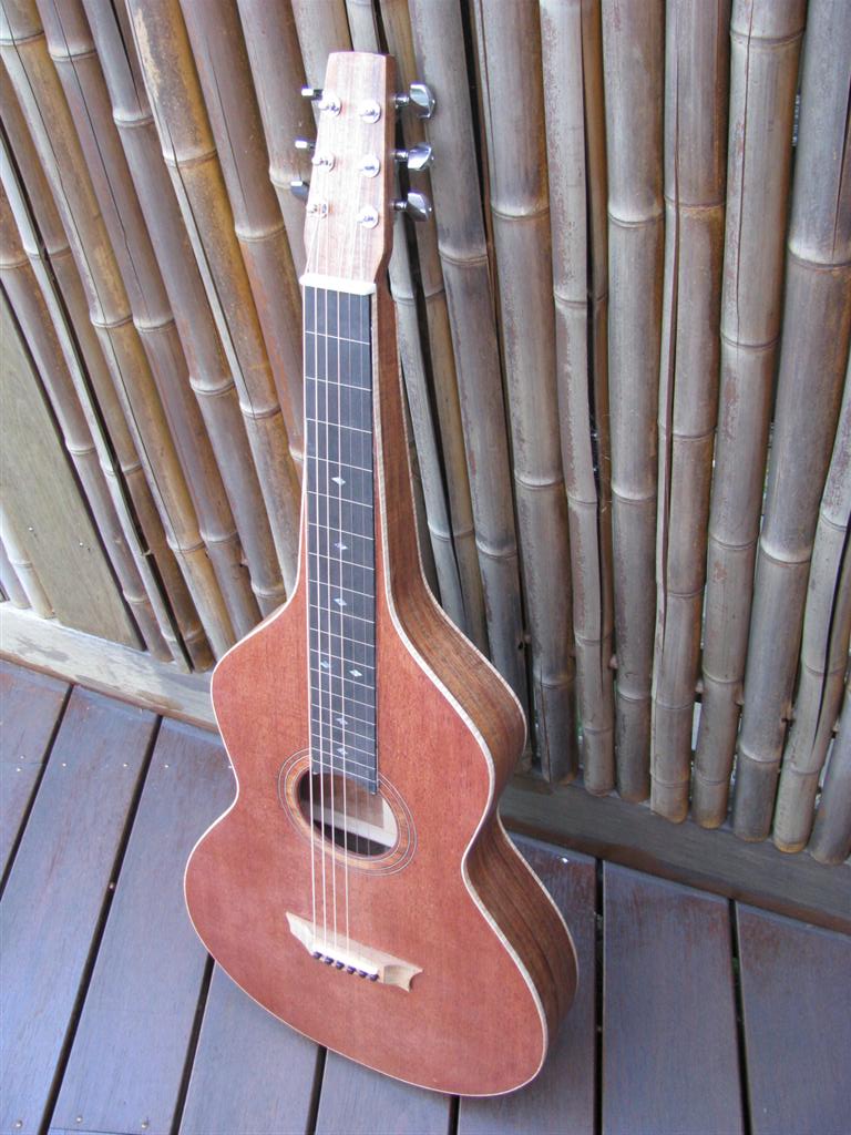

Well - it's finished and has been strung up for a couple of hours and hasn't fallen apart or collapsed yet so I suppose that could be categorised as success.
I'm not sure what it's supposed to sound like because I've got nothing to compare with but it sounds OK to my ears.
I'm still waiting on a proper set of strings to arrive (60-15) so it's got a set of mediums with the high replaced with an .015.
I enjoyed building this on so much that I've nearly completed a second one (this time with a Celery Top Pine top) I wanted to get this one completed first so I could make appropriate changes to the second one (in case of a catastrophic failure.
The finish is Mirotone 3220 - 30% gloss rubbed back with 360 wet and dry. Hell of a lot less work than 100% gloss and I think the satin finish suits the vintage vibe of these instruments
The top on this one is 2.4mm thick.
Great work Bob.

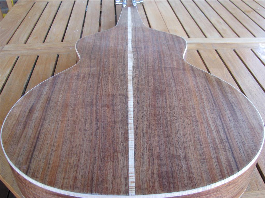

I really like the whole package, visually, the surian and blackwood are a match made in heaven and give a real warm traditional look, vintage vibe if you like. Just hope she sounds half as good and she will be a real winner.
Great looking guitar Bob. The blackwood sapwood bindings looks fantastic. What's the bridge - is that made out of the same stuff?
