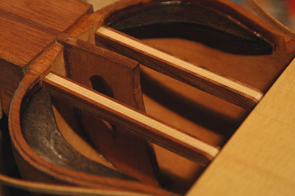

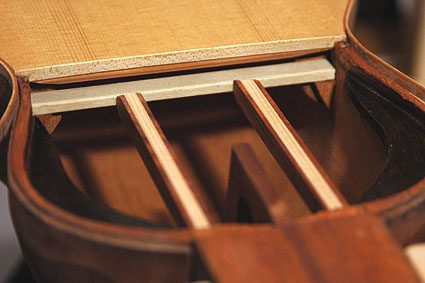

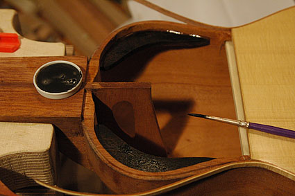

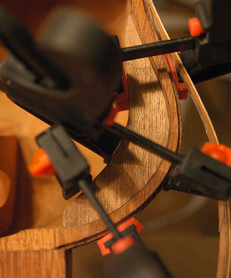

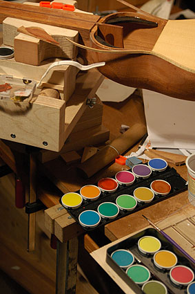

Before proceeding with the the internal Eiffel Tower construction I thought it might be wise to give the upper bout contours it's rigidity back I had robbed them for cutting the soundholes so near to the borders. I prepared some kind of partial second soundboard pieces to be glued to the bowl walls below the rosewood "soundboard-pickguard":
Dry run:
I didn't want to make them too obvious so I painted them in a colour similar to the shade inside the charango:
I did not use all colours, just brown and red for "grounding". When nearly dry I wiped this layer halfway off and then went on with black (steady hand needed when not protecting the instrument - no excessive coffee drinking allowed):
Then I brushed some shellac on and rubbed it out a bit, trying to not get it too shiny. I also streamlined the anchorages for the transverse bar a bit more:

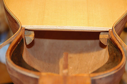

Finally I glued in the transverse bar, put in two more small triangular supporting blocks and glued in two sturdy laminated spruce-rosewood sandwich bars between neck and carbon fibre transverse bar:
The two bars run in a slight angle from the neck to the transverse bar. If assuming that the whole neck pivots around an imaginary axis near the bottom/heel, those bars will be loaded in direction of at least nearly their long axis:
That's how far I got until last Sunday. Now there's more Friendly Plastic use planned...Markus

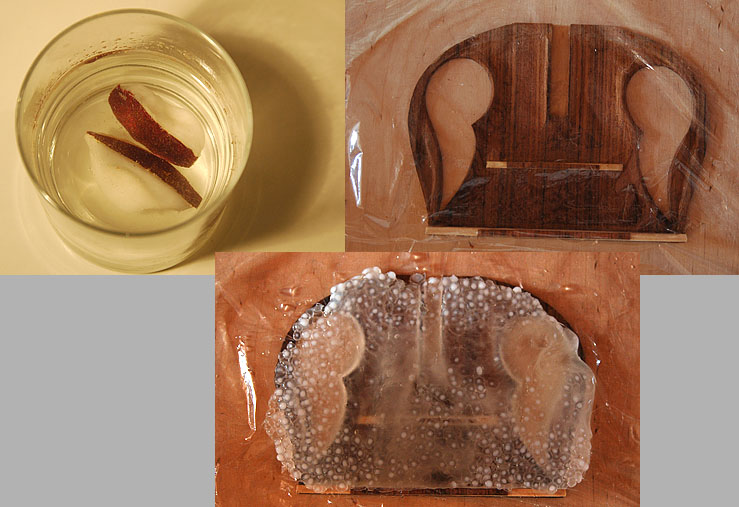

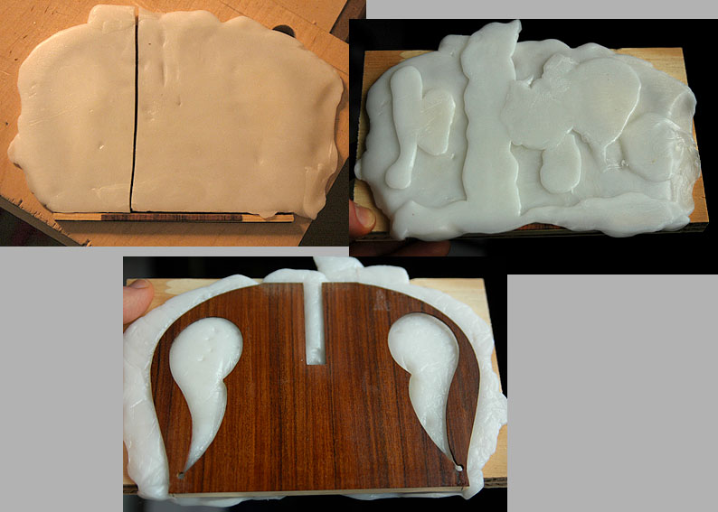

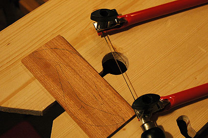

The rosewood part of the soundboard (I'll call it "golpeador" as one normally does for this part of the charango, even if in my fragile version it's not really a pickguard anymore, which is what the word "golpeador" means) first time already had broken when french polishing, much before I first strung up the thing. It was always a bit difficult applying enough pressure but not yet destroying the golpeador. So I thought I would do the french polishing this time before gluing the golpeador on:
The Friendly Plastic sanding blocks are taking a bath in order to separate them from the sanding paper an reuse them for a caul for french polishing the golpeador (adding more Friendly Plastic, of course). To my surprise Friendly Plastic was not as friendly as I hoped, it shrinks too much for what I wanted it to use. So I had to cut the caul in two pieces and "glue" them together with more Friendly Plastic. It doesn't look very nice but I hope it will do it's job before I'll melt it again for using it again. The golpeador is now ready for being french polished again. You may think now it would have been much easier and more logical to simply make another, stronger golpeador. That's right, but I really don't want to trash it because in the end, all this wood is a gift from Julio and Edgard, and rosewood, when bought as quartered tonewood veneer costs in Perú just about the same as, or even more than in Europe or Australia, only that the average peruvian income is not the same. So I really would hate to throw it away, even if Julio certainly would do it. Kinda sentimental stupidity from my side...
In the beginning I thought that a thin golpeador could probably act as a passive vibrating element, influencing sound in some way (having not much of an idea in which way this would/could/will be). Maybe this is true, or not. But anyway, I don't believe it will do a big thing. Maybe I'll see and hear what it's effect could be when making the next charangos which certainly will have a STURDY golpeador!

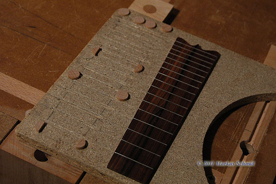

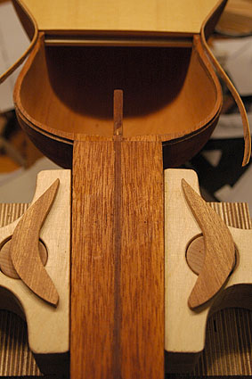

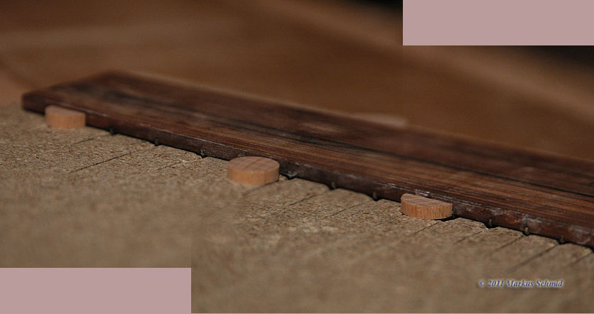

Re: When it's not normal: fun, but the price is higher. Char
Well, some months ago the golpeador got french polished and the box closed again, the binding slapped back in place, not really breaking news...
I wished to bring down the saddle hight which with 10 mm was "a bit" (way!) too high for a charango (about 6 to max. 8 mm would be normal). Before the first bridge wreckage the action was just about perfect (about 2.2 mm at the 12th fret, no noise at one note below "nominal pitch" - as you already know the bridge had failed with the strings tuned "right").

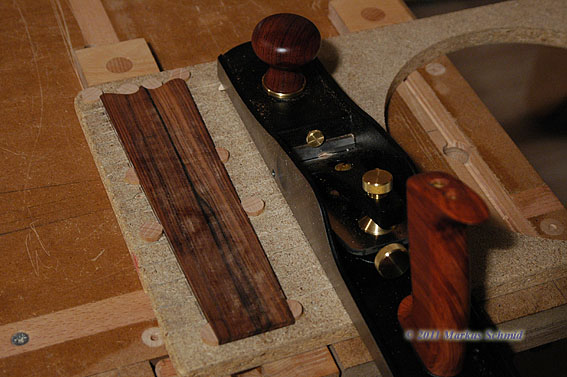

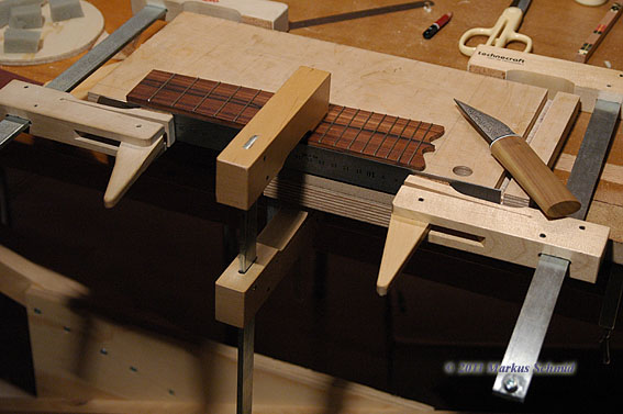

So I decided to lower the fretboard at the 12th fret by 1 millimetre, leaving it at the original height at the nut. During the whole process I did not removed the frets (with the exception of the two frets where the location pin holes got re-used when gluing the fingerboard back to the neck). Six pictures say more than tons of my blahblah, so here we go:

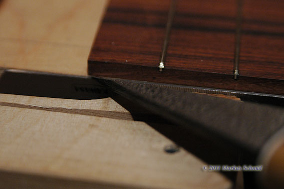

Scribe the line to which I then planed back the fingerboard: Planing the fingerboard with the frets in place: This was about ten days ago.
The first time I had glued on the fingerboard I had used Titebond and I had to learn that it is relatively easy to de-glue, but cleaning it up well is a mess and very tedious, especially if you don't want to scrape back any wood at all. Well, who would want to think of ripping off the fingerboard even before the instrument is finished!
This time I didn't want to take a chance and the fingerboard went back on to the neck with hot hide glue, using the same steel location pins and holes as I did the first time. To prevent the neck from back bowing I wetted the outsides of the neck with the steamer, in order the gluing surface and the outer surfaces would expand by about the same amount. The next step was to smooth the bowl shape with scrapers and shape the neck...

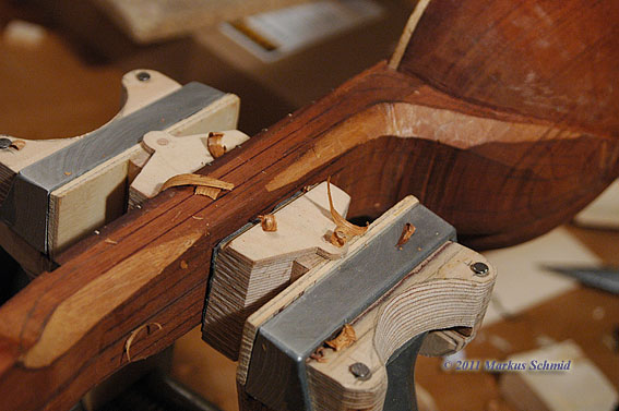

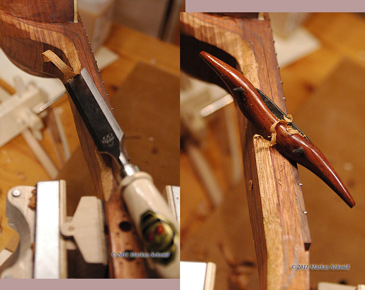

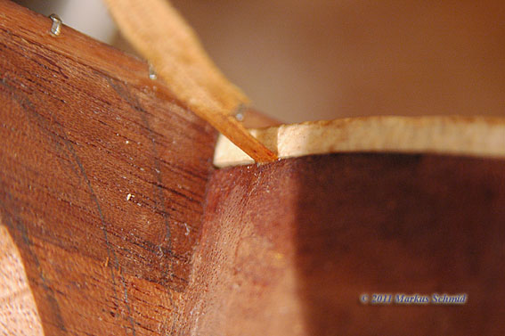

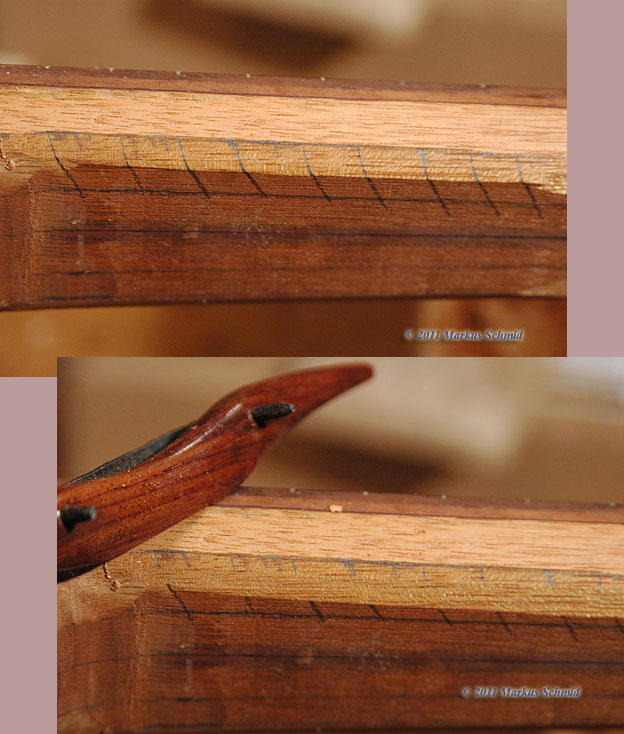

Hiding sloppy binding channel cutting action:

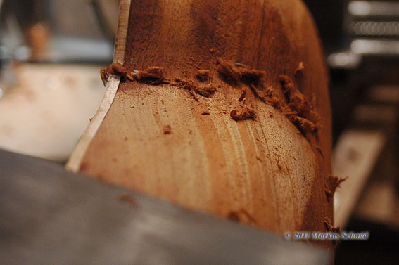

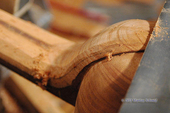

Scraping the body, smoothing out the ridges left when carving the bowl with the spokeshave:

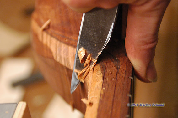

Chisel work:
In the tight curves I felt more comfortable with the knife:

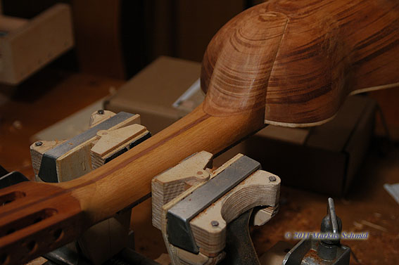

Neck carving:
Smoothing the neck with the scraper is fast and accurate:
Ready for sanding:
I hope to get it pore filled and maybe french polished before 2011 ends. It would be nice to play a happynewyeartune with that little bugger!Markus
