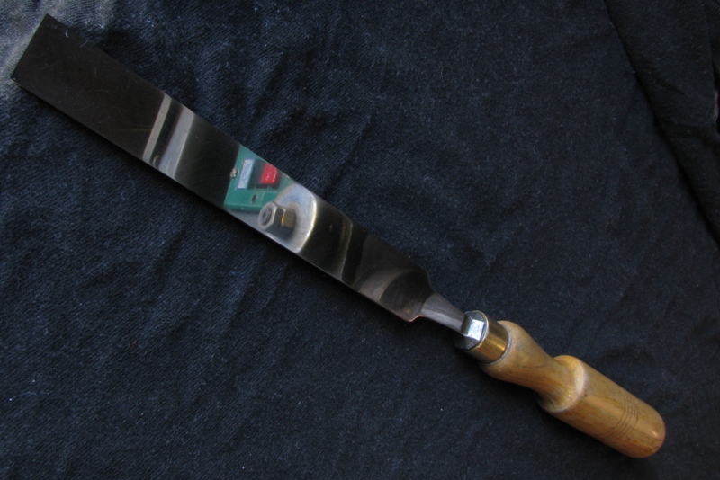

Yep that link covers it quite well. One thing I will add is that a single edge tool can only ever be as sharp as the back is flat. Before you think about working the bevel, you need to get the back flat and polished. I take my bench chisels right up the grits until they are like a mirror.
This not only gives a superior edge, it also ensures that the edge is easy to maintain with just a few quick passes over the higher grits. I use to sharpen all of my tools for site work by hand on an oil stone. But this was a daily task for heavy carpentry. The high quality edge tools I use on the bench are all sharpened with a honing guide, yes I can sharpen them by hand, but I choose the guide because it is more conservative with hard to find quality steel such as EA Berg etc. Another tip is to use a leather strop charged with green honing compound to maintain the edge between sharpening session but you need to be careful to leave the back of the blade flat...I avoid using a back bevel for this reason.
Here's a link to the type compound I am talking about..works real good: :mrgreen:

Kim wrote:Yep that link covers it quite well. One thing I will add is that a single edge tool can only ever be as sharp as the back is flat. Before you think about working the bevel, you need to get the back flat and polished. I take my bench chisels right up the grits until they are like a mirror.
This not only gives a superior edge, it also ensures that the edge is easy to maintain with just a few quick passes over the higher grits. I use to sharpen all of my tools for site work by hand on an oil stone. But this was a daily task for heavy carpentry. The high quality edge tools I use on the bench are all sharped with a honing guide, yes I can sharpen them by hand, but I choose the guide because it is more conservative with hard to find quality steel such as EA Berg etc. Another tip is to use a leather strop charged with green honing compound to maintain the edge between sharpening session but you need to be careful to leave the back of the blade flat...I avoid using a back bevel for this reason.
Wow that is a thing of beauty Kim. I am looking to purchase some chisels at the moment. Cumpianos book suggests a 1" and a 1/4" paring chisel. The only ones I can find are from this website http://www.macwood.com.au/index.php?mai ... cts_id=636. Can you suggest a good source for these?
