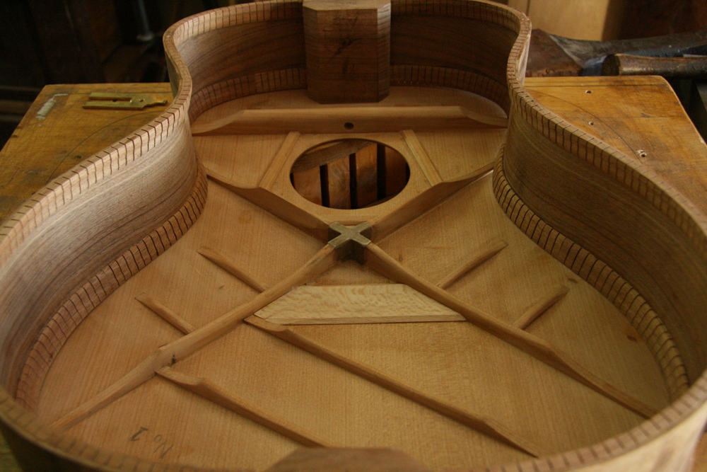

A pic of the insides, I changed that bridge plate, after I had it glued up
, it was in the wrong spot, and it's a small one.
