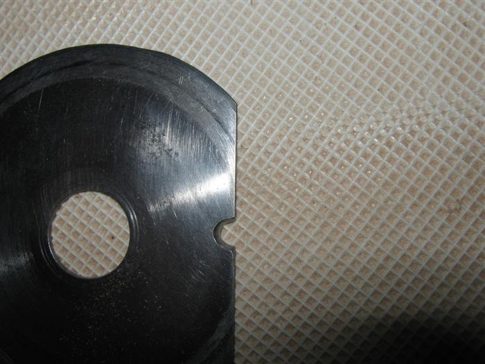

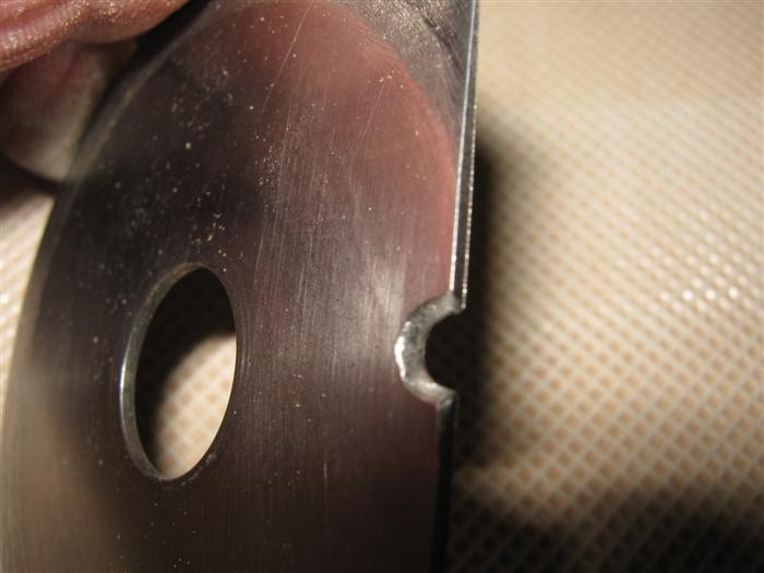

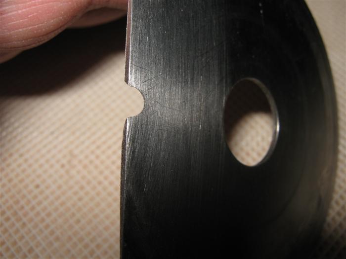

Alan, The viol family as you know have the back and belly overhang the ribs by a couple of mm, to creat a uniform rounded edge on a violin build i made this little scraper in the profile i neded, works well, baybe you could try something similar for your aplication.

Thats a great idea Rod. Looks like you have used an old mover blade to make the scraper tool out of. Doing a round over by hand I reckon always looks unfinished. The uniforn edge is what I am looking for. Thanks heaps for the idea.
