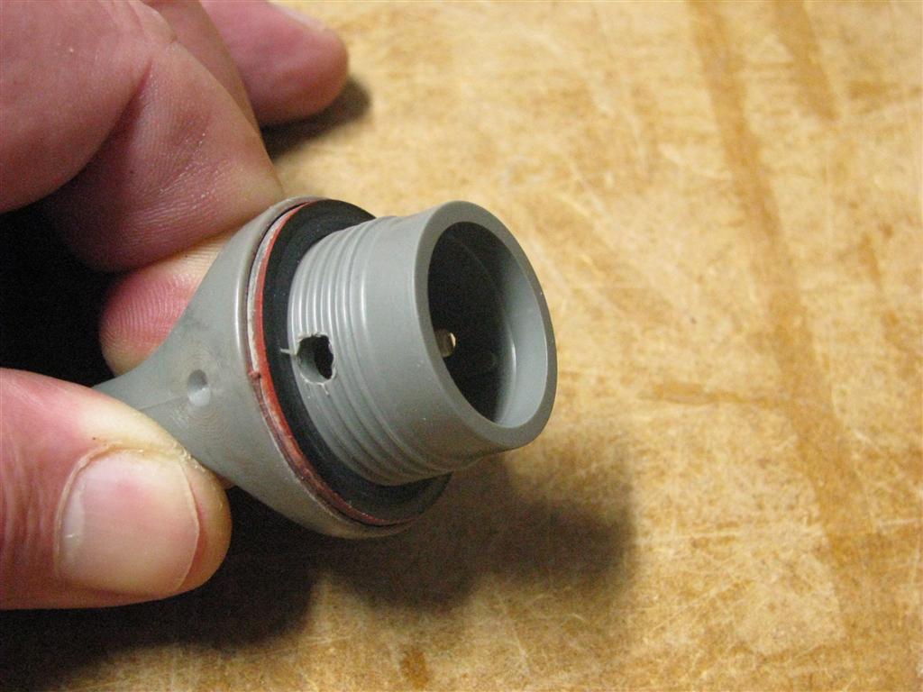

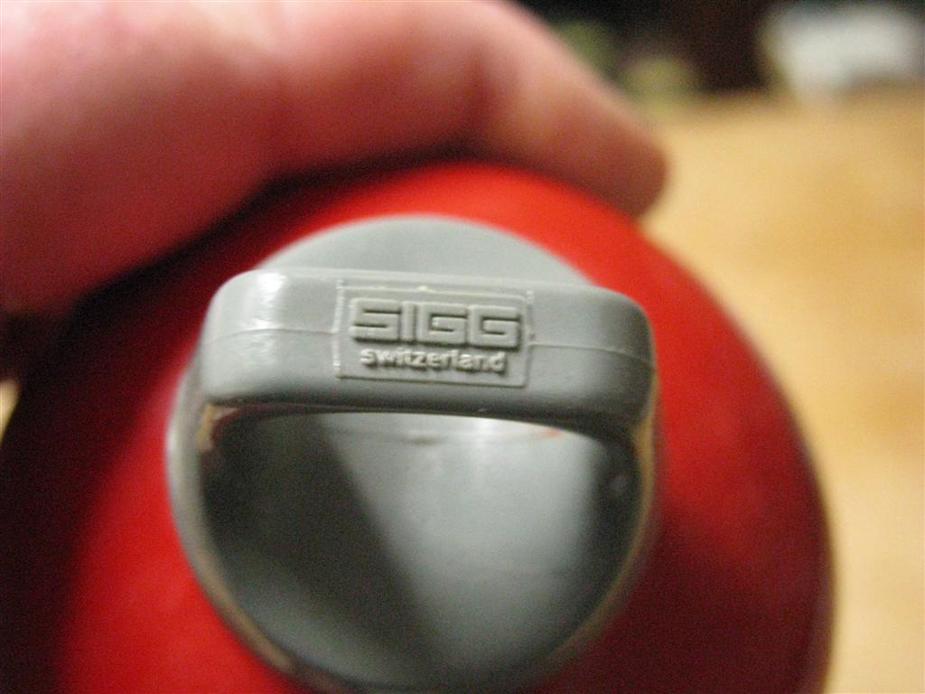

I grabbed the above image of the Sigg bottle from the net but it does not show the actual holes drilled in the threads so I went out and took some quick and dirty images of my own to show more detail...yes it is only a small thing, but it is very helpful especially in allowing accurate control of the flow of product....
This is the very top of the screw top showing the banding.
Here you can see both holes, the larger in the forefront of the image, and where they have been drilled in relation to the seal...note also the dot to give external indication of the spout location as you unscrew the top.

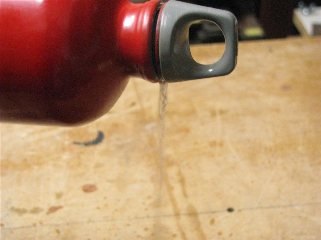

This image is a goofy attempt to show the consistent flow stream of product (Naphtha) that the vented hole delivers. Yes this will still pull moisture laden air into the bottle, but it will only allow the minimum of exposure and much less than leaving the bottle uncapped while you sloshing it around on a rag.

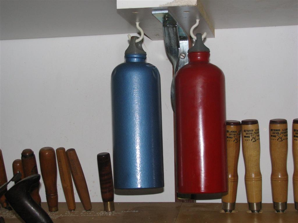

And here are my two bottles, one painted red for naphtha, and the other blue for meths, hanging up out of the way and ready for use.
Not trying to be cocky but I'd be looking at putting labels on those bottles. Colour coding is fine but if anyone else wanders into your shop they won't have a clue what's in the bottles. :D
Me being anal..maybe but Ive just spend half an hour explaining to one of my Mudloggers out here at work why storing bacteriocide in an unmarked lemonade bottle is a very bad idea. :-?
Re: Bulls Eye Shellac
Post by Kim » Fri Jun 24, 2011 11:25 pm
No one is allowed to do any work in 'my' shed but me Marty...my shed, my tools, my rules, my bottles, my colour codes, no labels required. If someone comes into 'my' shed and ask me, what's in those two bottles Kim?? I will ask to see their badge.....and should they produce one that forces me to acknowledge their right to question, I will ask to see their search warrant, and should they produce one that I am then forced to acknowledge and then repeat their question, I shall look at them very sternly and say..................fluids 8)
