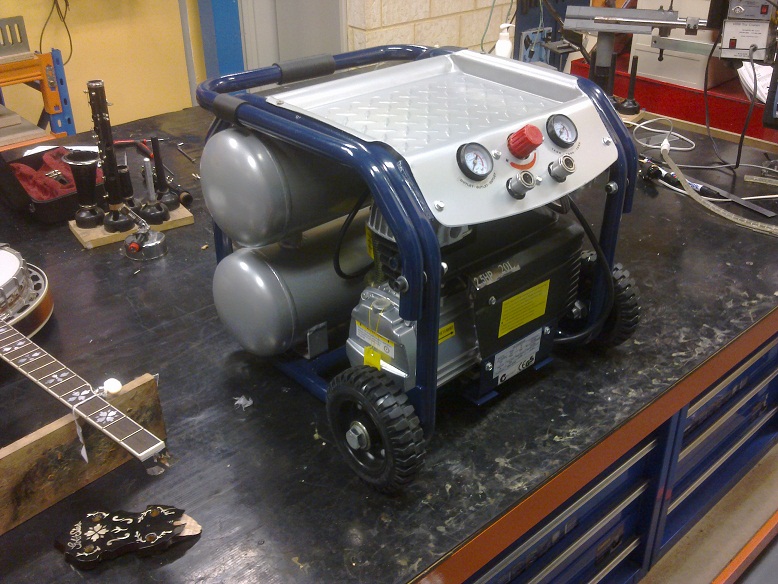

Well still waiting for LMI stuff to arrive, frustrating, Ive got to give stewmac one thing if you place an order on a monday by friday its delivered to your door here in australia, there postal service is very good.
Ive ordered a vacuum pump, waiting for it to arrive from qld, but I was in bunnings today and they had this little unit on a clearance 100 bucks.
Thought it would work great as a vacuum pump assembly, swap out the gauges and the pump and should be good. Well I hope so

Great pickup Steve, should work out perfectly.

If the thing blows up (I give it 6 months before it sucks itself to death) it'll make a dandy drinks table.

Why do you think it will implode.
The tanks equal 20 litres, so being a newbie at this vacuuming world, Im assuming a 20 litre vac'd tank should be enough to hold a bridge down for 30 minutes.
Ill swap out all the fittings on the front and turn it into a mobile work centre.
Couldnt believe my luck when I saw the thing.

Steve am I correct to assume you intend to retro fit a Joe Woodworker EVS system into that compressor? If so it will be ideal, the tanks and frame should be perfect.

Thats exactly what I intend to do.
In the short term, whilst waiting for parts it will simply be the pump hooked up to the tanks, as soon as I can get the kit from those guys I will retro fit it to the whole system.

I can't think of the last time I bought anything from Bunnings that lasted longer than 6 months. The Ozito router I bought lasted 5 minutes and went straight in the bin once I noticed the depth stop kept changing its setting as soon as the cutter hit wood.simso wrote:Why do you think it will implode.

Ahhh, now that makes sense.
The compressor pump, the heart of this unit is going straight into the bin. The tanks are aluminium so if they ever split I can tig them back up. The gauges are going in the bin and same with the piping. Im only keeping the tanks and the base frame so hopefully all will be good.
