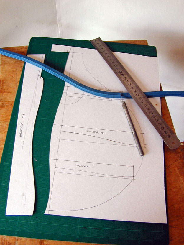

Ruben,
Don't get too stressed by having your curves exactly following the curtate cycloid curves. Do them so the peak of the arch is under your bridge. A simple way to draft is on a piece of heavy card (I'm a non-CAD person) and here is a pic of the tools I use to do these. A flexible ruler is very useful

Ur r right anyways I exhausted my intends of exporting those curves into my autocad… but more traditional approach will do, tomorrow I will reduce the top thickness and see what happenGraham McDonald wrote:Ruben,

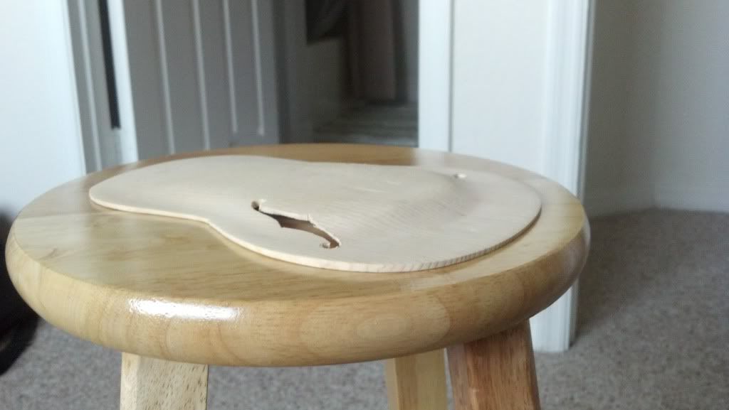

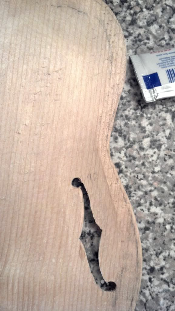

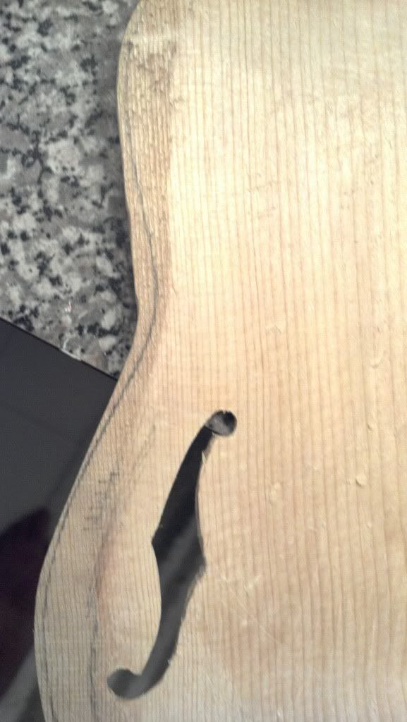

Some good progress this Saturday
But I ran into a little trouble...I carved too close to the Edge of the top (can u see the pencil marks).... it wouldnt be a trouble but I wanted to bind the UKU

You could try and build the area back up with several layers of thin veneer. I always carve the insides of the top and back first. After the wedges have been book matched, I sand the outside flat, down close to the final height. The flat area makes it easier to hold the top while carving the inside. And if you go too far, a couple of passes on the belt sander can make things right.

I some time ago Re-edged a double bass, that's a lot of work jejeje may be more that Star all over (This is a good experience for me i know next time to plan for this)... but other than that the top is fine... I really cant figured out how to star carving from the inside fist, i see it does haves some advantages, but I will get confuse, how can i figured out the outside shape then???Bradford wrote:You could try and build the area back up with several layers of thin veneer. I always carve the insides of the top and back first. After the wedges have been book matched, I sand the outside flat, down close to the final height. The flat area makes it easier to hold the top while carving the inside. And if you go too far, a couple of passes on the belt sander can make things right.

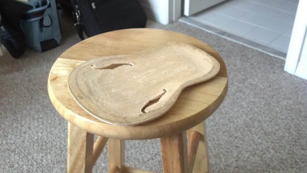

Some slow progress
