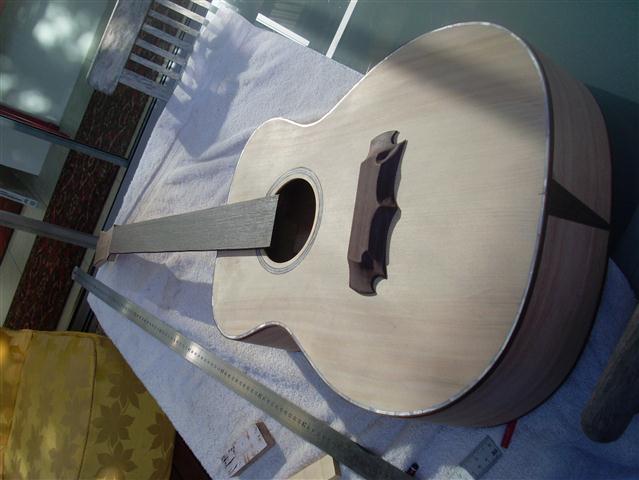

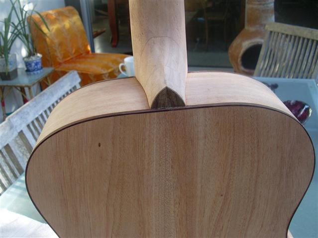

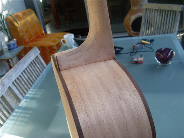

Finally ran out of excuses for not fitting the neck. A bit of a challenge for me on the first go, but it's rock-solid, even if it's not beautiful. The nasty bits will be covered by the fretboard, but.
Here's where I am today. Tomorrow, the truss rod installation....waiting on a fret saw to arrive, as all mine are pretty catcus..

Don't know why I couldn't edit my previous post to add a comment, but..
I'm not too sure about the bridge yet, but it's a work in progress...
Also, failing to find a router bit deep enough, I did a multi-cut using dovetail and straight bits, and finished off by hand...Was going great, until I stuffed it up in the last second and had to use the shim trick...

It's generally a good idea to hog out with straight cutters and then do the final cut with a dovetail.nnickusa wrote:Don't know why I couldn't edit my previous post to add a comment, but..

The bridge...mmmm..looks like a Klingon warbird. Not my cup of tea but that's just my personal taste which at times is questionable.

Exactly what I did. Clean out the center to proper depth, then hit the dove tail on the sides, leaving only a corner to clean out...
Same on the neck side...
problem I had was with the fitting after the cutting was done, but I figured it out next time round...

Looking interesting Nick, I'm abit like Martin & not sure I like the 'heavy' looking bridge but it's not me that's going to own it! Did you undercut near the base of the dovetail? This can help seat the heal snuggly against the sides and make for an almost 'invisible' join.

I'm thinking about mortise and tennon next time...Seems, from the video that was posted here earlier that it's a much quicker way to do it. I did want to try the dovetail first. In fact I was just following the book.
As to the shape of the bridge, I had an idea, but I don't think I like the way it looks--both "Batman" and too big for the guitar. Some ideas don't necessarily translate well into reality
I wasn't aware of bridge weight being a significant issue, but will weigh it today. I do think I'm going to change it....If I stuff up, a new bridge blank is only $10, so I can always start over....

Nick, I do not use ebony anymore because of the weight. Rosewood usually comes in at about 30g. You can shave that too to about 24 if you take a lot out of the bridge from the line of bridge pins back. They no longer look "trad" but they will make the guitar louder as F=ma and you have lowered the mass therefore the acceleration will be larger for the same string force. I didnt really know just how critical this was until I started to get into the Trevor Gore approach to the guitar. I use the word approach because that is what it is, a whole approach to the subject of making an efficient guitar. None of the stuff he talks about is new (after all its physics going back at least to the days of Sir Isaac Newton) but he has collated it through experiment and experience into his approach and I believe that it is a very good approach and one that I feel can benefit all makers. i know it has benefited me as the guitars that I have made post reading his book are much better than those that came before. I have made 5 guitars using parts of his approach (it takes time to be able to change direction and there are so many things to consider) and they are much richer sounding. There are quite a few innovative things in there as well and new skill sets to develop so it will take me a while to fully implement all the things that I want to from "the Book"...I am just glad that he wrote it!

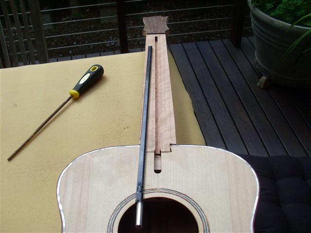

2. Today I routed for the truss rod, but have a bit more to go before it's done...I'm taking it slowly, but have stopped dithering and just get into what needs to be done....
3. Tomorrow I finish off the trussrod, and filler, and cut the frets, and shape the fretboard to fit....then I go to work.

You're routing the truss rod channel after shaping neck? I generally do it while the neck is in blank form and Ive got a square blank side to register the router fence off.nnickusa wrote:
Re: Newbie with a project
According to Kinkade, this is how he does it. In fact, with the dovetail, it seems to make sense....since I need to go thru the neck block as well...

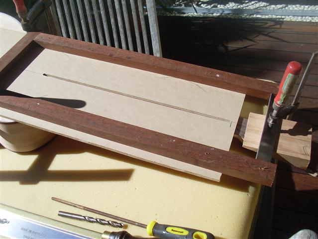

I made this jig..aligned to the centre of the neck and guitar.....saves the trouble of trying to get the neck and neck block the same---I guess

This is the jig
This is the result

Looks fine for the way Kincaid fits the truss rod...was just curious.
