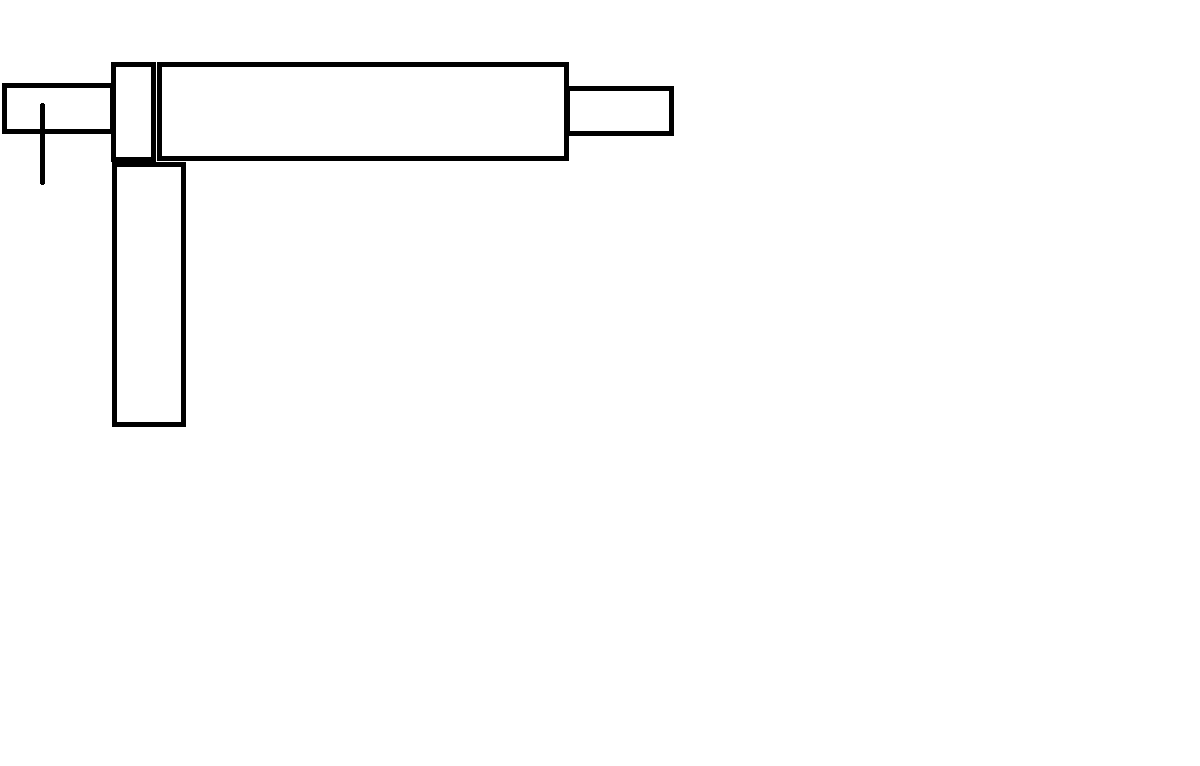

Hope this helps. The verticle bar is the gremlin and the horizontal bar is your existing tool. The top bit of the gremlin has a hole cut through which the knife bar fits. Despite my crappy picture the side of the gremlin that runs against the top is smooth and does not step all the way up the knife bar. And one screw into the body of the tool should be enough to fix it solidly.
let me know if have succeeded to make it more clear or not.
