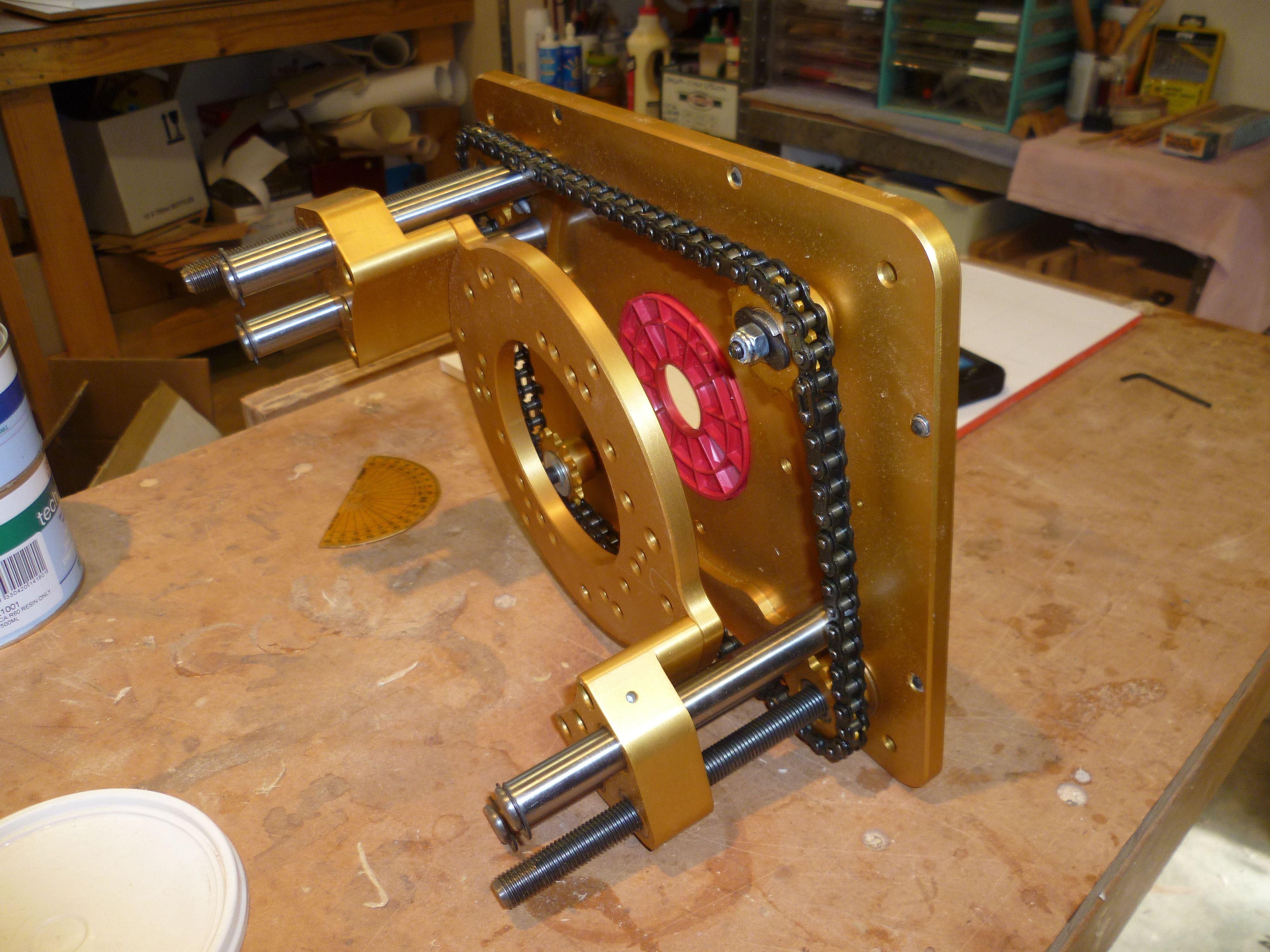

50mm thick wont be a problem if youre using a router lifter.....it sits in a recessed opening the depth of which is governed by thickness of the lifter plate.

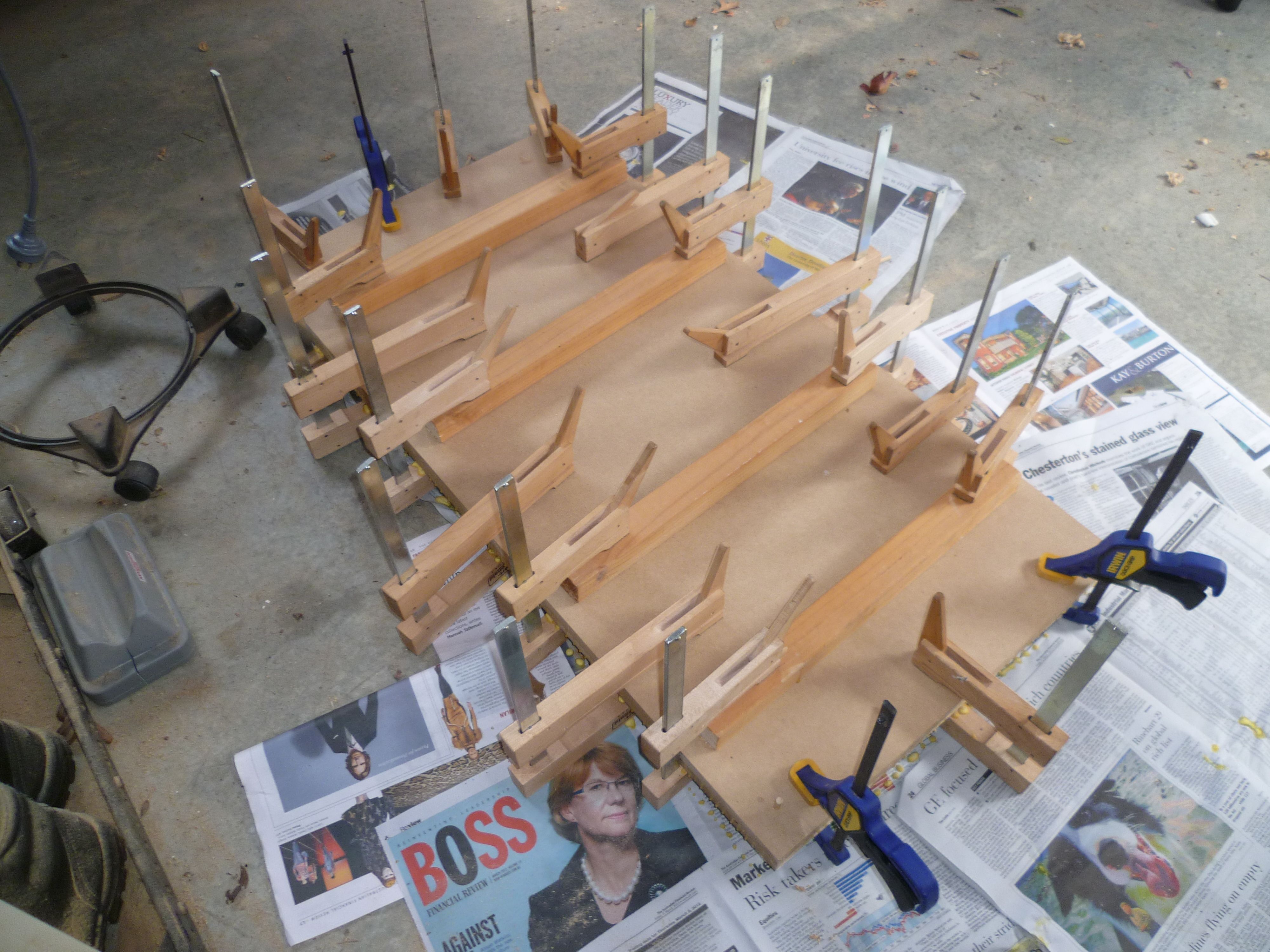

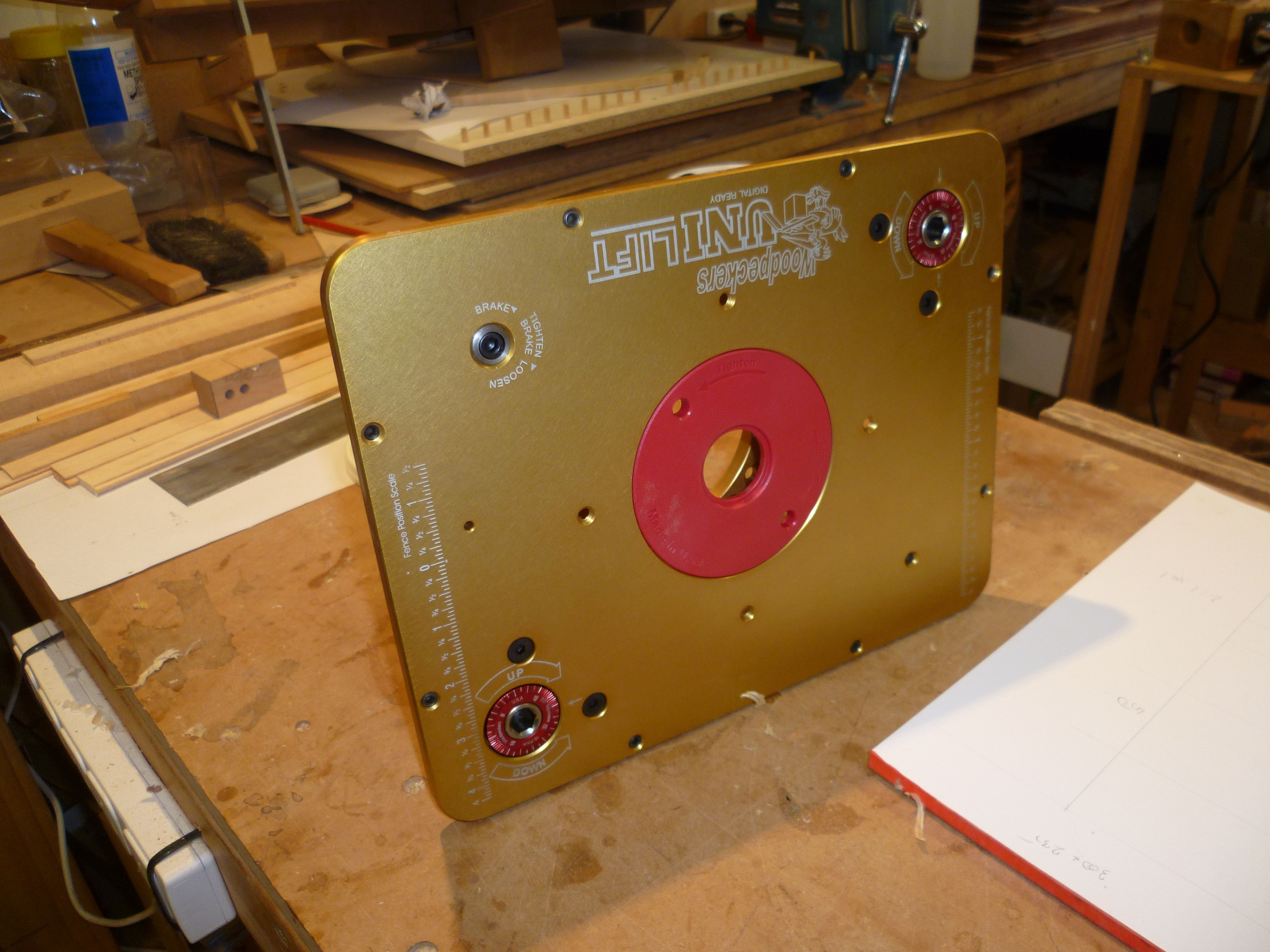

Second clamp from the left top hasn't got enough pressure on it & the fourth has too much! Geez do you want to get this thing right or not?
The Unilift's a bit flash Martin! Puts my old table to shame

Was going to park the Mazda on it overnight but the boss needed the car for work.Nick wrote:Second clamp from the left top hasn't got enough pressure on it & the fourth has too much! Geez do you want to get this thing right or not?![]()

Shoot!!That's a nice looking bit of equipment Martin. did you order it here or OS?
Nice to be able to adjust depth of cut from the top.

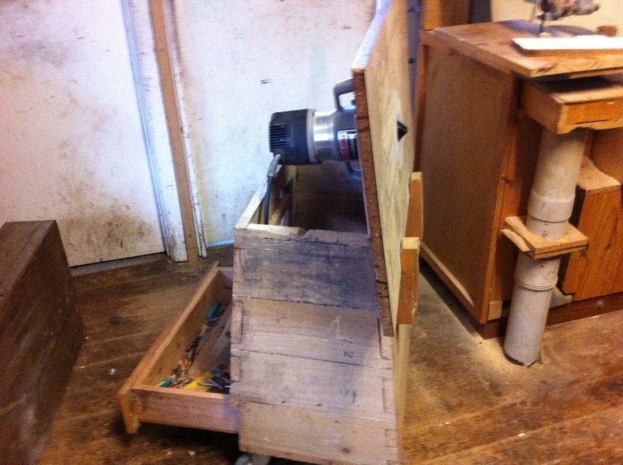

MMMMMMMMMM Now Your Talkin Robauscab wrote:Would you like to see a Dovetailed treated pine ex packing crate version, with cutter drawer locking wheels .Tod Gilding wrote:How About Posting Your Table Build Martin, I'm Thinking about making One Myself and would'nt mind seeing how you go about yours.
- drooling_homer.gif (18.76 KiB) Viewed 20673 times
Re: Adhesive advice
Yes please Rob.

Got it here Rob: http://www.woodworksupplies.com.au/auscab wrote:Shoot!!That's a nice looking bit of equipment Martin. did you order it here or OS?
Not sure if the unilift is still available. I heard a rumour that Woodpecker Australia are calling for expressions of interest for a re-release of the unilift.

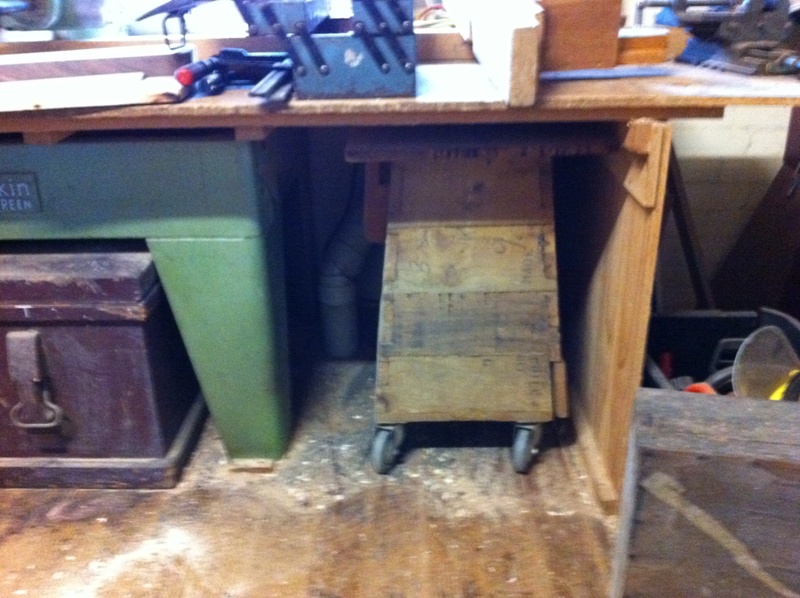

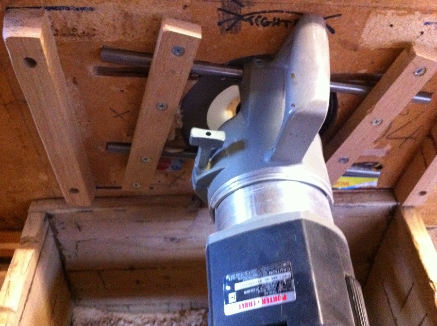

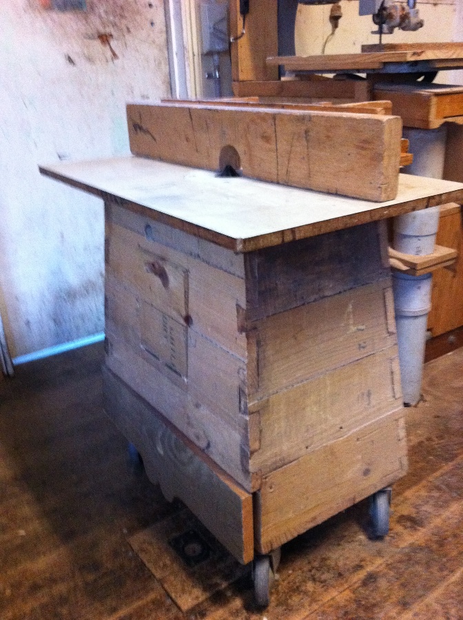

She's on the third router now ,I made it in about 1988. the first two routers were Makita's.
The Porter Cable is good but I learned the hard way to tighten the height adjustment before turning it on.
The start up force of the motor can reverse spin it out of the housing. Gravity helping it along.
It was a trial run and the switch was on and I was turning it on at the wall.
Apart from that it's been good . The top is an old bit of Kitchen bench with laminex. The body dovetailed and held with HHG. The wheels have brakes and it lives under the radial arm saw. A roughy but She's done so much work.

Think I paid around $800 for my Unilift....Kim wrote:
If I recall correctly the expressions of interest by woodworksupplies.com.au were related to a single run by Woodpecker of the now obsolete unilift model which accepts a 'plunge' router...they stopped making these some time back because USA demand is mainly for fixed router units such as those larger beasts in the Porter-cable range. I seem to remember the asking price to get in on the order was hideous...nice unit and all but for that sort of money I reckon I could have a hooker come into the shop whenever I need to raise me bit and still come out on top...![]()

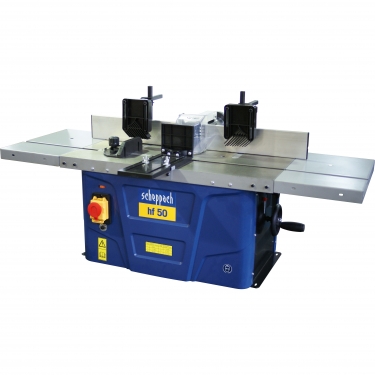

For years mine was the same as the top of Auscab's, just a piece of chipboard with the router screwed to it.
I just clamped it to the tablesaw bed, clamped a fence on and basically just used it to cut truss rod slots.
Now I have one of these
http://www.machineryhouse.com.au/W846
Actually I had the previous model, but the router lift mechanism would not lock firmly in position so the bit wobbled around.
After 12 months I cut a 1/4" slot that ended up 8.5mm wide I got jack of that and called Hare and Forbes who said "we'l send you a replacement, keep the other for spares".
This one works
I still basically just use it to cut truss rod slots. or sometimes with a pattern bit.

"we'l" you can't argue with that for service Jeff. Hats off to Hare and Forbes for understanding the principal and benefits to a business of building a loyal customer base and managing to avoid getting themselves involved in that silly game doing all a disservice of trying to compete for market share via the cheapest possible price point regardless of how close to landfill the products at hand was when it had been ticked off for the production line with not a single thought for after market support.jeffhigh wrote: I got jack of that and called Hare and Forbes who said "we'l send you a replacement, keep the other for spares".
This one works.

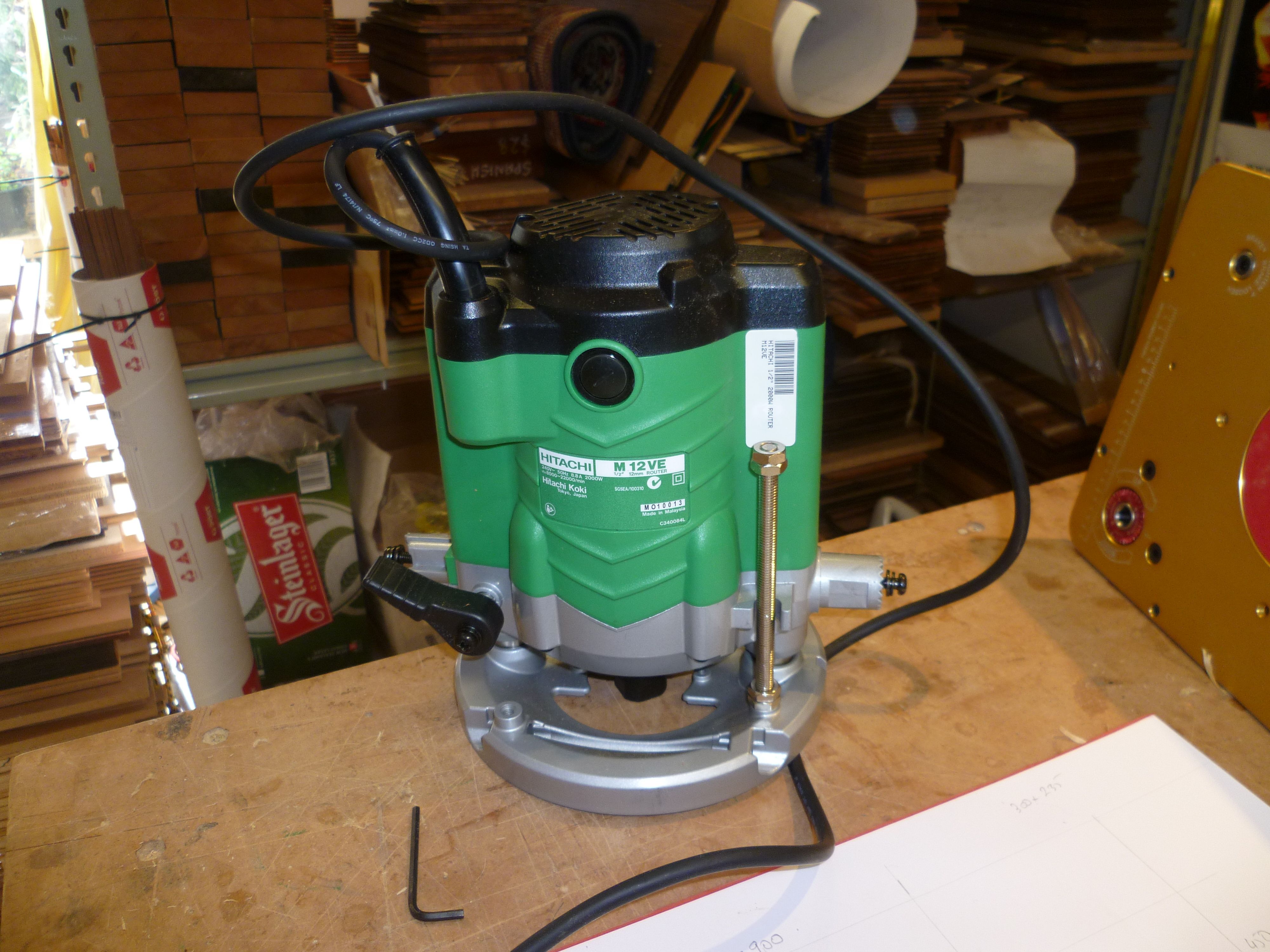

Rough cut the recess for the router lifter and had a look at the glue bond between the two sheets...its all good. Had to look really hard to see the glue joint.
Havent yet decided how overboard Im going to go with the cabinet part of the table. Would be nice to have a bunch of drawers to hold all my routing sh*t and dust extraction is a must. Need to consider the fence as well. Ive got a Rockler ready made fence but it wont allow dust extraction at the bit. Might make up my own fence.
