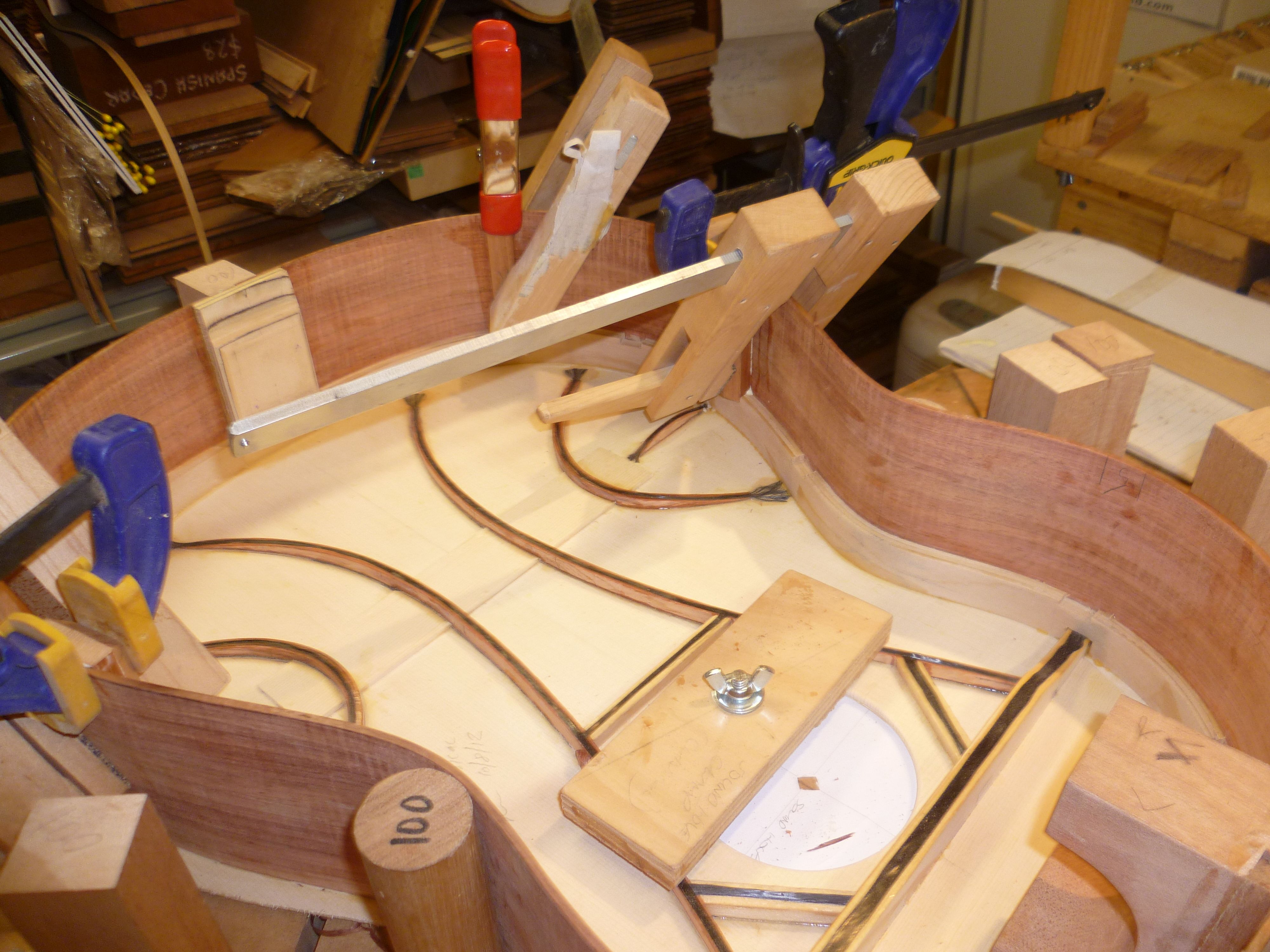

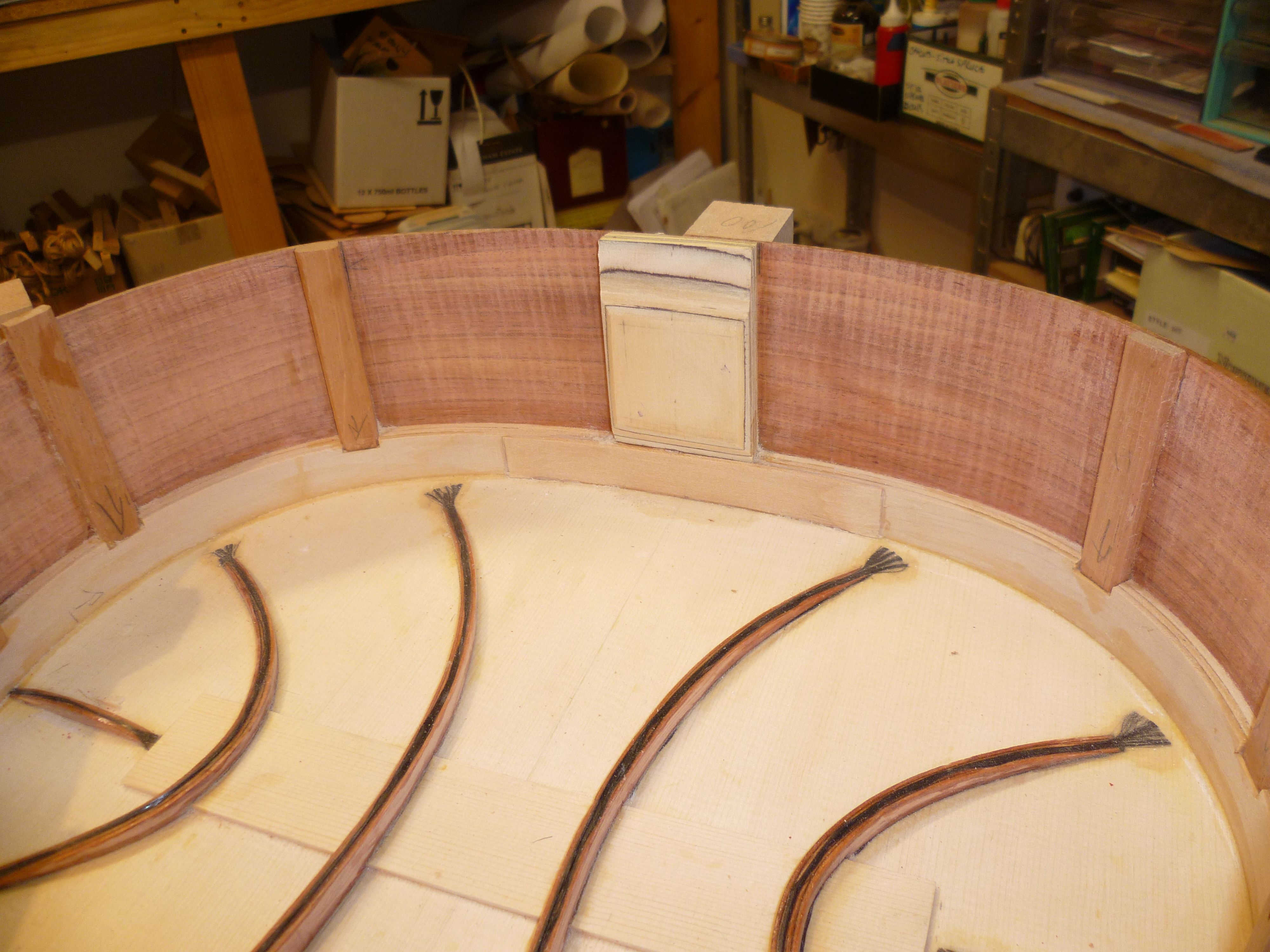

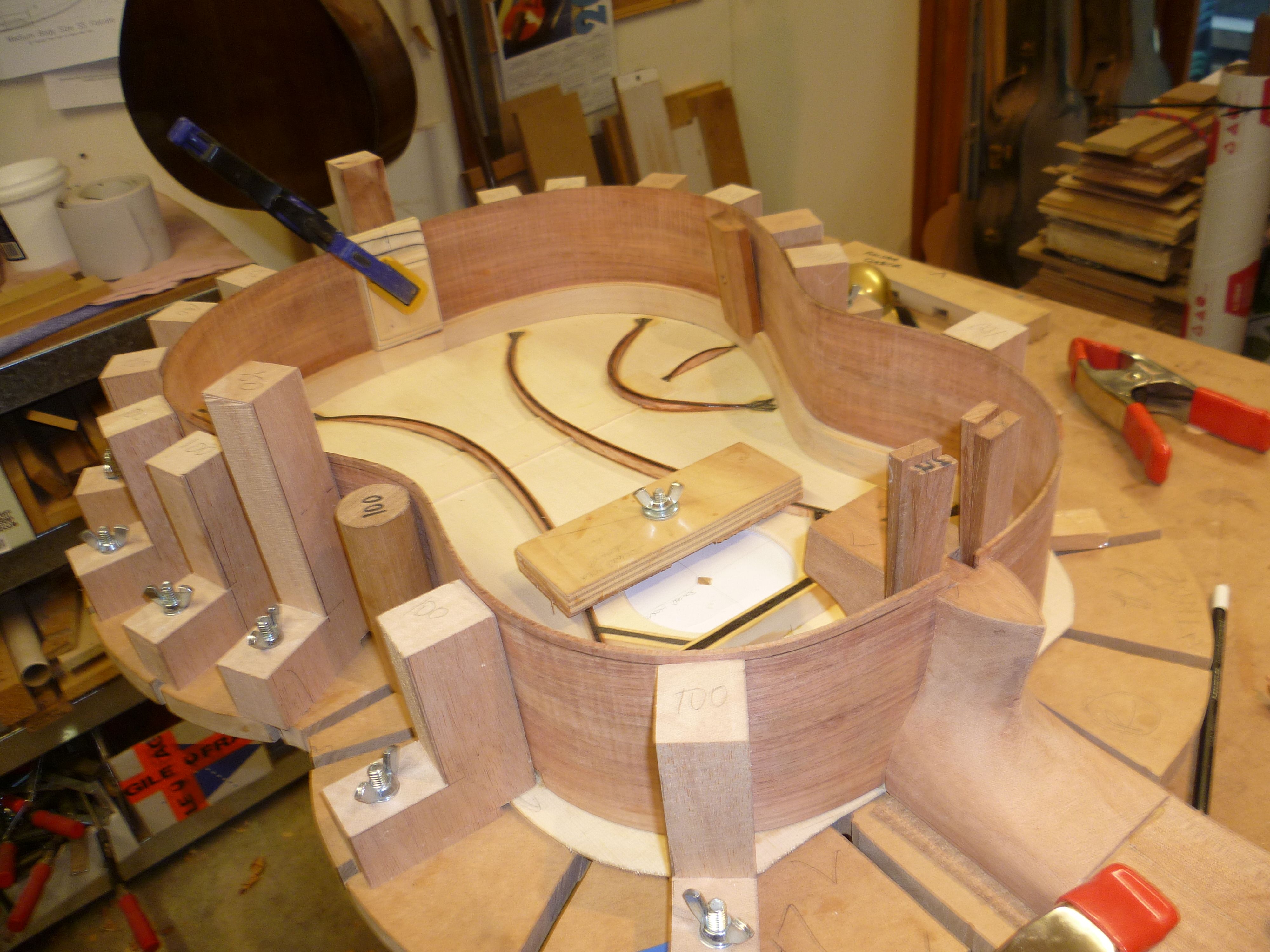

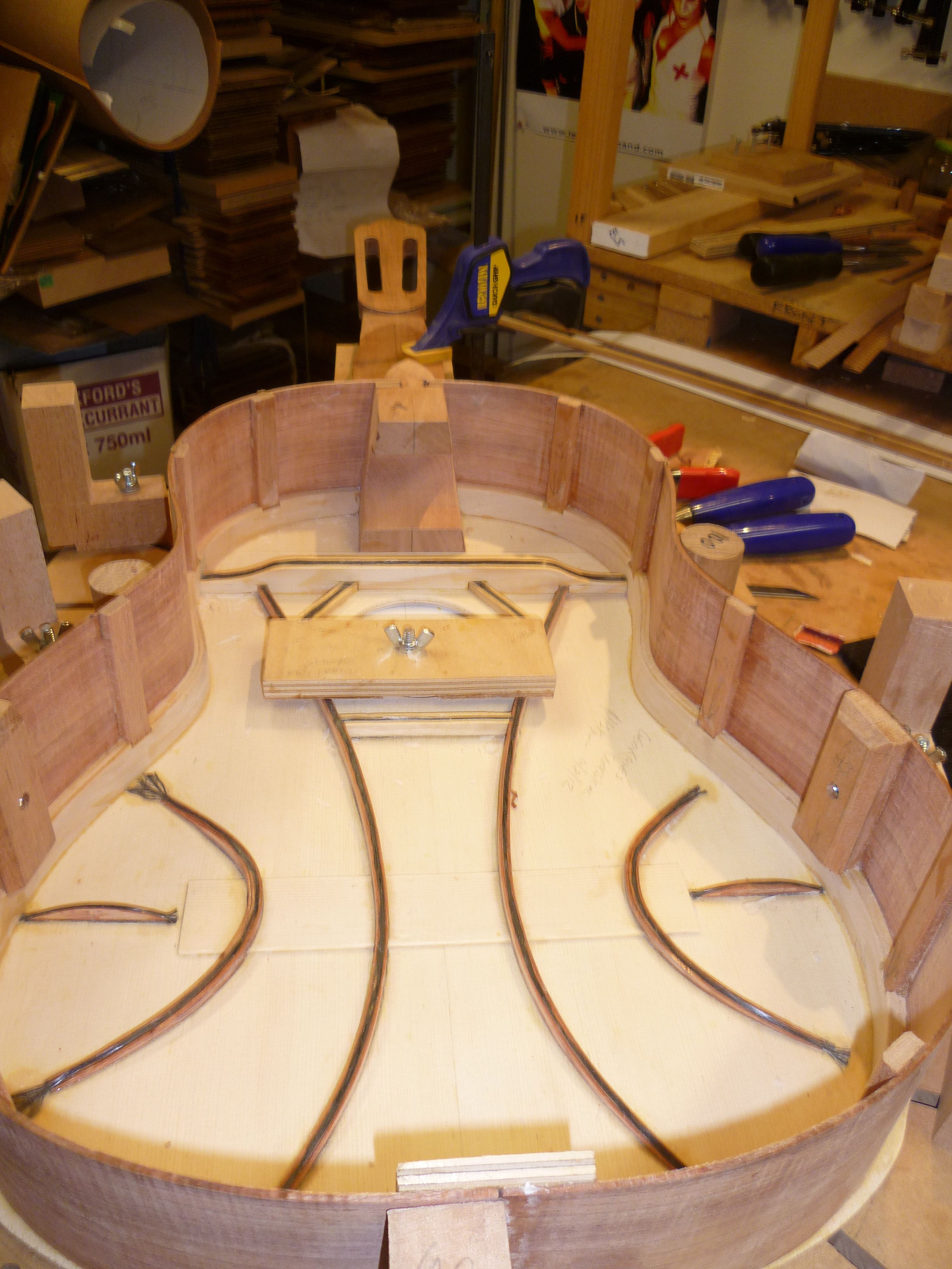

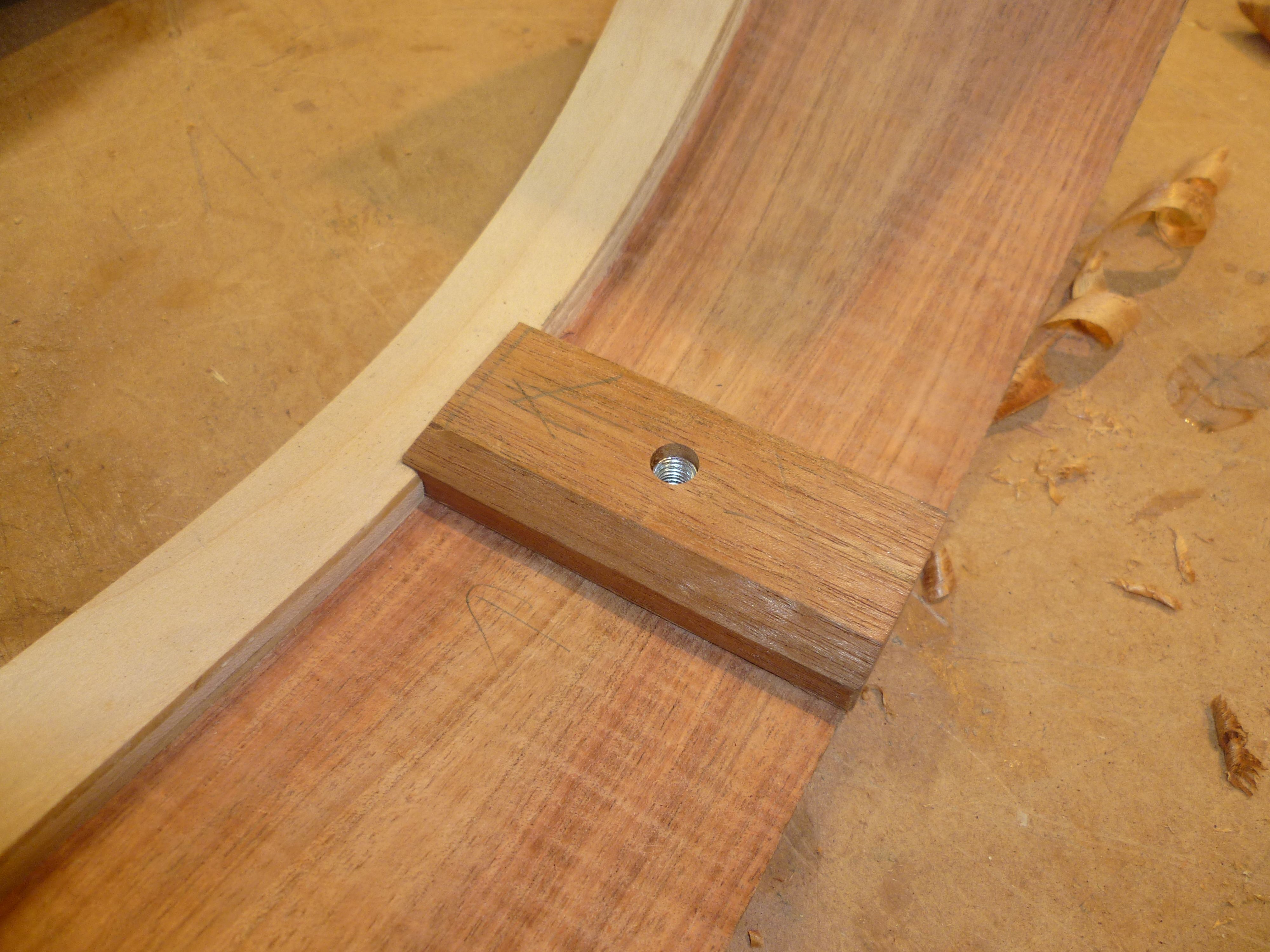

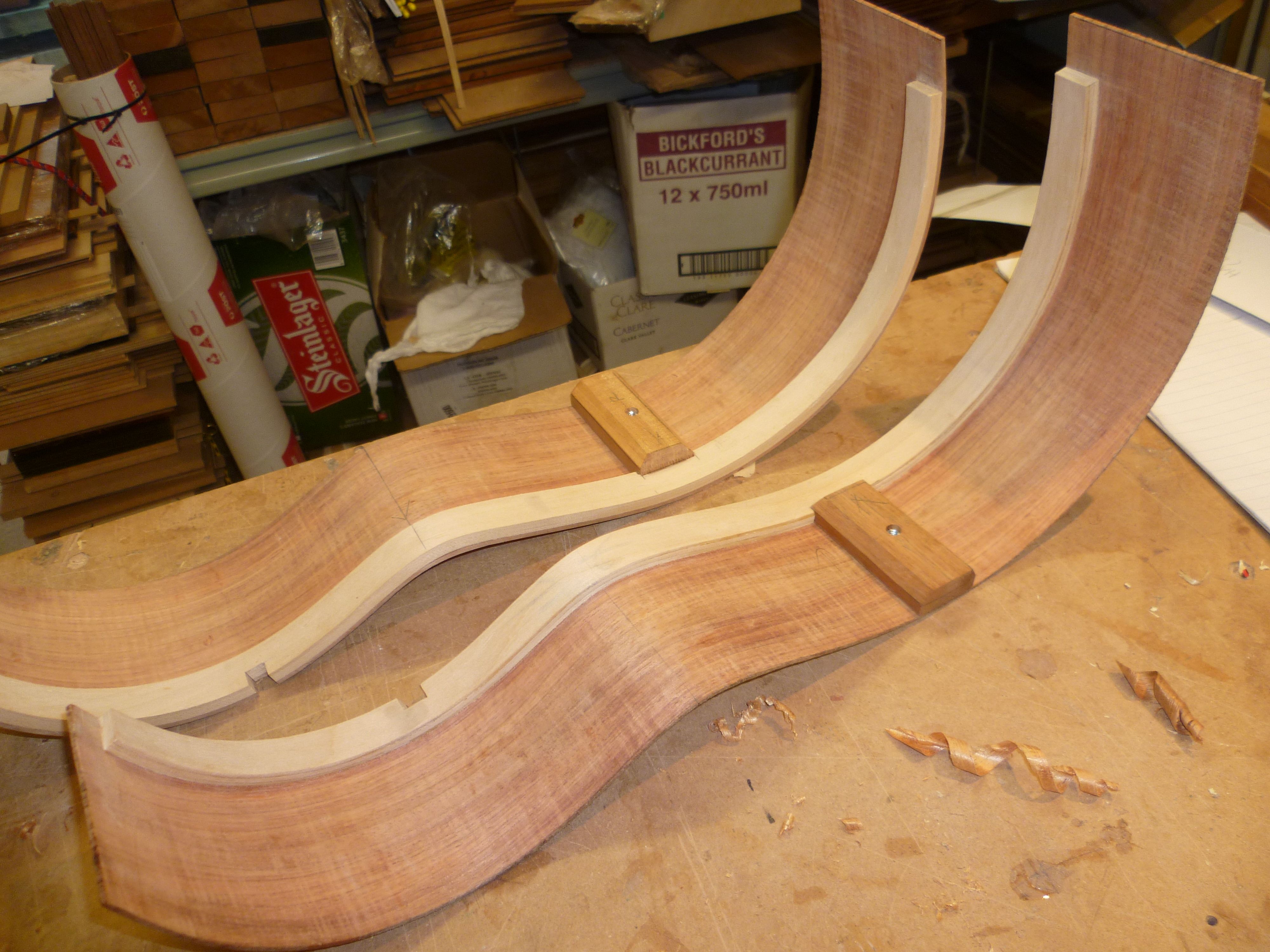

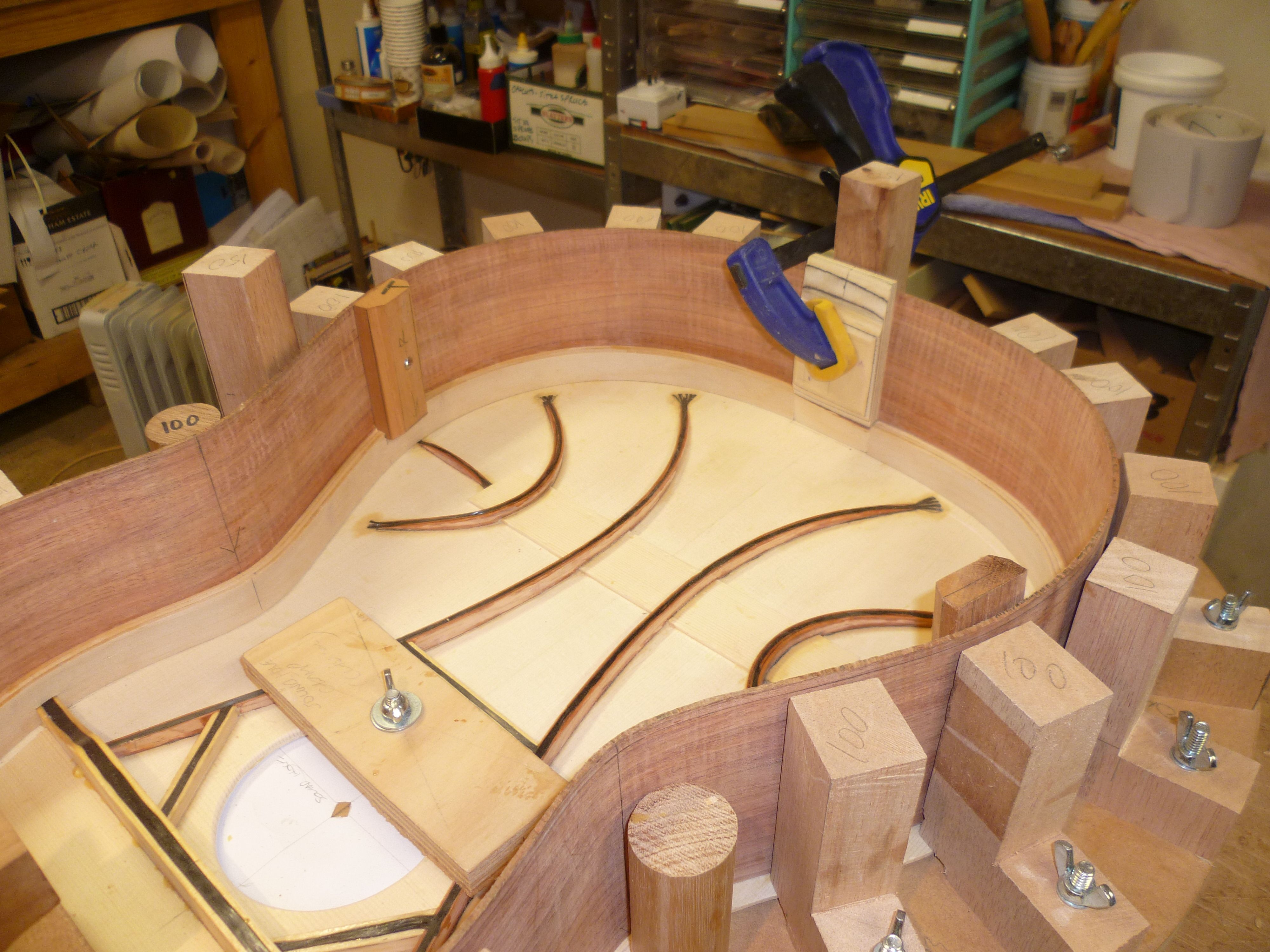

More progress over the last few days. Sides all bent up and laminated solid linings glued in. Threaded splints also made up to take weights if necessary to fine tune mass of the sides. Also added in a patch between UTB and spanish foot.
seeaxe
Posts: 764
Re: Falcate braced classical
Post by seeaxe » Tue Aug 07, 2012 7:55 pm

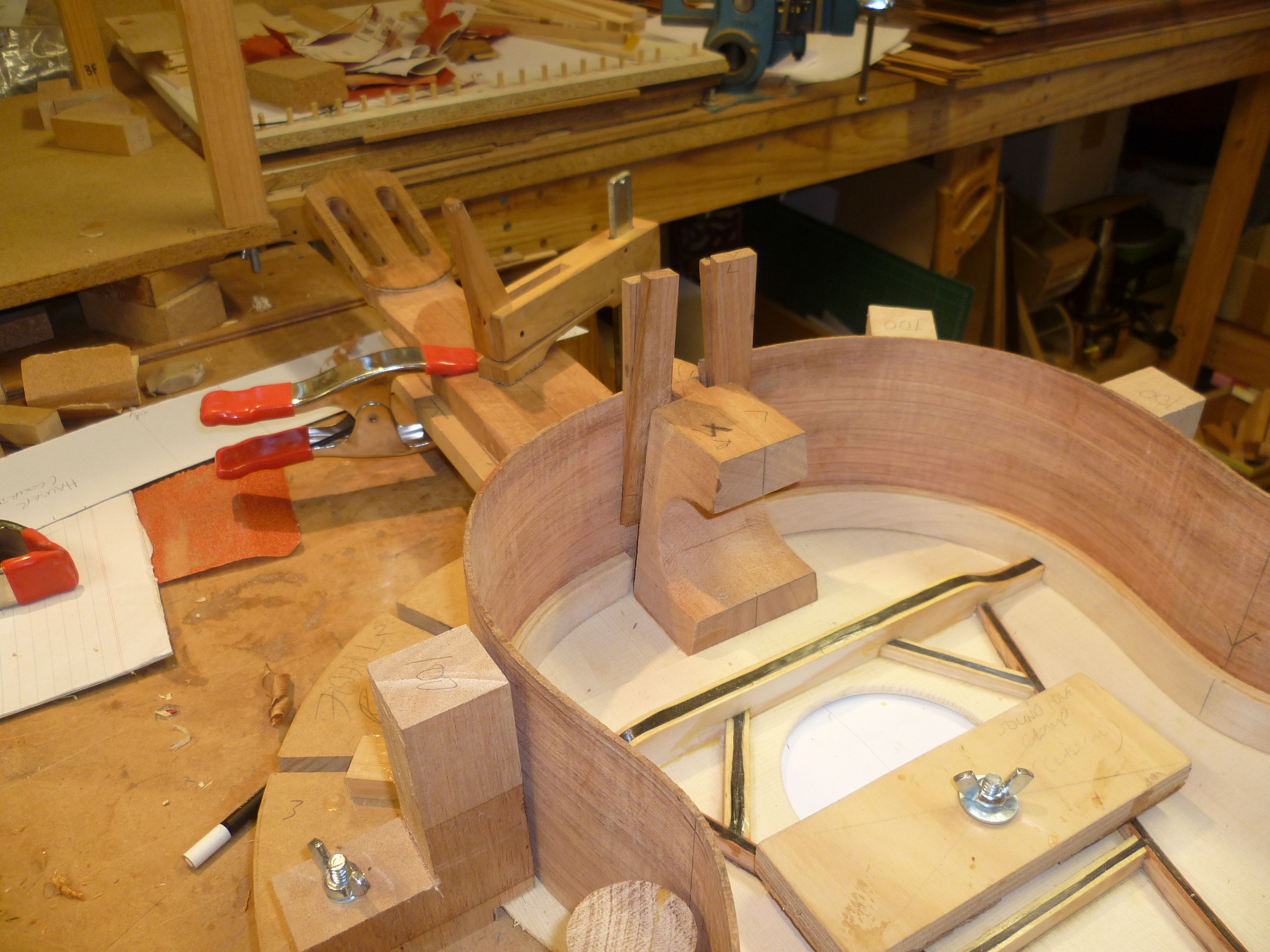

Martin, can I ask about the way the sides are joined to the spanish heel - I havent seen that before. Are you going to put wedges in the final joint or are they temporary?
I like the bindings - they look very neat and tidy - I'm going to try them on my next one.
Posts: 10864
Post by kiwigeo » Tue Aug 07, 2012 8:57 pm

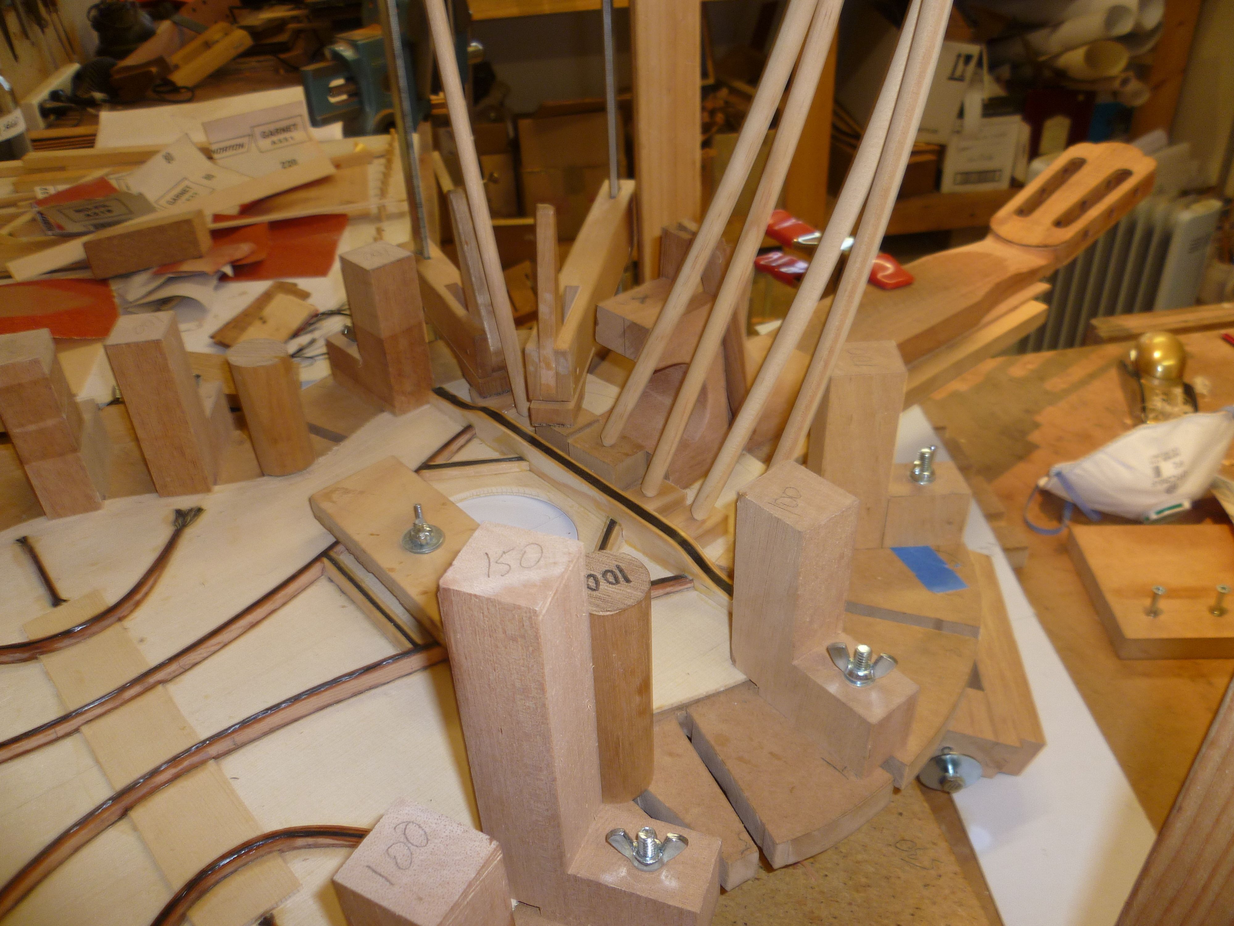

The double wedges will hold the sides into the heel block. I normally use a single wedge but have decided to try the Romanillos double wedge method. The wedges should hold the sides in place without glue but I usually glue the facing sides of the wedges as a bit of extra insurance.
Note in the photos the wedges are both pointing up. In final position the wedges will face in opposite directions and be hammered towards each other until a tight fit.

What are you planning to do with the mass support blocks where they will be glued to the back, tapper them to the same thickness as the Kerfed lining or leave them as they are ?

Tod Gilding wrote:Nice Work Martin,I'm enjoying the build.
You wouldn't believe the trouble I had getting allen bolts for my support blocks around here. ended up finding them eventually and stocked up, but it took some searching, I couldn't believe it.
Haven't given much thought to the mass support blocks where they meet the back lining. What does Trevor do with them?
Did you buy your allen bolts off the net? If I could get your source that'd be much appreciated.

I ended up getting my bolts at an engineering supplies, But should have got them from Ebay seems to be plenty there.
Not sure what Trevor does with the mass blocks, I just had a look at Build vol 9.6 and it doesn't say there,but looking at the photo's in the books it looks as though he leaves them as they are.
Trevor Gore
Posts: 1639
Post by Trevor Gore » Wed Aug 08, 2012 5:46 pm
Tod Gilding wrote:Not sure what Trevor does with the mass blocks...
I bevel them down to the thickness of the back linings. Various pics in Chapter 12.

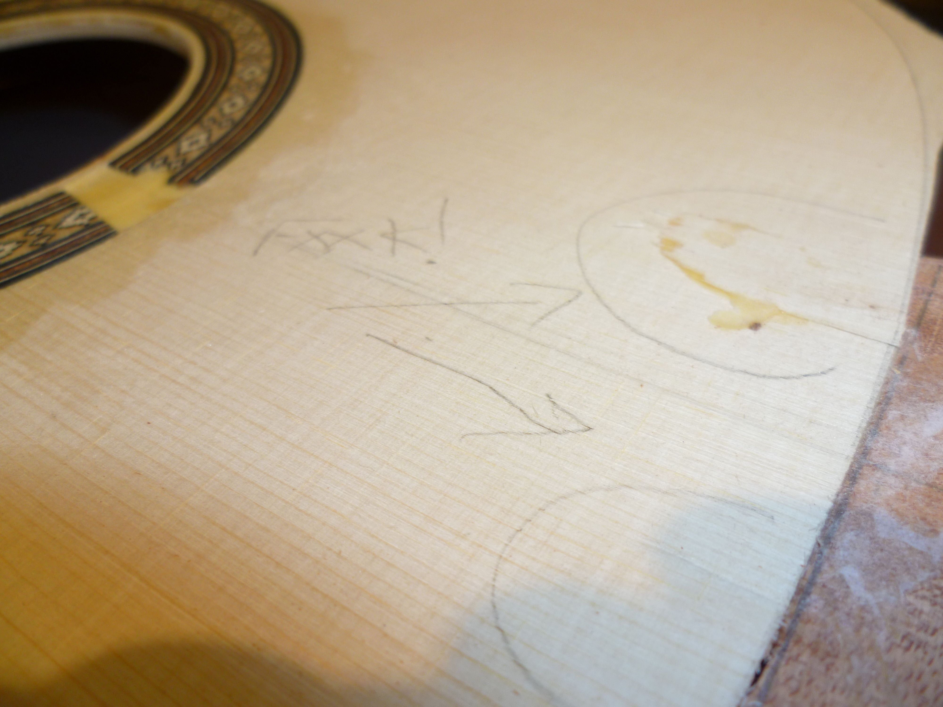

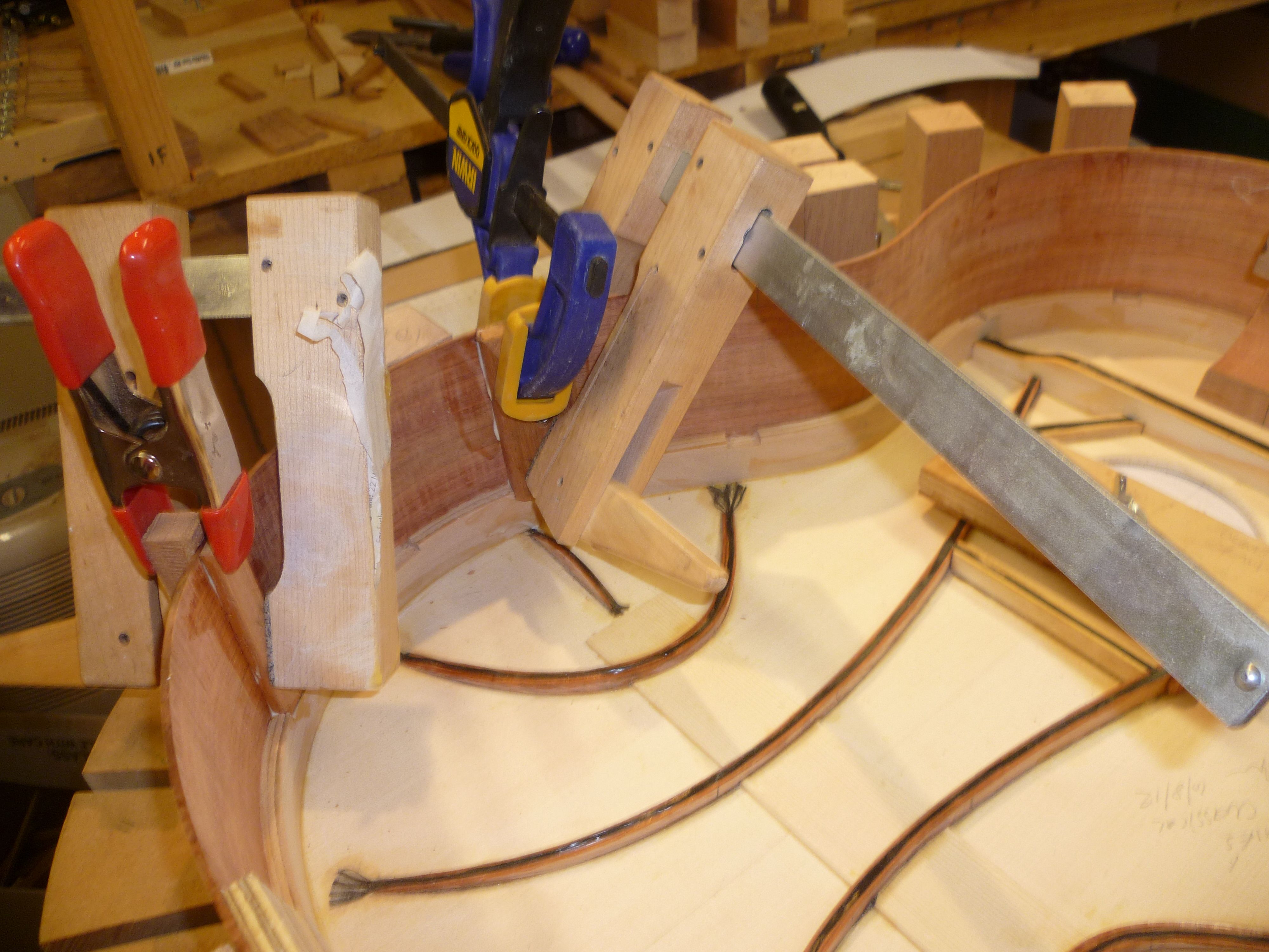

F*****ng nightmare glue up. Stupidly hammered the neck wedges in on one side and of course one went through the top. Took a quick look at the top and its not a complete disaster but a lesson for others using the double wedge method....DONT HAMMER THEM IN!

Sides glued in and starting on gluing in side splints. First pic is the end result of the wedge fiasco....luckily the damage will be hidden by the fretboard.

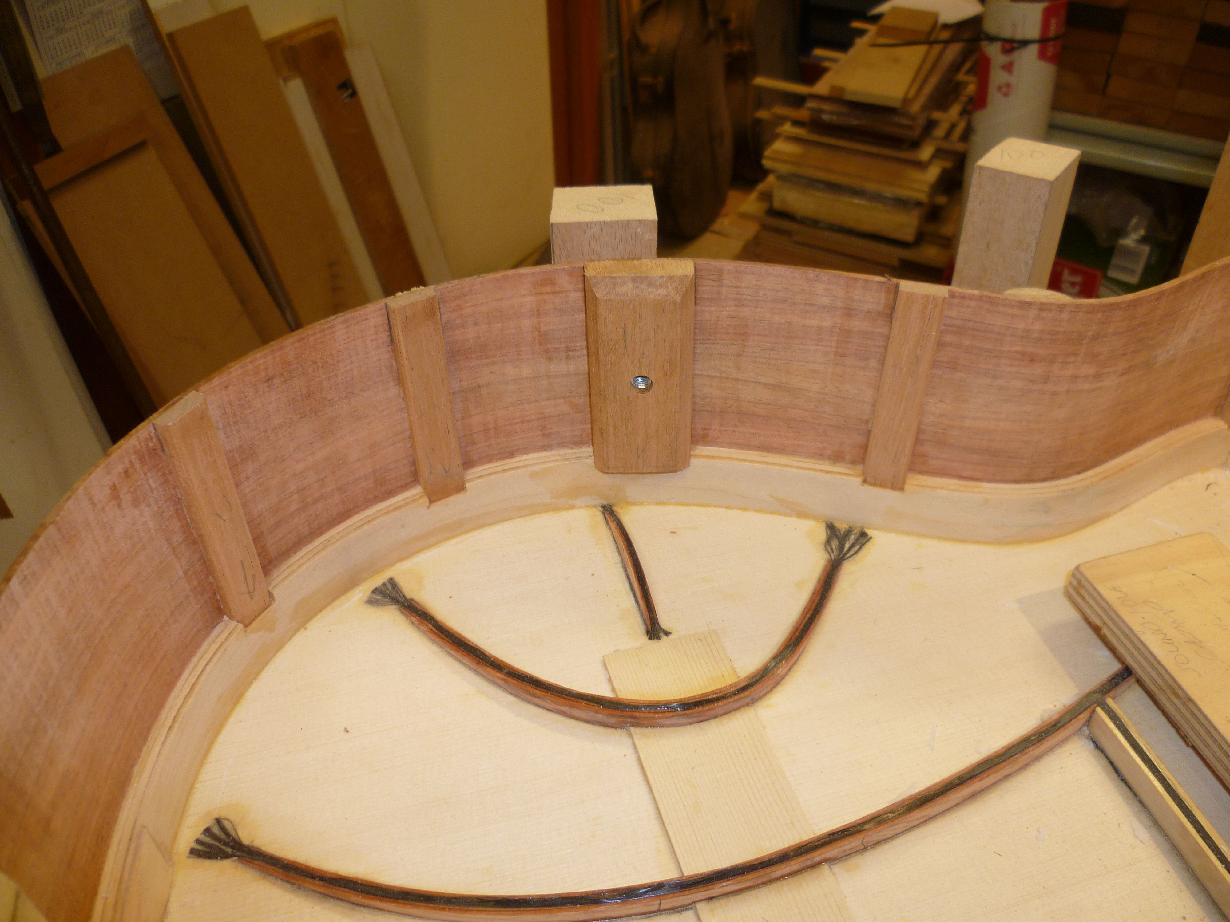

Post by kiwigeo » Sun Aug 12, 2012 9:16 pm

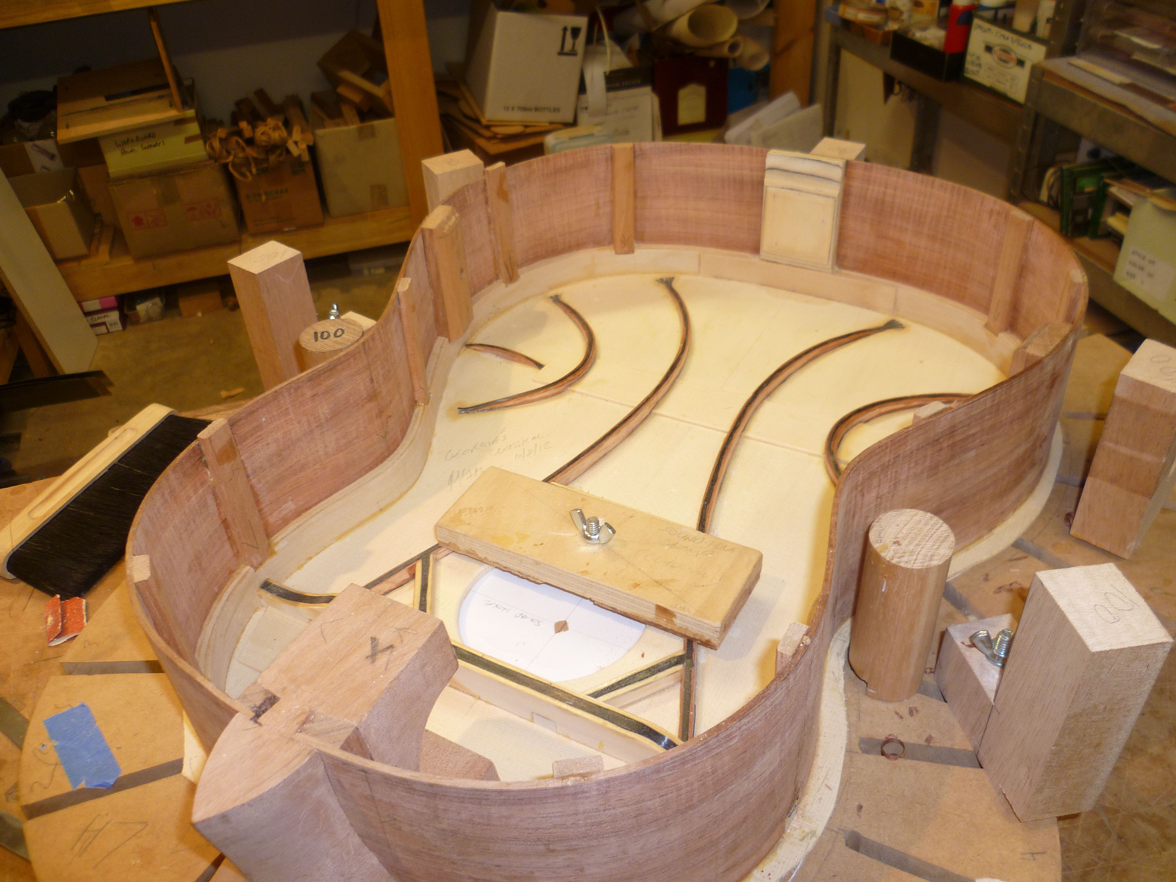

Side splints glued in along with solid lining patch around top of tail block. A bit of cleaning up required and then its onto the live back.
Posts: 10864
Post by kiwigeo » Sun Aug 12, 2012 10:37 pm
The area along the top centre seam between the primary falcate braces has been bugging me for about a week now. On my fan braced classicals theres usually a fan brace sitting over the seam which serves to reinforce same. Think I'll play safe and glue in a few small reinforcement patches along the seam.
Trevor Gore
Posts: 1639
Post by Trevor Gore » Sun Aug 12, 2012 10:56 pm
That's what the small diagonal tertiary brace in the lower bout is for...and is currently missing from your design. A couple of diagonal grained diamond cleats will do the job if you don't fancy a brace there.
