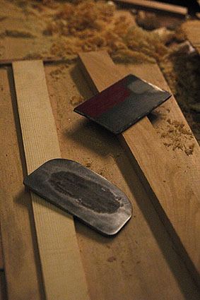

Well, without a brand new Tormek (and not even an old one), manually lapping my new scraper was (as usual when lapping any blade) a major pita, in spite of having previously relieved the centre of the surface with the grinder and having "pre-lapped" the thing on my crappy belt sander (which is the right-hand part of my crappy grinder). But well, here we are (this time after more than 20 minutes):
To finish my scraper story: when trying the new scraper on cherry scraps everything seemed to work fine. The same when scraping spruce - but wait! there seem to be some chatter marks! I had not felt any chattering, but without any doubt, there were the marks:
Chatter marks?
These were medullary rays!
The dwindling daylight had fooled me (photos taken later, at "bulb light").

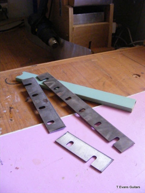

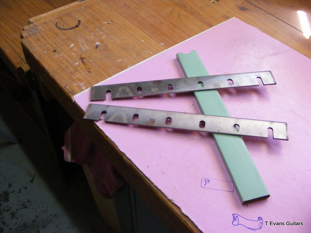

Hi All, I too was inspired by this thread to get one of these scrapers but during a recent workshop tidy up I came across these 12" planer blades which I had replaced earlier this year. And then . I had, for some time, wanted to buy a smaller grinder for the building workshop and thought that if I made my own scrapers the money saved would easily pay for the grinder. So the rather large industrial grinder I had put up with for years was relegated to the bike workshop/shed and a small grinder purchased from a local hardware store.
The process was:
1- cut a length off of one of the long blades
2- grind off the beveled cutting edge
3- flatten the faces of the smaller blade [now referred to as "scraper"
4- true up the edge to be used [hollow ground]
5- set up the new grinder and grind the 'hollow grind' into this edge

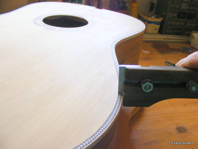

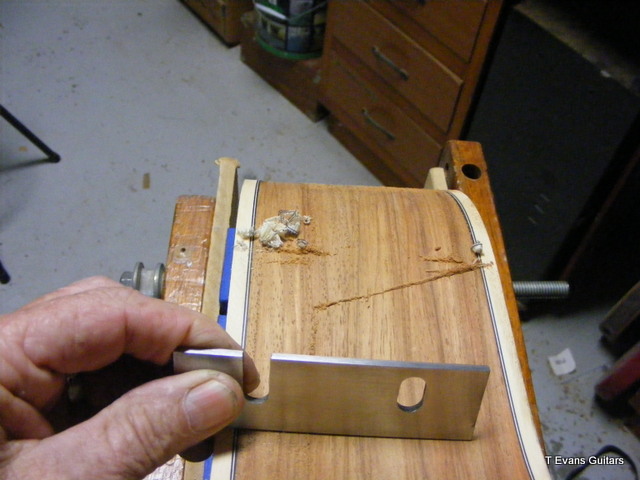

The tests on slab timber worked great. The photos were taken when I was actually taking down the binding flush to the sides.

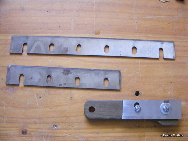

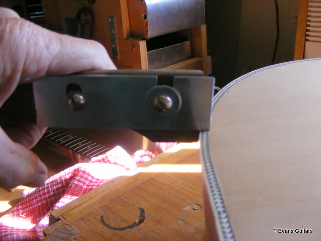

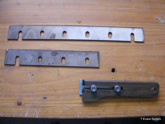

To make this scraper a little more adaptable [and as a value added future] I made a handle with guide fence to assist with the scraping of front and back purfing and bindings.
This scraper will possible stay in this handle as I have started to make more scrapers out of the remaining stock, both straight edged and contoured.
Thanks for looking

Nice idea, and I especially like the way you fashioned the handle to make a purfling/binding scraper. Is there enough "wiggle" room in the slots and holes of the blade to permit some in and out adjustment for wider or narrower bindings?
Patrick
Patrick
- Taffy Evans
- Posts: 1000
Re: Scraper
There is a slot in the handle for this adjustment, as seen in one of the photo's.
