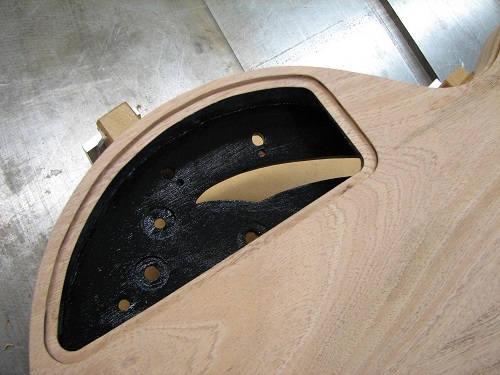

Oh, I am sure you feel much better now!Nick wrote: Once this was done everything that was going to be on the inside received a coat of sheilding paint to stop any excess hum/interference, so all that "nasty water staining" has disappeared on the inside at least Marcus!.
But hey, this top looks now like a sieve, Swiss cheese is solid rock compared to this! A few more holes and the "water stains" will be gone also on the outside!
Very nice work Nick

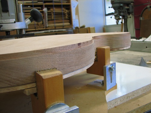

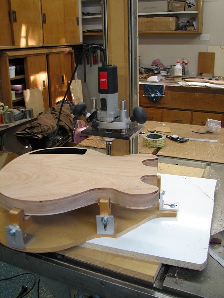

Next trick was to rout the binding channels. I'd done a Telecaster some years back with a similar tobbacco burst that I want to do this build and I'd just used a single Ivoroid binding on that, no purflings or anything so the channel was an nice simple thing to cut.
I 'adapted' a cradle I originally used for Archtops when routing the channel in my jig. Fortunately I'd built in a fair bit of adjustment when I first made it so this is the third size of guitar that I've been able to fit into this cradle
It just needed a little packing under the feet as obviously the body was nowhere near the depth of an acoustic.
Yeah I know, that is a cheap arse Ozito brand router you can see on my routing jig
but they're as cheap as chips, variable speed and seem to be fairly good in the bearings so I don't get any chatter in my cuts and if it burns out, I will just go and get another without crying because I haven't just burnt out my good router.
Channels cut and......

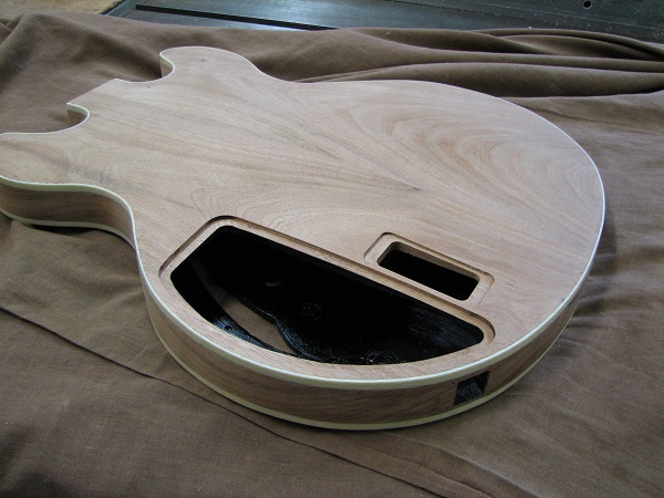

the right size

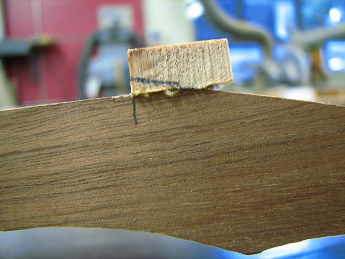

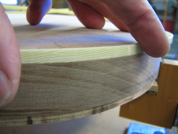

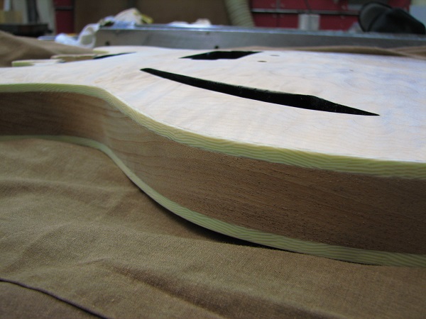

I like to go slightly deeper to allow for any glue thickness and also because it's only a single line binding, I like to scrape the side down to the binding rather than the other way round because then you end up with a 0.040" & under binding rather than the 0.060" it started out as.
While it was still in the cradle I went to the smallest bearing size in my binding cutting set and machined a ledge for the cavity coverplate to sit in. Bindings glued in and a hole machined for the battery box for the various 'active' components (the Control X unit for the T Bridge & magnetic pickups ((which allows you to either blend the two signals, run magnetics only or the undersaddle transducers only or run the two signals seperately into in stereo channels)) & also an N-Tune) Hopefully the battery drain will be moderate or I'll have to run two batteries
and a closeup after the sides have been scraped down to the binding.
I finished off the body by drilling all the little screw holes, mounting holes e.tc so the body was essentially in a finished state & I've put that to one side until the neck's ready for fitting & gluing. So it was onto the neck, I've done my usual and laminated two pieces of Sapele, I find this method easier than making a one piece for some reason, maybe because I can bandsaw the shape complete with headstock angle and I don't need to add 'wings' for the headstock ears as it's usually plenty wide enough. It may or may not be technically stronger and I'm not advocating this to be the better method than a one piece, it's just something I've always done.

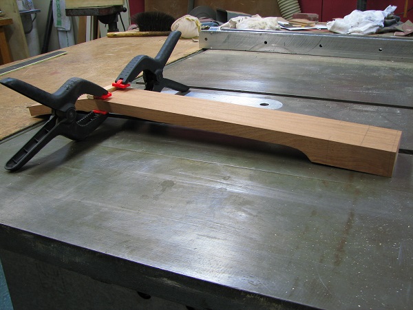

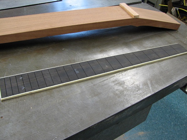

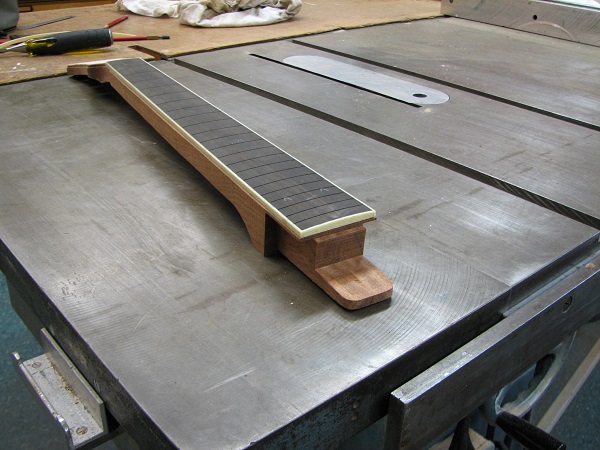

Here I've joined the two 50mm wide 'halves' & planed my two reference faces (the face where the fingerboard glues on and the headstock face) parallel to each other & I'm gluing on a fingerboard stop. Any body familiar with Benedetto or read his "How to make an archtop" book will know what I'm talking about. It's just a little scrap piece of spruce 10mm (3/8") wide that glues on at the nut position, this means that you have approximately 10mm of 'flat' area between the end of the fingerboard and where the headstock angle meets. Once the glue's dried you chisel off the excess then clean it up at the same angle as the headstock so that the headstock veneer will eventually continue right up to the fingerboard (only to be chiselled out later for the nut!). The idea is that the headstock binding will come up and meet the fingerboard binding at exactly the end of the fingerboard/nut point so that it looks like a continuation of the fingerboard onto the headstock, it's really good if you have purf lines as these look like they run continuously from the fingerboard, under the nut then onto the headstock. (sounds more confusing than it really is but if you're having trouble visualising what I mean, pictures to follow at a later date
Fingerboard is cut and slotted for the Gibson 24.75" scale & bound with the Ivoroid, just waiting for the Gold EVO fret wire (I fret off the neck). Because the L R Baggs T Bridge has a set radius I had to radius the board to a 14" instead of my usual 12

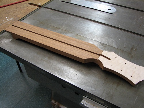

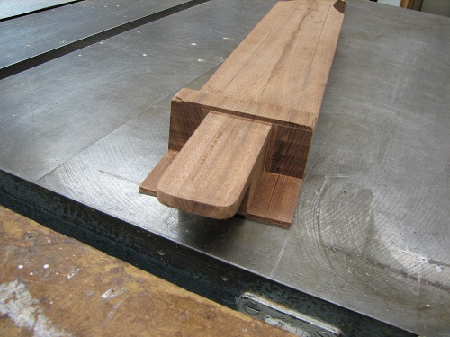

Neck slot has been cut and headstock shape cut in with the router. Tongue has been cut and I'll fine fit to eliminate any gaps e.t.c around the body joint once the neck has been trimmed and shaped but it does still fit reasonably well at this stage just for a 'rough' fit. Now to explain a bit easier, with pictures, the reason for the fretboard stop I tried to explain earlier

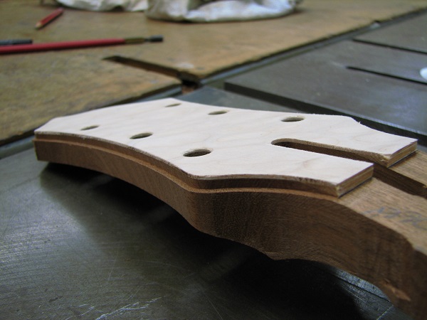

With the bound fretboard sitting against the stop, it gives you a bit of material to make a decent binding channel on the headstock face, the bottom edges of the binding matches up. (Doesn't matter too much in this case but if I was to run purflings along under the binding, this gives the look of a continuous run of purfling between the two different planes). Binding ledge cut And sitting the headstock binding in it's ledge, not fitting perfectly yet but you get the idea and neck taper roughly bandsawn I've got further than this (fingerboard has now been fretted and glued to the neck stock, truss rod cover hads been added & headstock bound) but haven't taken any photos yet, I'll add these in the next couple of days. Next job will be to cut the nut slot and shape the neck

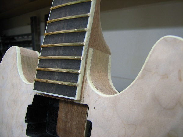

I really like that treatment at the nut transition. Very elegant.
And, I'm engrossed in the build as well. As I'm going to use plastic bindings on one in progress, can you, when you get there, detail the finishing process, please? If I recall, you said it would be dark on the back and sides?
Re: Gibson CS356 build

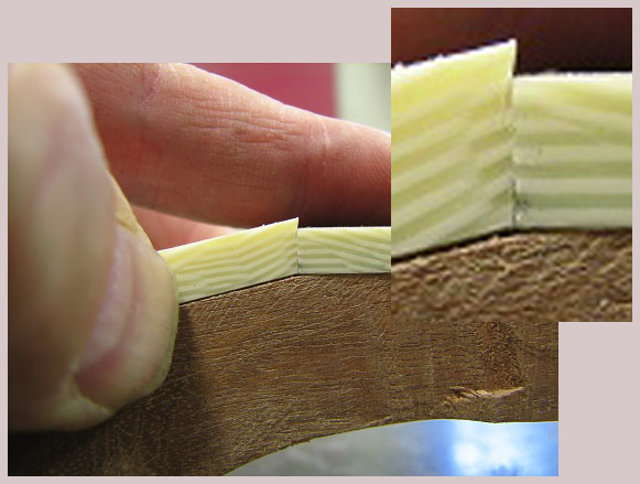

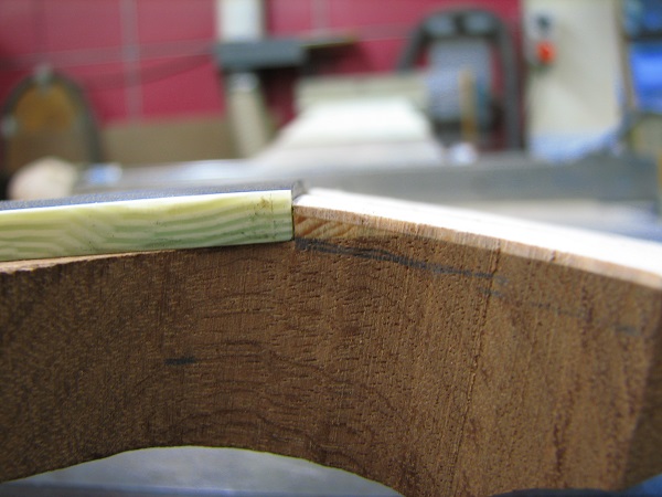

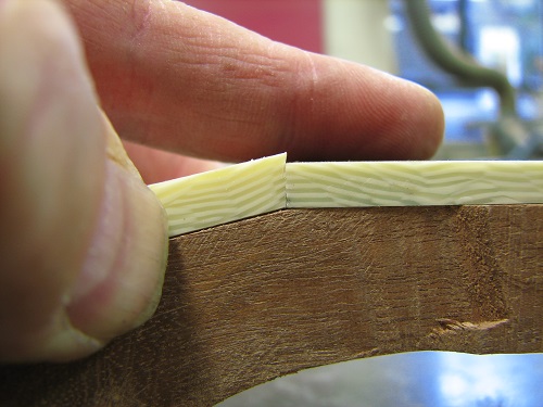

Just make sure to line up properly that ivoroid figure.Nick wrote:[...] not fitting perfectly yet but you get the idea
The possibility to use the design-simplifying little wedge is a very good technical reason for a bound headstock.

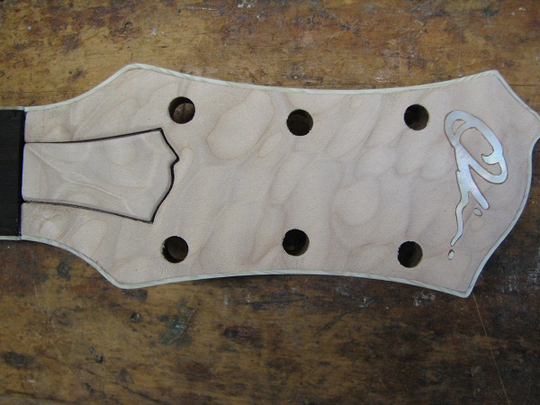

It was pretty close Marcus when I did it but after all that, without the contrast of a purf line under the nut it just didn't look right with the bone nut sitting on top of a thin line of Ivoroid (bit like a patchwork quilt!) so I ended up taking the cut right down to the bottom edge of the binding so the bottom of the nut is flush with the bottom of the bindingcharangohabsburg wrote:Just make sure to line up properly that ivoroid figure.![]()
So I bound the headstock with the Ivoroid binding, cut my pearl Sig and inlaid it (gold MOP which doesn't look much at the moment against the white maple face but the headstock will have a small burst which is when the MOP should stand out). Also made a truss rod cover that sits flush with the headstock face and is located with a small wood key (block) thats the same width as the truss rod slot, the cover is then held down with a small rare earth magnet. It looks like a large gap around the cover but I glued a 2mm thick piece of BRW on the back of the 1mm thick Maple & then chamfered the edges so with a bit of finish on it should show up as a nice dark brown border.

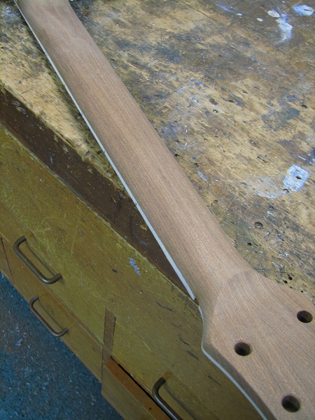

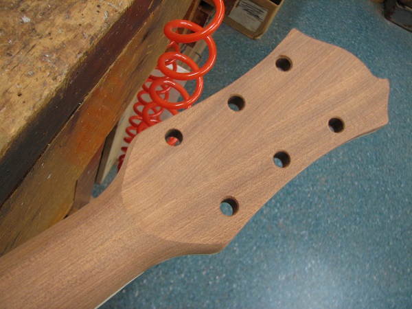

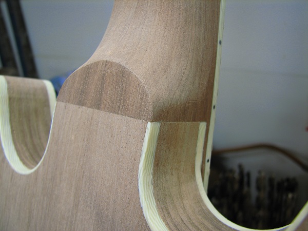

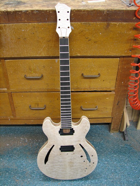

Next step was to shape the back of my neck, I left it a smidge oversize at the heel so that once it was glued in I could scrape & sand it flush with the body. I left just enough clearance between the neck tenon & body mortice to allow the glue to get in there without it all being squeezed out but still allow the neck to locate without slop. Then the moment of no return! slapped some Titebond on the Tenon and went for it. After the glue had dried & clamp removed I flushed up the sides of the heel with the body. And it was altogether
Anyway the next step is staining the body (Tobacco burst the top & a dark tobacco back & sides) so I'll stop the build post for now & continue the next step in the tutorial section so if you are interested, keep an eye out for it, I should have something up there within the next couple of weeks.

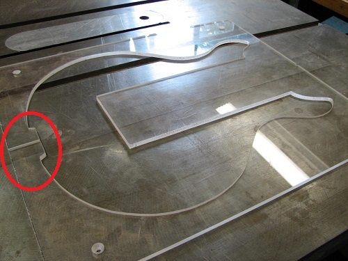

I just marked out where I wanted my 'hole' on an acrylic blank (I used the commercial plan and just laid the acrylic over the top and basically traced it out with a permanent marker) and cut into the shape with the bandsaw (red circle) from the butt/tail end of the shape, somewhere where it wouldn't matter if there was 'slight-if-any' glitch in the internal wall then cleaned the cut up with a file. The pattern was screwed to the wood (outside the profile of courserocket wrote: i love the cutaway and the shape of the horns. What process did you employ when making your poly carb routing templates?
