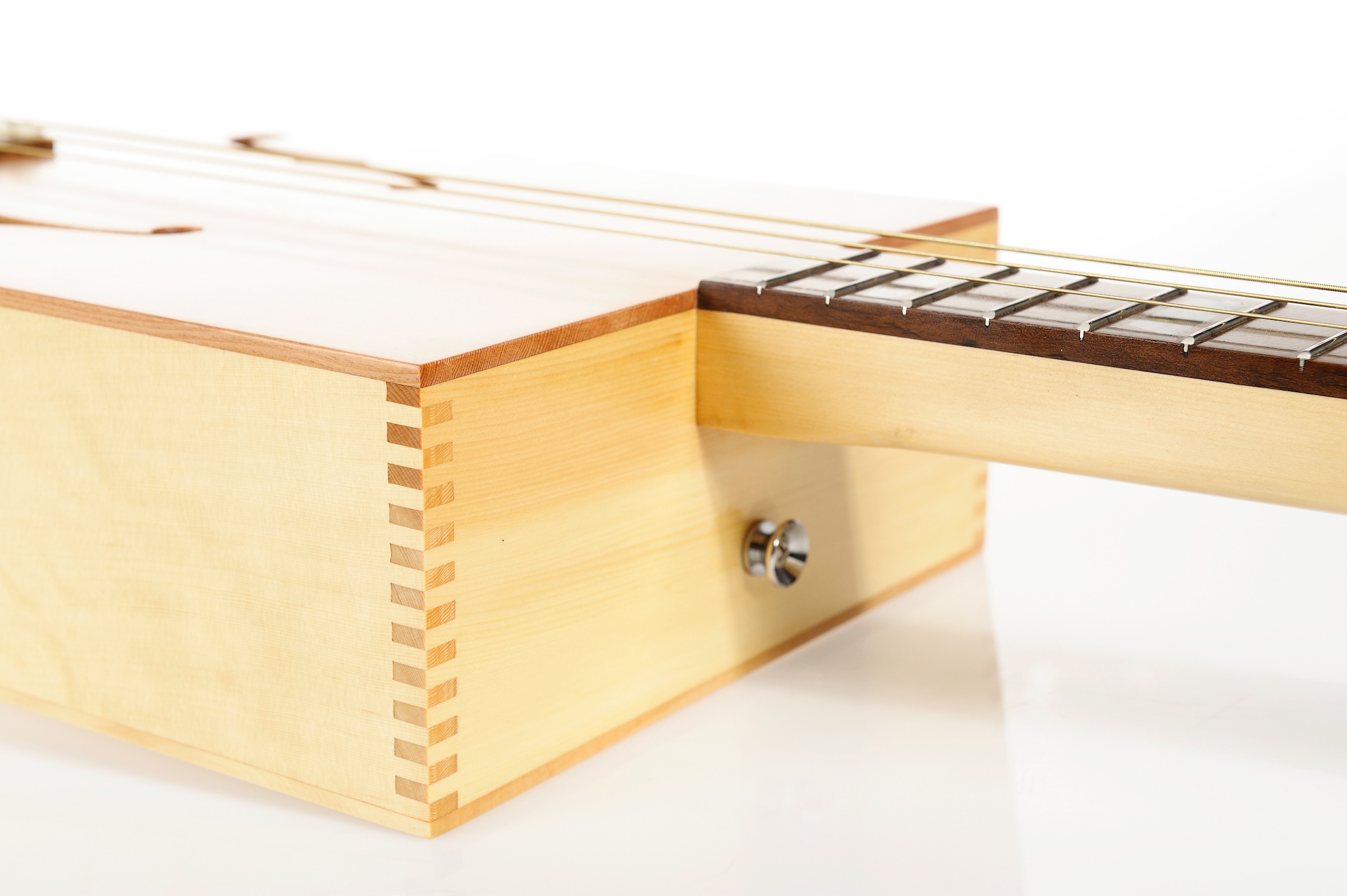

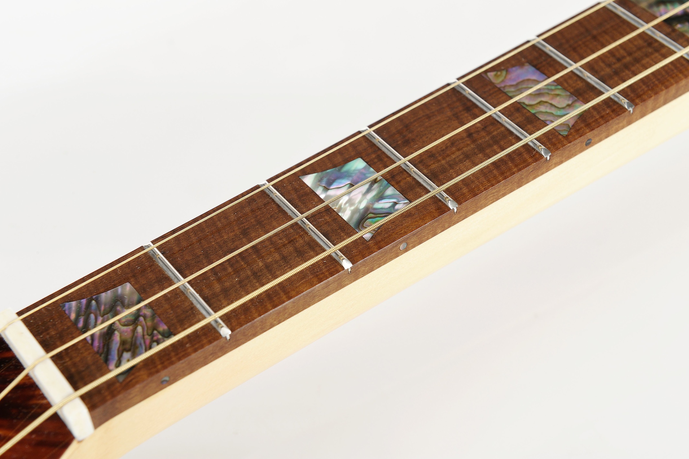

I would like to see some pictures Jim. This one is for a friend and is not a true Stella with the ladder bracing. This young fella is a working muso so we decided to go with an x brace design. He hits pretty hard too so I have built it to take a pounding.
By the way I didn't have enough ebony off cuts for the chess board but Tim in WA sent me some Pacific Blackwood and that will look fantastic with the maple and the Queensland Maple table. Thank you Tim!

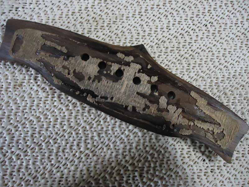

A repair job. I have seen this many times but this time decided to post. Other than this it seems like a nice guitar made by Tanglewood, nice wood and Maple bindings. The glue felt like CA but not sure and there was at least 4mm of finish right around the edge that was not scraped away.

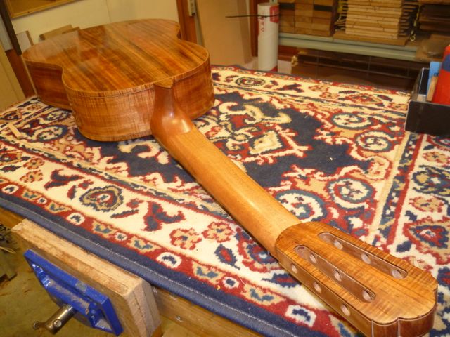

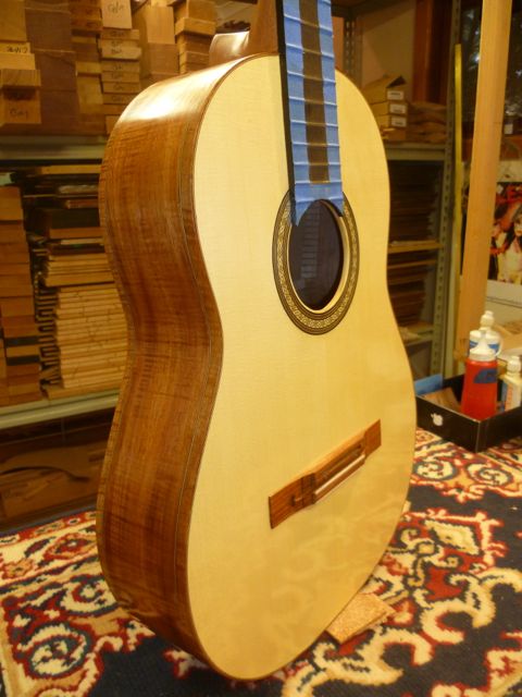

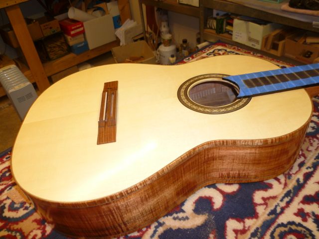

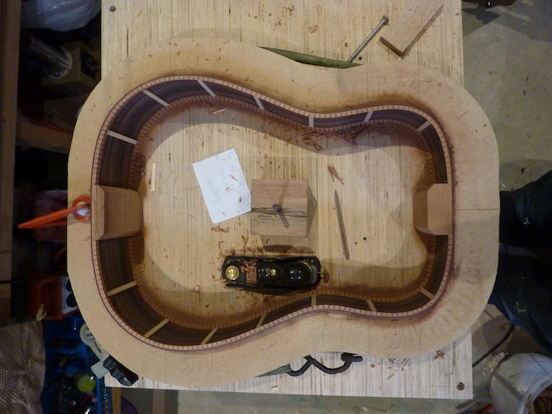

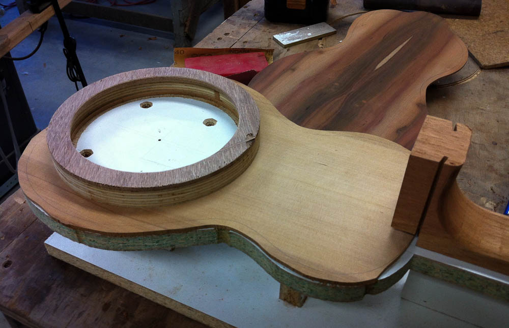

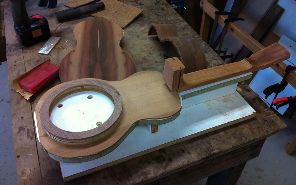

Not a huge amount going on in my workshop of late due to a heavy work schedule. Nearing completion is a falcate braced Blackwood/Engleman classical...built using Spanish method. Latest addition to the workshop is a chisel mortiser....still in the process of being commissioned.

There's an all Tassie Blackwood with rope bindings one as well as this Milo reso. I got this very nice milo from Brett at curlykoatonewoods.com. Apparently it's a bit rare in its Hawaiian homeland. So rare that there wasn't enough to do the top of the reso as well so I whipped out a nice bit western red cedar for the top

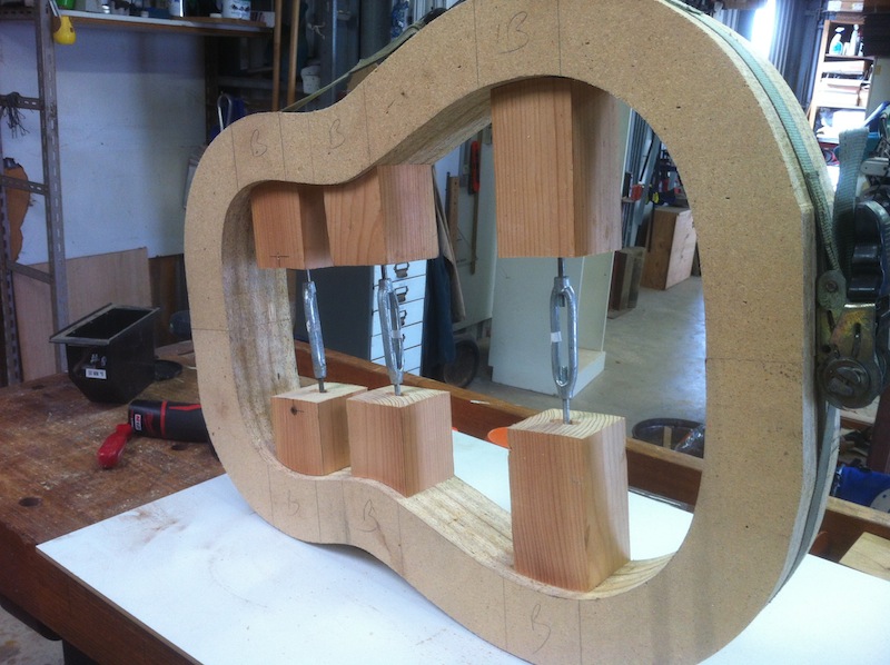

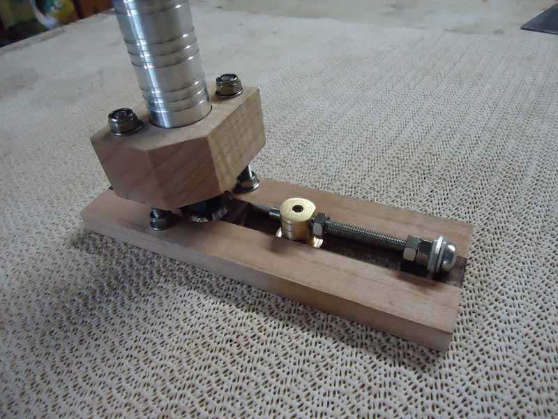

My newest tool, just finished. I goes from 55mm to 155mm diametre and the adjuster has a 1mm pitch thread so one full turn equals 1mm of adjustment. To take out any backlash i used nylon washers and also filled the thread in the brass bit with epoxy so all up there is bugga all discernible backlash.

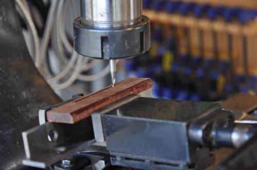

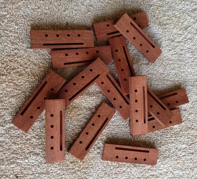

Well, here is a picture of milling the saddle slot in some Snakewood. 9 degree tilt back and cut in one pass full depth.
Then I had to do a batch of bridges for the upcoming uke class, so had a play with learning the line hole function on the DRO. Made a tedious job quite enjoyable. And those string holes are within 0.005mm.

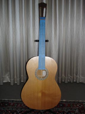

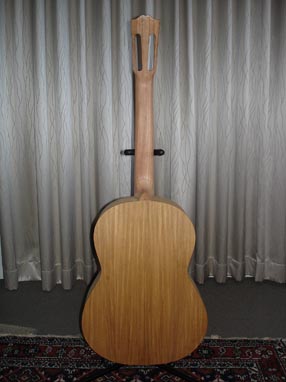

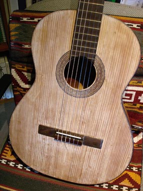

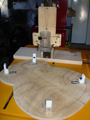

Its getting too cold in Canberra at the moment to spend much time in my shed (tin garage).
I have just finished making a binding router jig, using a heavy duty runner off a TV swivel stand
for the sliding mechanism. Will try the jig out on my current build, a classical guitar with red cedar top
(ex Tim Spittle) and New Guinea rosewood back / sides (ex Woodrat). I am also playing around
with a $30 cheapy that I picked up in an op shop in Brisbane. Have stripped back the finish and
will now thin out the top around the edges to see what affect that has. Then if I am not happy
with the outcome I will replace the top.

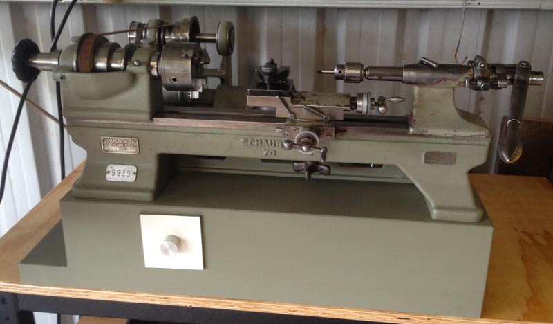

I had a bit of a score yesterday by acquiring a Swiss made Schaublin 70 toolroom lathe. These lathes have been built since the 1920's and are coveted by watch and instrument makers for their deadly accuracy and fine build. And still being made today. Says something about the design. But if you have to ask how much for a new one, you most likely can't afford it.
It's a small lathe ideally suited to the space and tasks I have in mind for it. Came with a huge selection of extras including 2 tail stocks, lever actuated double cutoff cross slide, collets from 12mm down to something that looks like it could hold a hair.
I knocked up a sturdy stand on good locking casters yesterday and placed the lathe in place next to the milling machine.

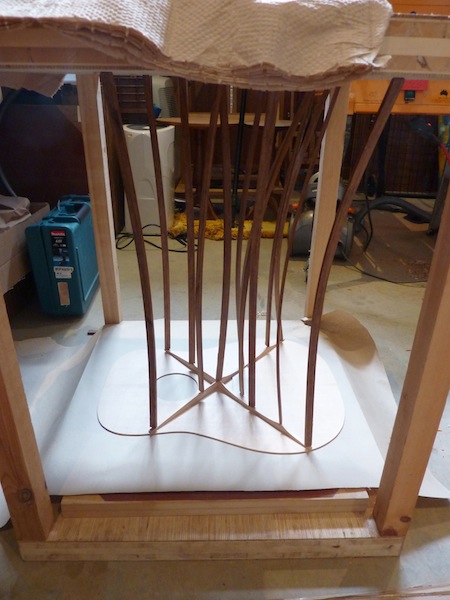

Due to a recent op and subsequent recovery time, I've been able to start work on two guitars. Which will be number one and two for me. The first is a stewmac dreadnought kit, a prezzie given to me about a year or so ago. Part of me wishes that my first guitar wasn't from a kit - but its actually been great to get my head round the processes/tools needed and i'm jigging up as I go along.
I made the go-bar deck about a year ago - but recently made the bars themselves. I used strips of "strand woven" bamboo flooring, after a mate laid it in his house. Its really good. The bars flex amazingly, and because they are woven, there is no grain direction - took them down to 4mm.

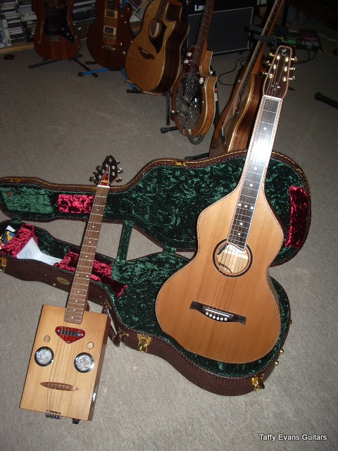

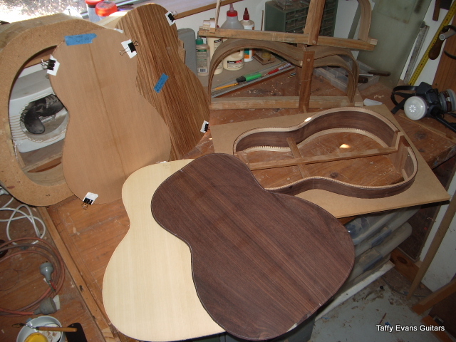

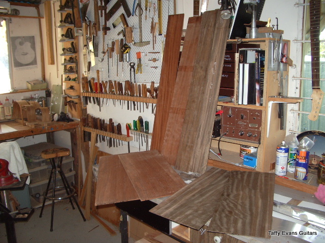

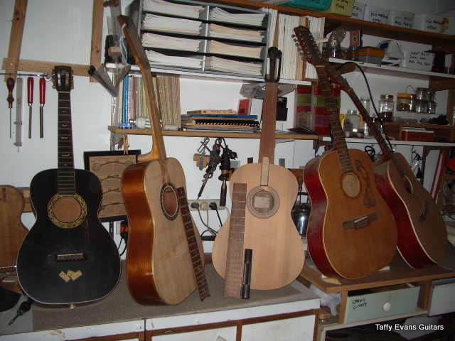

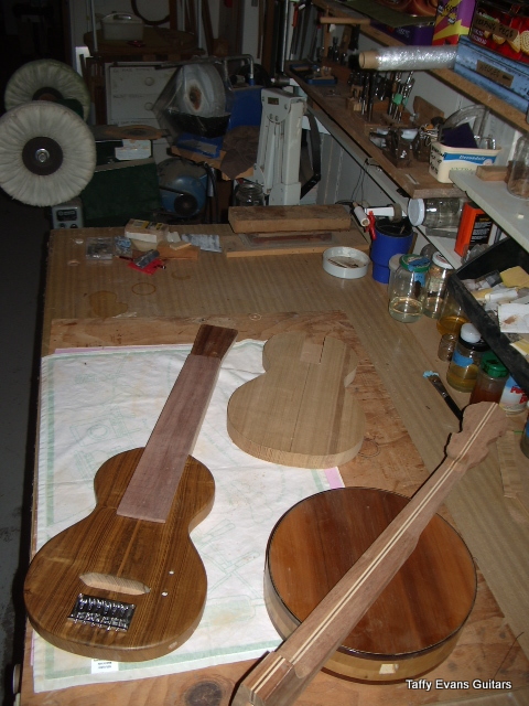

Hi all, it's good to see what you are all up to. Just found some time to contribute to this thread. I could spend every waking moment in the workshops to get though what I've gotta do, wanna do, gonna do, and finish whats already started. You know what I'm talking about, your probably in the same situation. And then one needs time to pursue other activities out side of shavings, dust and glue.
Here are some pics of whats on my, under my, over my benches..................
Two solid lap slide guitars and a wood top banjo 1 x Rosewood '000' 1 x NGR '000' 2 x NGR Parlor guitars Timber ready for a Mahogany Dred and an African Walnut '000' Some restorations: Two Maton's 1 x 6 and 1 x 12 string 1 x "Evans" 12 string 1979 and 1 x Yarai Nylon and Regal parlor guitar. These two awaiting delivery: 1 x CBG and I x Hollow Neck Lap Steel [when I first planned this post they were in the workshop] And why such a back log.......a mans gotta have some social life [maybe too much though.

I think Martin needs to clear his shelves of some of that wood !
so he is the hoarder everyone alludes to ?
