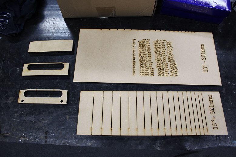

As discussed 15 inch scale,
One is designed to allow razor blade to mark out the other is stewmac jig designed, and the other is the request
In todays mail

Wow!...what a wonderful, creative, innovative and generous group we have in this forum.
Thank you all for your ideas and suggestions. They all have great merit and all have been absorbed, if not for this project, but another. The various explanations have increased my understanding of stringed instrument construction.
Thank you to Steve for so generously and rapidly preparing the fret templates for this Concert Ukulele project, as well making an insert template to be used with a Luthier Tool 'Slot Cutting Jig'.
Sincere thanks to all.
