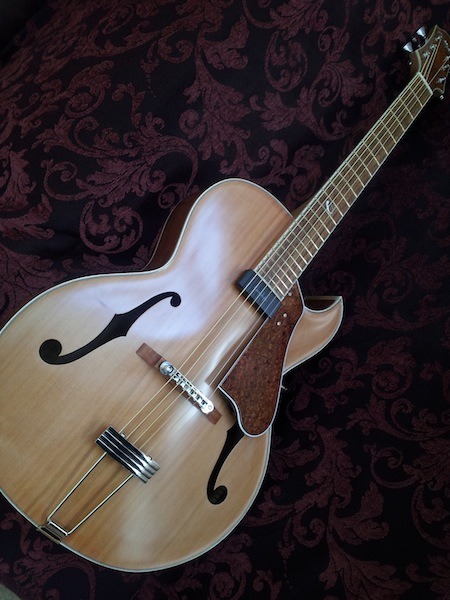

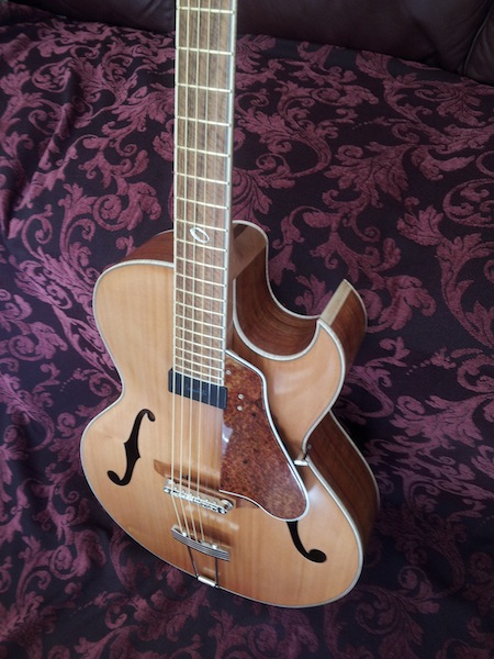

The latest news on this build, i took it to the Melb. guitar fest, not quite finished, couldn't really tell though, still had to hook up the elecs and polish the headstock and pick guard the rest is a satin finish, ended up a very tidy build, deliver next Thursday, hope he likes it.
- Steve.Toscano
- Posts: 495
- Location: Port Stephens NSW
Re: 16 inch Florentine archtop.
Absolutely beautiful !!
- 56nortondomy
- Posts: 717
Well done Rod, it's a real work of art, pretty sure the owner will be more then happy. Wayne
