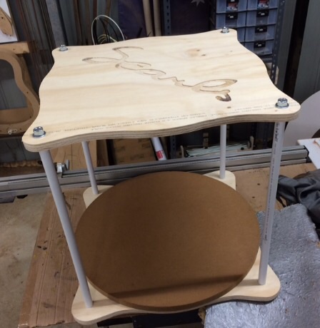

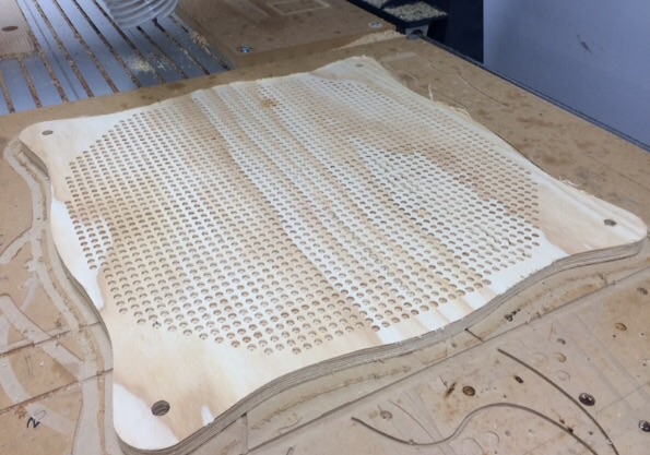

Finally put asside the time this morning to knock up a Go-Bar deck. I should have been fretting a couple of guitars this morning but I drew up the CAD for this and cut it out.
Thought it over engineer it a little with a heap of holes underneath, by a heap I think the CAD program said it was a bit over three thousand, they are so the bars have somewhere to locate Without slipping. Completely unnecessary but it will also assist if I need angular pressure for jobs other than just bracing.
I also just for the hell of it cut my logo out of the top, just deep enough so it's into the second layer of ply and showing a different color.
