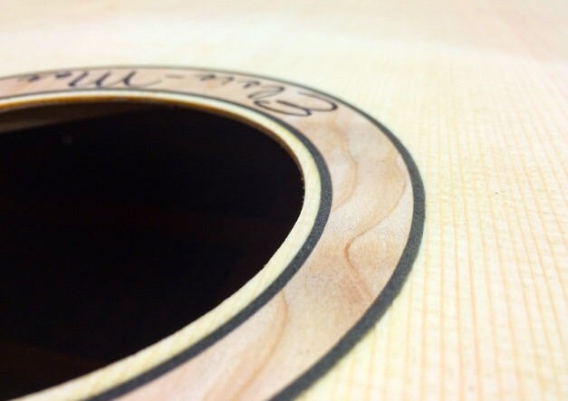

demonx wrote:Yes, unfortunately there was a bit of spillage when I was doing the rosette.
You should look at that very carefully before you put any more work into it. You might be up for a new top.
demonx
Posts: 1395
Location: Ballarat Victoria
Re: Elsie-May dread cutaway build
Post by demonx » Thu Sep 17, 2015 7:19 am
I think I'd rather stain the entire top than do that rosette inlay again!
I'm optimistic it'll sand out. Fingers are crossed.
When it spilled out I quickly wiped it off with acetone. So that can go two ways, it could be either thin just across the top -or- the acetone could have helped thin it down deep into the grain. I won't know till I get stuck into it.

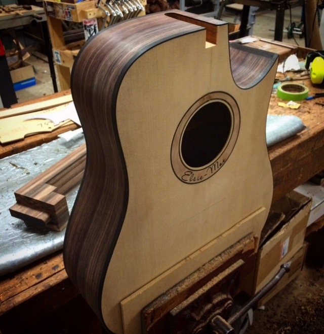

Mitre on the cutaway look good :)

Post by demonx » Thu Sep 17, 2015 9:54 am
You guys, stressing about nothing!
Gave it a quick scrape and then block with 120. It was just across the surface as I had hoped.
Guess I can continue with the binding today.

Trevor Gore
Posts: 1641
Post by Trevor Gore » Thu Sep 17, 2015 11:43 am
Well, I'm certainly hoping you got away with it, but on both my screens, including the colour-calibrated one, I can still see yellow. Check in a couple of different lighting conditions and wetted out with a solvent. These things have a really nasty habit of re-appearing when you start to buff out.
Here's hoping your luck holds!
Post by Nick » Fri Sep 18, 2015 6:42 am
Trevor Gore wrote:Well, I'm certainly hoping you got away with it, but on both my screens, including the colour-calibrated one, I can still see yellow. Check in a couple of different lighting conditions and wetted out with a solvent. These things have a really nasty habit of re-appearing when you start to buff out.
It's amazing how those previously 'invisible' things or things you thought you sanded out many stages back in the process show up once the jam goes on :shock:
Hope it goes well for you Allan as it's a nice rosette.

Binding on:

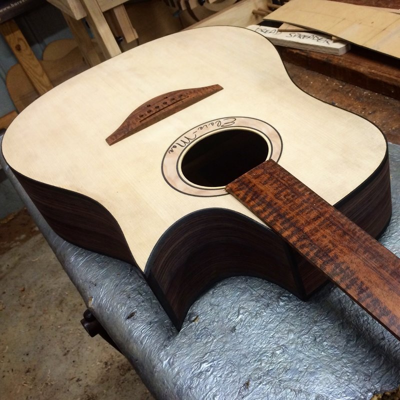

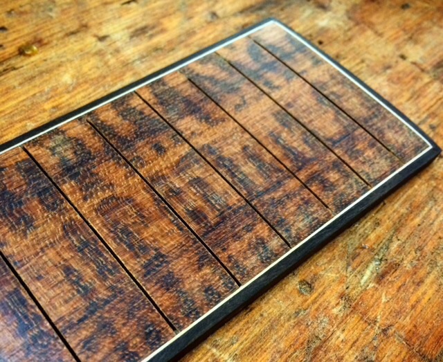

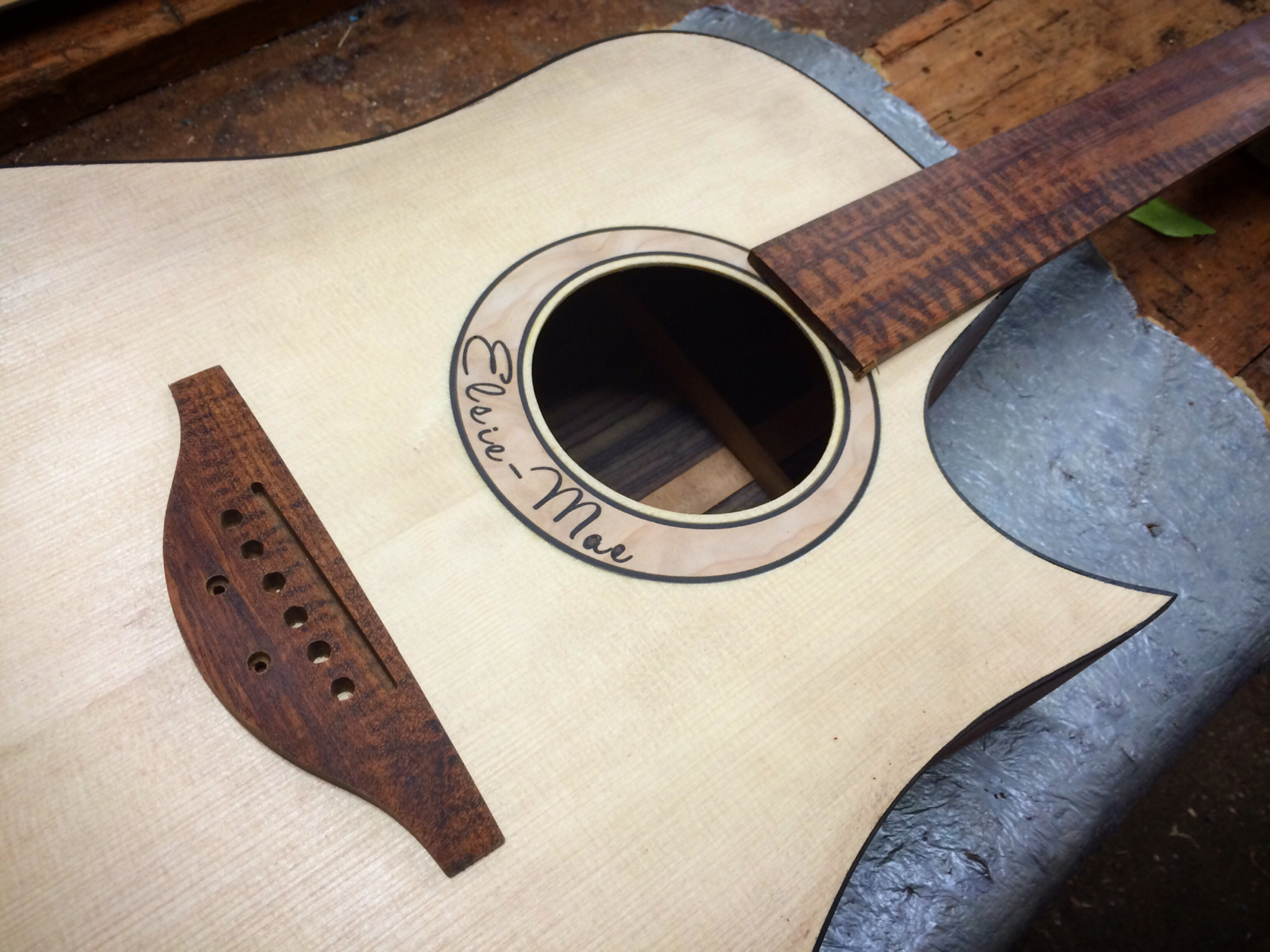

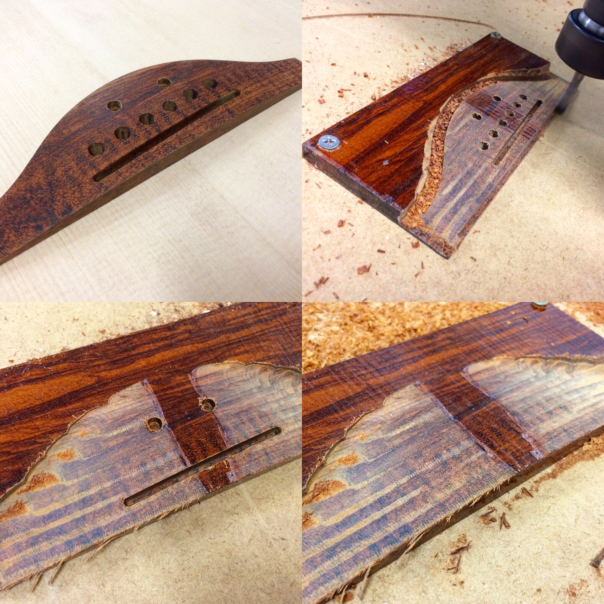

Snakewood board and bridge. Customer request, not mine. I was trying to steer him to Ebony, even yesterday he was here and I was sitting a Ebony board and bridge on it, but he insists he likes the contrast of the Snakewood.

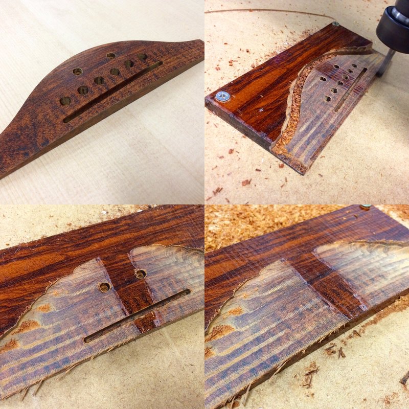

Post by demonx » Sat Sep 19, 2015 2:23 pm
Routing the bridge on the CNC. Three different cutting bits were used.

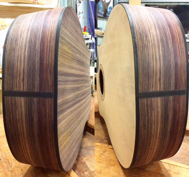

Ebony binding with a strip of maple:

Post by demonx » Mon Sep 21, 2015 3:58 pm
Binding rough sanded back:

Post by kiwigeo » Mon Sep 21, 2015 4:03 pm
Nice work...but how about some pics of the mitres on the corners? :mrgreen:
demonx
Posts: 1395
Post by demonx » Mon Sep 21, 2015 5:00 pm

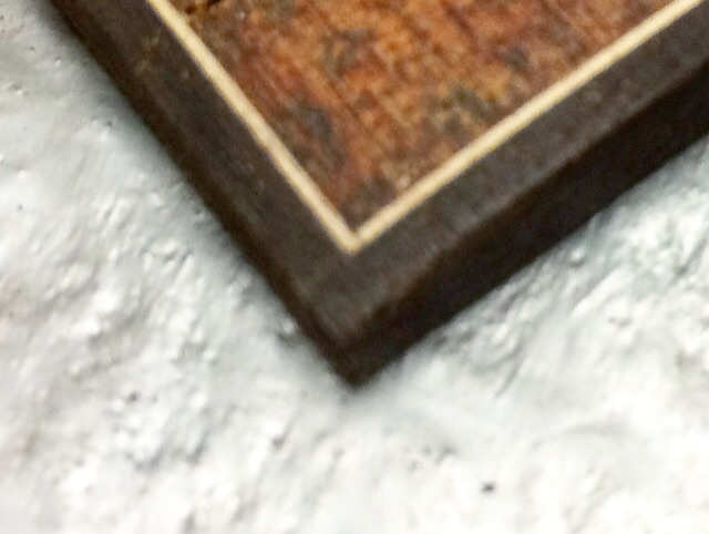

kiwigeo wrote:Nice work...but how about some pics of the mitres on the corners? :mrgreen:
I didn't mitre them, they're butt jointed.

As I said, it's not mitred.
I can't take a true close up as this is about as close as my phone camera goes without blurring right out, even this is "just" out of focus but you get the idea

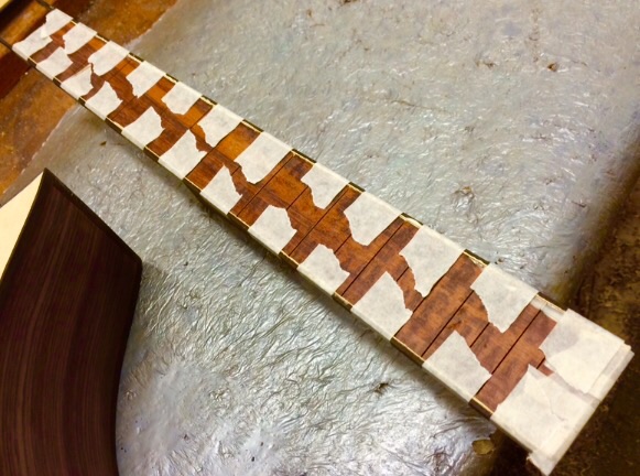

Attachment didn't work last post, so here it is again:
Laying out the fingerboard and pinning in position prior to glue up:

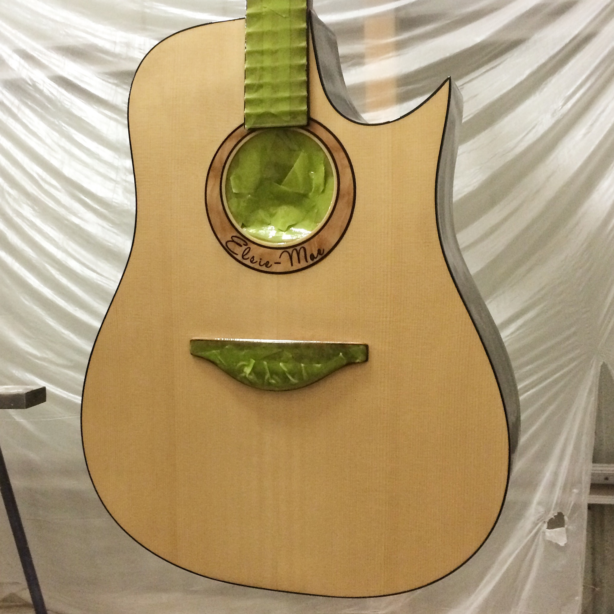

Post by demonx » Tue Nov 10, 2015 3:51 pm
It's been a while since I updated this thread.
Last week I sprayed sealer (Mirotone) and then realized I'd conveniently sprayed over a fingerprint on the top, so I had to sand back to timber and respray.
Anyway, moving on from the fingerprint incident I resprayed sealer and today I managed a couple coats of Mirotone 2k clear.

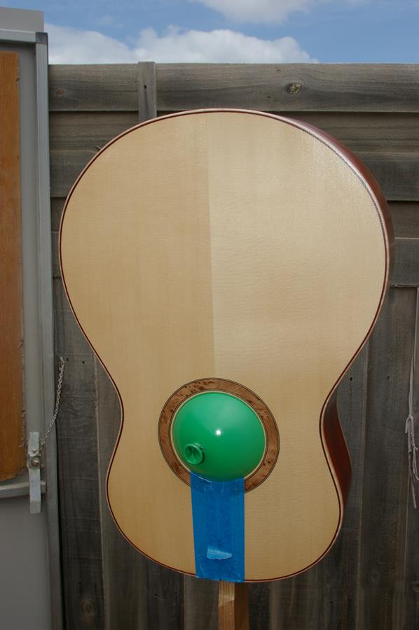

Nice Allan, I use a balloon to cover the sound hole, quick and easy.

Post by demonx » Tue Nov 10, 2015 6:40 pm
56nortondomy wrote:Nice Allan, I use a balloon to cover the sound hole, quick and easy.
That is very handy if you're spraying with water based products, I'll be honest and say I'd have never thought of that!
Try spray 2k and see how the balloon fares, I'd hazard a guess and say it'd melt down over the top.
Everything I spray is done in 2k.

Post by 56nortondomy » Tue Nov 10, 2015 9:07 pm
You may be right, I use miritone lacquer. Wayne
